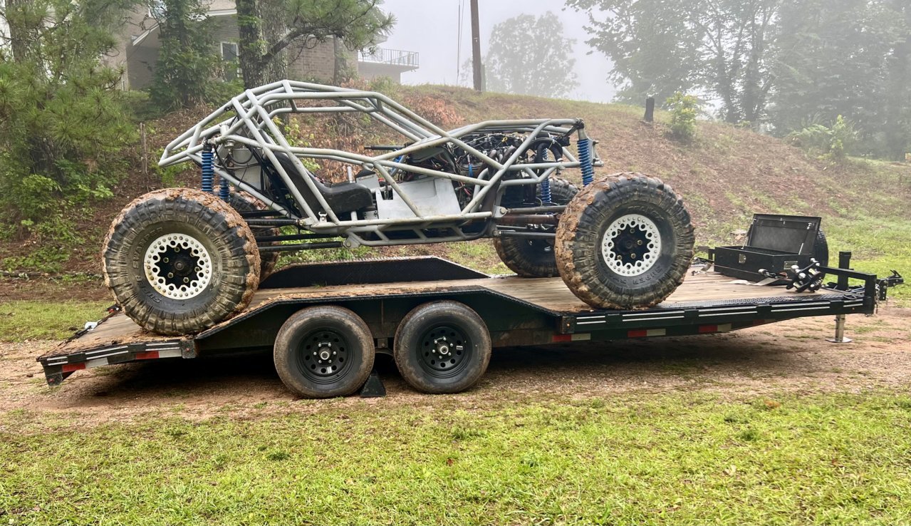

    I did a thing. Pooped a little first time I drove it. She mean!

    2000 SR5, 2003 Double Cab and a Suzuki Samurai
    Awesome, looking forward to seeing it in action :burnrubber:

    https://www.tacomaworld.com/threads/daymans-karate-class-but-you-wont-learn-nothin-4-link-lt-and-previous-iterations.755134/
    Gonna take me a while to get comfortable with that much beef haha gonna rip and roar at the house so I don’t embarrass myself too bad in public :rofl:

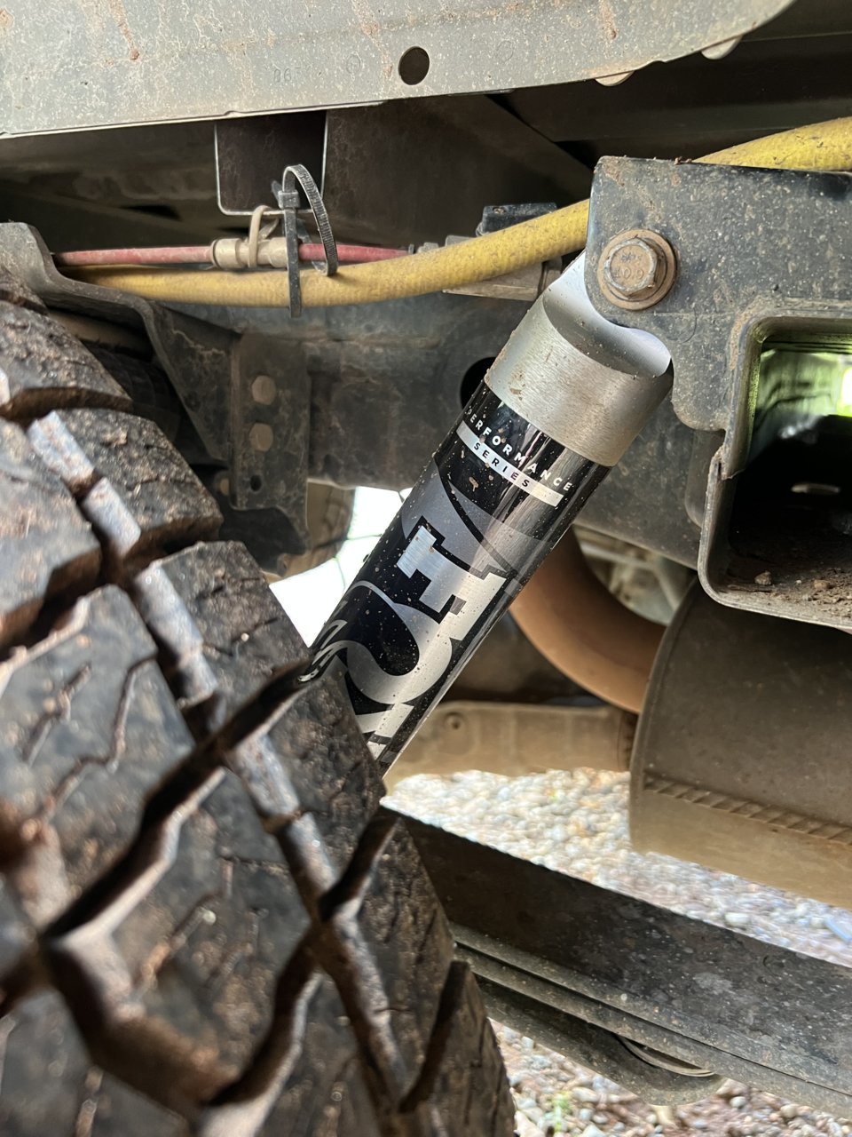

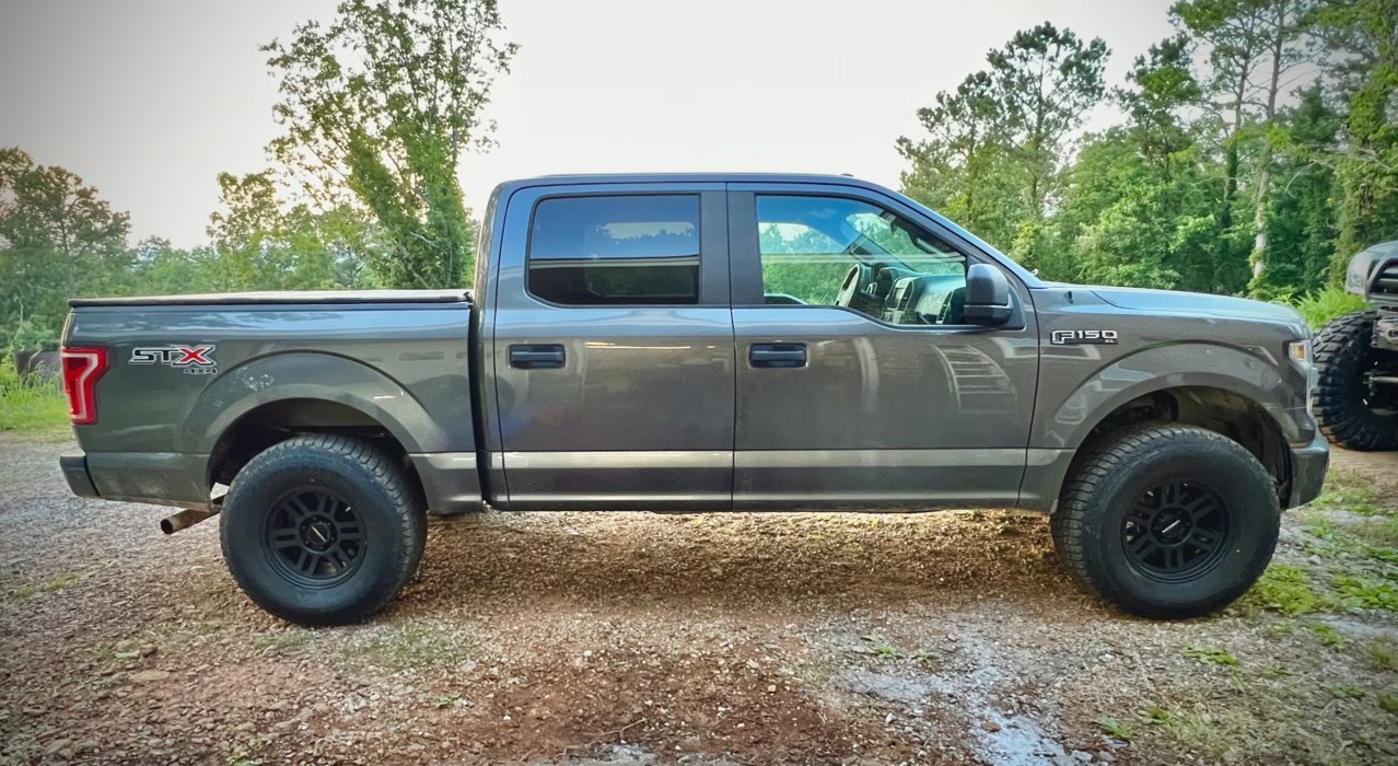

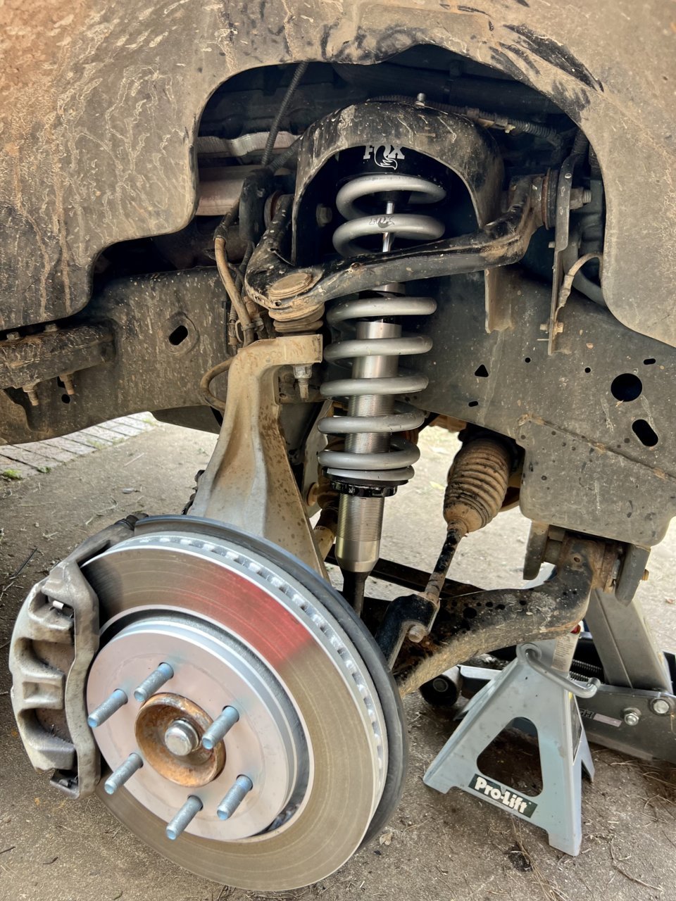

    Added some Fox 2.0’s to the Ford. Much smoother ride on and off-road than the 5100’s. New stock rotors and Powerstop pads, too.

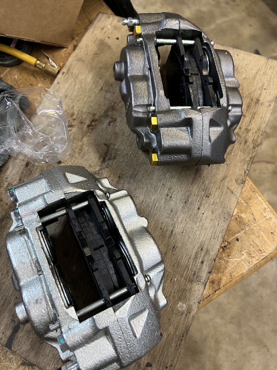

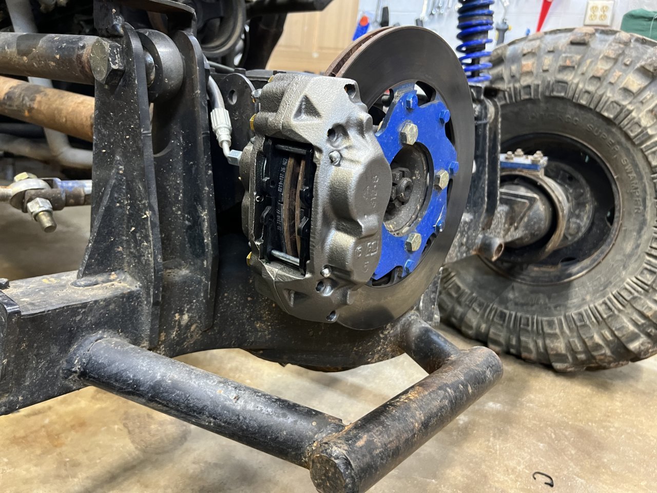

    More bouncer TLC. New calipers and pads. Bigger 220 amp alternator. My guess is the stock 80 amp wasn’t cutting it for the electric over hydraulic rear steer. Hopefully this helps.

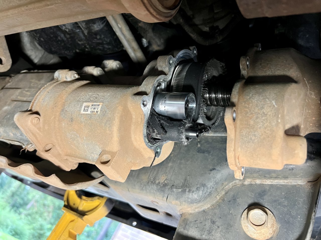

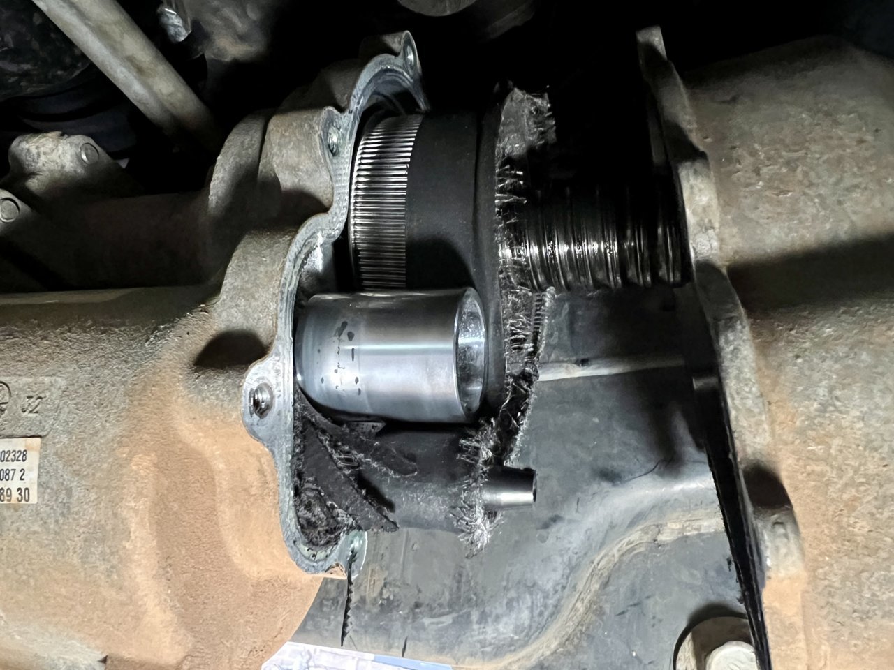

    Having some trouble steering with the ford and it started really acting bad yesterday to the point I stopped driving it. Did some research and decided the rack was bad. $1300 part, and since it’s electric it has to be programmed. I could reprogram with Forscan, but holy crap what an expense.
    Ford considers the rack unserviceable and doesn’t sell individual parts or anything. Came across a YouTube of someone who took their rack apart and found a torn belt. Sure enough, I have a torn belt and was able to find them for $30 online. Grabbing two. I wish I knew what caused it to jump and tear like that, but am happy to not have to spend $1300+ on a rack.

    I had electric power steering on both my Samurais and messed with a few different ones but that is the first one with a belt I have seen.
  17. Jun 28, 2023 at 12:34 PM
    #257
    Dayman Karate
    Dayman Karate [OP] Ruffling feathers and turning eagles into vultures
    Dec 18, 2017
    #238838
    4,719
    Clay
    Central Alabama
    2001 4Runner, JKU Rubicon
    Yeah I’m not very excited about it happening with only 80k miles. Wonder how many folks get screwed into replacing the whole rack. Gonna keep an extra belt in the truck. Not too bad to replace. Don’t have to pull the rack, but the rack is only two bolts anyway.
