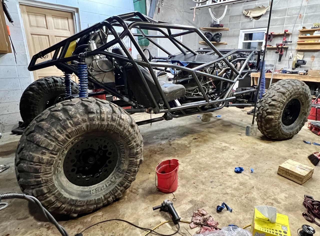

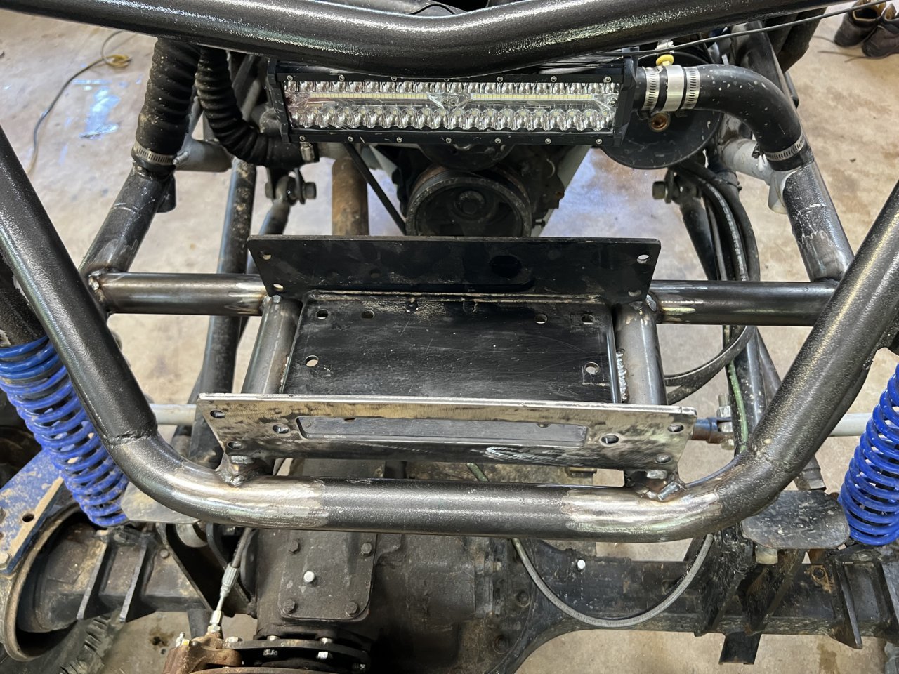

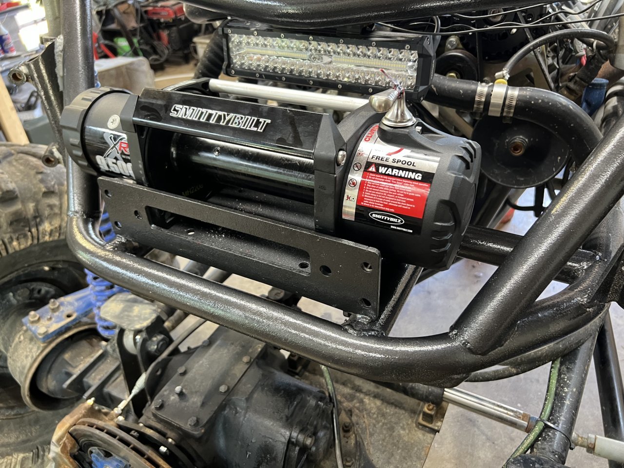

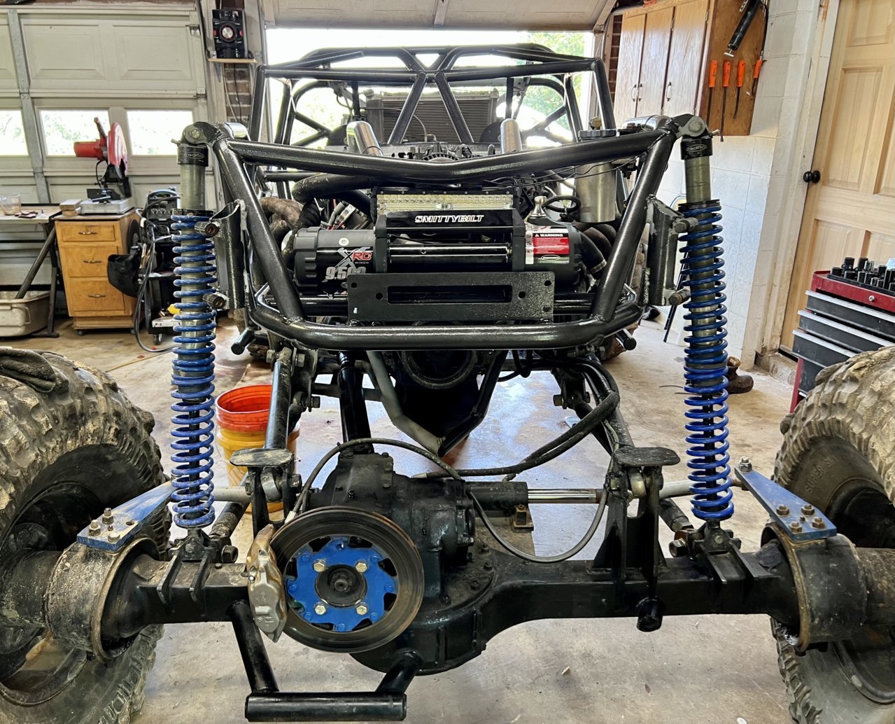

    Been messing around with the bouncer. Ordered a new trans pan from Summit with a drain plug. Need to plumb in a temp sensor, but not sure where yet.

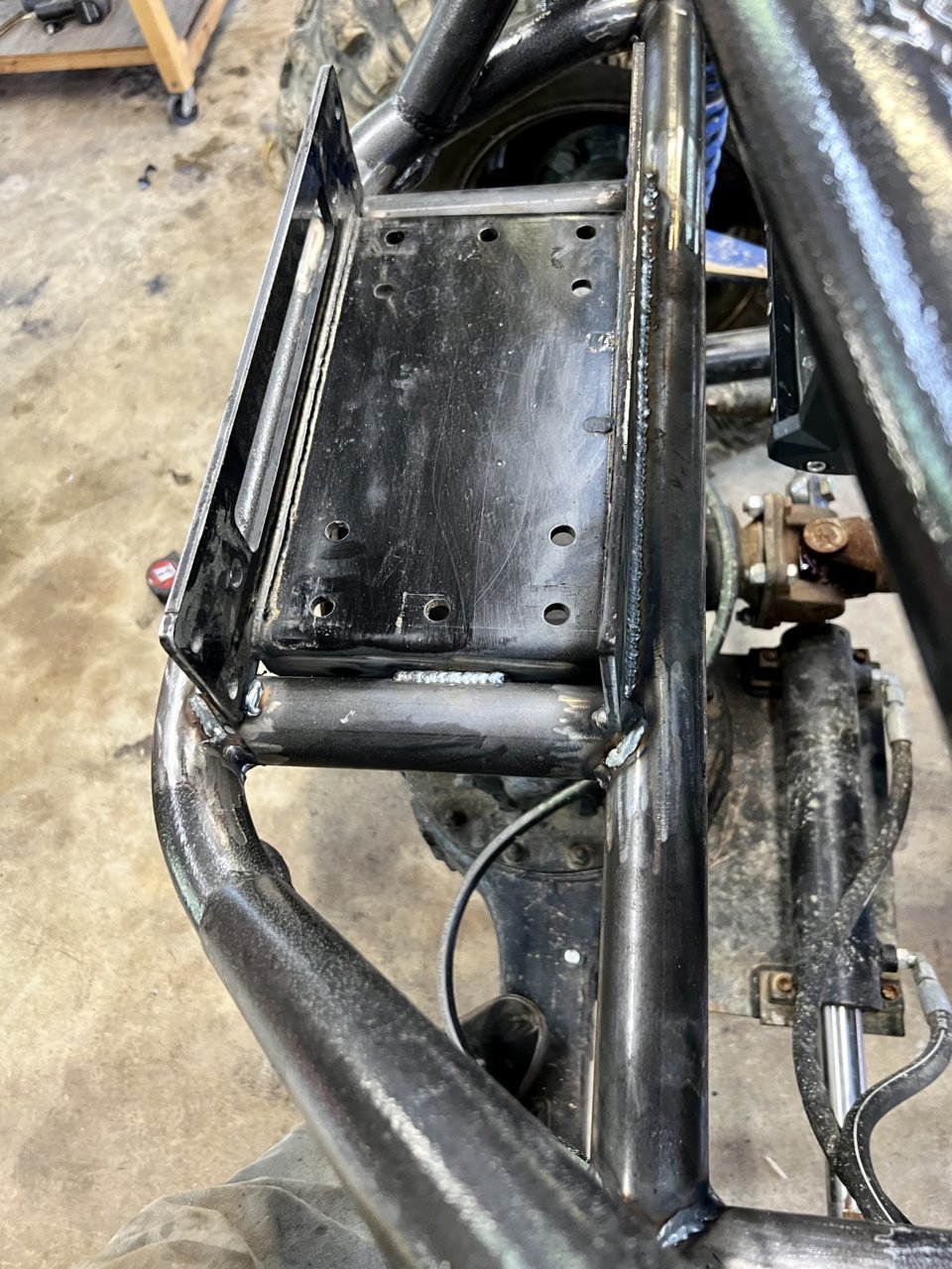

    Knocked out the winch tray with some old stuff I had. Nice doing just tube 90’s. Been a while since I’ve fabbed anything up. Slowly painting it with hammered black paint and a two inch roller. Surprisingly forgiving and covers up a lot. Has more of a super dark gray look which is what I really wanted.
    Going to paint anything that’s blue with regular black spray paint including the coils. Need to set up bump stops and straps and redo a bit of wiring.

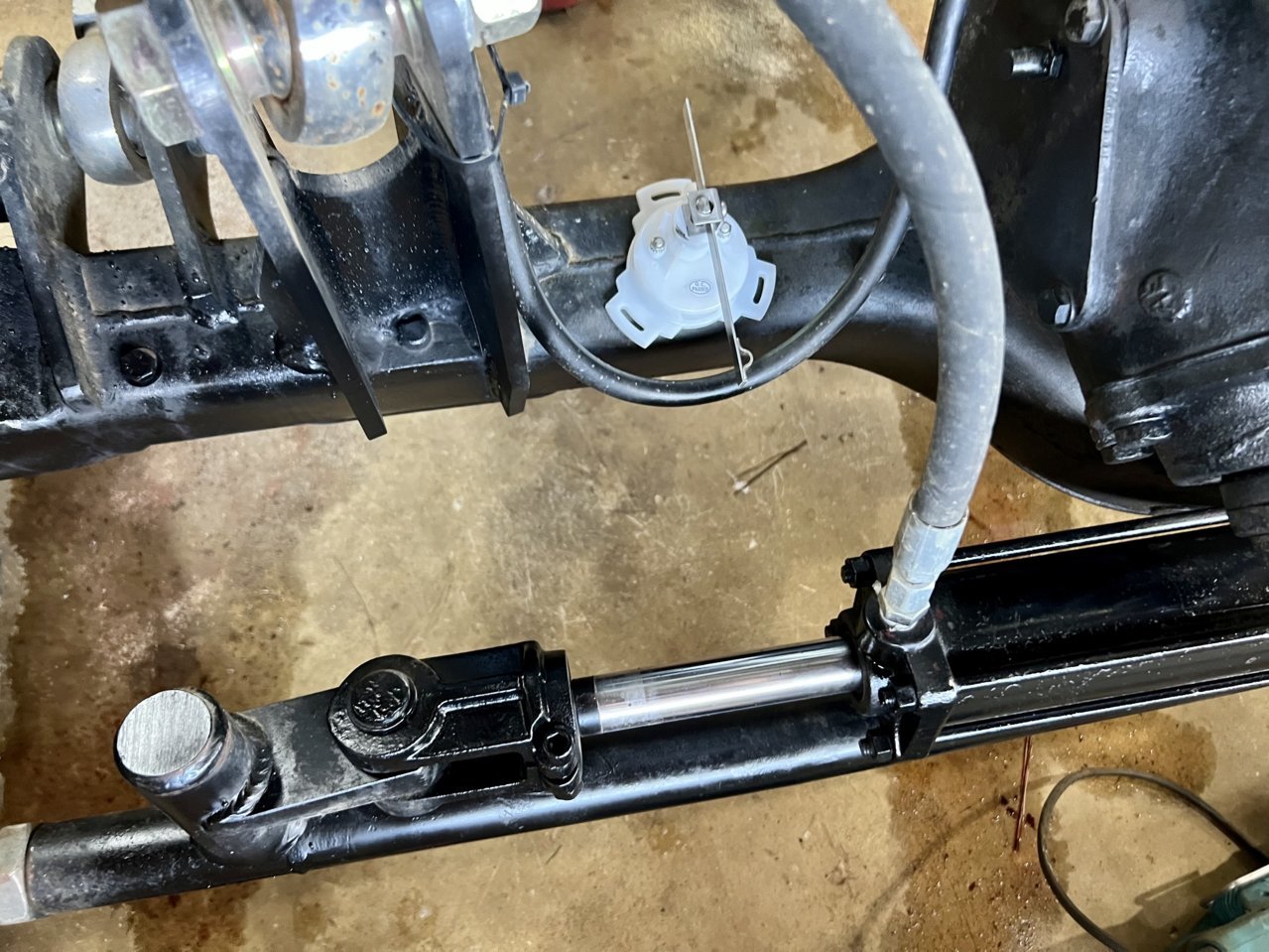

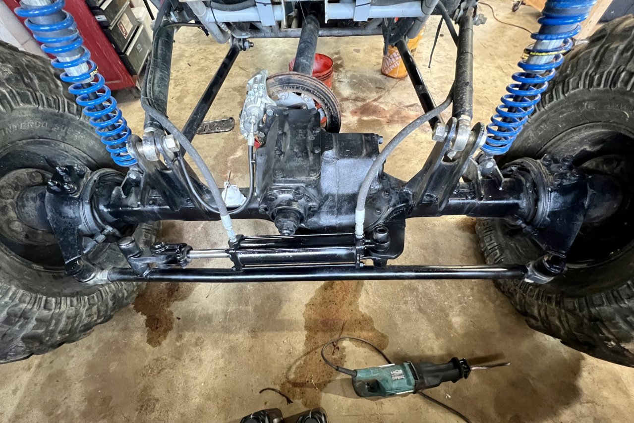

    Self centering rear steer would be sweet, but I think I’d be happy just knowing when the rear is centered for now. Rigging up a rudder position sensor to the rear axle. Thinking I’ll use a bicycle brake cable attached to either the steering arm or cylinder and have the other end spring loaded so that it will keep some tension on the cable turning the other way. This should let me know exactly where the rear wheels are at all times without turning my head and guessing.

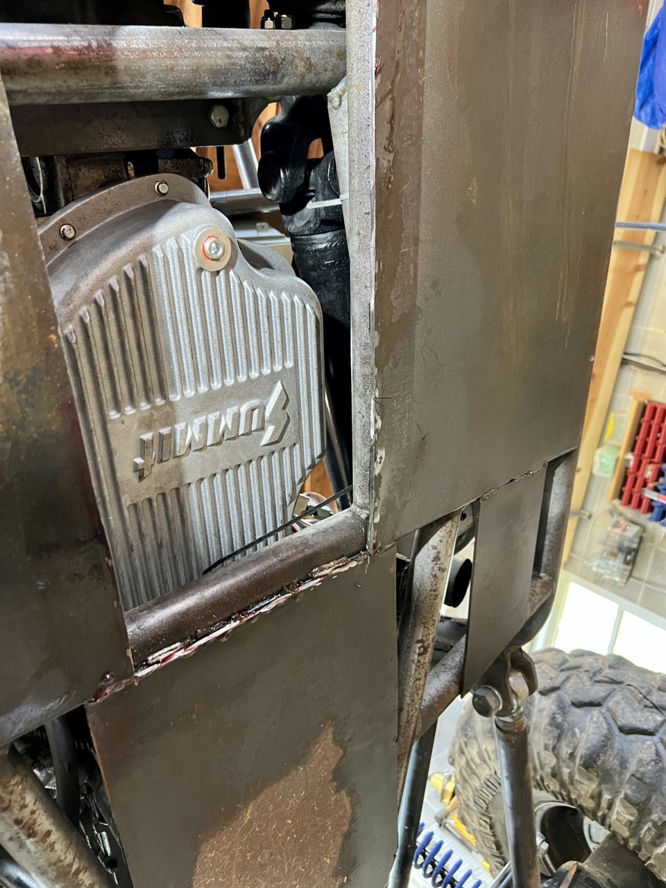

    Swapped pans on the TH400 and used a lubelocker gasket. Had to cut a hole through the belly because aluminum pans are a bit thicker than the stock steel ones. Took some finagling with the filter, but finally no more leaks.

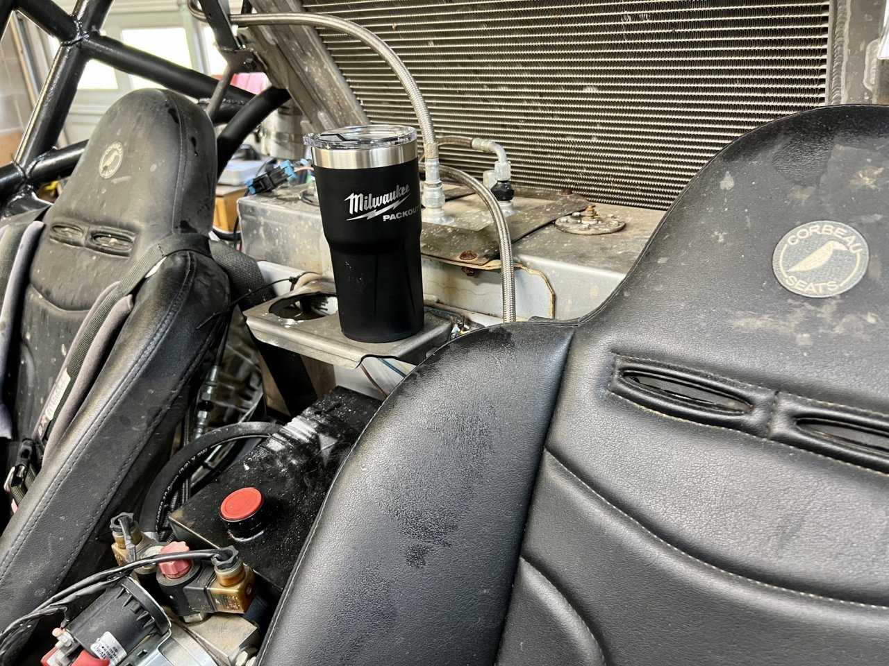

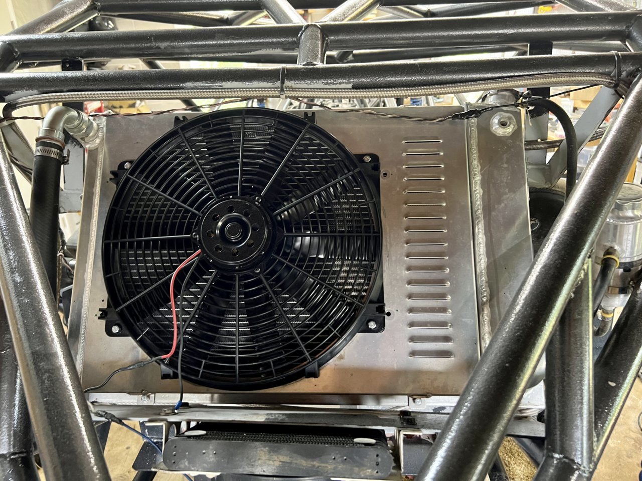

    doing a little painting and added a cool pack out cup mount from Off-road Anonymous.
    Changed the oil and swapped to a higher output fan, but I’m pretty sure I have air in the coolant so I’m trying to burp all that. No idea what I’m doing.

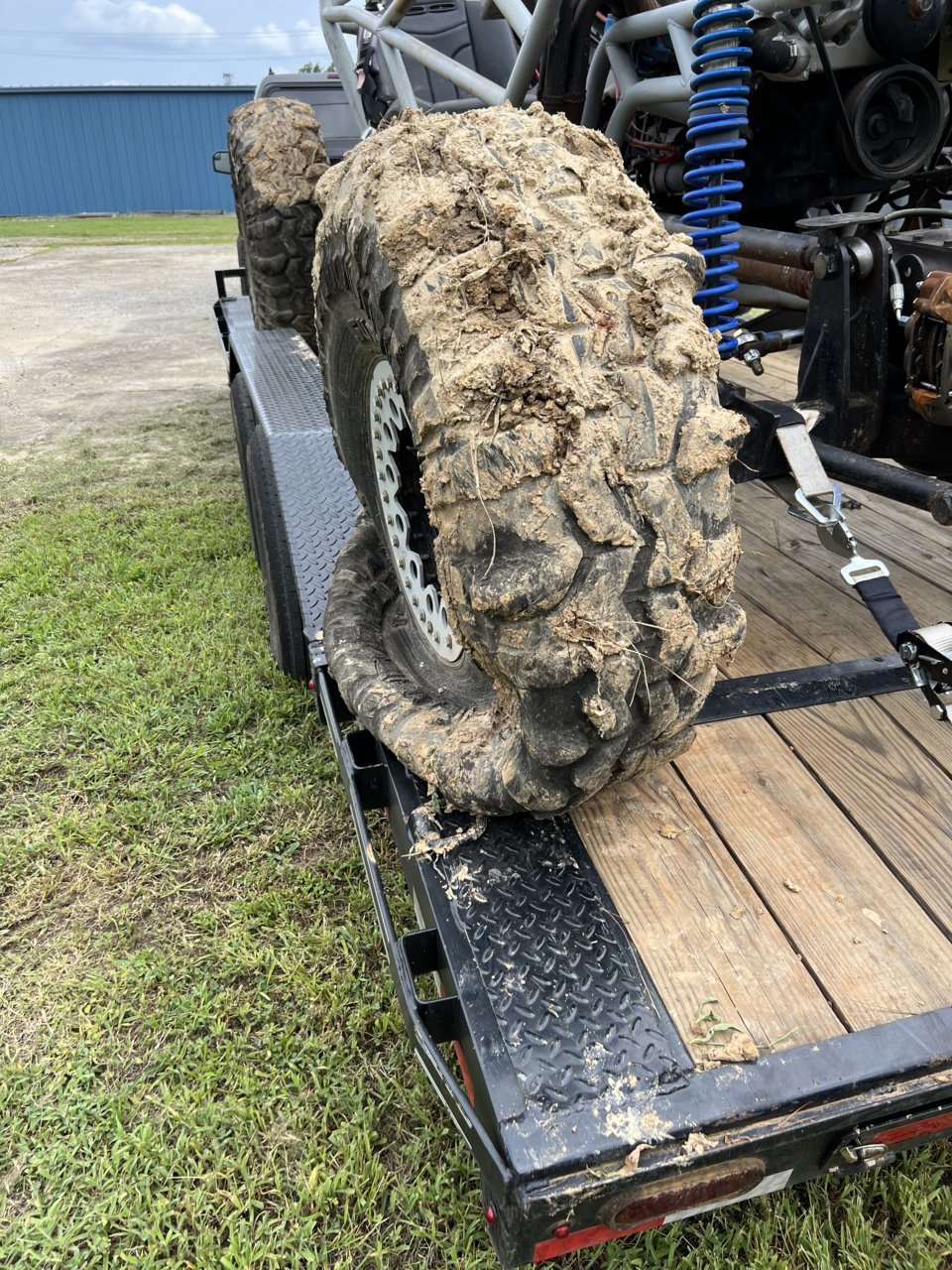

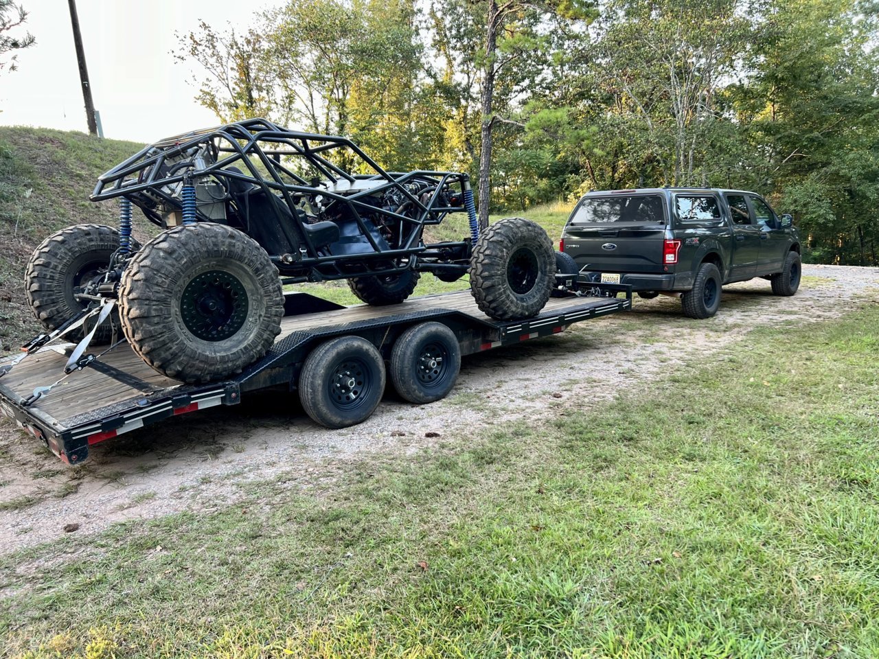

    Loaded up for AOP this weekend
  20. Sep 24, 2023 at 11:37 AM
    #300
    Dayman Karate
    Dayman Karate [OP] Ruffling feathers and turning eagles into vultures
    Dec 18, 2017
    #238838
    4,719
    Clay
    Central Alabama
    2001 4Runner, JKU Rubicon
    https://www.tacomaworld.com/threads/daymans-karate-class-but-you-wont-learn-nothin-4-link-lt-and-previous-iterations.755134/
    AOP carnage
