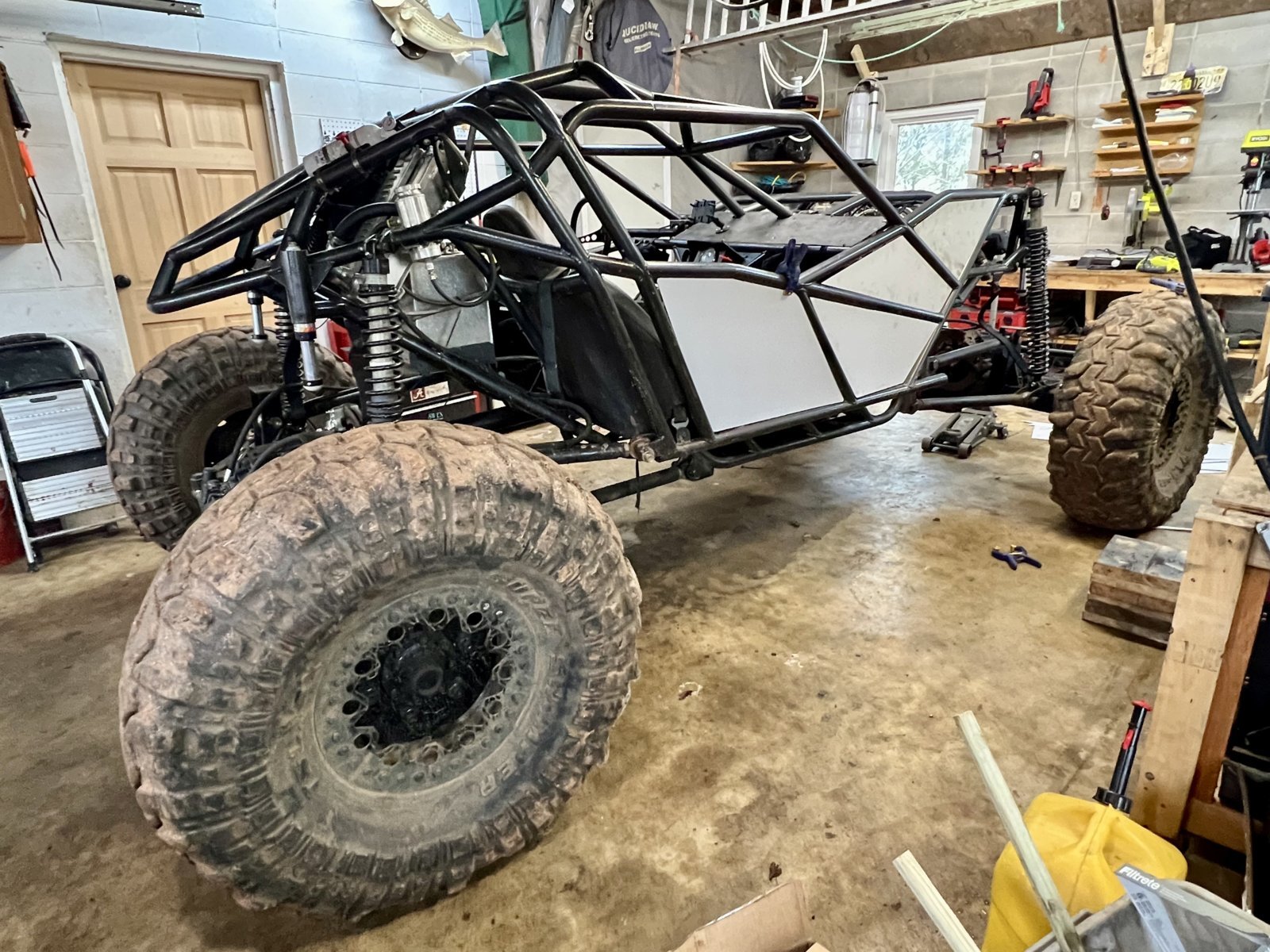

    They’re pretty gappy, but it’ll work for me haha wish I had a better way to trace the shape. Just eyeballing the thickness of the pen and hoping for the best haha

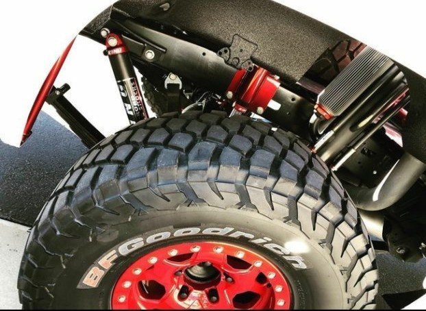

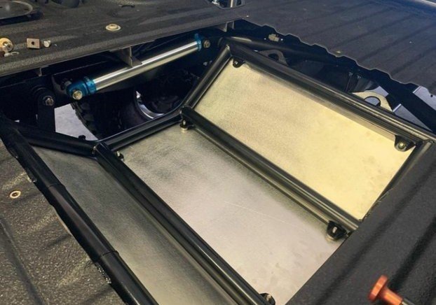

    Took me a bit to find the photos, but here are the two that gave me the idea/solution for towing.
    Red one is a kibbetech truck with the air shocks bolted to the axle. Shot of the empty spare tire carrier is an SS Built truck I believe, and shows the air shocks bled of nitrogen, and then pivoted up to secure it along the frame when not in use.
    This would literally be the last part of the build since they have to of course clear everything and are only used for a few miles at a time on the weekend. Guessing a 10" or so travel shock is all you'd need.

    That’s a pretty sweet idea. Should give you some confidence towing. Can air shocks hold up to heavier weights at higher speeds? I had heard that don’t do too well like that, but that’s zero knowledge on my end, just hearsay. Since they aren’t supporting the weight of the truck it may not matter.

    I've generally heard the same. Aside from ORIs, i've always thought of the smaller diameter king/fox/etc air shocks as a budget alternative to coilovers. with the tongue weight of my boat only around 250 lbs, i should really only see an inch and a half or so of sag. my concern is that even with an antirock, that id see significant body roll. So really their purpose is sway control more than weight support.

    I think that’s a solid move. You’ve got the coilovers supporting the weight anyways, air shocks are just stiffening things up a bit. I’m interested to see it all come together. Are you making a build thread?
