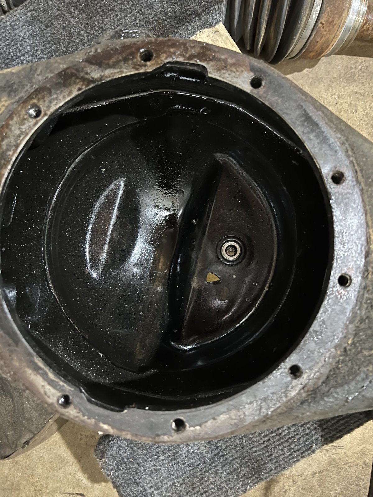

    Yeah, as much as I want to fill in that decent size hole I’m gonna go with the Dorman replacement diff cover lol amazing how thin that metal is…

    Forget if I mentioned this but shave that housing for better clearance while you are at it.
    also won’t have to worry about the drain coming loose dragging over rocks

    Shave like a 14 bolt or just cutting off the drain? Edit: nvm, no way there’s enough meat to shave like a 14 bolt lol
    Looking at replacing stud replacement kits, too.

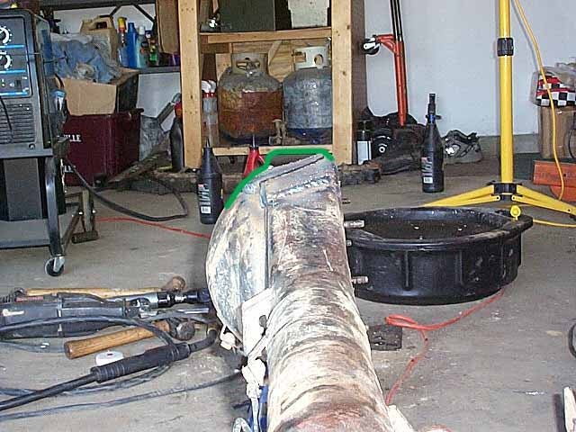

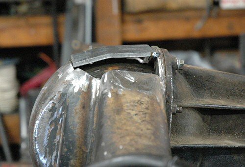

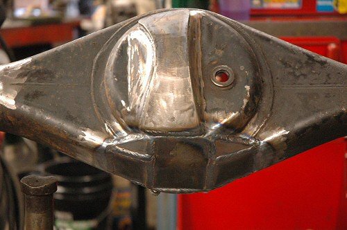

    Kinda like a 14b just no room to shave the mounting face of the third like the diff cover on a 14b. Rather cut the housing from the mounting surface back and plate, making sure it clears the ring gear. There are some pirate threads on it, people say they gain up to 1” depending on pinion angle.
    here are some random pics I saved of it
    I plated the fuck out of my housing a while back and wish I would have done this instead

    Wow I’d never seen that on a Toyota axle. Was debating plating mine. Toyota housings are pretty dang slim as it is. The chunk is pretty much in line with the lowest part anyways. After dealing with tons, I’m not sweating a yota thickness just yet haha

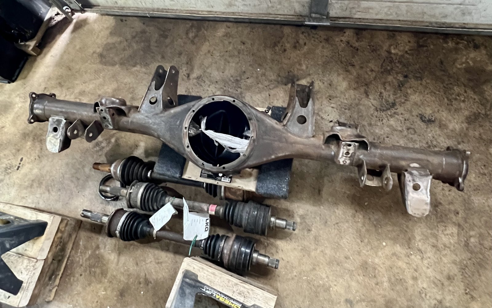

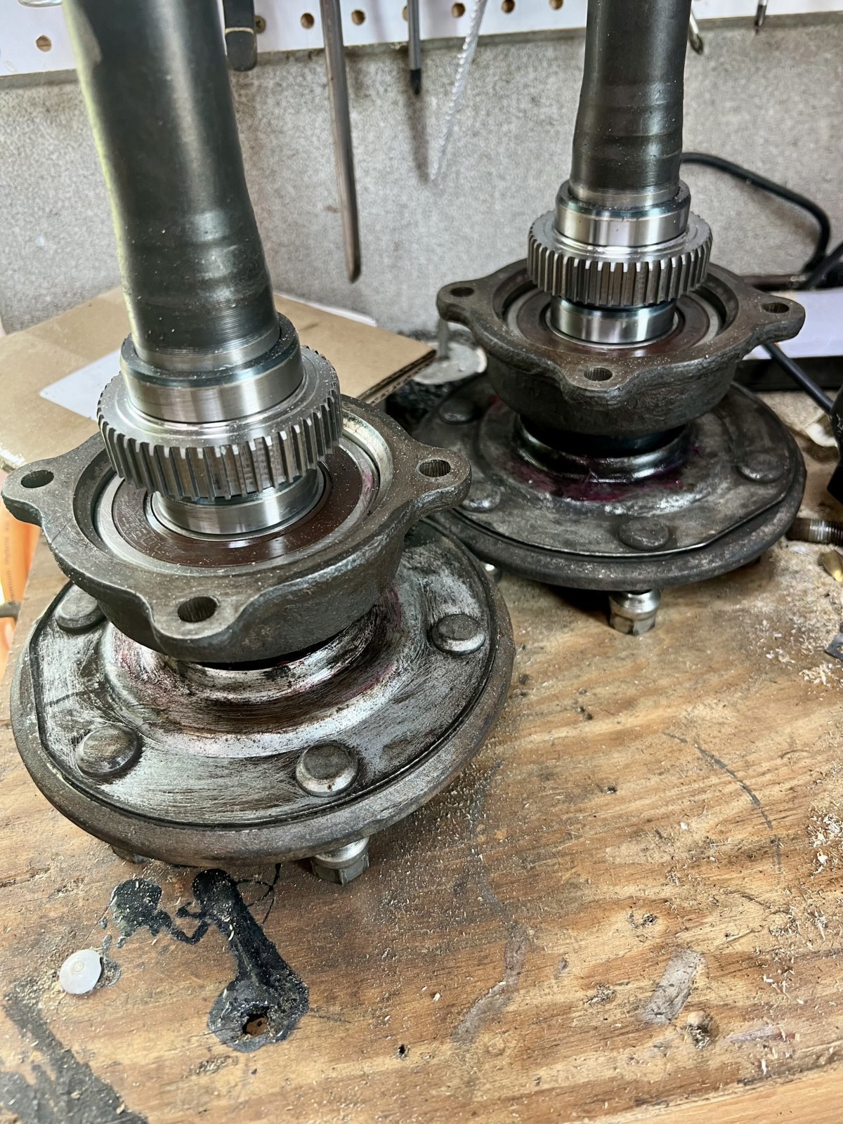

    New rear bearings are in, spindles empty and prepping for gussets, rear axle halfway cleaned up.

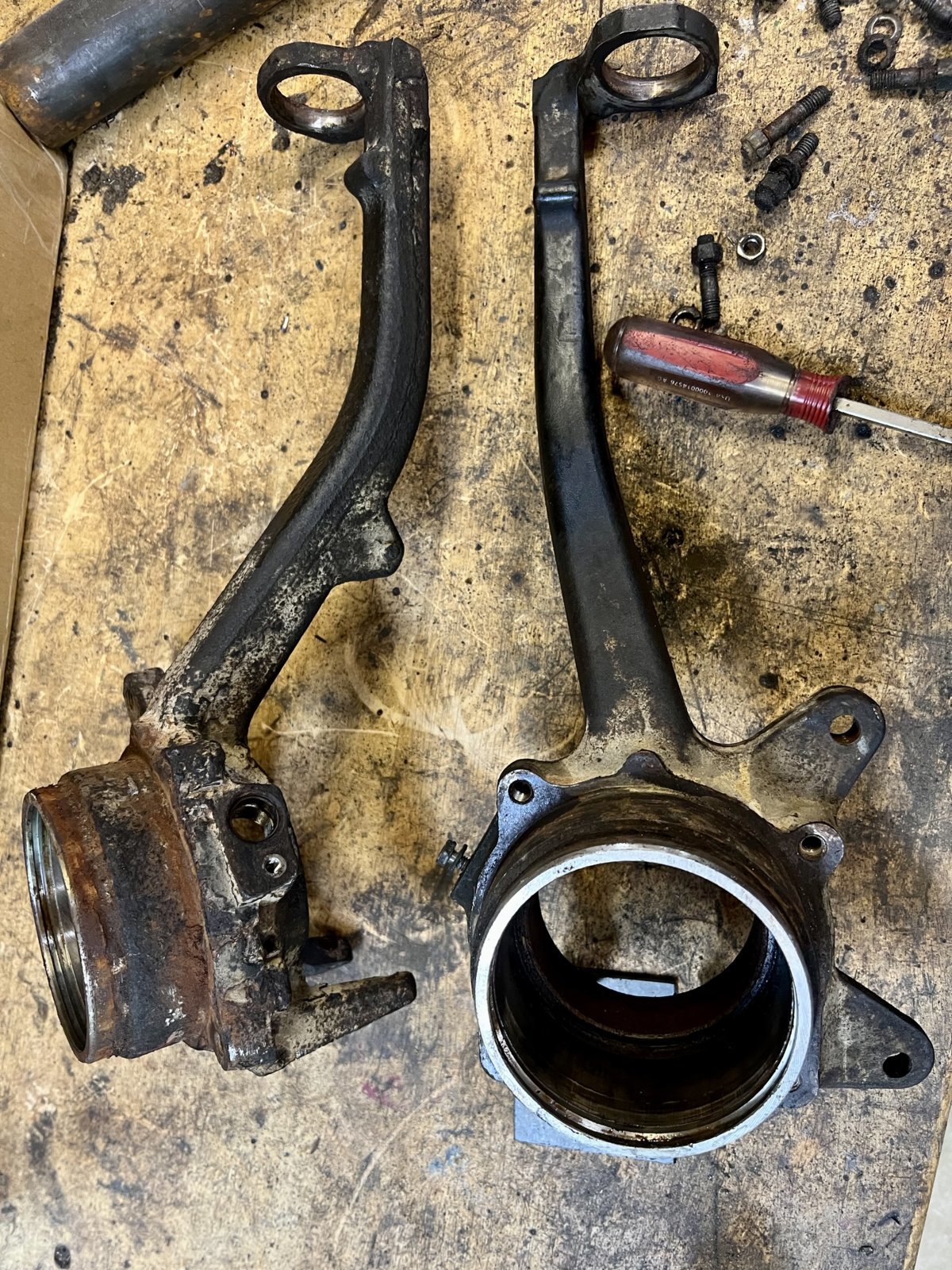

    Japanese finger torture. Plus damn near every bolt snapped off in the frame. Don’t think I can bring myself to put this tank back@JTFisherman have you researched the Ford tank relocation any?

    not much. I think eimkeith has some on his website about it and has some parts maybe?
    would be hard for me now with the sway bar

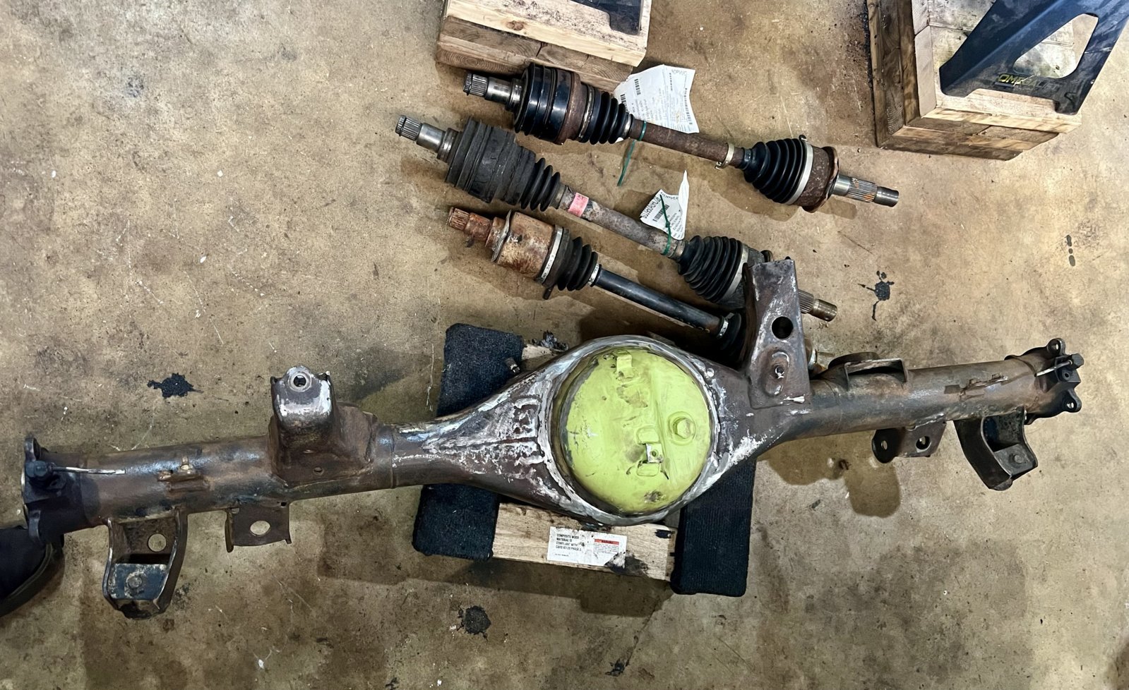

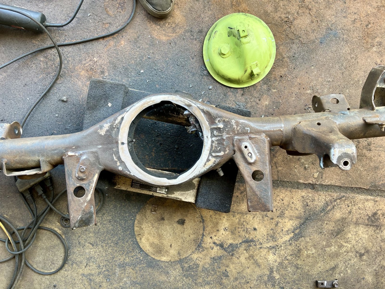

    Cut off the frame side lower link mounts, driver side axle upper link mount and replaced the diff cover. Also plugged up the diff drain and will replace the studs with bolts. I did an absolute awful job on the diff cover welding so it went to grind town. Different wire, bad settings, gas not flowing right and by the time I got it dialed in I was pretty much done haha

    Just cover the ugly welds with bondo and fiberglass :rofl:

    Too rich for my blood. Might get some caulk :rofl::rofl:
    I was so disappointed since I took the time to prep the shit out of it haha

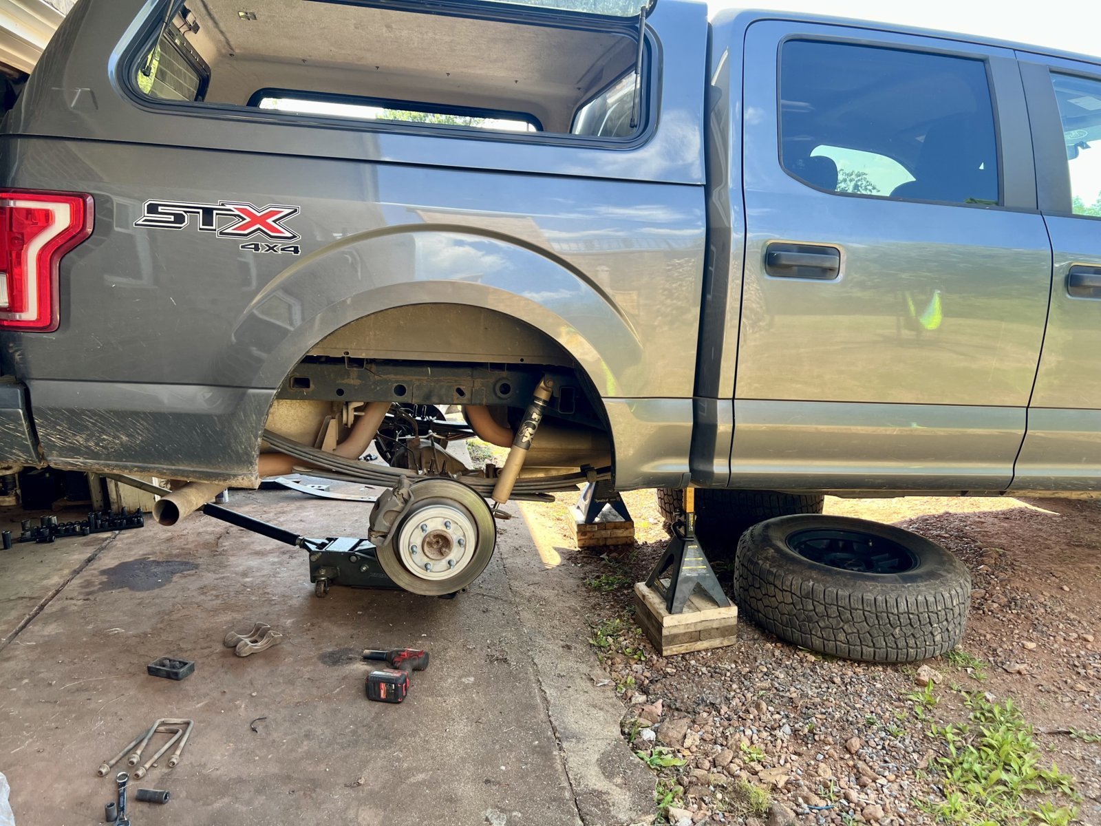

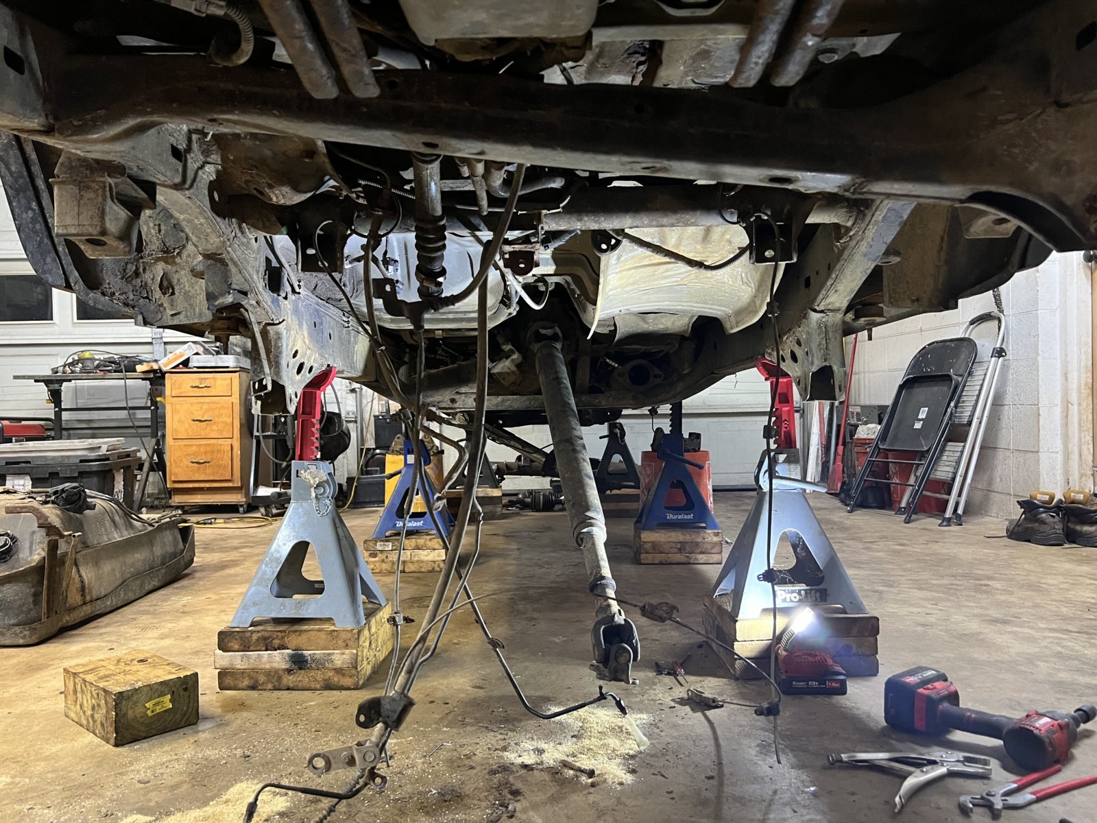

    Been busy lately. Tree killed the camper- big bummer there. We have six goats now.
    4Runner is coming together- got the three link, shock relocation and rear disk set up this weekend. Had to modify the freel good kit, but it’s cycling 14” cleanly now.
    East coast gear supply and @AccuTune Offroad delivered super quick. Both only took a week before they were shipped. Both super helpful and friendly as always. Went with 5.29 and ARBs in both diffs.

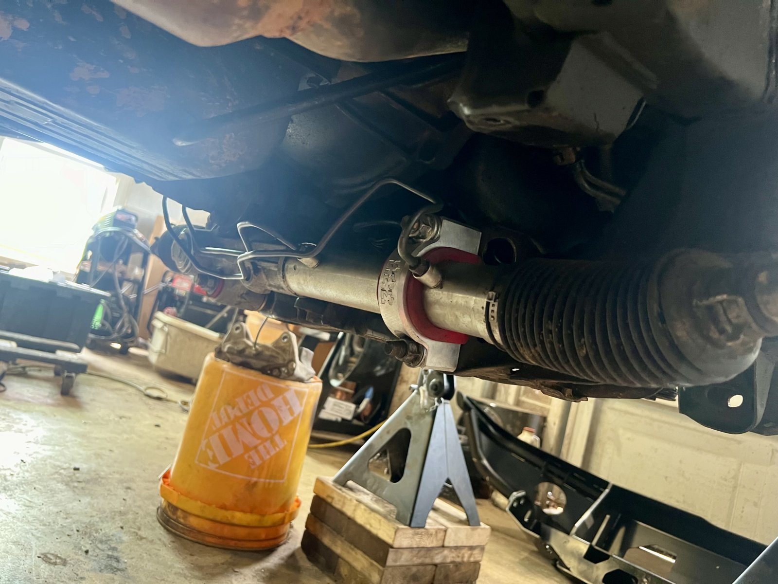

    Got the front diff in, painted the bumpers and had the worst time with the steering rack. All the weld nuts broke, so I ended up throwing two bolts through the clamp side. Luckily they tightened without anything on the backside, but it’s anyone’s guess if they come off the same way. Another day lol
