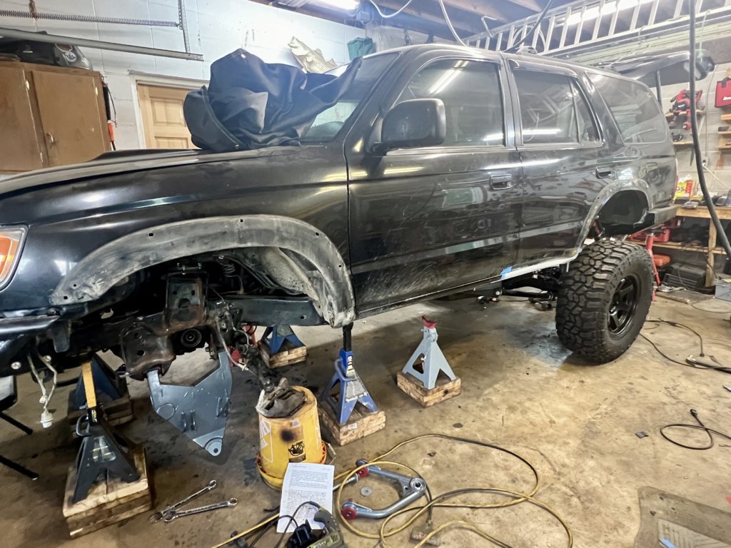

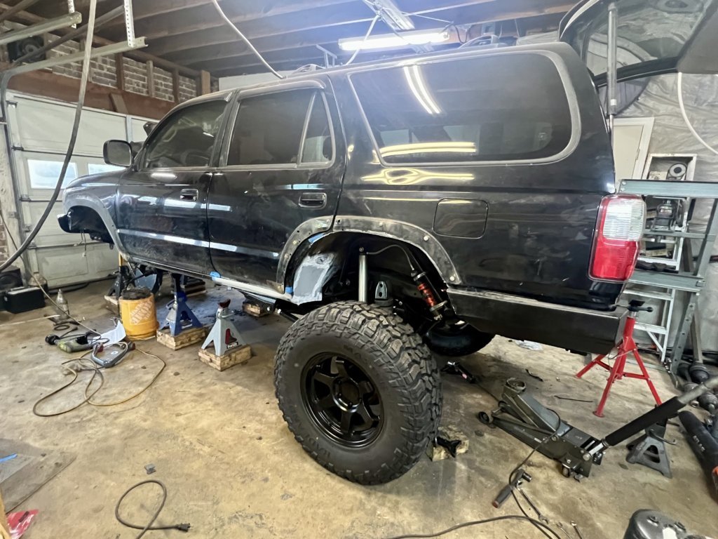

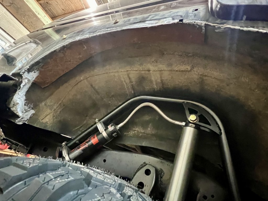

    Rear end is on the ground now. Have about 200 lbs to add to the rear, so hopefully it comes down a bit especially when the front is on the ground. More sheet metal work to patch the hole after clearing 35’s.

    God damn that sits up there… hopefully I didn’t steer you too wrong on the springs when it is off jack stands.
    Can’t wait to see this hit trails.

    Yeah she’s way tall haha but I have no skids, sliders, tools, spare, spare parts etc back there yet. Doubt it’ll come down enough, but I’m hopeful lol I could also trim the axle side perch down and lower it maybe 1/2” since it doesn’t sit flush.

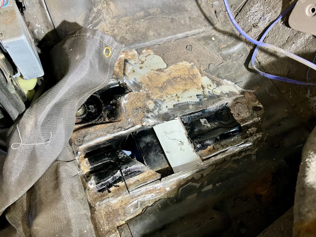

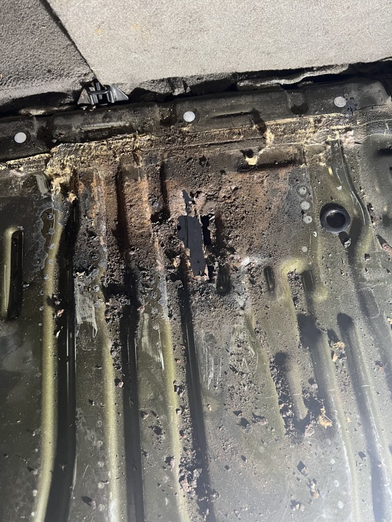

    Front floorboard rust. That’s a porcelain tile so I didn’t melt my brake lines lol

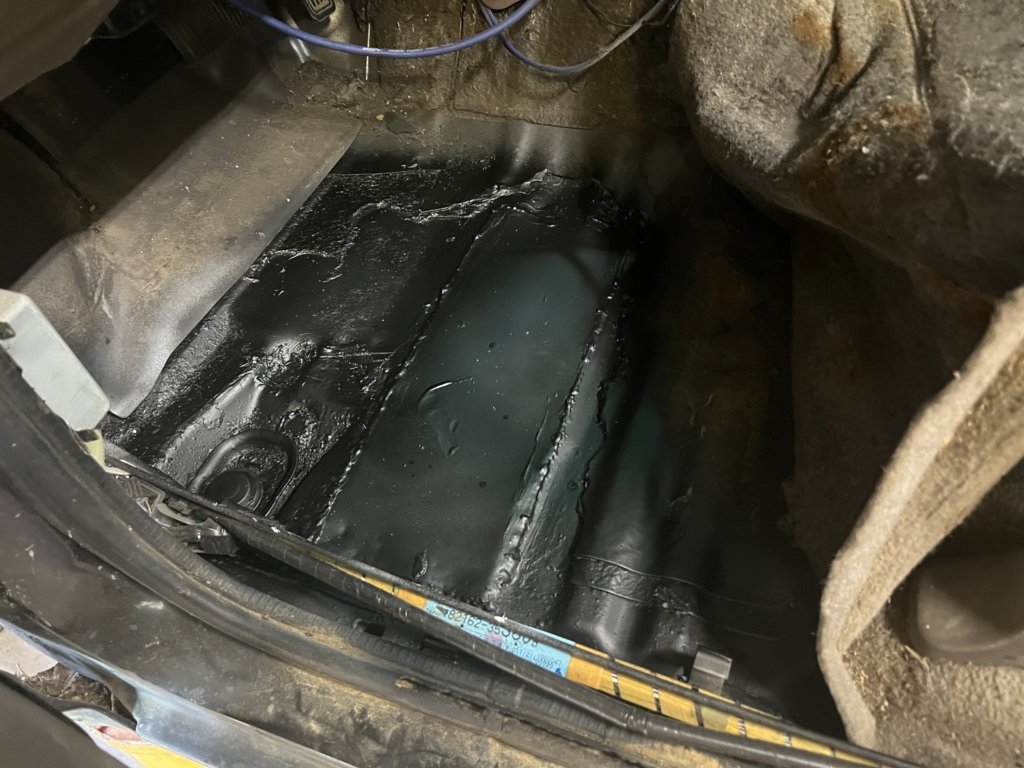

    Went to remove the nasty rear carpet and shabam- another rust hole.

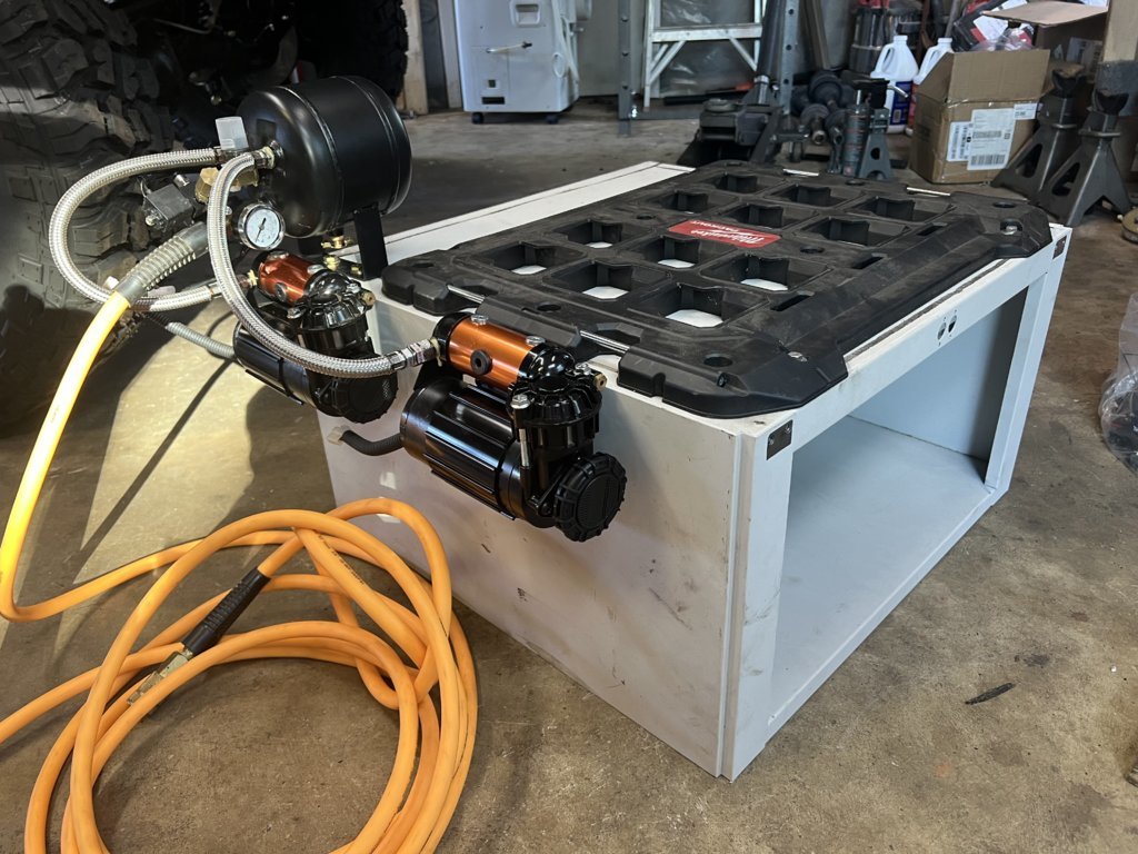

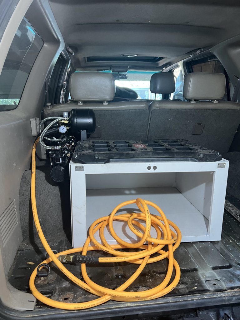

    Decided to turn an old printer stand into a pack out mount/storage box/on board air hub/wiring conglomeration. Found two Vevor ARB knockoffs listed wrong on eBay, so I pickup up two at half price. Was able to use 3/8” air hose for everything, but I doubt I’ll see any difference. I’ll mount a spare upright next to the box.

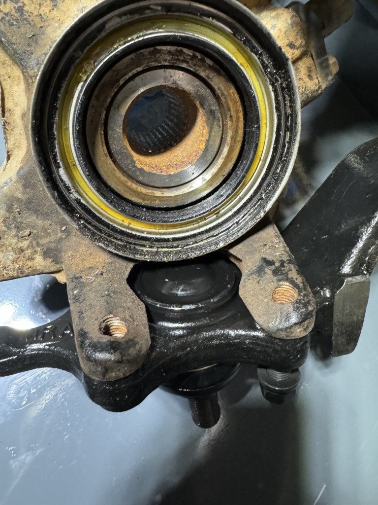

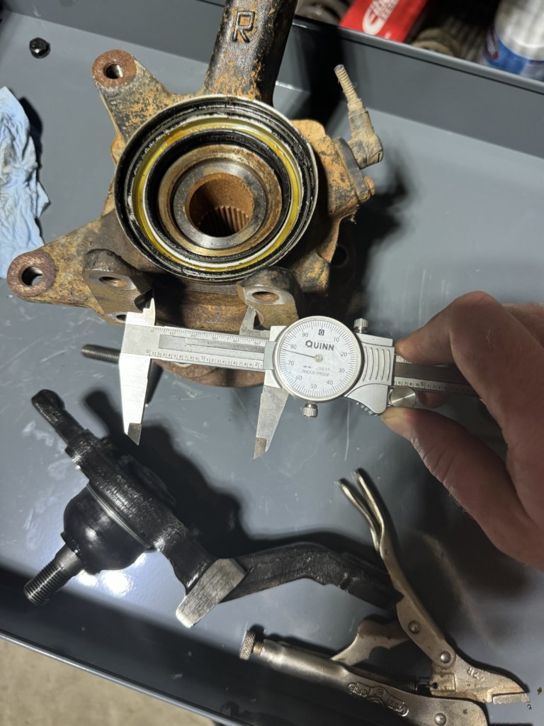

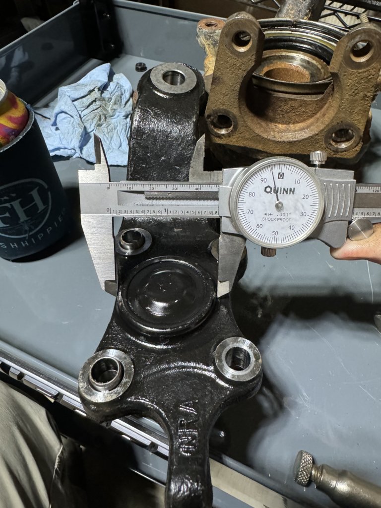

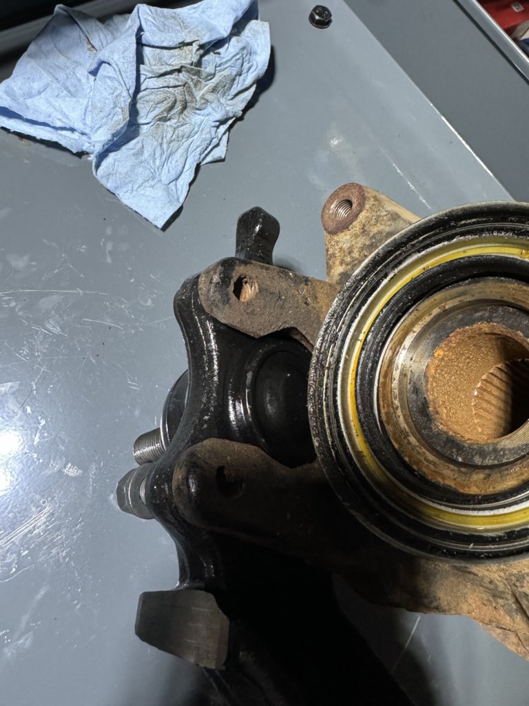

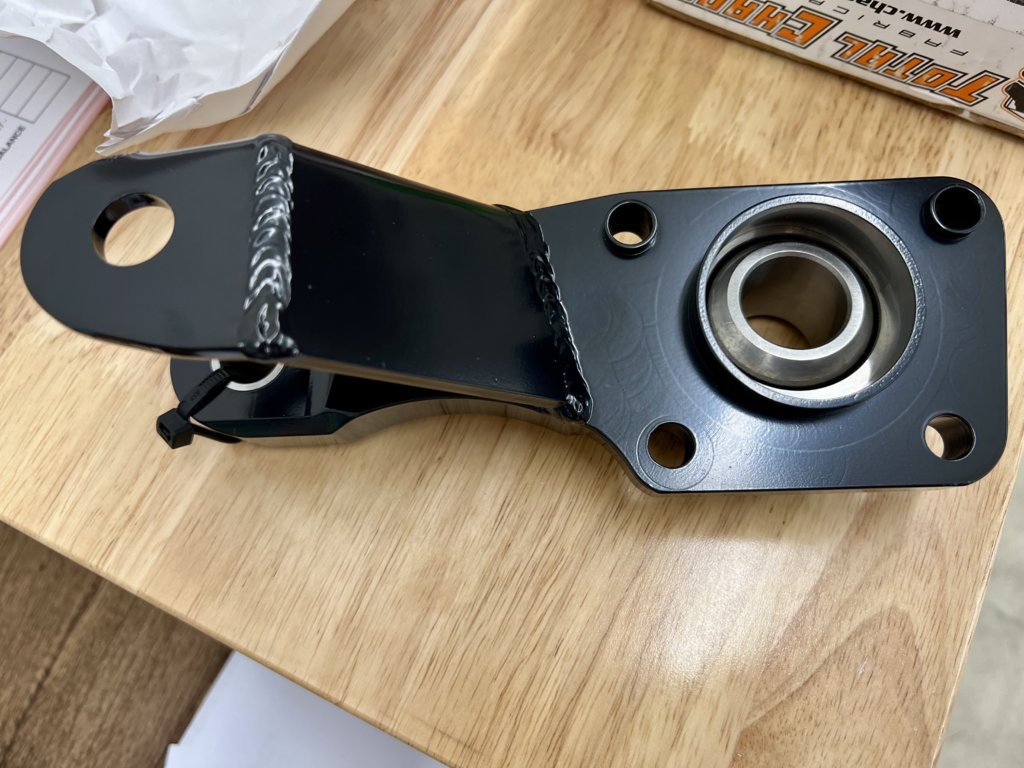

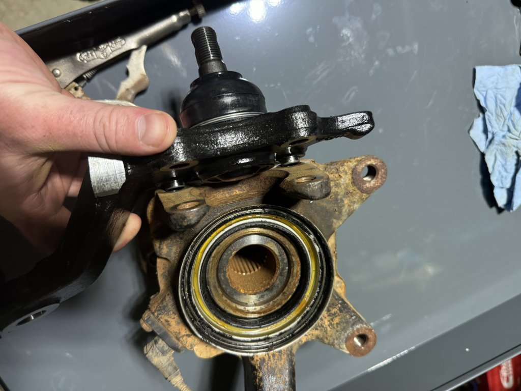

    I was on the fence about these uniball conversions from TC, but they seem to be a really solid upgrade. Will see how the ring mates up to the spindle. Should keep a lot of side load off of the four bolts.
    sparkystaco, JTFisherman and colinb17 like this.

    I had a guy that was lecturing me on the tc conversion suggest I safety wire the bolts as well, which is not a bad idea to make sure they arnt loosing preload or coming loose.
    he didn’t think people shearing all 4 bolts was a thing, he said two come loose and they only shear two. I know I sheared all four of mine but he thinks one of my bolts was loose.
    @theesotericone how many times did you shear bolts and was it all 4 or were some bolts often unaccounted for?

    How’d he recommend adding safety wire? Drilling through the bolt heads or another way I’m not thinking of? Speaking of bolts, these came with 10.9 zinc coated similar head to OEM I think. Torque spec was in the 60’s maybe. Really want to see if I can press in new uniballs when bolted up, and I might just weld these to the spindle in a couple spots. Not sure I’ll really put these through enough to justify that, but we will see.

    That’s weird to me the TC came with aftermarket bolts…
    I swear forever they were saying we use oem bolts because they are the best.
    Either way, read that article by spiked engineering on lbj bolts and I would steer away from anything not oem or arp
    im kinda thinking about buying a safety wire drill rig for the bolt heads, I can do a few for you too if I do, just need to decide if I drill the oem washer bolts that are 2.50$ each or the arp bolts that are 5$ each
    arp are 12 point and they don’t make 12 point specific safety wire drill rigs but they do for 6 point

    Do you know if the factory ball joint hugs that circle cut out in the factory spindle? I’m out of town or I’d check mine. If the TC ones are as tight of a tolerance as they say I think that’d help cut down on a lot of stress.
    I read that article and the factory bolts seem best for sure. I have some I bought new beforehand. I’m going to beat the piss out of it on my trails before taking the family out in it so maybe I’ll get them to snap haha

    Factory lbj doesn’t really have any contact there.
    that guy told me the TC is super tight in the spindle, I feel like their index cones on the outer bolts arnt as nice though.
    I think the index in the center is nice but idk how much it would help depending how they shear, if it is shearing with the kingpin axis it will just spin around that indexed circle, and if they are broken in tension from a hard hit then it will just lift off the top.
    would have to be shearing front to back. Or turning then hitting steering stops then shearing them off by pivoting off the steering stop

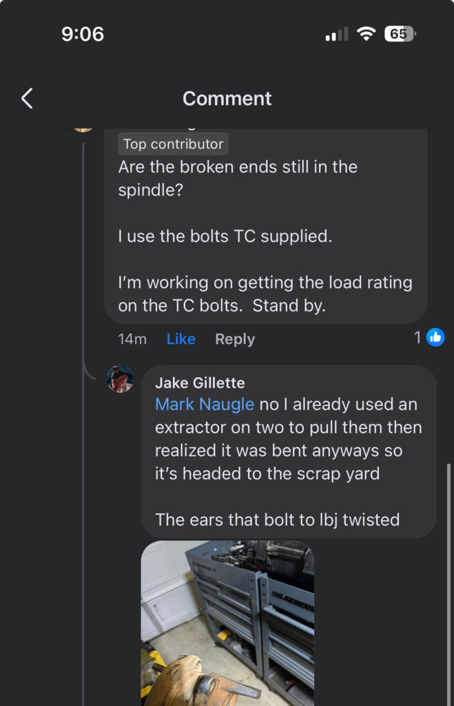

    Also I’ll let you know on this

    That’s a good point. I’m curious to see how they hold up. If it wasn’t for the double shear and reaming out OEM ball joints every time I had to change them I’d stick with OEM. That and pressing out a cheaper uniball are good incentives, but maybe not $1150 worth on their own haha

    What happened there?

    He is going to get the tc bolt load rating if you want to use those

    Oh I gotcha. I was reading your message below and thought he broke his, too. I’d bet those TC bolts are reg ass 10.9’s nothing special. Really curious about just stitch welding a section and calling it a day lol somewhere easy to cut apart if need be.
