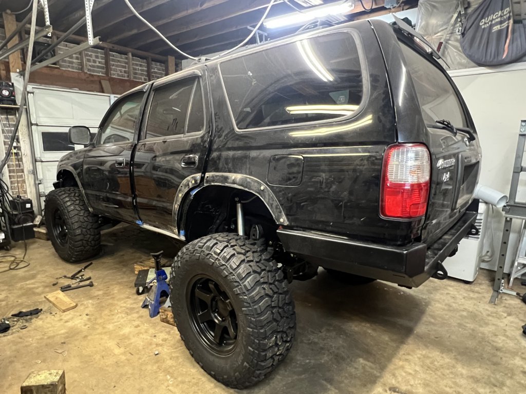

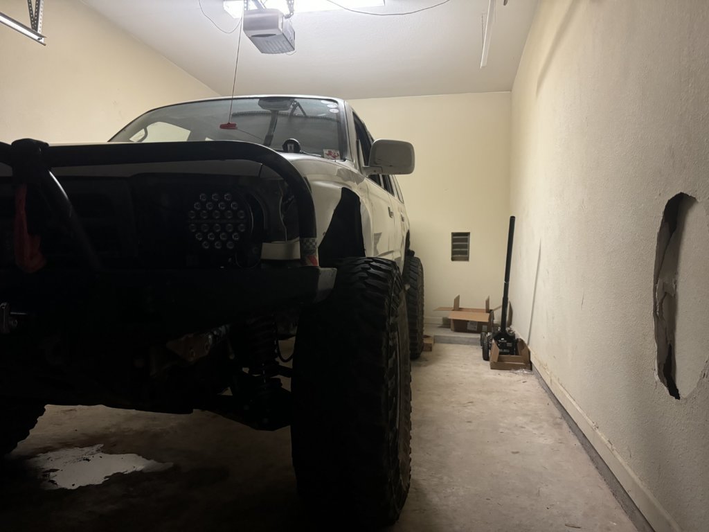

    On the ground for the first time. Still a lot to wrap up. @JTFisherman ass end is high. Can’t tell if the front is too low, too. I have no good reference point since it had a shitty RC lift when I got it. I have about 100 lbs to add to the rear, but I don’t think the 861 will pan out. Know of any longer lighter coils? Maybe stock with a spacer if it doesn’t coil bind? lol

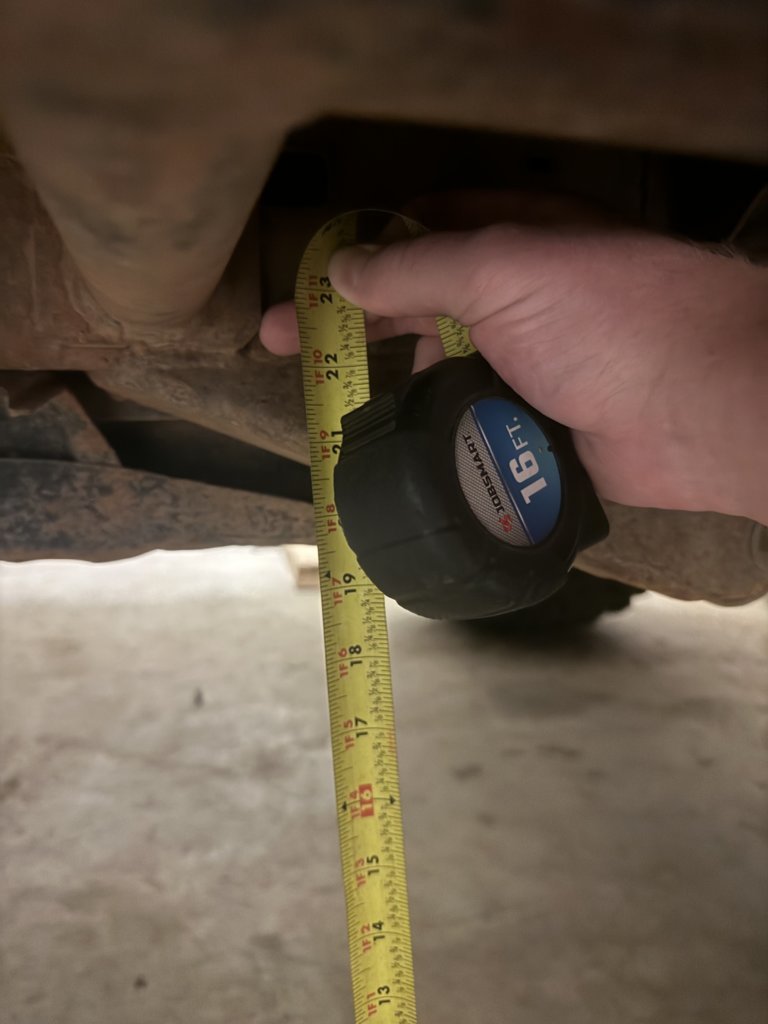

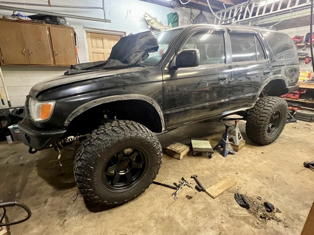

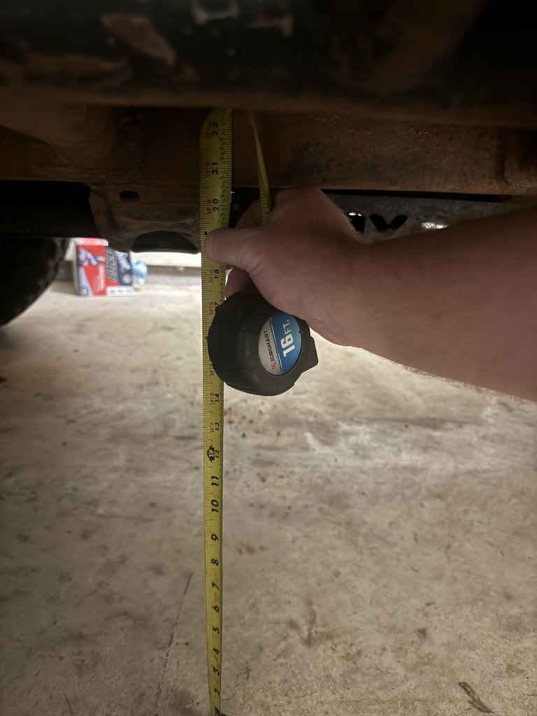

    Superlift 580?
    idk what free length was but pretty sure it was atleast that of 861 and it lowered my rear bumper 3/4”. They should be on Amazon so easy return. I do have more weight probably with s
    did the rear lower any when it came off stands?
    For height, included pics of 37s and 35s at two ride heights, sorry to clutter up the thread haha 37s are after raising 1.5” ish it when it was too low on 35s I’m happy enough with this ride height, would lower it a touch maybe with 37s, but don’t want to with the rake.
    when I had 35s it was a little low before I raised ride height. scraped a decent bit but the rake bothered me more.
    my hub is 17 off the ground and frame behind front tire is 21.5 in front of rear tire is 22 right now
    37
    35
    This one shows better how low it was to me
    Frame

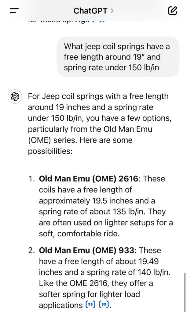

    @JTFisherman thought I’d give AI a shot lol the OME 2616 might actually work…not sure if wrangler coils will fit though. Do you know? Also, I can’t find rate info on the superlift coils anywhere. Still surprised the Rusty coils at 20” and 160 lb/in didn’t sit closer to where the 861 do. Also, no way in hell anyone is cycling 14” without the coils falling out on 861. No more room for uptravel since the upper link hits the round crossmember

    man that might be getting close to too light.
    My rear is 2400 unloaded - 200 for tires, -200 for axle and -100 for misc. leaves you at 1900, so like 7" of compression which doesn't seem too bad i guess. I can measure my 861 length at ride height tonight to compare
    Will be really loose in the rear though, i would want a sway bar probably

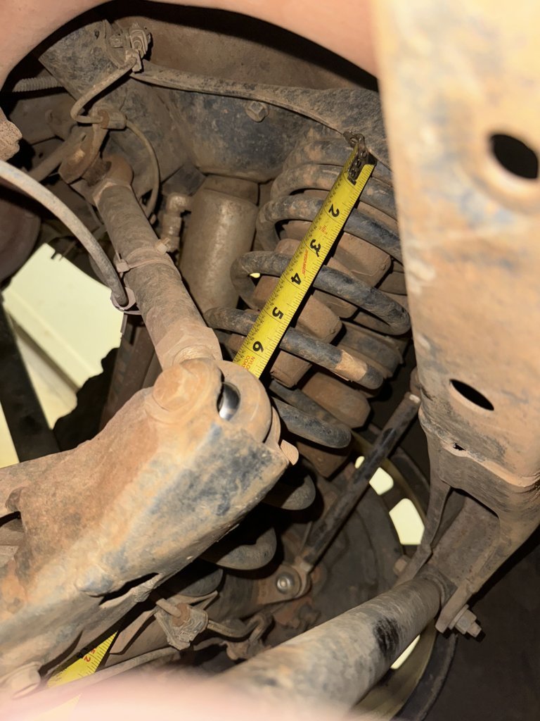

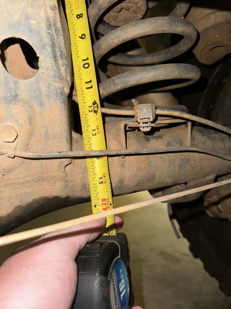

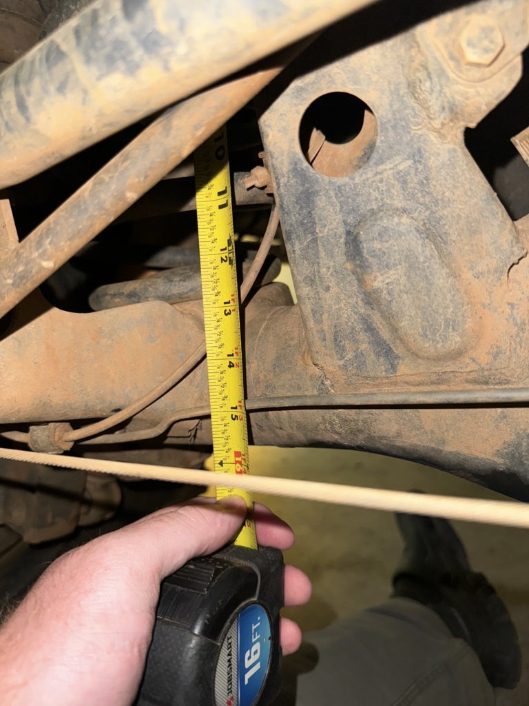

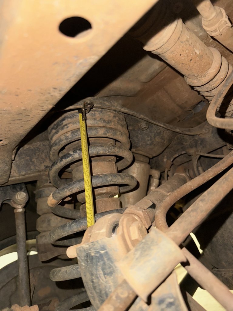

    Maybe add an inch to this because it is on that metal bracket not the top of spring.
    I also do have the coil isolators in if that matters.
    so probably 13.75 ish spring at ride height both sides.
    Passenger

    Just measured mine and it’s 15” with nothing in the trunk so I’m not far off by any means. Going to play it cool and see what’s what with sliders, skids, tools, parts, spare etc. maybe the 1” body lift is making it so much more dramatic?

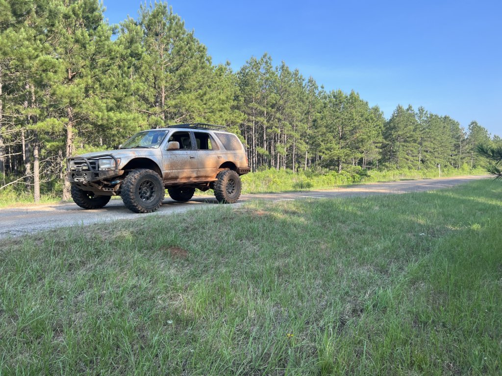

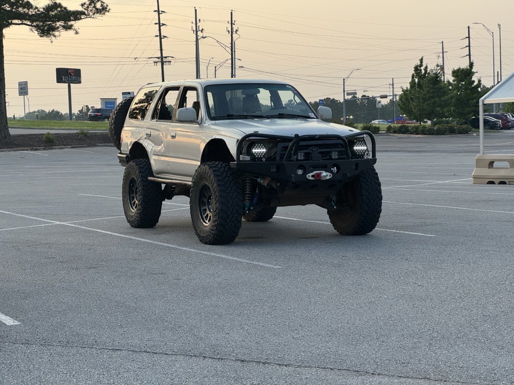

    idk, wouldn't expect it to look as different as it does since my fender is cut then rolled up a good bit too. I think the giant front fender cuts on mine really make it look more level just because.
    Doesn’t look like your are really far off these guys.
    This one has a 1” body lift and 35s. looks like a good bit more suspension lift than me too
    pretty sure no bodylift on this one, 35s I have wheeled with him and it does well, I just like stuff low with big tires lol
