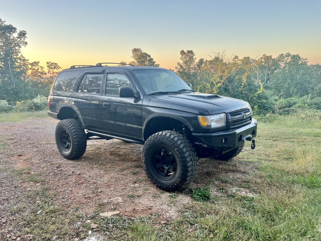

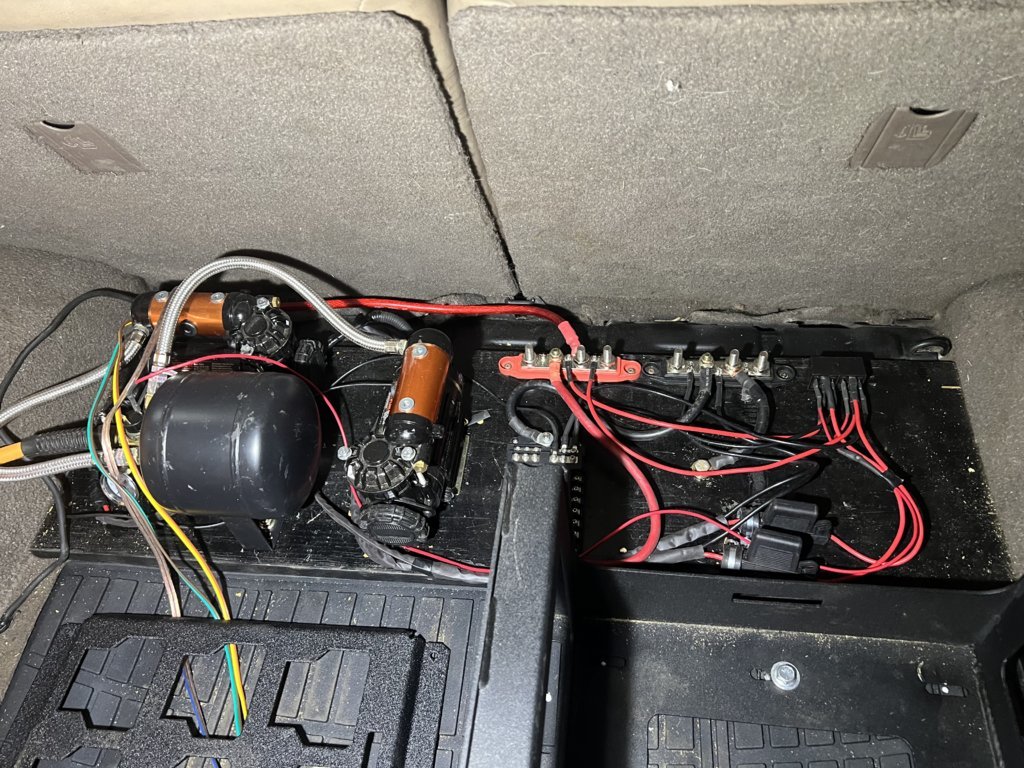

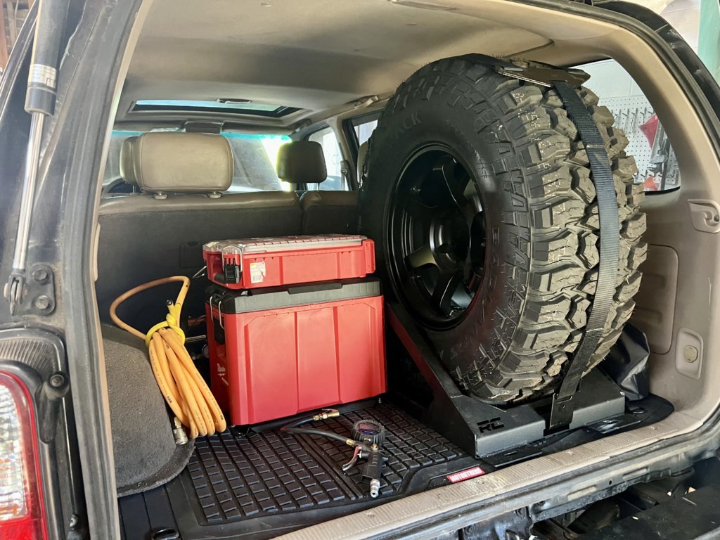

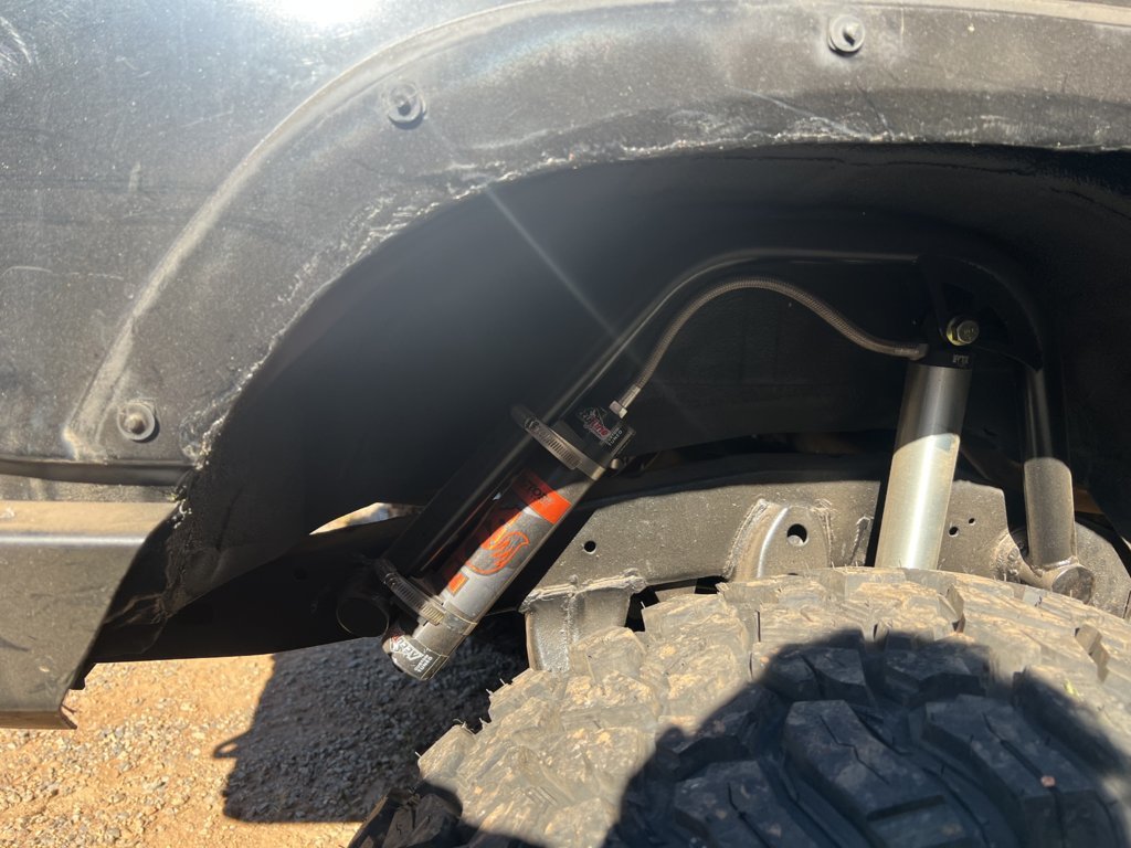

    Finally out of the garage. Hopefully I’ll lose some height with the LC coils. Also missing about 75 lbs back there. Had to change up the rear layout. Went with a rough country tire mount because I’m tired of making stuff :rolleyes:

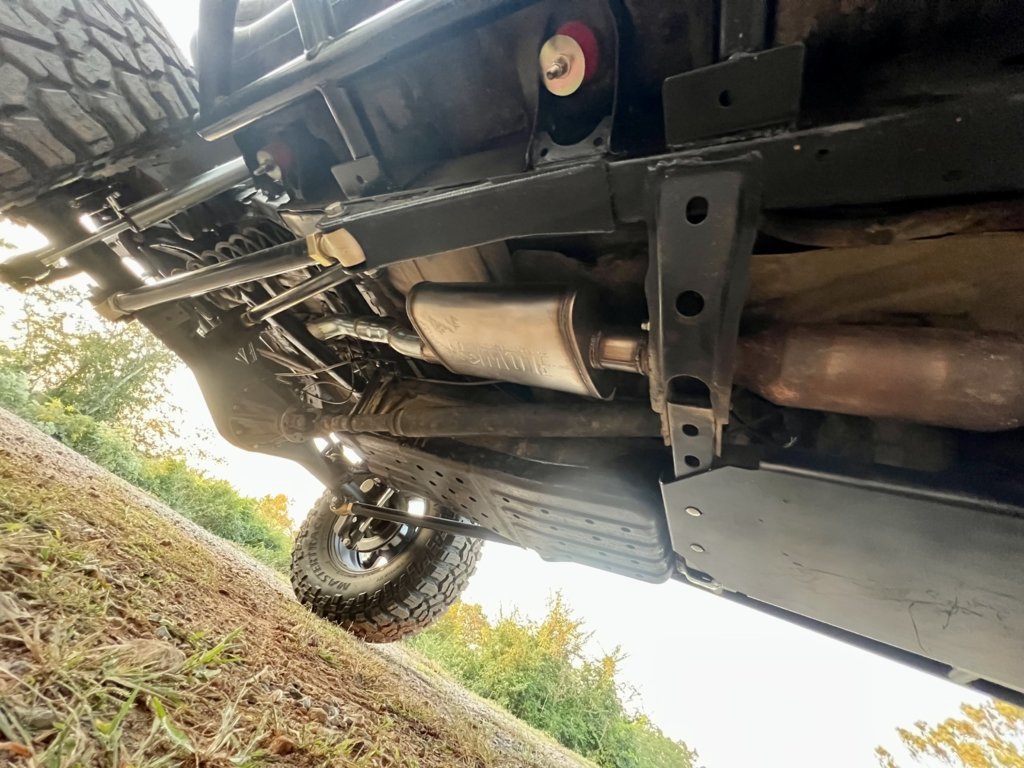

    Testing things out a bit. Exhaust dumps right on the rear axle and Johnny joint which I’m not happy about so I’ll be changing that. So far it’s a blast, but have some fine tuning to do for sure. Also lost my speedo which I’m guessing is from ditching the rear ABS sensors when converting to disks. Not sure what to do about it.

    My Speedo went in and out once in heavy rain but 99% of the time it works and I only have front sensors attached.
    also you have to redo exhaust for the 3 link? I might bother you for some pics of the layout because I might be cutting into mine this winter.

    Maybe my fronts are dead. I’ve got a couple new ones to try. You do have to reroute the exhaust. I originally wanted to go all the way back, but I hate exhaust work so I just dumped before the axle. Not early enough apparently because the housing was so hot you couldn’t touch it haha. I’ll snag some pics, but it’s nothing fancy. Just a compact muffler and turn down right past the bolt junction around the middle of the cab

    @JTFisherman here’s my exhaust hack job. I will do a turn down right past the muffler instead. Hope that helps

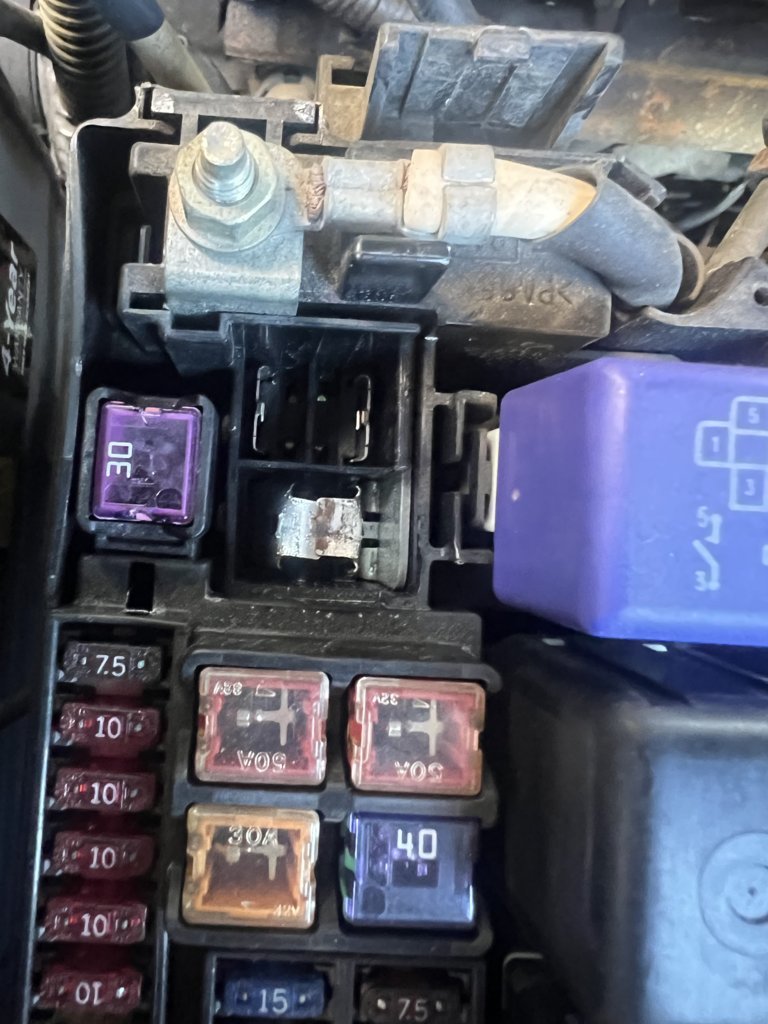

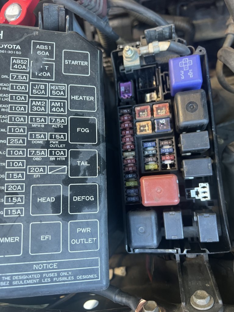

    Probably why I have no speedo. Also love the short on the alternator fuse. Not sure if these are fuse prongs stuck in there, but I can’t get them to pull out and I’m scared of using too much force.
    edit: I see that they’re fusible links and bolt in from the sides. Cute.

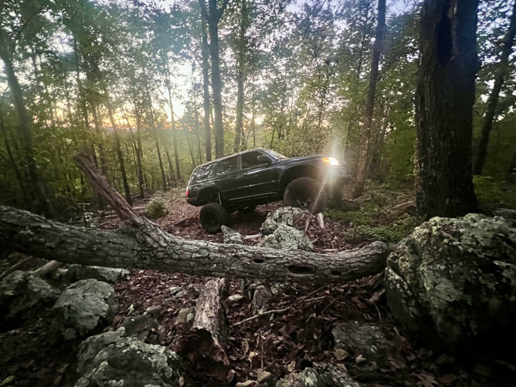

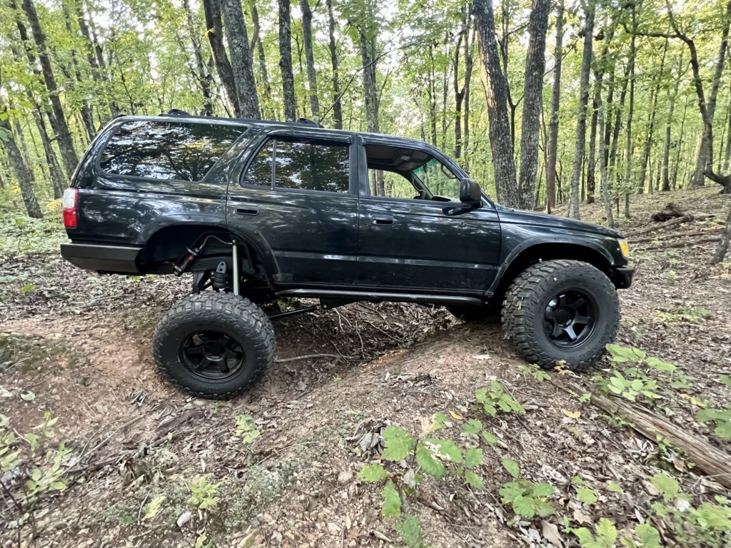

    Evening ride on a rockier section at the house. Holding up pretty well so far. Not pushing it until the diffs are broken in. Skids are getting broken in pretty good though lol Speedo and odo still not working with a fuse in…not sure what my next step is

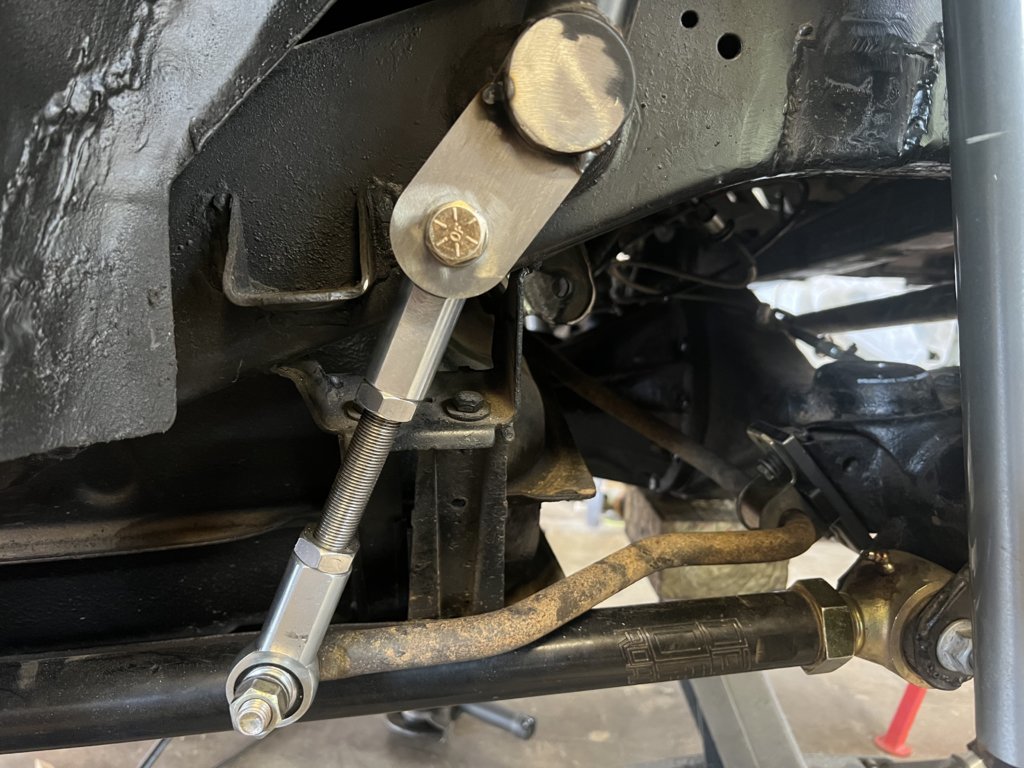

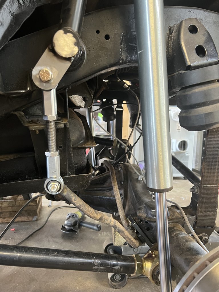

    Thought I’d try cycling the stock sway bar with custom links/spacing/mounts before trying a stiffer aftermarket (OEM fit) bar. So far so good. Hard to fully articulate it in the garage, but what I could works well. Welded it all up and will see what’s what in the ground.

    Got it on the ground and it cycled smoothly without binding. Didn’t do much for the front, but hopefully a stiffer bar will. Can’t find any specs other than the bar is 1” thick, but this seems to be my only option so I’m going for it-
    https://www.addco.net/product/toyota-4-runner-1996-02-rear/

    After emailing ADDCO, their sway bar for the 3rd gen is 206 lbs/in and the stock is 55 lbs/in. I haven’t crunched any numbers, but since this is the next logical step we will see how it does. I can tell a bit of difference with the stock bar on, especially normal driving. Hoping the ADDCO bar doesn’t snap or anything though. Will be asking a lot of it with 12” of travel
