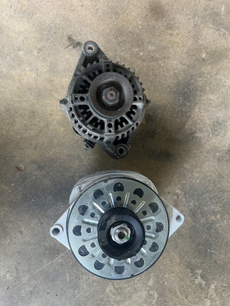

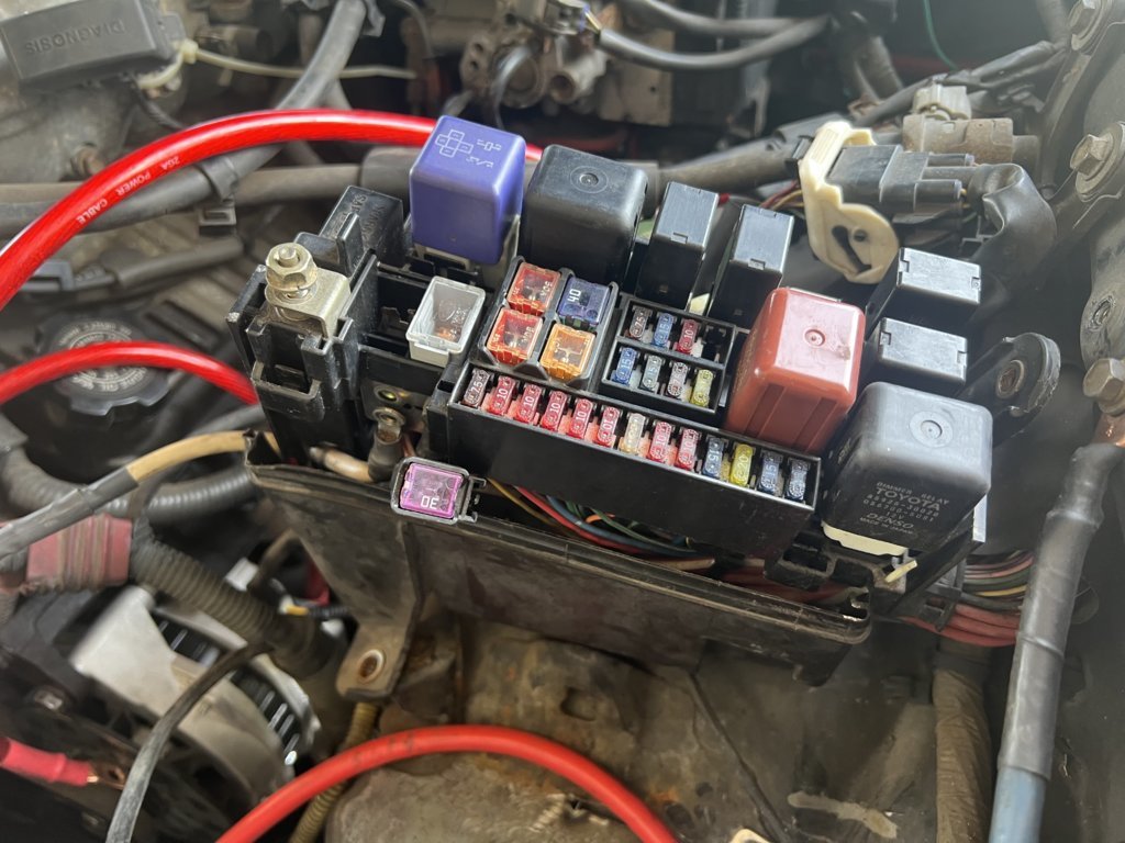

    Cadillac alternator upgrade and replacing the blown ABS and alternator disable links (not fun)

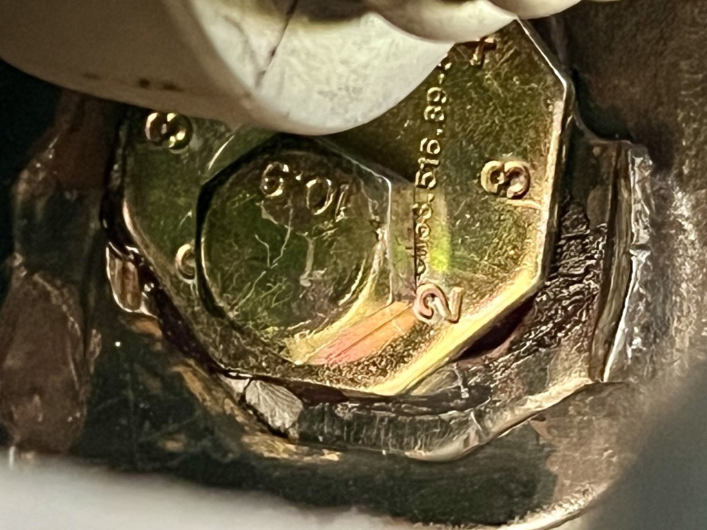

    didn’t take long to flatten the cam tabs @JTFisherman any recommendations? Still don’t have speedo or odo so I’m lost on a fix for that. Also my gas tank pours out from the top on an incline which is cute, so I’ll be investigating that as well.

    KPO is the best kit from what I have seen. Mine has been sitting for a long time but I was going to try and weld it today.
    their bolts look the best as well. Stover nuts which I love and the bolts are cut down to fit better without having to monkey with the steering rack.
    even my tabs arnt that bad, wonder if it is because I can clamp the bolt down on the metal misalignments super hard.
    I have never leaked gas to my knowledge but had a guy in a gx who was leaking it bad a few weekends ago, seems like some sort of vapor lock with the charcoal canister in his case but idk with ours being up front.

    I debated welding a bead behind the tabs while I had everything apart. I regret not doing it lol May cut some square pieces to replace the factory “wing” parts with.
    I give up on the speedometer. I think I’ll just get a gps unit that keeps up with the odo as well.

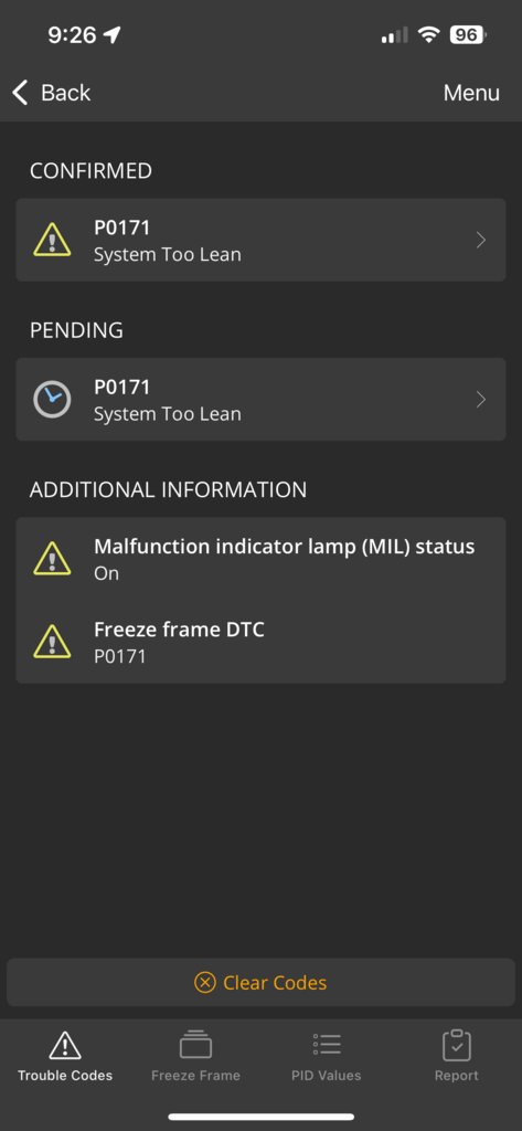

    Running lean. May be the aftermarket intake? MAF sensor? Got some digging to do

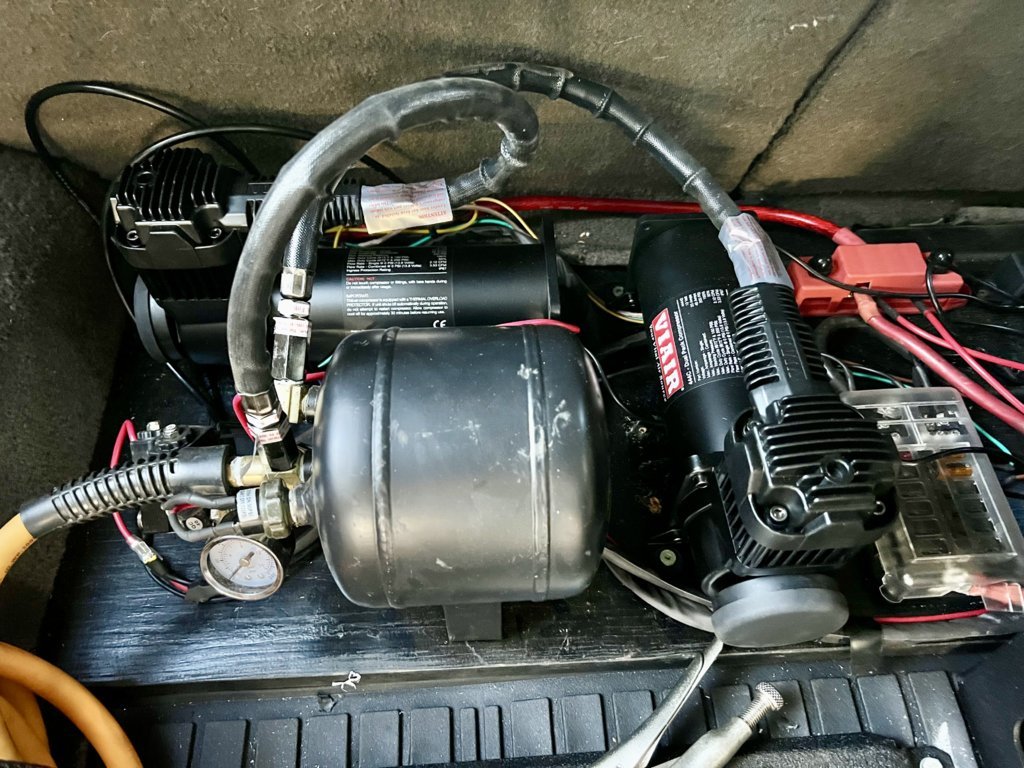

    Well the two cheapo Vevor air compressors pooped the bed after filling up all four 35’s. That’s what I get for cheaping out. Went with the tried and true two pack of Viair 444c. Should have done that the first go around.

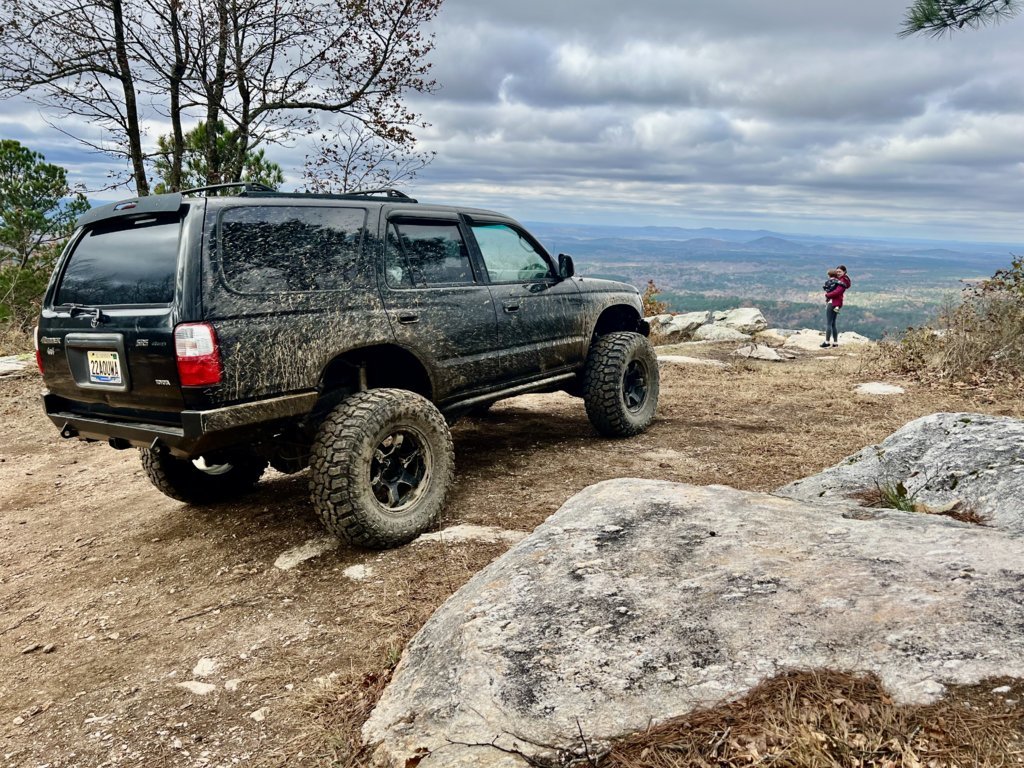

    Took the 4Runner out on its maiden voyage. Nothing too crazy. Forest roads and some side trail crawling. So far so good. Very plush and the steering is getting better on the road so I’m thinking it must be all the new heims wearing in.
