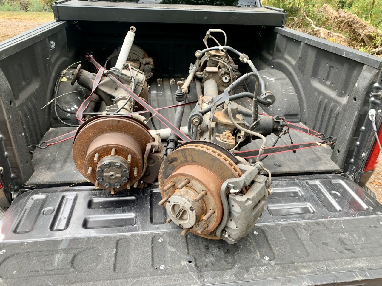

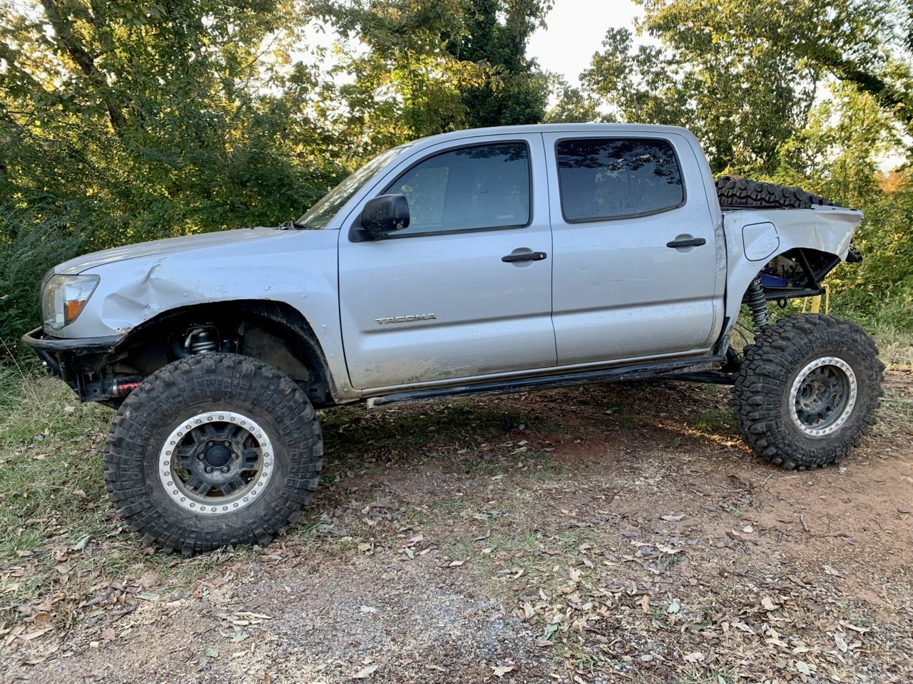

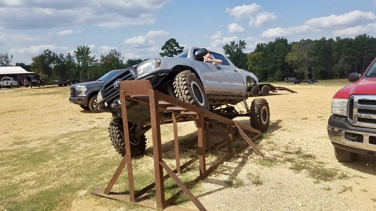

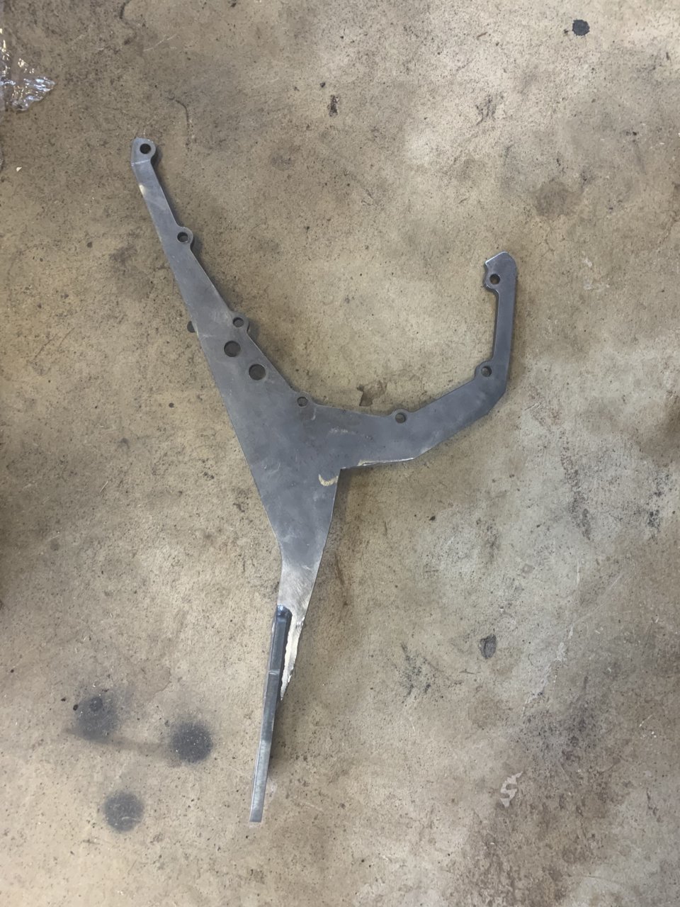

    Starting the SAS/buggy build. Picked up the super duty axles this morning. Leaning towards four link, full hydro and 43’s. Probably stretching out to 136”

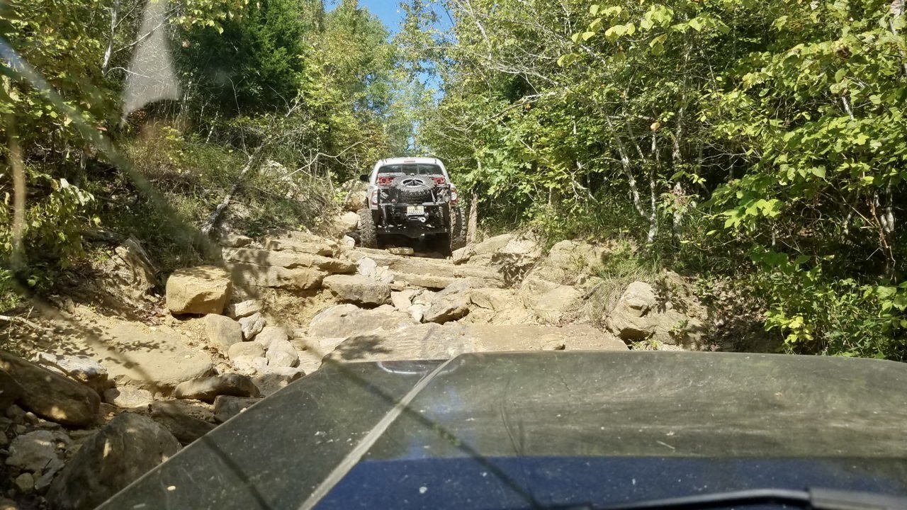

    Guess I forgot to add a trip to hawk pride in September lol

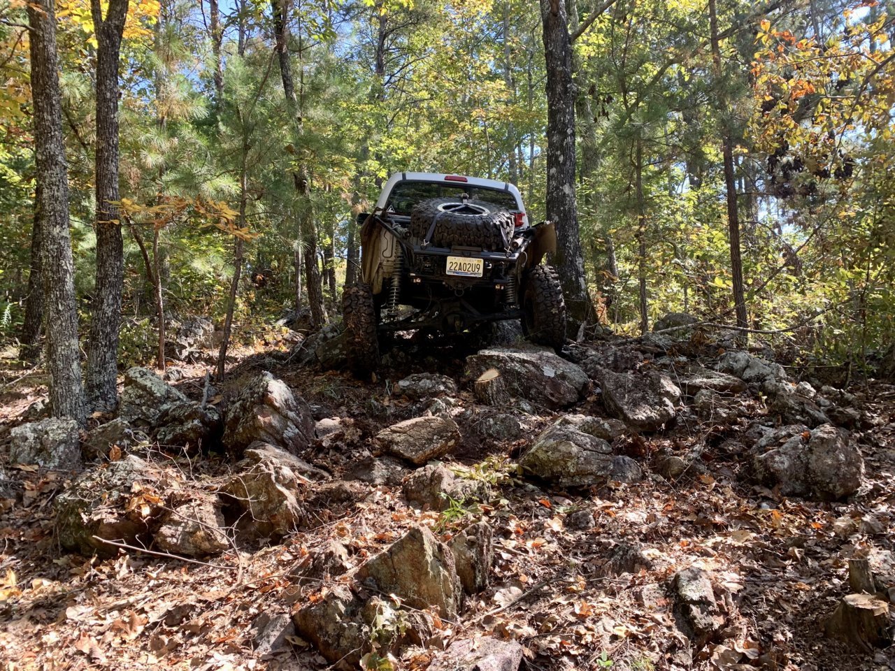

    Also some light wheeling at the homestead on a freshly cut trail. Little extra body damage before hanging up my hat for a bit. Last IFS run before SAS.

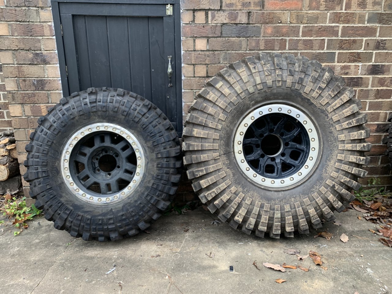

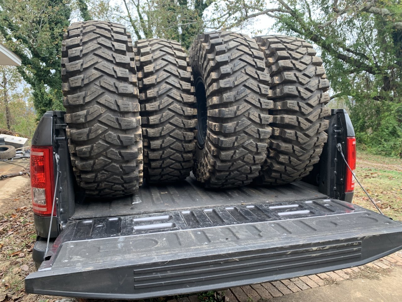

    I originally wanted TSLs but found a really good deal on these 42” treps on dirty life’s. Little bit bigger than my old 37’s haha

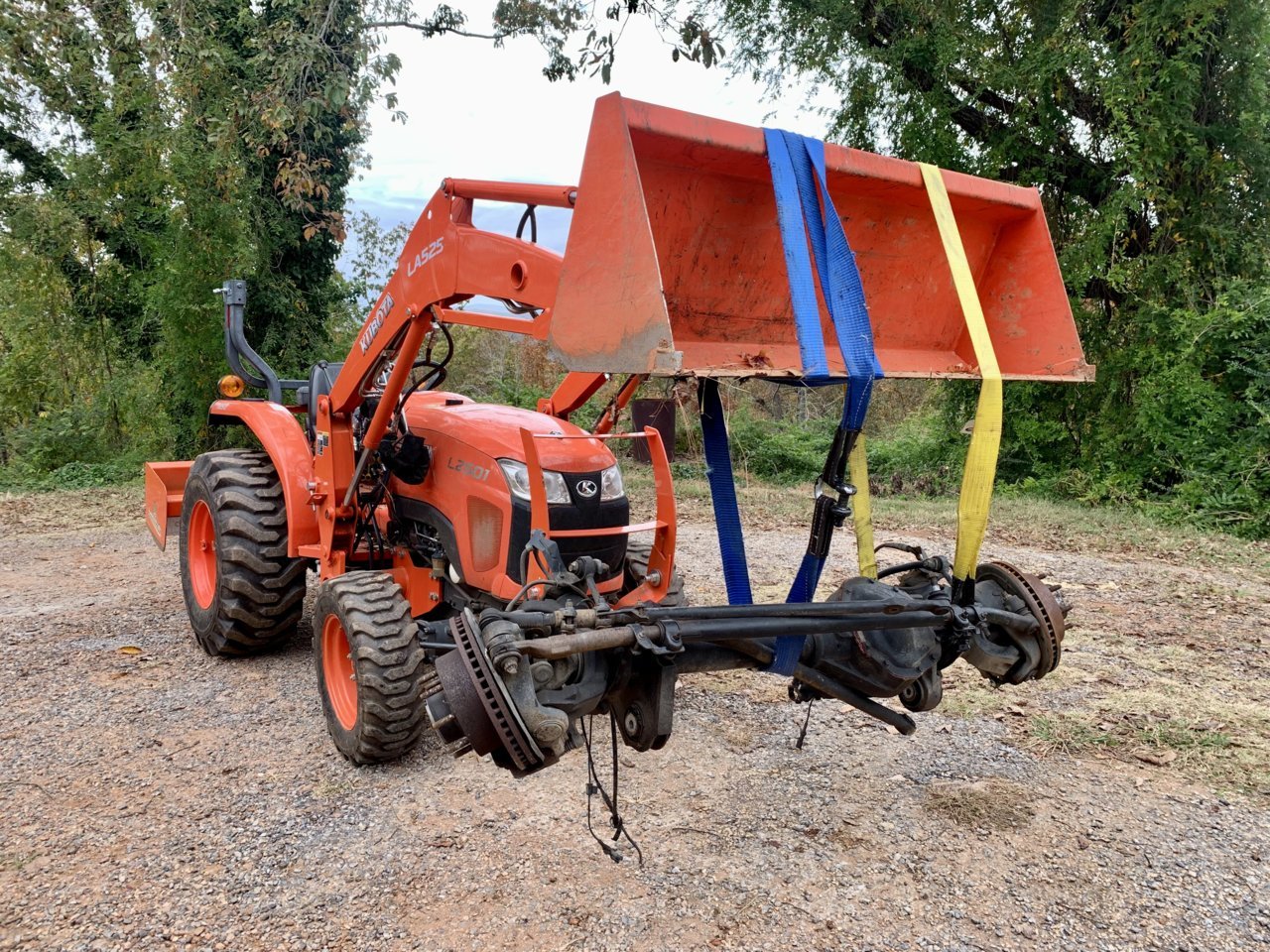

    Found a few hours to work on trimming down my axles. Barely feels like I did anything. Not a process I want to repeat, especially when it’s 30 degrees outside.

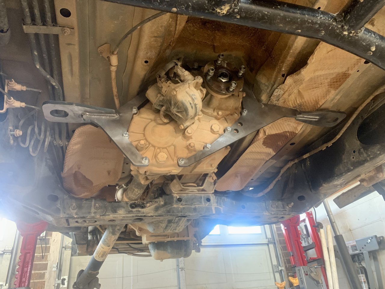

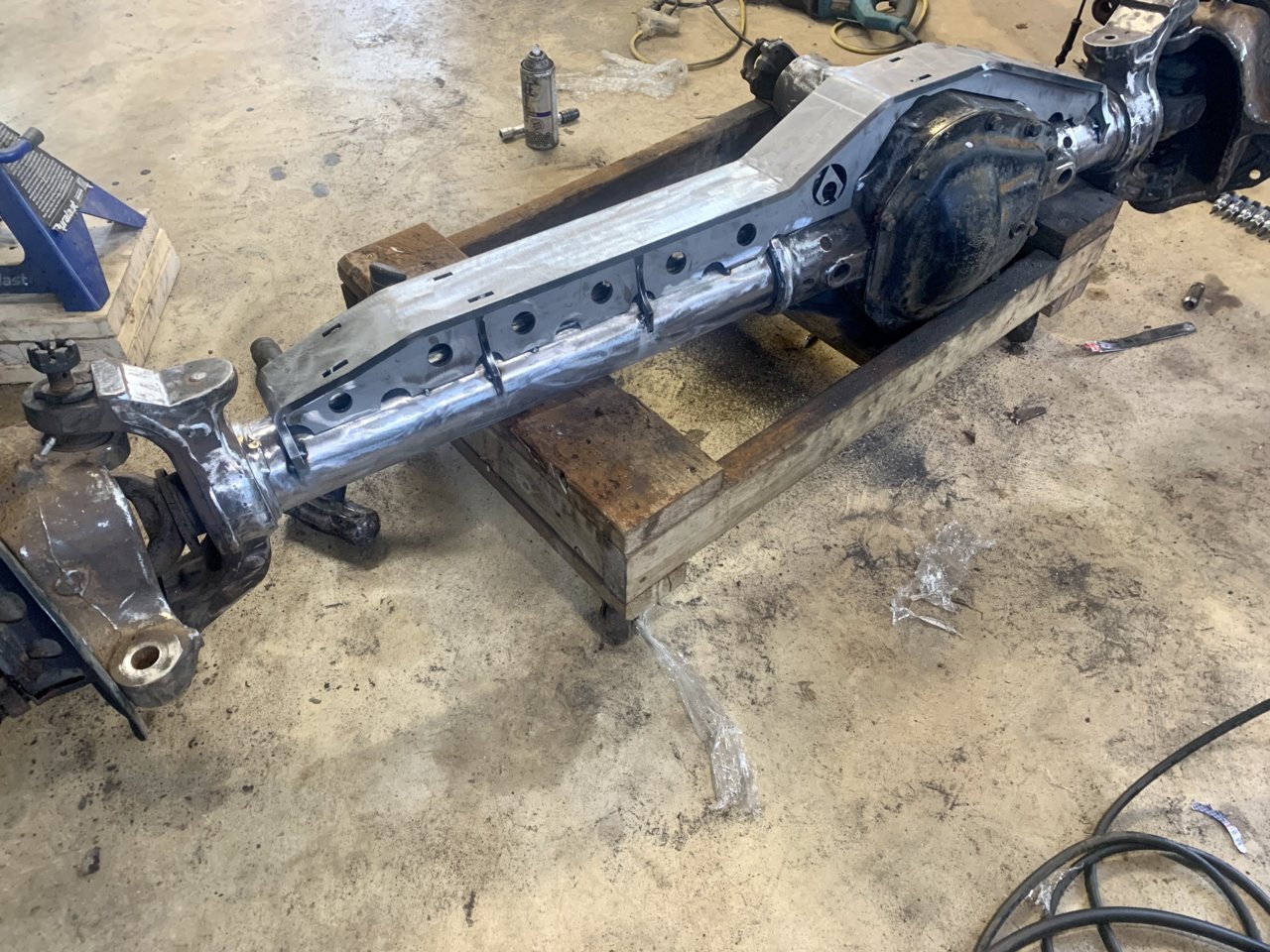

    Axles cleaned up, truss tacked on. The 1st gen trans crossmember took a little trimming. The bushing mounts are too close to the cab, so I’ll be using a diy crossmember mount from Barnes or similar to mount it to the frame.
