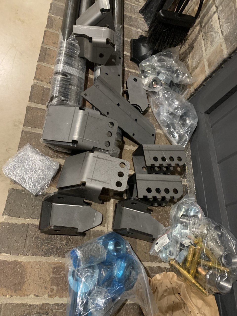

    I went with Artec for the trusses, but everything else pretty much will be Barnes. I went with RuffStuff on the rear, but Barnes was more economical for what I need. Just ordered their basic hydro mount, clevis/tie rod, and high steer stuff today.

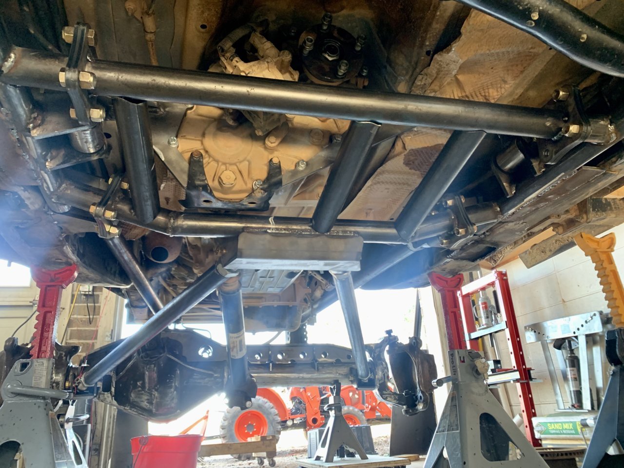

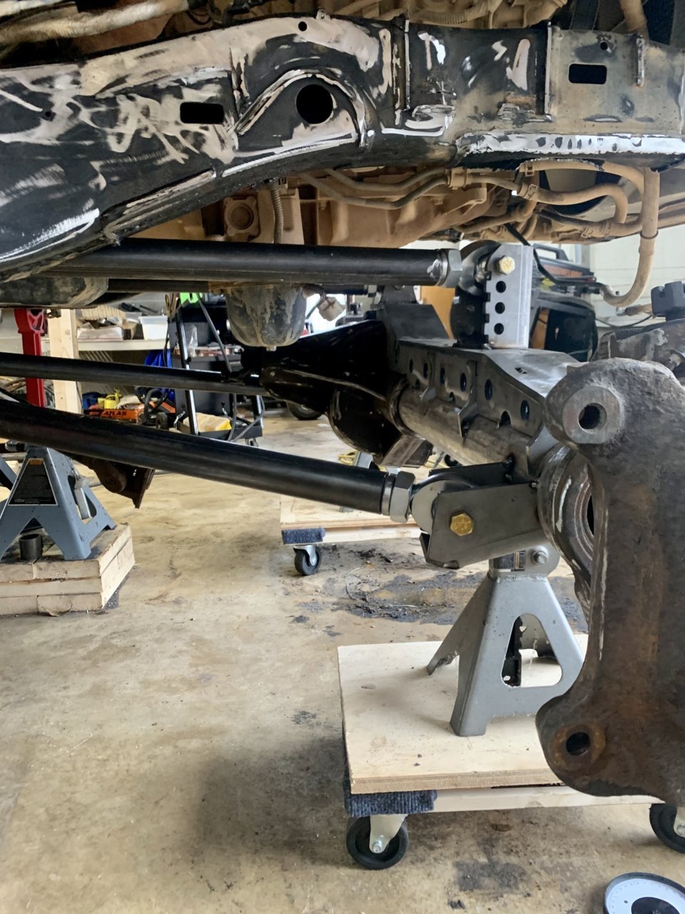

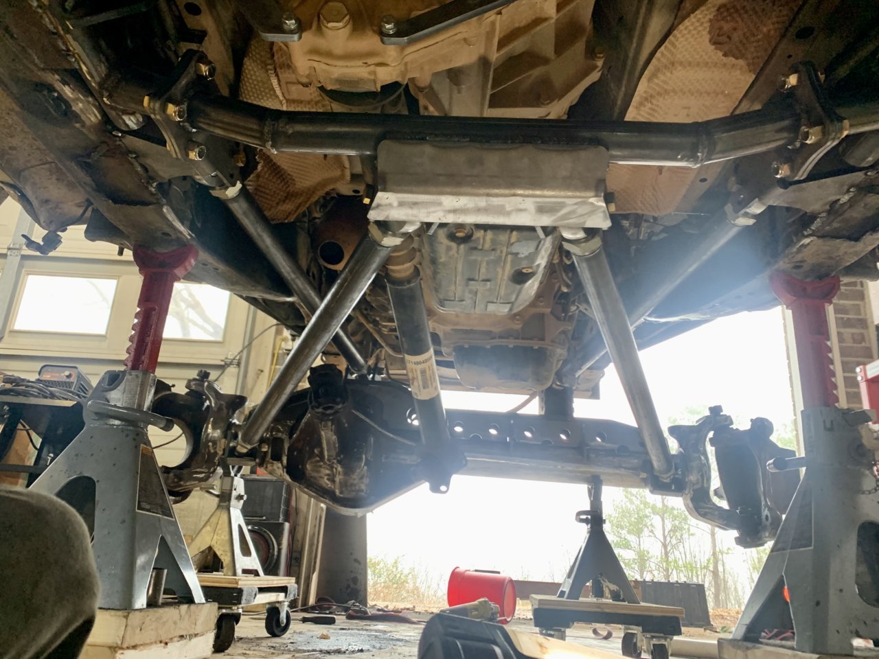

    Four link progress and cycling

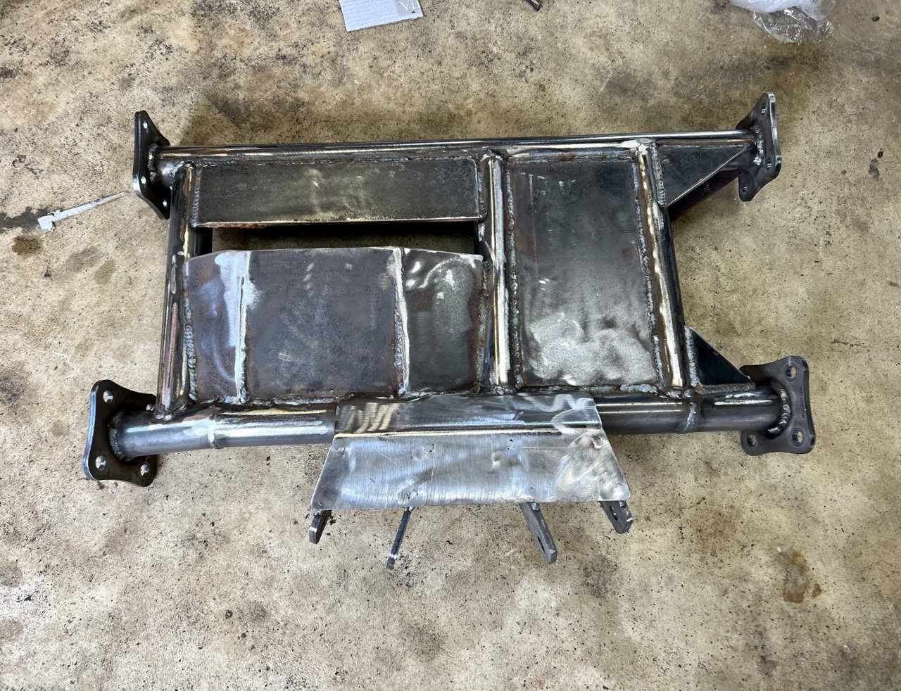

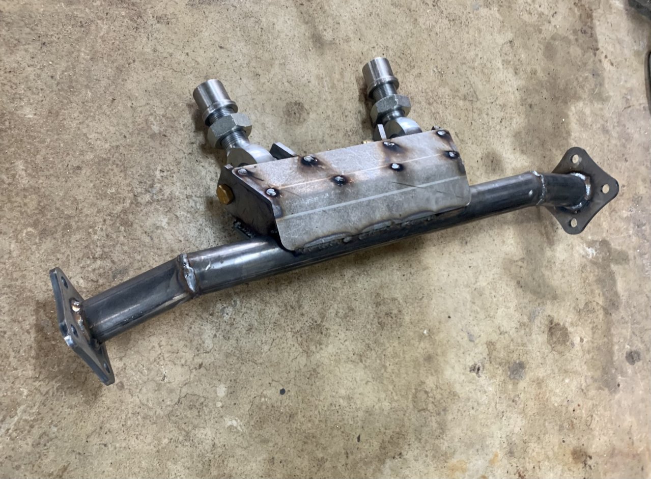

    More work on the removable crossmember. Will box in the right side and double gusset the left.

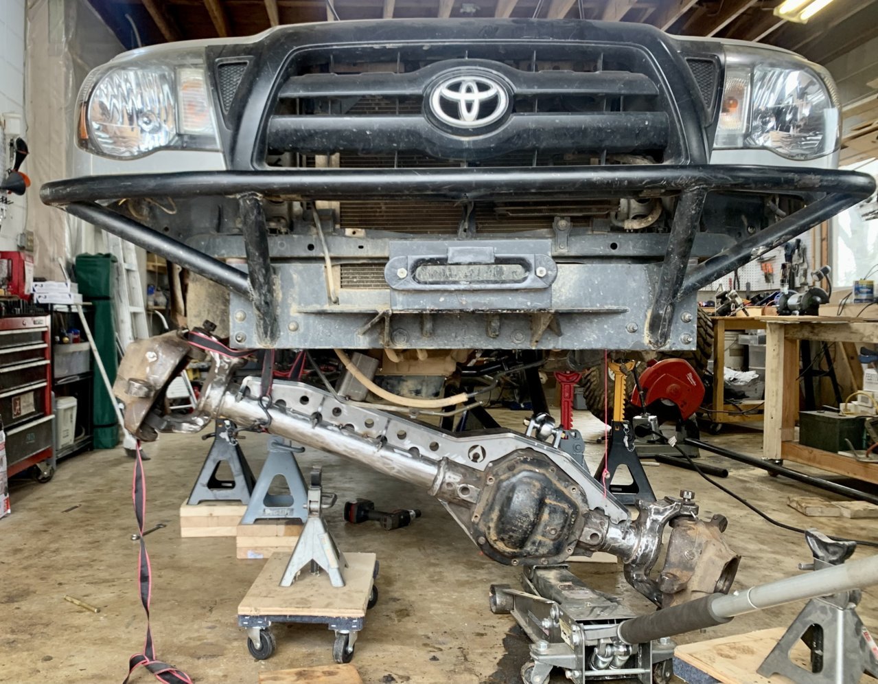

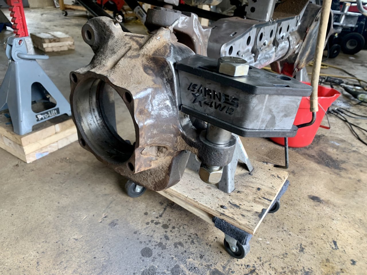

    Knuckles reamed out and slowly getting the steering tacked on. Not thrilled with how low the Barnes universal mount is. May try to trim it flat and mount it higher up

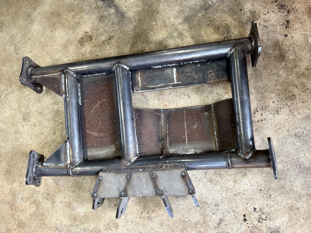

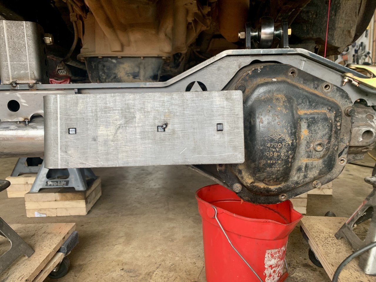

    Nothing fun, just a bunch of welding. Half of it was welded upside down, the other half is ugly because I’m not a good welder :rofl:as I stare at it, I realize the transfer case skid section needs to be angled so it won’t get caught going in reverse. Will leave a smaller gap for the plug.
