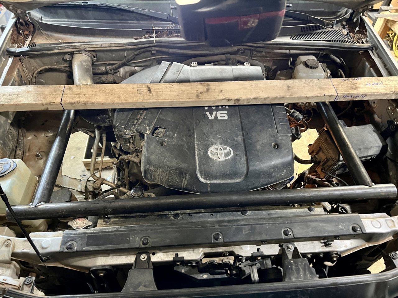

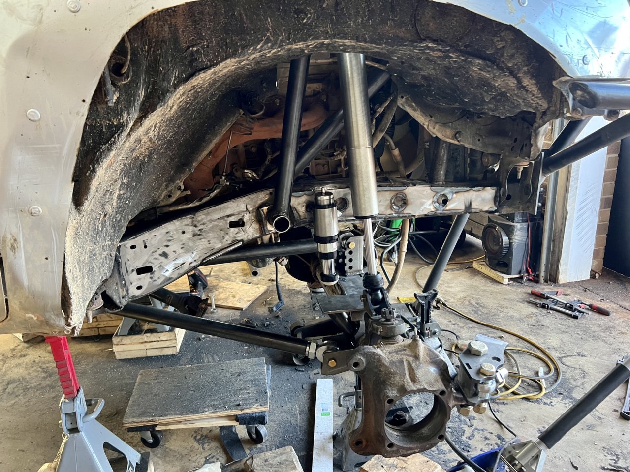

    Some progress mounting coil overs. Realized I’d need to build some mounts into the engine bay. Should be enough slack in the fuse box to push it to the side luckily.

    Spent 2.5 hours figuring out where to place that tube so I don’t have to relocate everything under the hood. Tube notches are starting to pile up on this build :rofl:

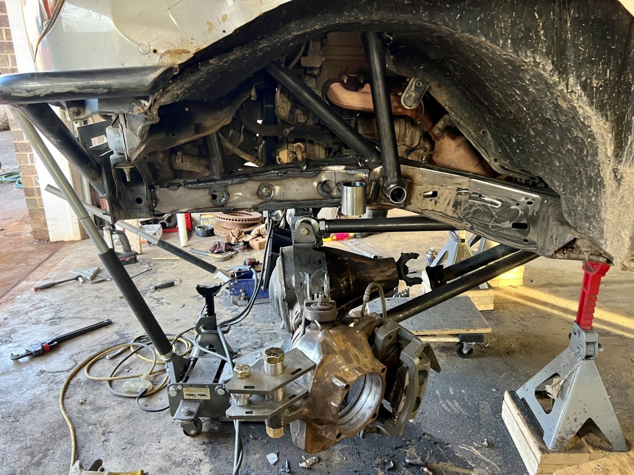

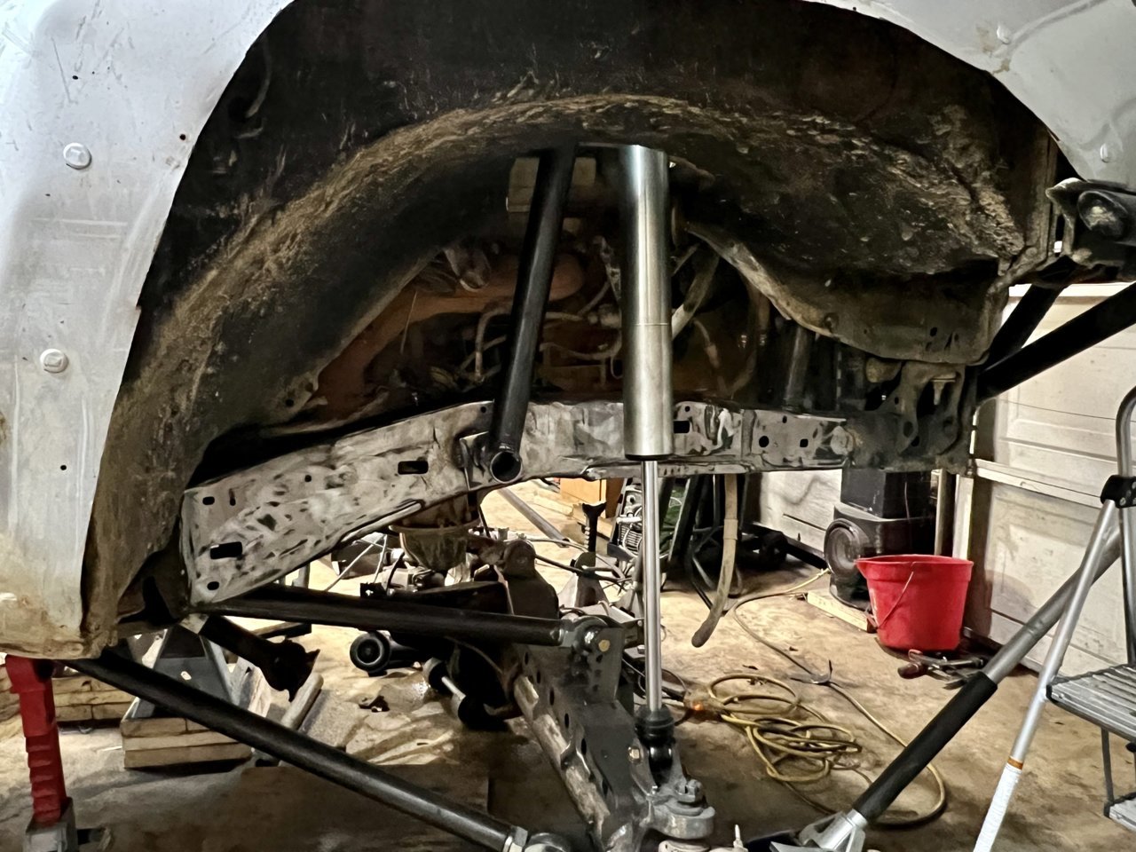

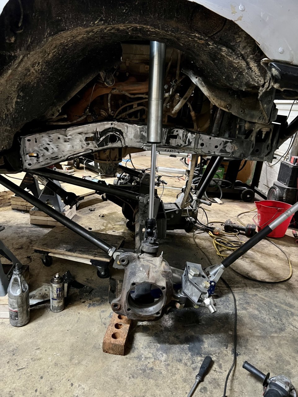

    Bumps and landing pad roughed in.
