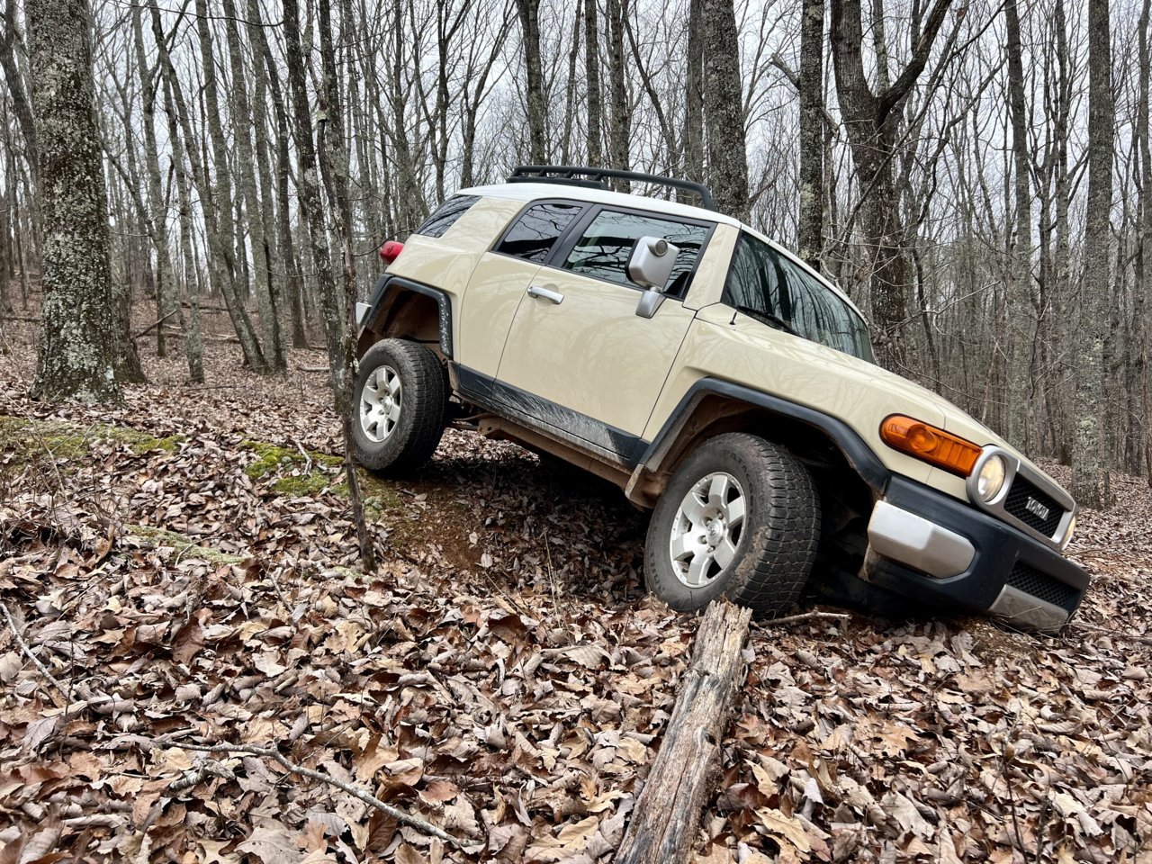

    My wife upgraded to a 4Runner since fitting two kids in the FJ was getting cumbersome to say the least. I wanted to keep the FJ as a good trail vehicle since the Tacoma will only be trailered. The short wheelbase is pretty rad. It’s pretty cool how capable these are stockish. Rear locker and A-trac make a lot of difference.
    Gotta ditch that front chin and make some skids, but that’s a project for after the taco is done haha it’s been fun to have something to ride around on our trails and make quick trips to the national forest. I miss wheeling and am ready to get the taco back on the ground.

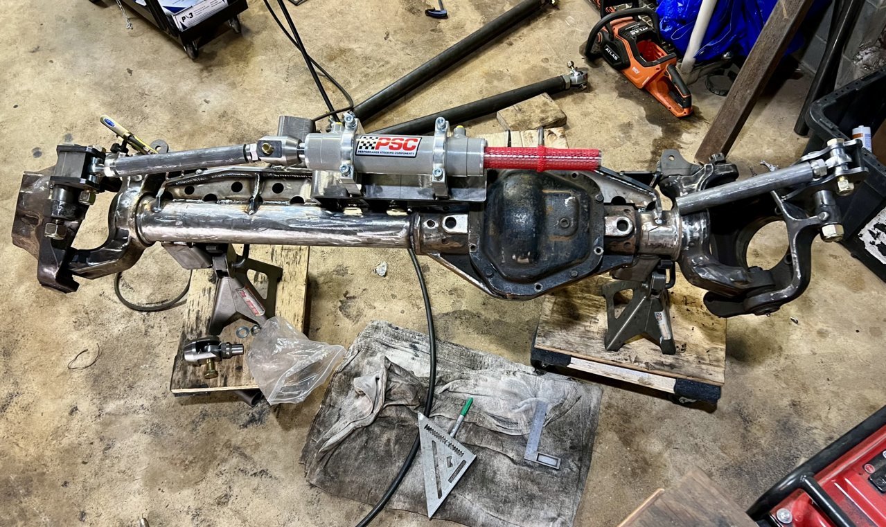

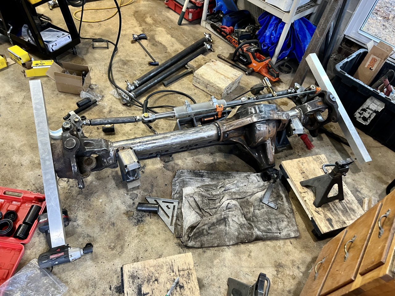

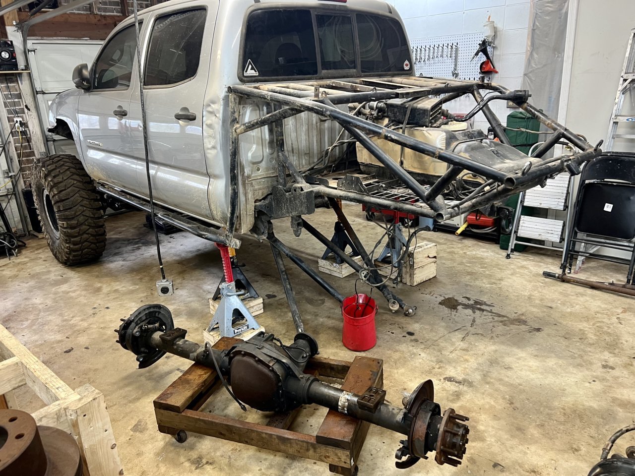

    Finished welding up the front axle truss. Welded up my DOM links. Engine brace tube cut, notched and bent but waiting on some tube flanges to make it removable. Tacking on the steering and figuring that out. Guess I need some air to move the ram to center.

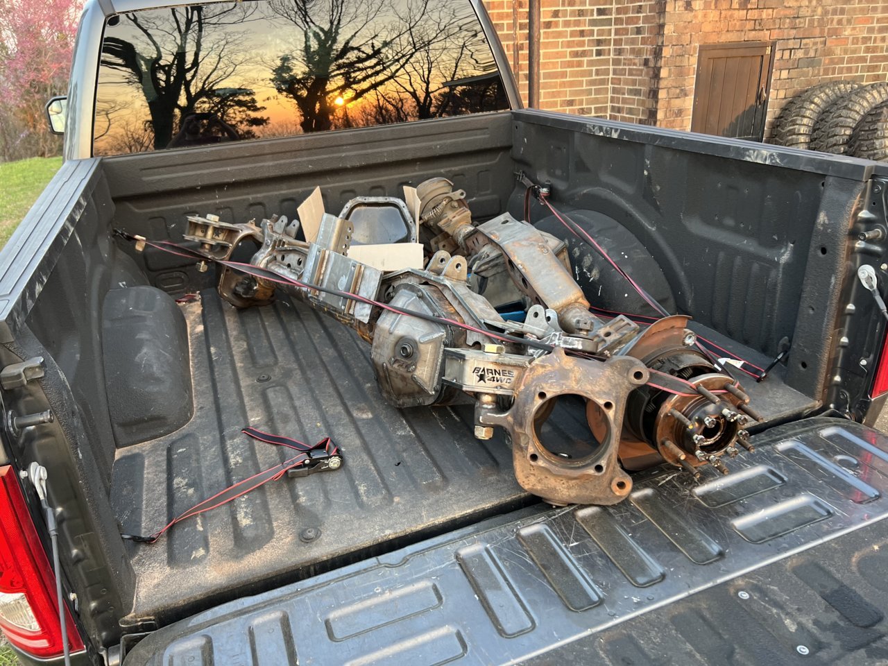

    Found Sterling rear 5.38 gears, yoke, master install kit on marketplace brand new for about $300 less. Someone changed their mind and went with a 14 bolt. I didn’t realize there are practically no spools for Sterling rears so it looks like I’ll be welding it. Found a new grizzly locker for the front for about $150 less on marketplace, too.

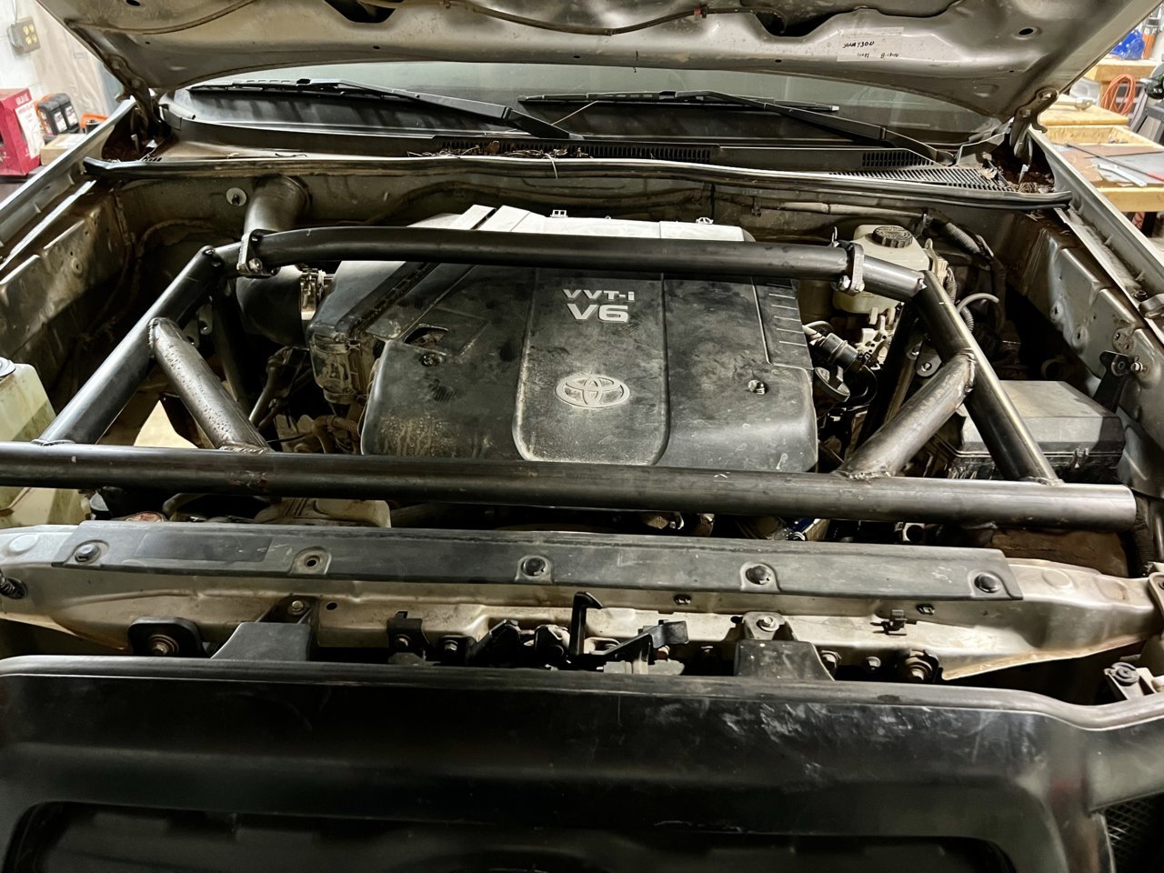

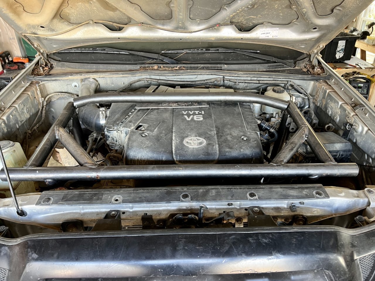

    Engine brace tacked on. Really glad the hood still closed haha. Made some alignment hicky boogers out of some scrap angle aluminum I had. Tie rods and steering welded up.
    Should be able to put the front on the ground tomorrow and start figuring out how far down to move my rear shock mounts and get everything welded/trussed up back there
