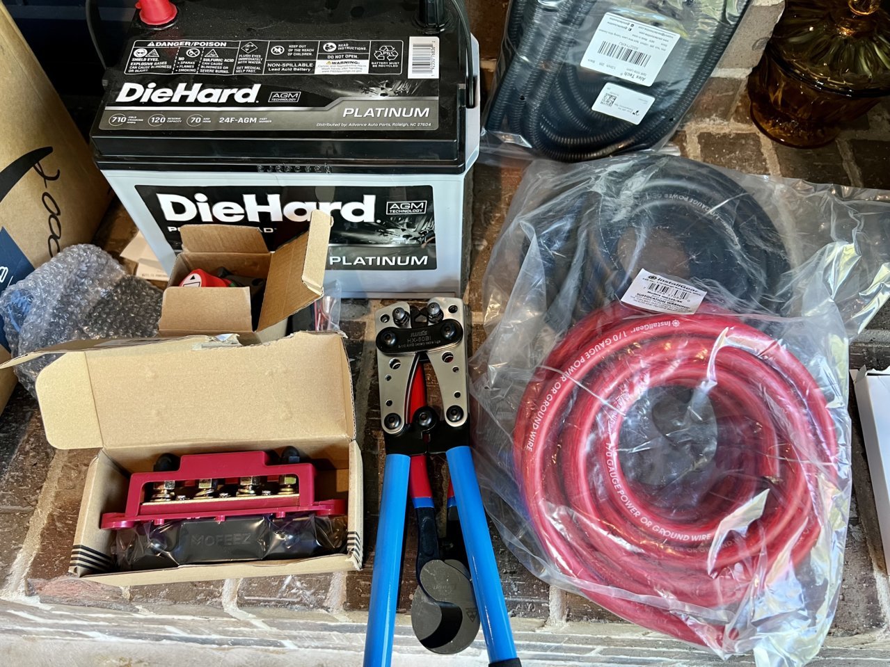

    You doing 1/0 copper or something else? I need to do mine since I have no more room in the stock location

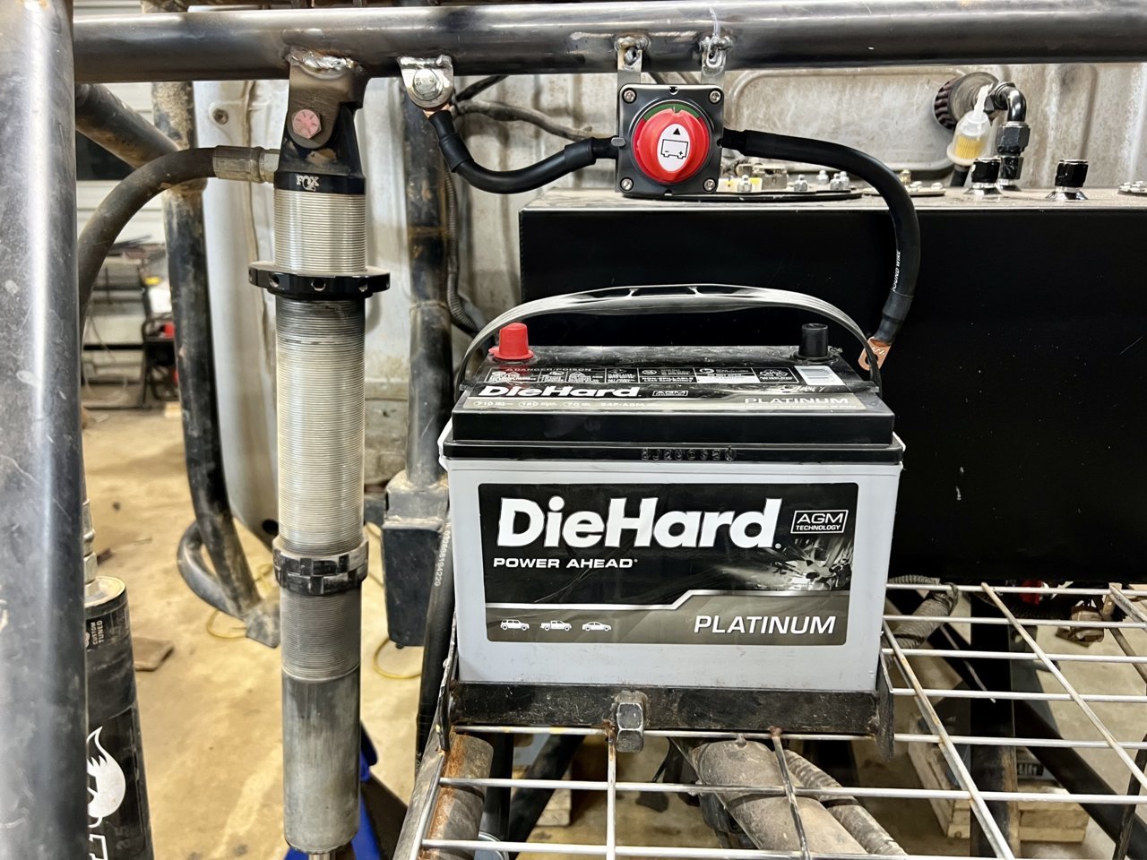

    Yep, that’s exactly what I’m doing. Picked up a 24f AGM battery. Couldn’t find a 27f locally and already made a 24 size box haha

    This is what I went with-
    Alex Tech 25ft – 1/2 inch Split Wire Loom Tubing Wire Conduit – Black https://www.amazon.com/dp/B07TCDTFL2
    Mofeez Power Distribution Block... https://www.amazon.com/dp/B09J24J338?ref=ppx_pop_mob_ap_share
    InstallGear 1/0 Gauge Wire (50ft)... https://www.amazon.com/dp/B01MXRVKLB?ref=ppx_pop_mob_ap_share
    iCrimp Battery Cable Lug Crimping... https://www.amazon.com/dp/B00MVE48Z6?ref=ppx_pop_mob_ap_share
    AWBLIN Battery Disconnect Switch... https://www.amazon.com/dp/B09HZP9X7T?ref=ppx_pop_mob_ap_share
    TKDMR 10pcs 1/0 AWG-3/8" Battery... https://www.amazon.com/dp/B08R6TX3XM?ref=ppx_pop_mob_ap_share
    Die Hard AGM battery- 24F

    I’m interested to see how you work out the terminals under the hood when you get there. Mine are just zip ties so they don’t flop around and I’m running off the alternator right now lmao.
    You do any research on using the aluminum vs copper wire for it? I want to use aluminum since it is so much cheaper but was a little worried it wouldn’t keep up with loud music and lots of lights as well.

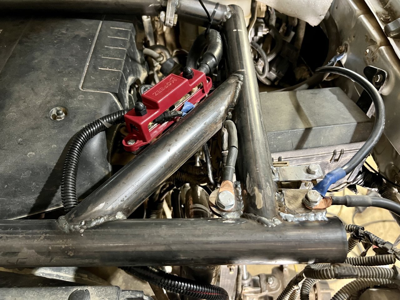

    It was only $75 for 50’ worth of wire so I didn’t bother looking into aluminum. I figured I’d build a little mounting plate and weld it to the engine cage for the terminal blocks. Instead of trying to rewire the alternator and factory ground I think I’m just going to cut off the battery terminal hicky boogers and put rings on them.

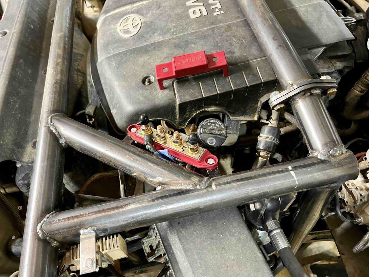

    Came up with this for the positive side of things. Little ghetto. Drilled out the factory stuff to 3/8”. Might burn down the truck during an oil change, but hey you only die once :notsure:

    Sometimes I feel like I’m making a very expensive car bomb. Also, I’ve welded four thousand ground points to the frame. I don’t remember unbolting that many, but apparently I did. The main 1/0 lead is sleeved with 5/8” discharge hose. Decided to mount the winch box beside the winch so I can get all the air to my poor radiator.

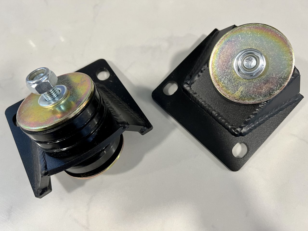

    Picked up some MarTec poly motor mounts. Since the rear trans mount is poly, I figured it’d probably be best to have consistency with the front.

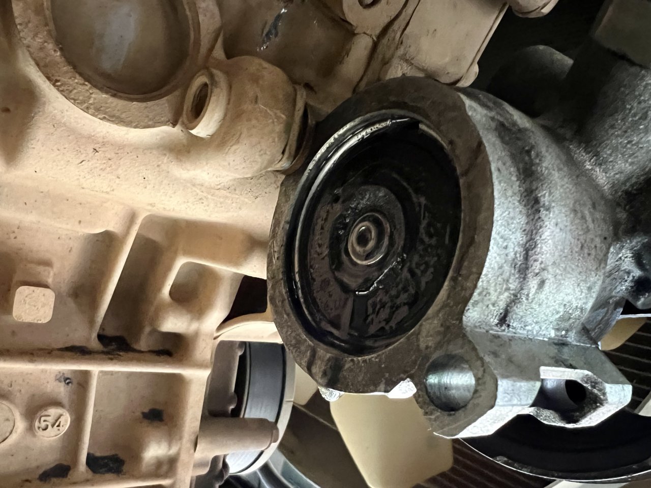

    Had it gassed up, ready to ride out of the garage, but ran into a hiccup. Was bleeding the steering and noticed the pump leaking from the back side when the truck is running. Not sure what happened, but I’ve ordered a new pump and hopefully PSC can tell me what the problem was.

    I ordered another from Summit in case it’s my fault. I don’t know what could have happened. Had a shop press the pulley on, maybe it went too far or bent the shaft. Truck fired right up though, so once this is squared away I’m ready to drive it.

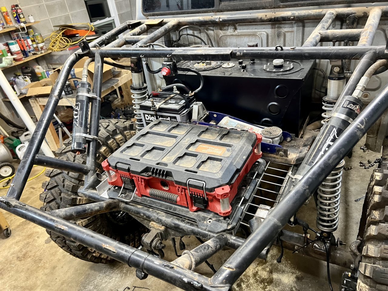

    Cleaning up the bed from past iterations and mounting the pack out and jack.

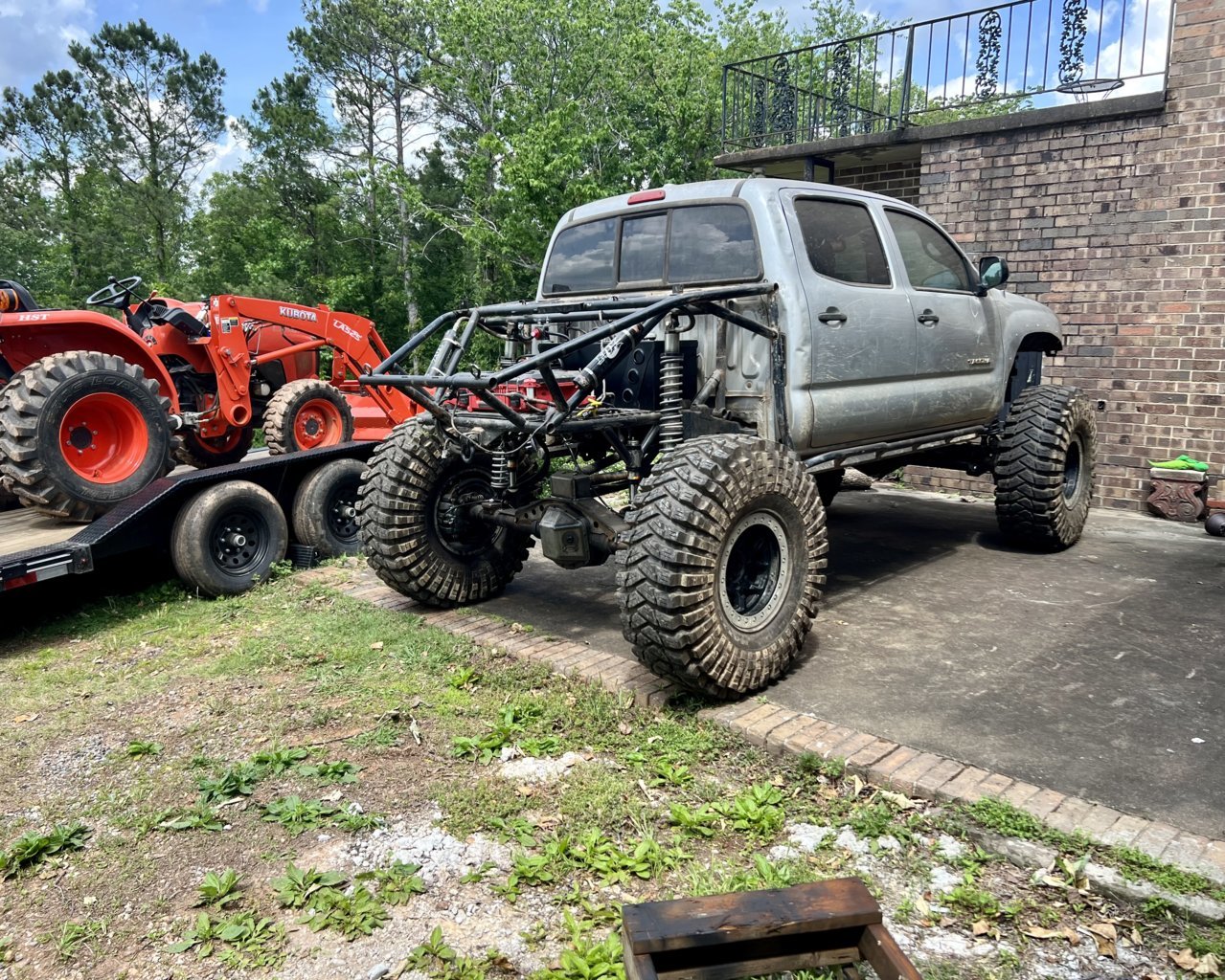

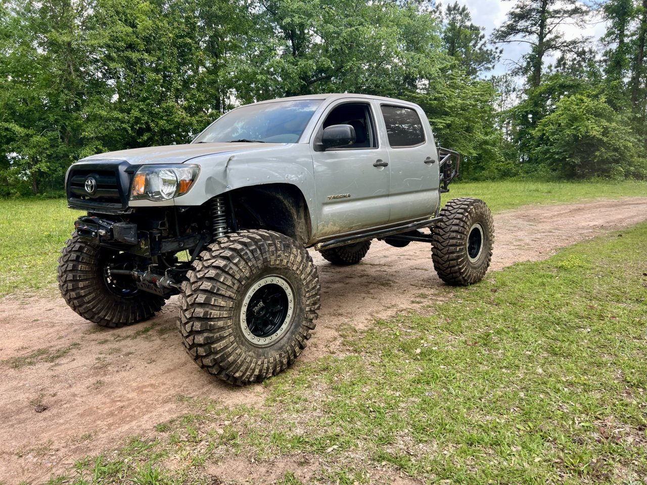

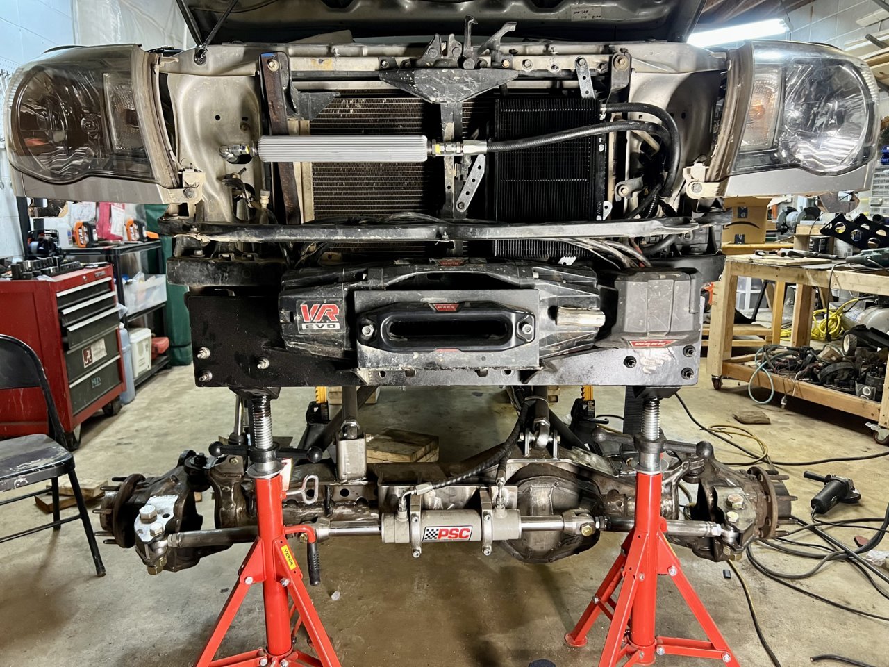

    Redid the front hydro mount with a TMR. Drove it out of the garage after six long months. Sitting a couple inches too tall and I have some other things to wrap up, but so glad it runs haha

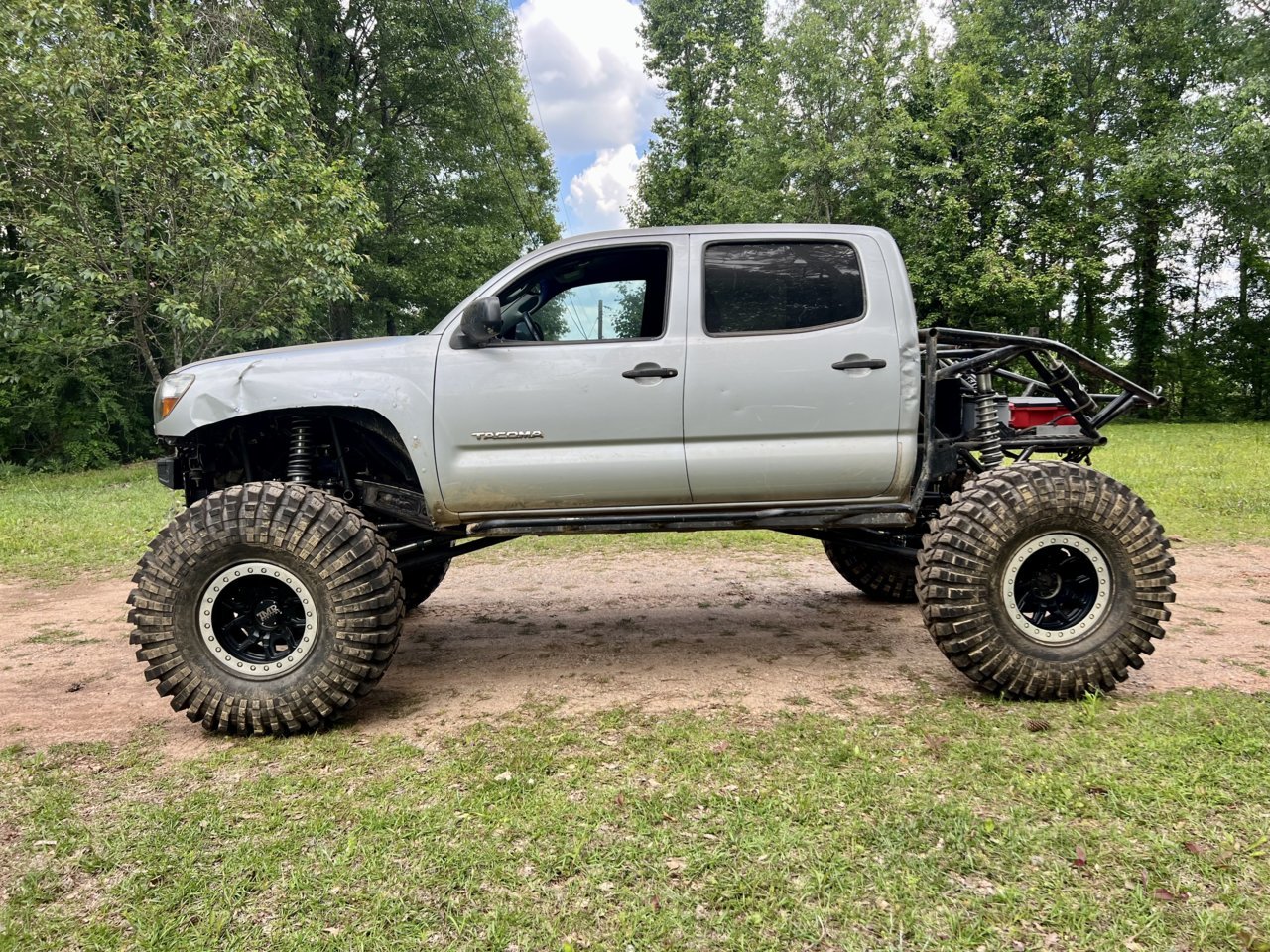

    That looks awesome, looking forward to seeing it on the trails.
    Hawk Pride cut some new trails that are really good, need to come try them soon.
    This was yesterday
