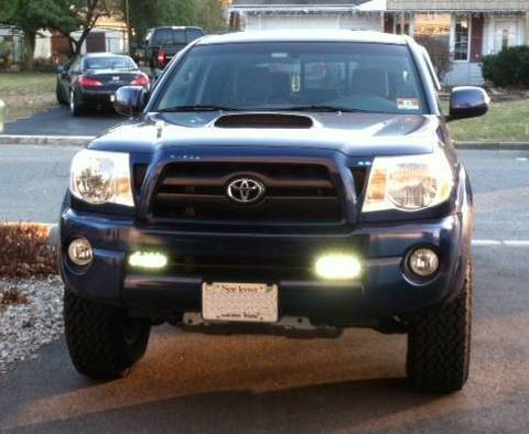

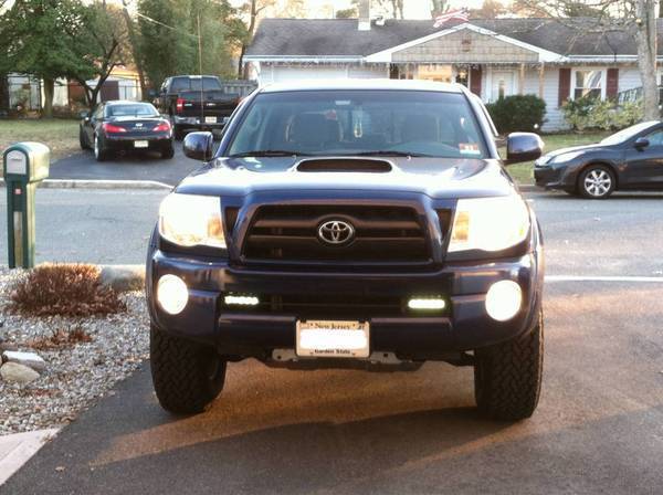

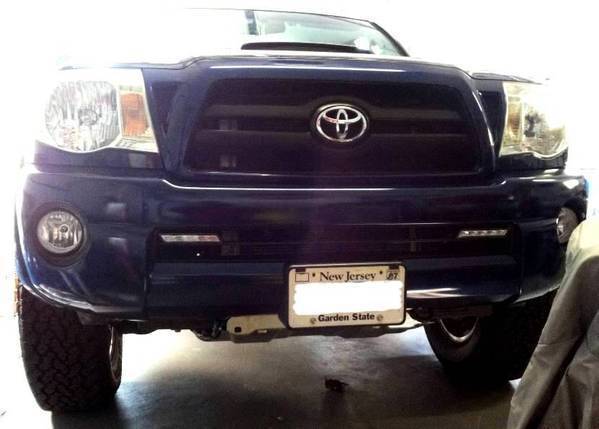

    Below are some pictures of the Sylvania DRLs I installed. Like Cain stated of the Phillips type, they are "plug & play"; that simple, there are 3 wires to connect... 12v, ground, & parking light. The last connection allows them to dim when the headlights are turned on. There is a module that senses the voltage difference from the alternator and switches them on/off accordingly.
    The driver's side appears brighter because of the angle.
