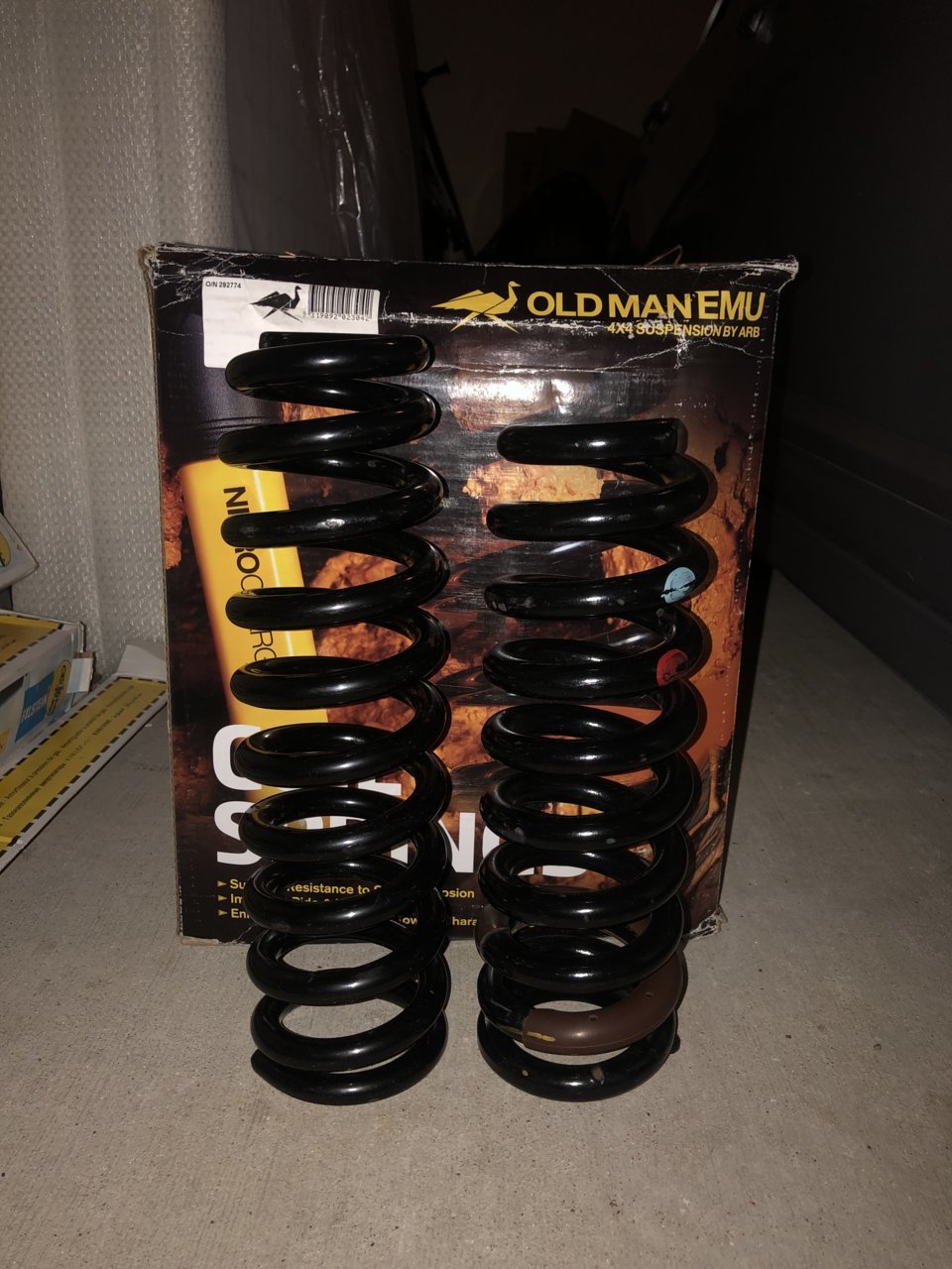

    Hey guys need some guidance. I wanna level the front of my truck.
    I recently acquired some OME 885 springs for FREE from a local 3rdgen owner locally. Can I run these springs with my factory struts? Or is it not recommended? I just want it leveled. Not wanting a spacer lift either if I need front struts will I need to AAL the rear?
    Thanks in advance. Pic of 885 vs stock and my truck on the bottom photo 496447BD-A538-497A-A930-00CD81A25F50.jpg

    You need different struts like 5100s or Ome struts with those coils. You'll probably be slightly nose high without anything in the rear. A 2" AAL might give you more rake than you'd like. A 1" block or 1.5" AAL would probably be best.

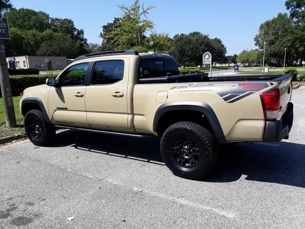

    It did at first but after settling up front it's still just a little tail high, still very happy with the end results.
    Here's the latest pics, I've also bumped up to 285 tires with a CMC.

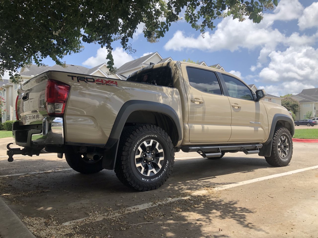

    just gonna throw these pics in here.
    ome 885 on bilstein 5100 with 1/4' spacer, deaver aal. stock goodyear 265/70r16
