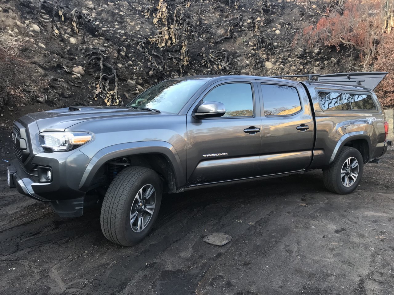

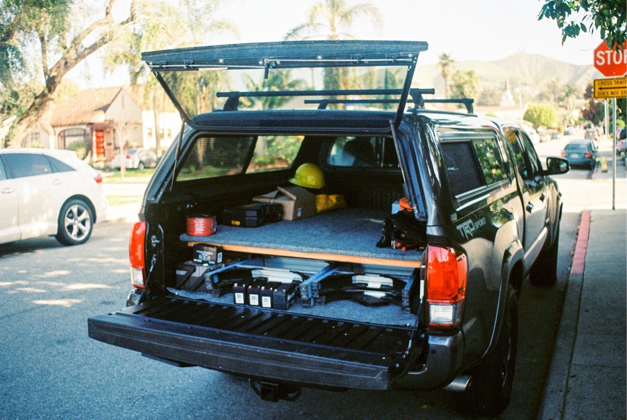

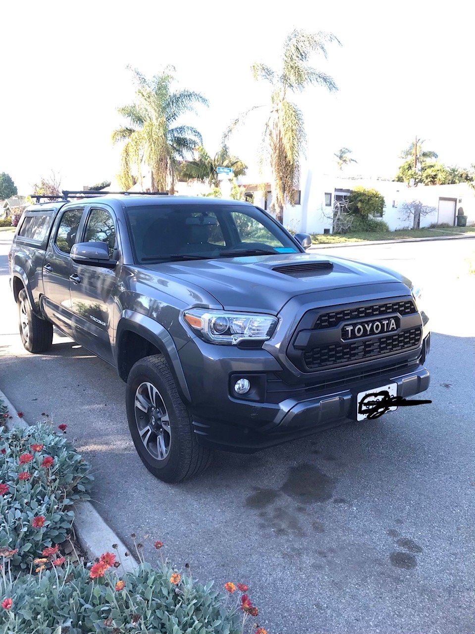

    Hey Jason,
    I'm about ready to pull the trigger and order the kit from Headstrong for the 5100 Bilsteins, OME 885s and the HS 3 leaf AAFs and I'm going to also replace the driver side needle bearing like you recommended.
    My truck is a 2017 TRD Sport DCLB with a camper shell and like you my truck is basically a daily driver and commuter for work (rarely do I go off road) and I'm only looking for a 2"- 2.5" lift.
    I'm basically looking for confirmation that this is the best route for my truck and my wants and if there's anything special I need to explain to the installer.
    Thank you for the tons of info you've already shared!

    Looks good but what do you estimate the weight of the stuff you carry in the bed in addition to the weight of the shell?
    If anything keep the overload leaf in otherwise you might end up with the rear dragging a bit over time. If over 300lbs I would consider a replacement leafpack.
    Good luck and hope you enjoy the lift!
