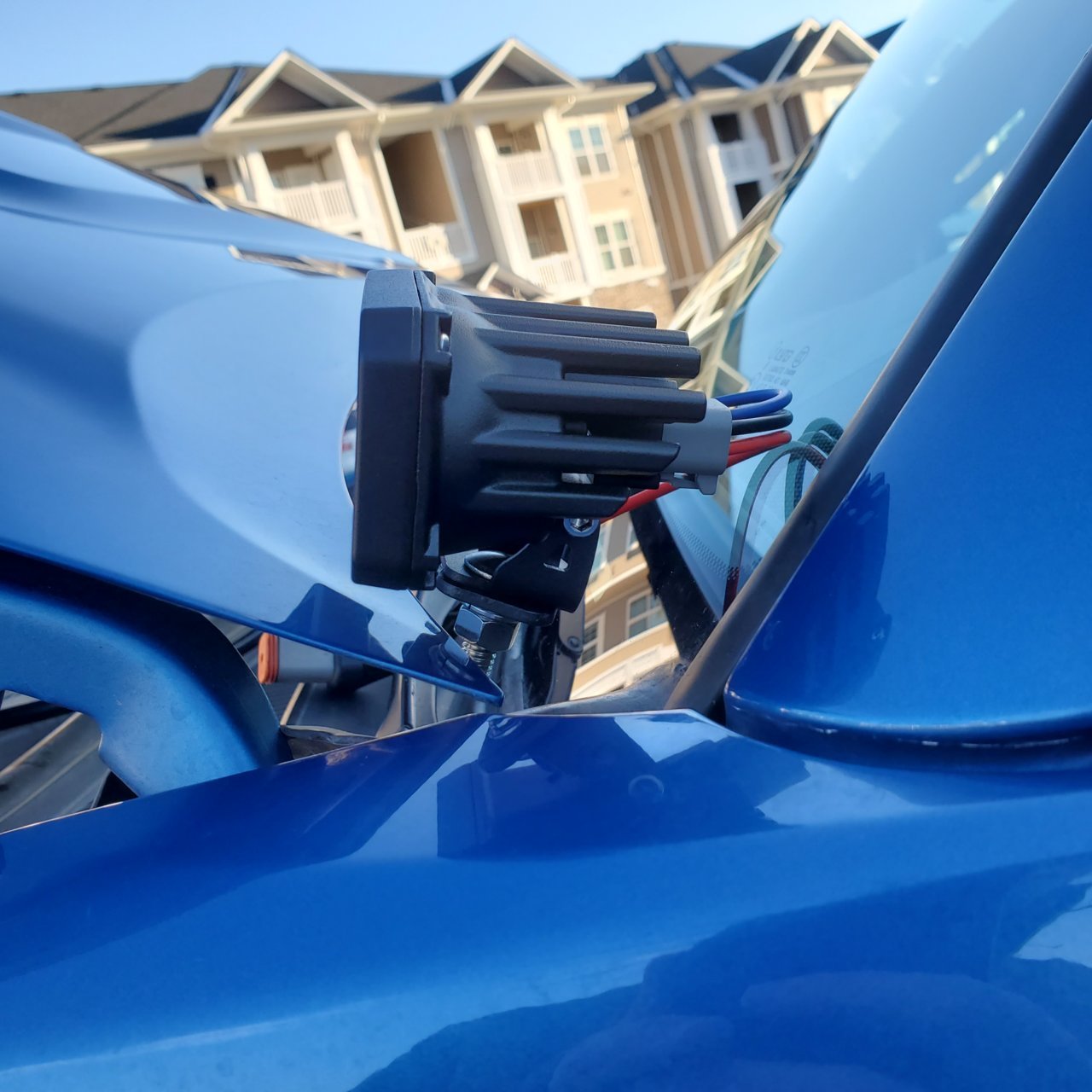

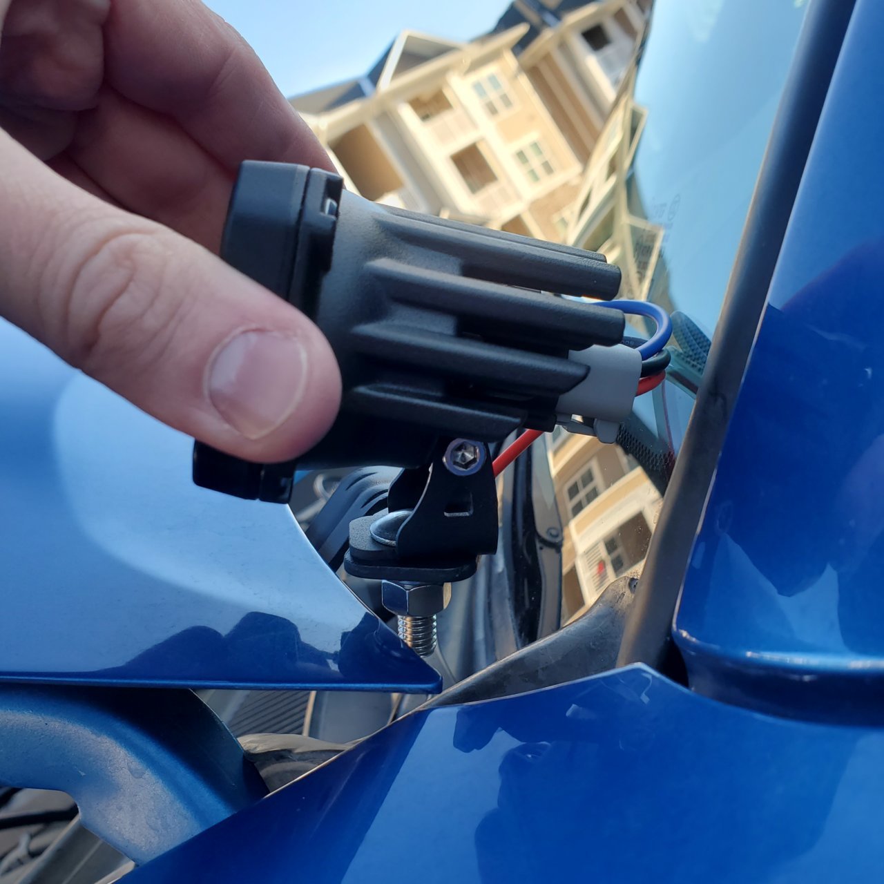

    That harness is fucked... and appears to not be the right one. Shoot me a pm and we’ll get you fixed up. I’m on my phone at the moment so I’m limited.

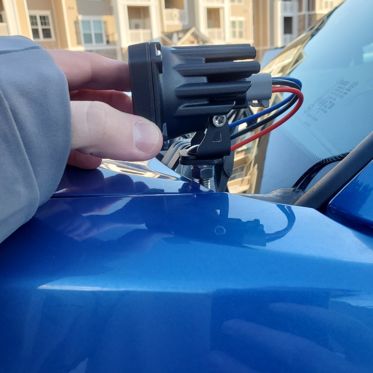

    I wish @Diode Dynamics would have flipped the deutsch receptacle 180° so you could use a 90° boot adapter! Not sure it would have helped you though. What ditch light brackets are those?

    Didn't seem awful, I had the electrical tape on standby, but I'll get a PM your way!
    It definitely felt like a missed opportunity for a 90* adapter! It's an Amazon lookalike to the caliraiseds, https://www.amazon.com/gp/product/B082MHD7JX/ref=ppx_yo_dt_b_asin_image_o01_s00?ie=UTF8&psc=1
    I'll settle for getting them all wired up for now, but who knows what the future holds, I'll keep ya in mind!

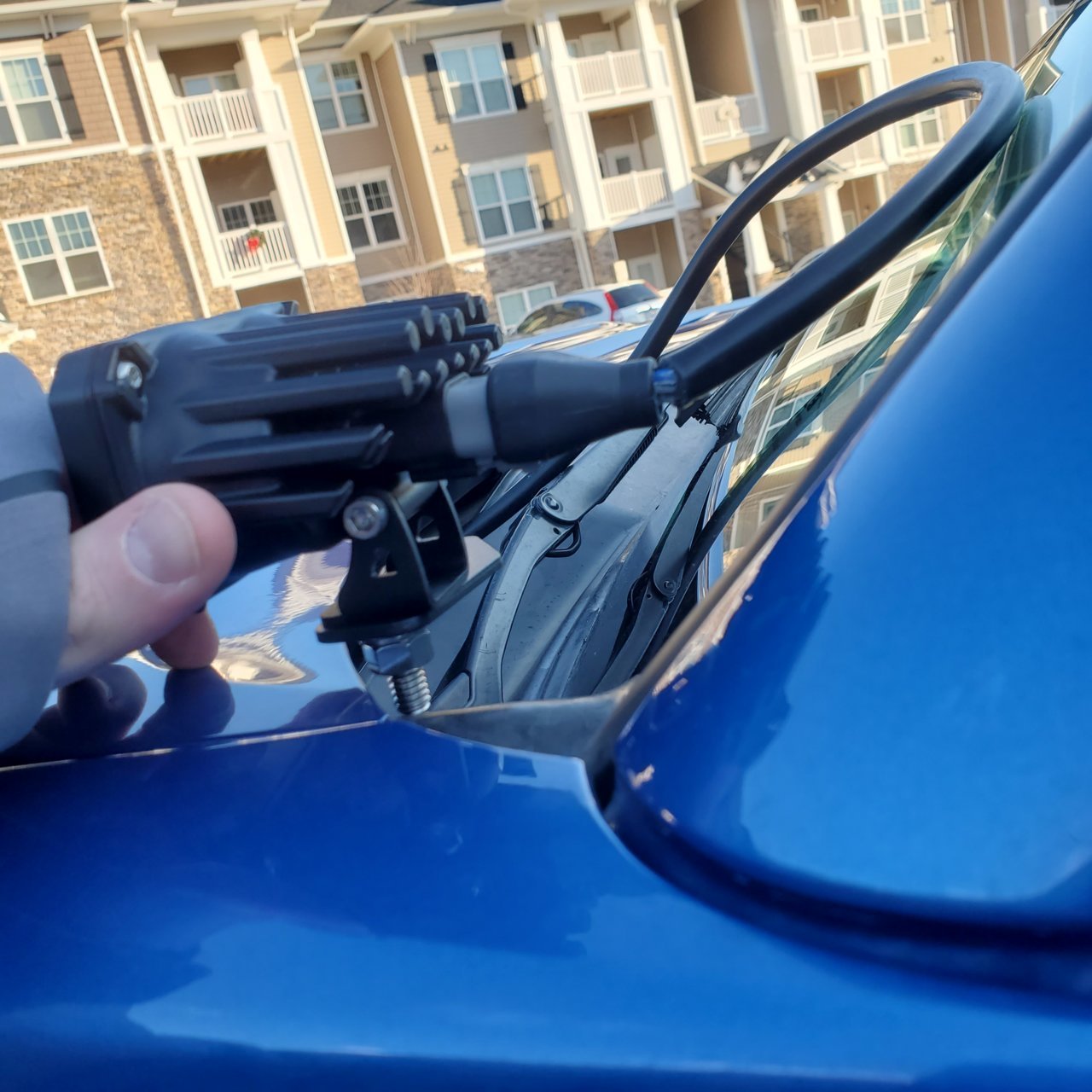

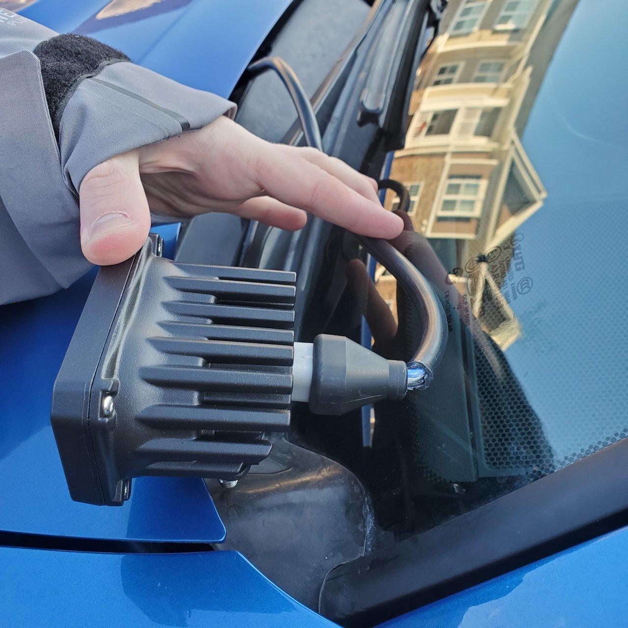

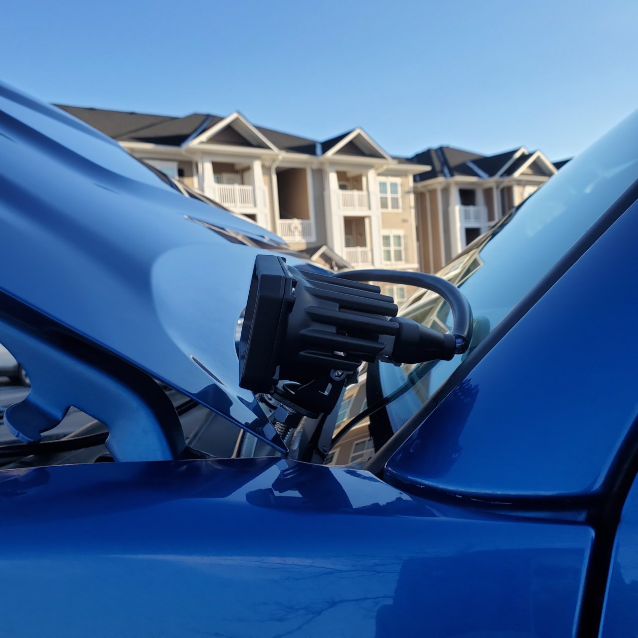

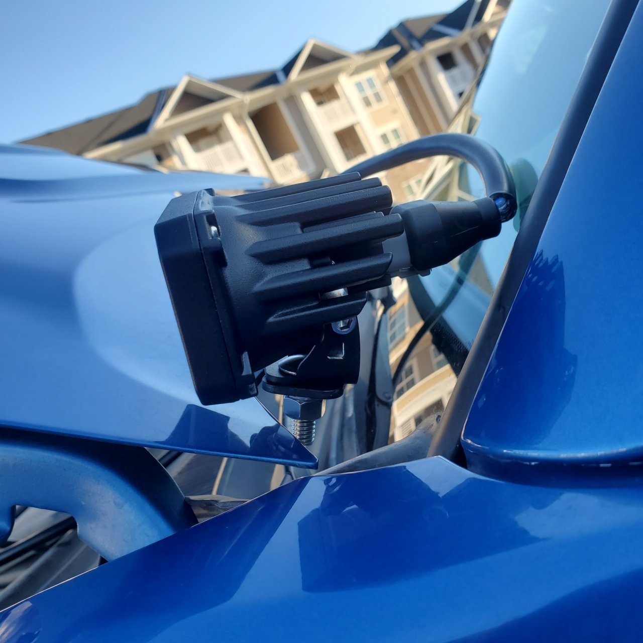

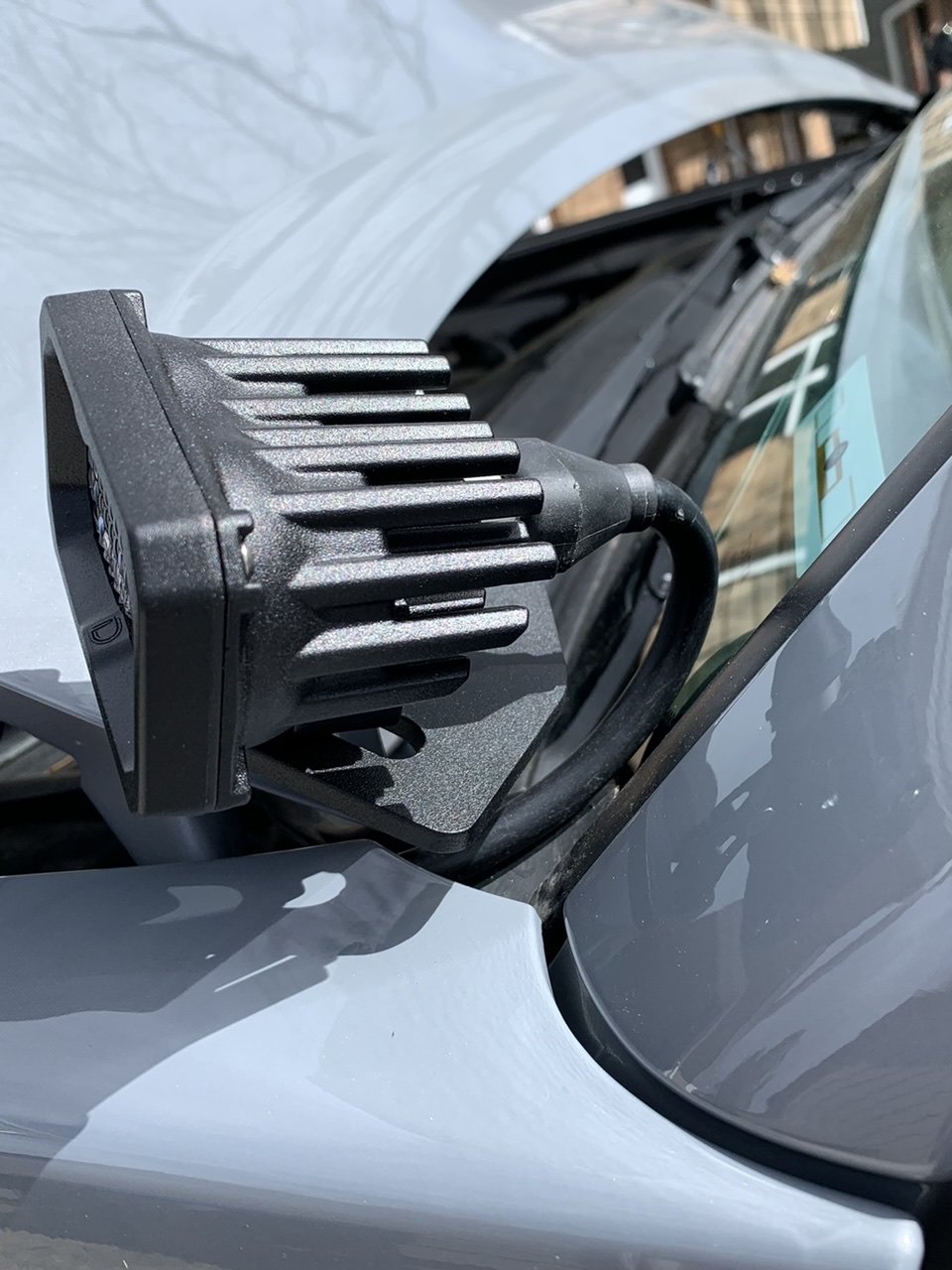

    So I received the same harness. Is it in fact the incorrect one? Mine do fit because the lights are angled and I have SDHQ brackets which push the light further from the windshield. It’s a nice harness, but seems like not really designed for ditch lights? The boot on the connector adds like an extra inch off the back of the light. It’s definitely up on windshield with hood open, though not with too much pressure. More concerned with how heavy the jacket of is, the curve down is too much stress on the connector and is definitely a weak point.
    if I wanted these facing straight ahead, probably couldn’t open the hood and these definitely wouldn’t work with the DD brackets.

    Don et al, I thought we had this all figured out as I thought there were changes coming to it... This model of harness with the overmolded rear plug is actually the "upgraded" version, but it clearly has clearance issues in certain applications. I'm glad it works in your scenario, but I completely understand where it may not work in some others. I have forwarded this on to the DD team, and will tag them here as well to hopefully get some more visibility on it. You guys are the only ones who have brought forth direct concerns, but I doubt this is localized to only you.

    @memario1214 Appreciate the response and that you've been more than helpful answering my questions and resolving the slight issues with my order. More than likely, will just unplug lights when I need the hood up for an extended amount of time, it's really not a big deal and will eliminate stress on that connector. Hopefully if a new and improved harness is made available those of us with this one can get a replacement sent or a decent discount if we'd like to buy the new harness.

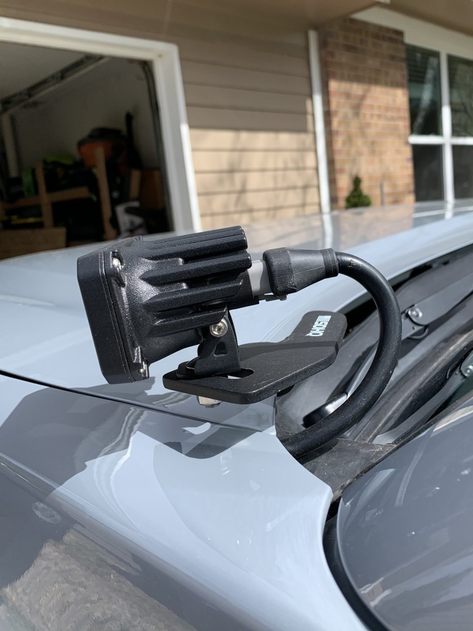

    @Diode Dynamics while I typically appreciate things that are super heavy duty, it seems to me that in this case, the harness is a bit over engineered. I know that this is used for multiple applications but it's not a great harness for ditch lights at all. Besides the plug size extending too far from the harness (a 90 degree plug would be amazing), the jacketing on the cables is way too thick and rigid. If it was thinner and more flexible it would be a lot easier to route from under hood up to the lights and make the bends where you need to make them. On the plus side, it looks a lot better with the molded rear as opposed to the other pictures I've seen where the thin jacket simply ends and the end of the wiring are exposed.
