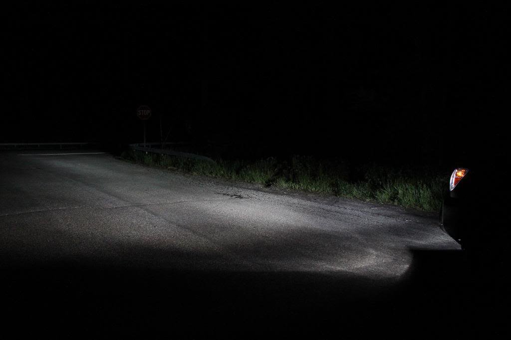

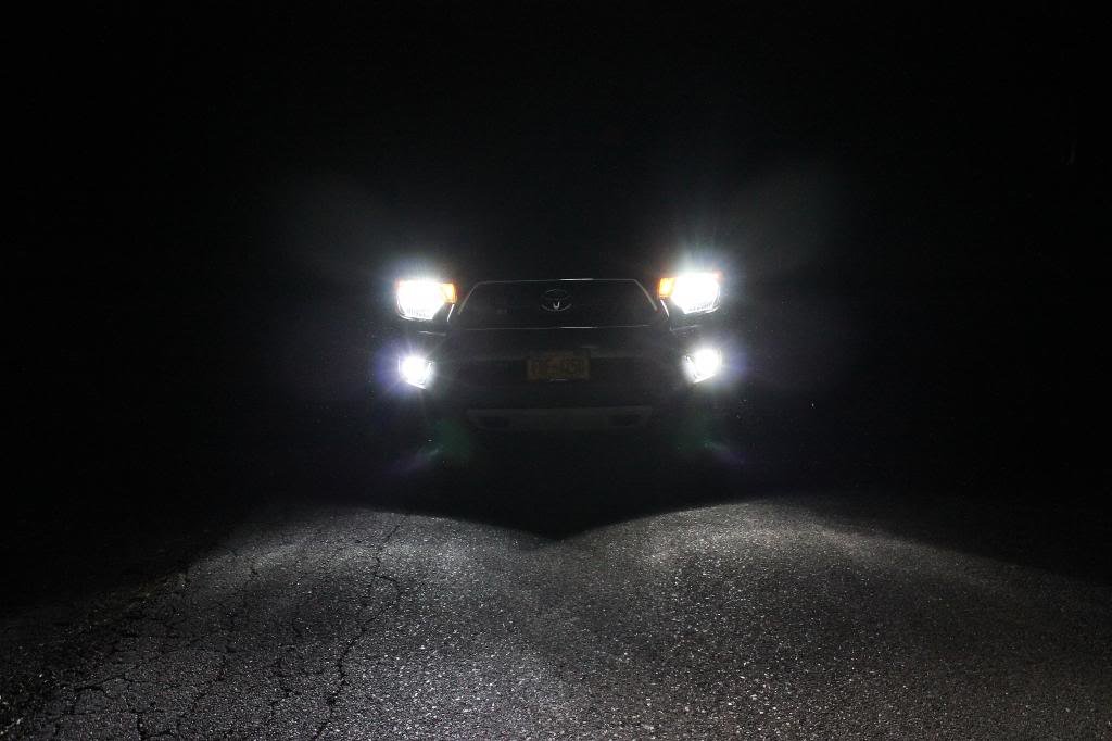

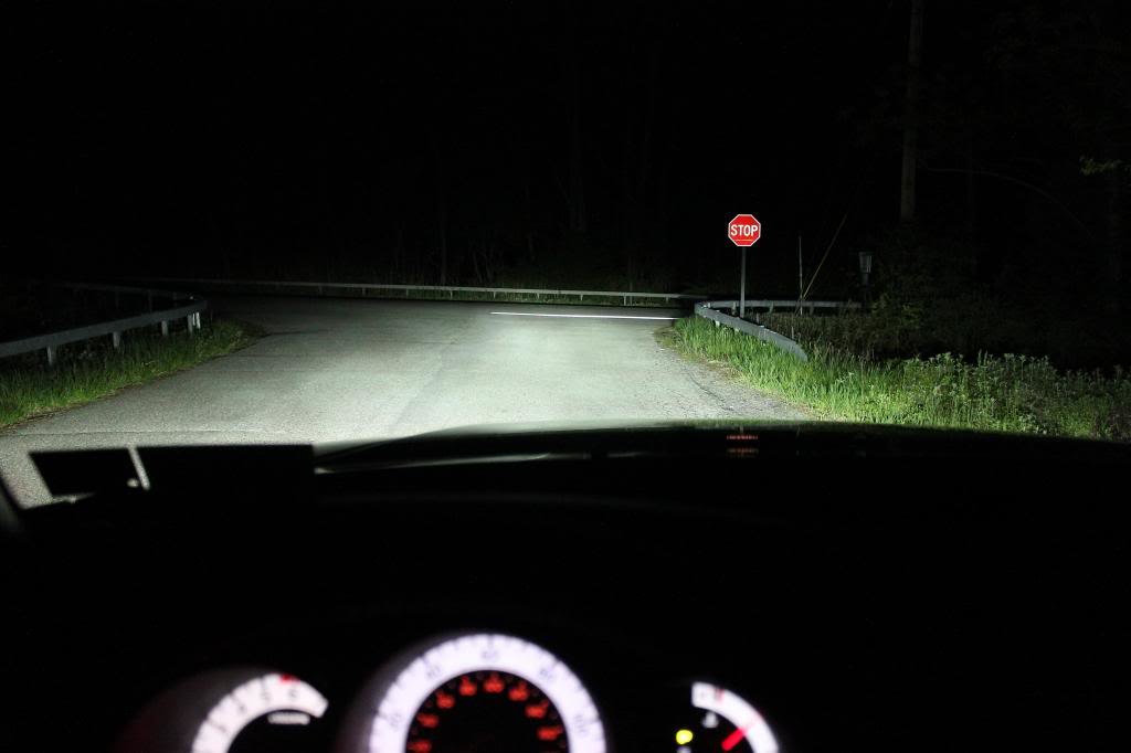

    Installed my HIDs over the weekend. The hi-lo kits kit for the headlights came with the relay harness and I ordered the optional relay harness for the driving lights. I think it looks great and to be honest, I don't understand what the big fuss is about needing projectors on this particular vehicle. The cut off for the headlight beams are pretty much exactly the same as with the stock setup. Prior to the install I taped lines on the wall of my garage for the low beams and the high beams and if anything, I'd say the new HID setup has a cut off that is slightly lower than with the halogens. I'm wondering if this has something to do with the fact that the bi-xenon lights have a shield that only allow a portion of the bulb to be exposed during low beam operation.
