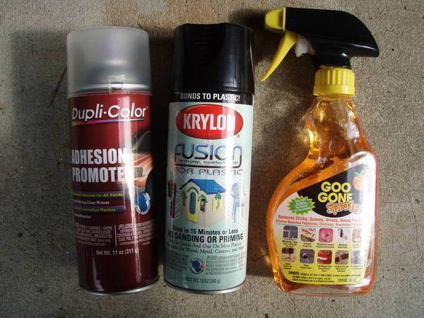

    To paint the taco badges...
    DON'T TRY AND PAINT THEM WITH THEM ON THE TRUCK!!!!!! IT DOES NOT WORK!!!!!
    That being said you need to first debadge the vehicle and get these materials...
    The first can is adhesion promoter. It makes a chemical reaction with the plastic badges so that the paint will have an easier time sticking to the surface. I did 2 coats of that waiting about 2 minutes between the coats. (Basically just follow the instructions on the back on how to use it)
    The second can is Krylon Fusion paint for plastic. This can is black but it comes in tons of colors. I did about 3-4 coats of this. Waiting about 2 minutes between coats. (Basically just follow the instructions on the back on how to use it)
    The third is Goo-Gone which is what I talked about in the debadging section but you don't use it for painting.
    The procedure for painting is...
    1. Remove badges and wash them. I just put them in a bucket of water with car wash in it.
    2. Spray adhesion promoter. (2-3 coats) Wait 5 minute before next step
    3. Spray paint the badges. (3-4 coats) Wait 15-20 minutes before touching and rebadging.

    What does this stuff look like?

  16. Sep 14, 2008 at 4:36 PM
    #16
    NumNutz
    NumNutz [OP] One of the original 7928
    Jul 14, 2008
    #7928
    4,899
    Virginia Beach, VA
    07 Tacoma 4x4 - Kings, TC, Dakars, broken stuff
    Lots.
    Thanks. It's really easy. I am a whimp when it comes to moding. I am always afraid I am going to screw things up but if I didn't screw it up then it has to be easy.
