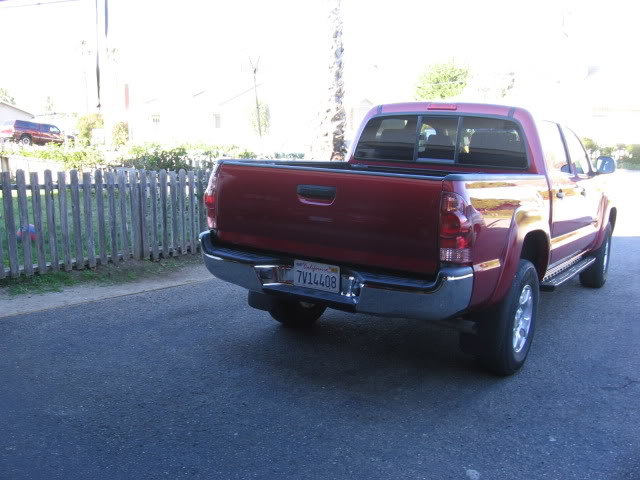

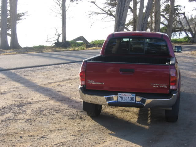

    Debadged the tailgate today. Instructions were great, used a hairdryer, fishing line, Goo Gone and Turtle Wax bug and tar remover. I was afraid there'd by outlines since they've been on since '06 but that bug and tar remover worked like a champ.
    Looks great, nice and clean.
    Before:
    After:

    Here's an update since I posted my results on post #242. I have a faint shadow in the paint where the badges were and is viewable in strong direct sunlight.
    I'm leaving them off for now since it's not glaringly obvious.
