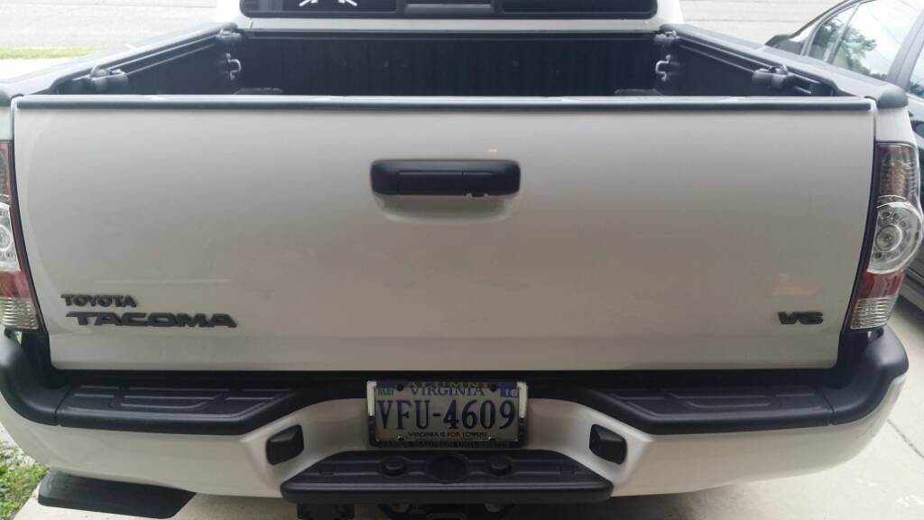

  14. Aug 10, 2015 at 3:05 PM
    #294
    Chase8059
    Chase8059 Well-Known Member
    Jun 4, 2015
    #156733
    200
    Chase
    ESVA
    2015 DCSB TRD Sport | Super White
    Bilstein 5100's up Front (1.75), Falken AT3/W 265/70r17 SCS SR8s GunMetal 17s
    Great write up! I just sanded the badges instead of using the promoter. I did grey badges on a Super White to match the grey "Toyota" on the trd pro grille I have installed. Now I just need the grey 4runner trd pro wheels and I'll be in business!
