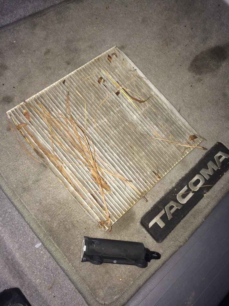

    What the hell is that smell? I couldn't figure it out.:confused: I workout almost every day (obsessed a little some would say) and get in my truck a little sweaty, so occasionally I have to give the interior a good cleaning to keep it from smelling like a locker room, but, damn, I don't smell that bad! :notsure: Then my Tacoma starts to smell up the whole garage! I think, that smells like death, literally. I start cleaning the daylights out if it and decide to check out the cabin "fresh" air fliter, pull it out and BAM!! Out pops a mouse, decaying mouse that is.:puke: NASTY! My truck smells like dead mouse!
    Anyway, anyone know where, exactly, the fresh air comes into the cab? Isn't there a screen or something to keep this from happening?

    I wanted to change my cabin air filter, but I thought I read that tacomas do not have one. So much conflicting info on this site...or maybe it's me, who knows!? Where do I access the cabin air filter?

    dude, hinge the glove box door open in, reach in there open the drawer, and pull out the cabin air filter. replace with new one. installation is the reverse of removal.

    ^^ Open the glove box, release the stops by flexing them inward to allow the glove box to drop all the way to the floor mat. That will expose a little door covering the filter. Pop it open, and slide the filter out toward you - and if your '07 has never been changed, be ready for a nasty surprise.

    Dammit!! I'm going to have look right now as a matter of fact, but I only have 50k on my 07 soooo fingers crossed. I doubt I'll find mice, but probably a couple dried up frogs.

    Thanks I found it and it was dirty but not too bad. Then this cylindrical thing fell out, and the glove box came out in my hands. Not sure where this plastic cylinder goes but got the box back in and cleaned filter for now.

    that plastic cylinder fits on the right side, its the shock absorber for when you just want to let the door swing open.
    if you dont put it back the door will fall without cushion
    if you put your finger in that little hole and pull you will see what i mean.
    its PITA to get back into place also

    The round cylinder deal is a damper for the glove box, and they tend to fall off as yours did. On the right side of the glove box and opening, there are two plastic posts - snap it back onto them, then put a small screw into the split of each one to keep it from falling off - if you care to have it on there.

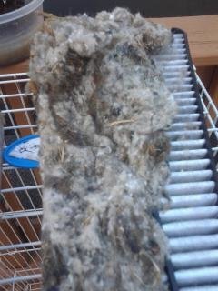

    Here's the cabin air filter that was in my PreRunner when they sold it to me at the dealer. This is after they said the truck had been completely gone over and serviced, thank you Romano Toyota for the great service. Still taking anti -biotics for the sinus infection before I caught this.
    012_zps05966c84_7b7ca762442fc7a25dbfd6c2a063884660eca1e6.jpgAnd the air filter also...013_zps5015479b_58406e65be4a8b47f72d151592d85115c58d1254.jpg
