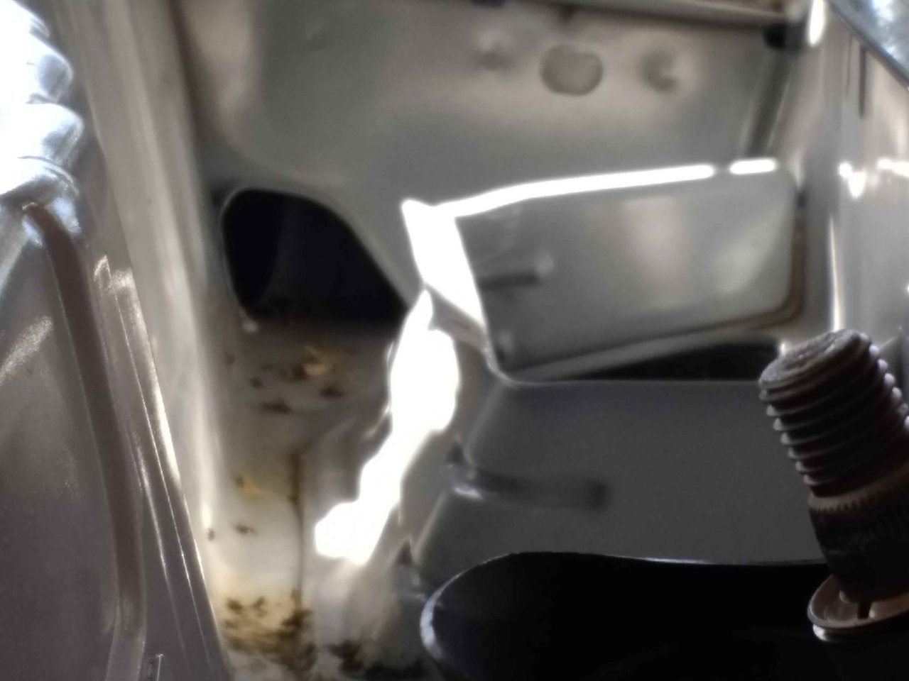

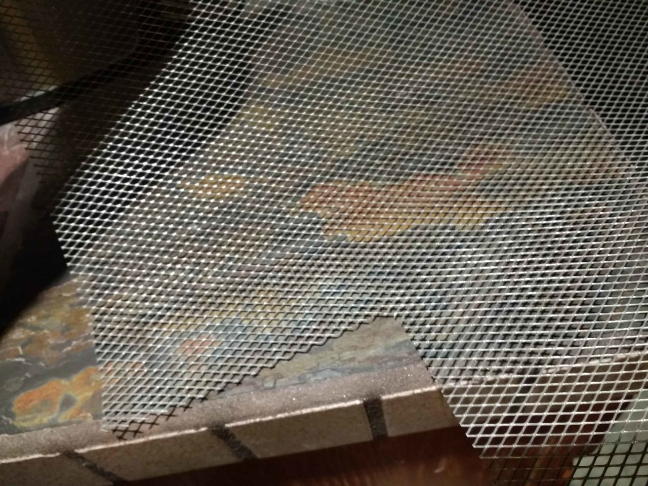

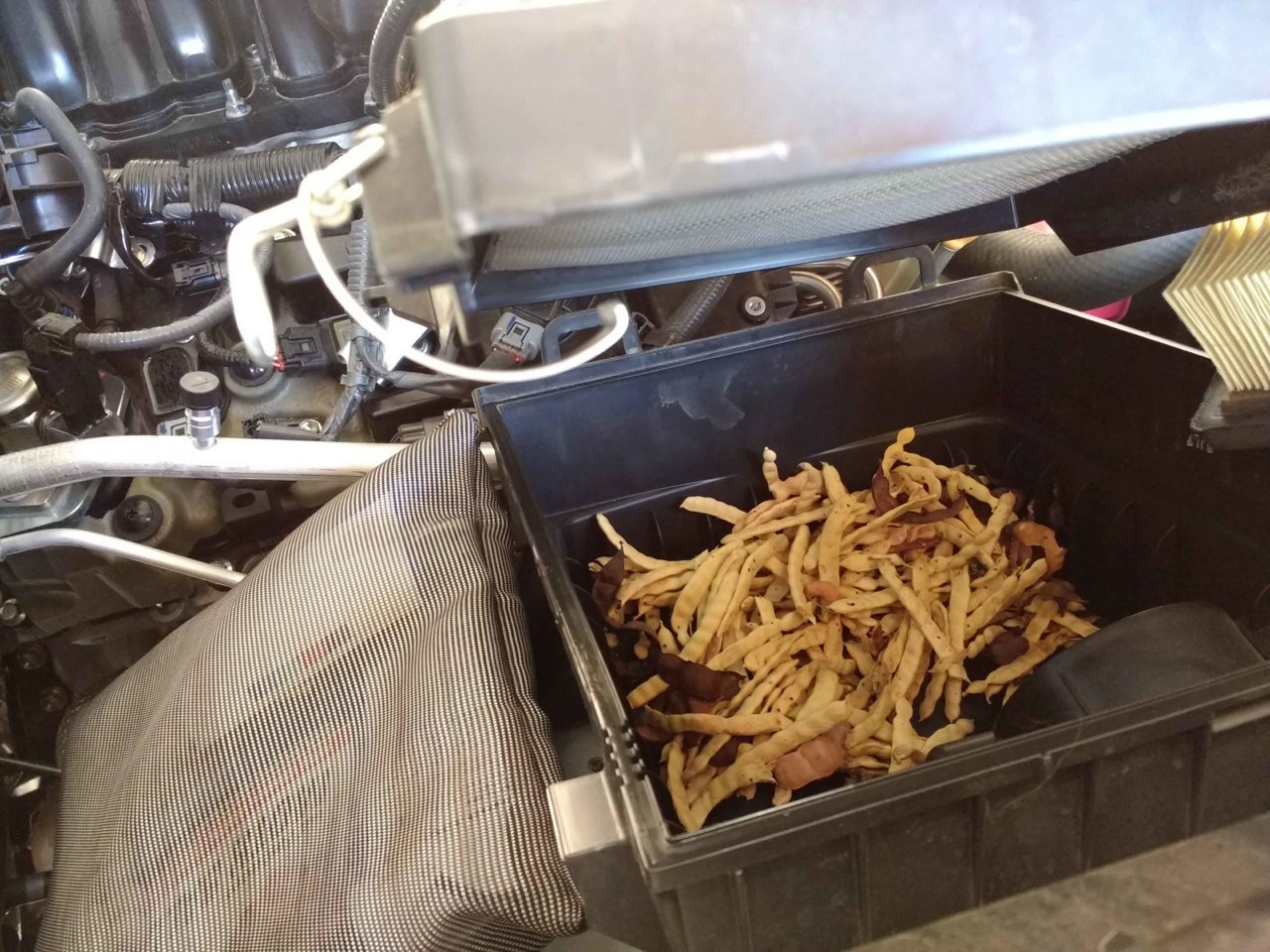

    Well, did you miss the intake air hole that is located just a few inches towards the fender? Nobody in this blog mentioned that hole! t's very hard to see, but you can put your hand in there and-- you will find it has a hole by feel, and considerably large. Check with a flashlight, stand on something to get your head in there and look towards the fender on the inside near the air intake. You can also make it out if you go to the driver side and look real low, you will see the opening. This is the opening that "intakes" outside "fresh" air from the fender cavity and is the "highway" where mice and rodents enter the windshield wiper well and subsequently the intake to the cabin ventilation system. A small mesh wire-cloth or similar over the intake to the cabin ventilation system would work, but to keep them completely OUT of that well, put a piece of wire-cloth over the hole that I just described. You can either epoxy in place, which is messy but permanent, or very strong magnets anchor the wire cloth or screening material to the steel body of the truck.
    Another Note: The engine air intake box has an extruding "pipe" that juts into the fender well that also takes fresh air from the same source as the cabin. I'm not sure just how "clean" the air is in that cavity since rodents can get into that area and frolic but BOTH my engine air filter box AND the cabin air intake were clogged with pack-rat nests, mesquite tree seeds, excrement, small stones, cactus needles, etc. I'm tired of the little bastards.
    Cut slightly larger 3.5 inch stiff screening and press into the part of the box where the pipe is. I put one on outside, one on inside. Just had so damned many problems with rodents getting into my Toyotas, 4 so far over past 25 years, and Toyota mechanics do not know how to fix much of anything like this. I do hold Toyota responsible as they should should have fixed this through engineering design many years ago, and they still can't get it right. Yes, they were TOLD.

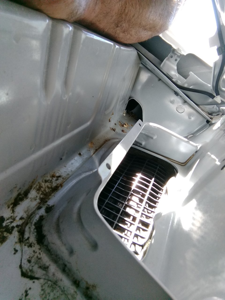

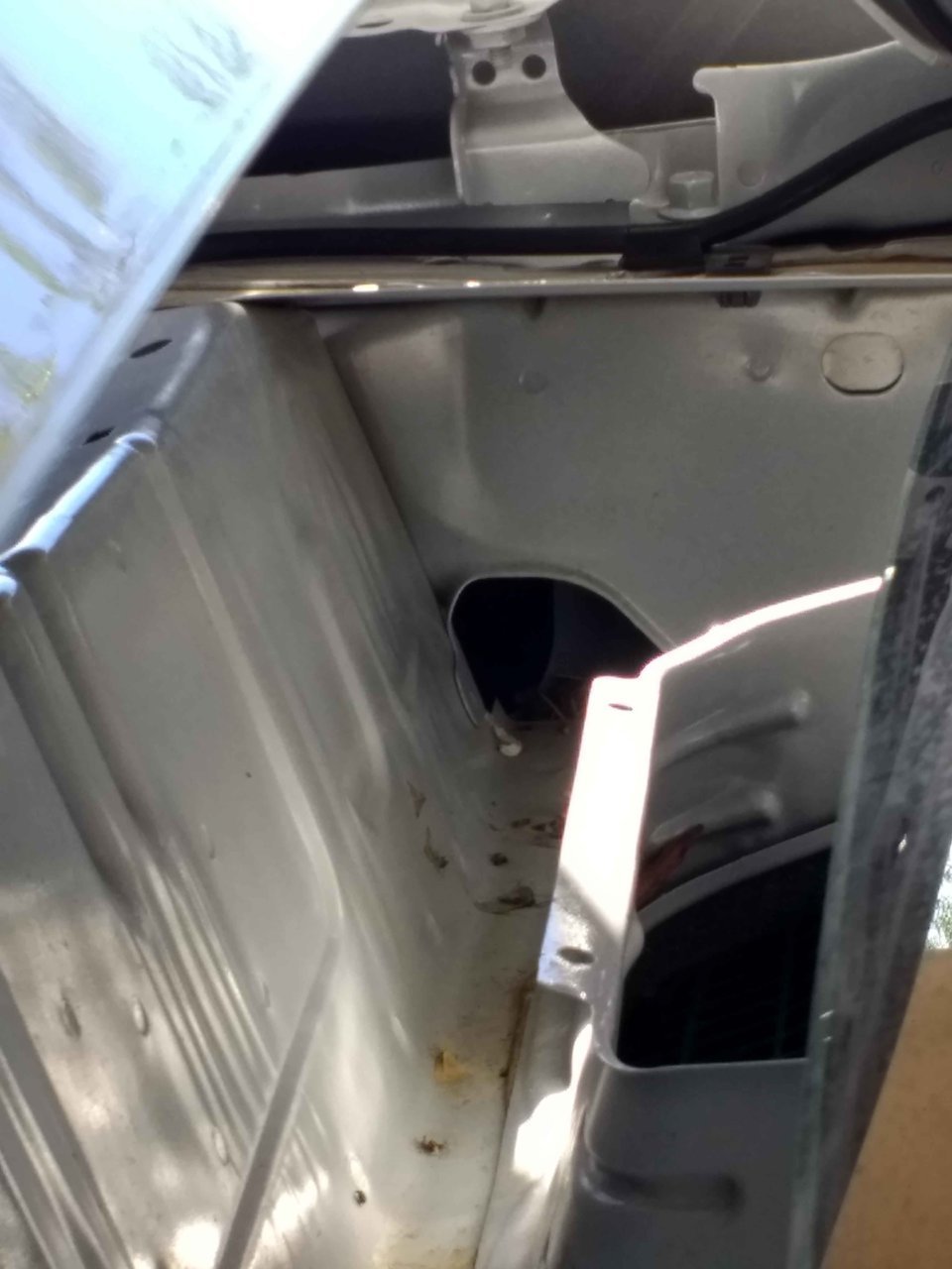

    The hole near the cabin filter intake, which I think should be called a "mouse hole" -- becaues it LOOKS like a "mouse hole" -- seems to have escaped notice on this forum. I just found out myself and feel that after so many years, 25 years of having to deal with rodent issues in the AC system should fall on Toyota and the Toyota dealers. Why? They are supposed to KNOW about these things, and the solution is SIMPLE. Just screen it off! I've lost tons of money on repairs by the dealers that do not work, and completely replacing trucks that are still barely broken in. Before my present truck, I was compelled to trade in my 2015 with only 30K miles on it off because of THIS very issue. The damages were too severe. I was tired of smelling mouse and pack-rat.
    Please check out the photos of this "mouse hole." I do not want to see anyone compelled to go to the dealer to address this when they will only clean, foam, whatever and charge you thousands. The fix is easy, but if you have a new truck under warranty, the dealer I contacted declared that my truck warranty would no longer be honored because I fixed it myself. However they do not cover rodent damages under Toyota warranty anyway.

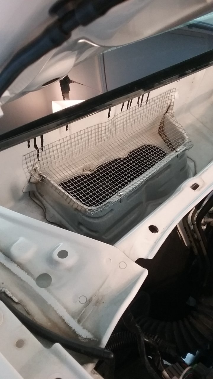

    I've had a roll of 1/4" square galvanized screen/mesh for years that I've used for various things. Worked perfect for this. Fairly easy to cut and shape. I secured it with some stainless steel nuts and bolts in 2 existing holes

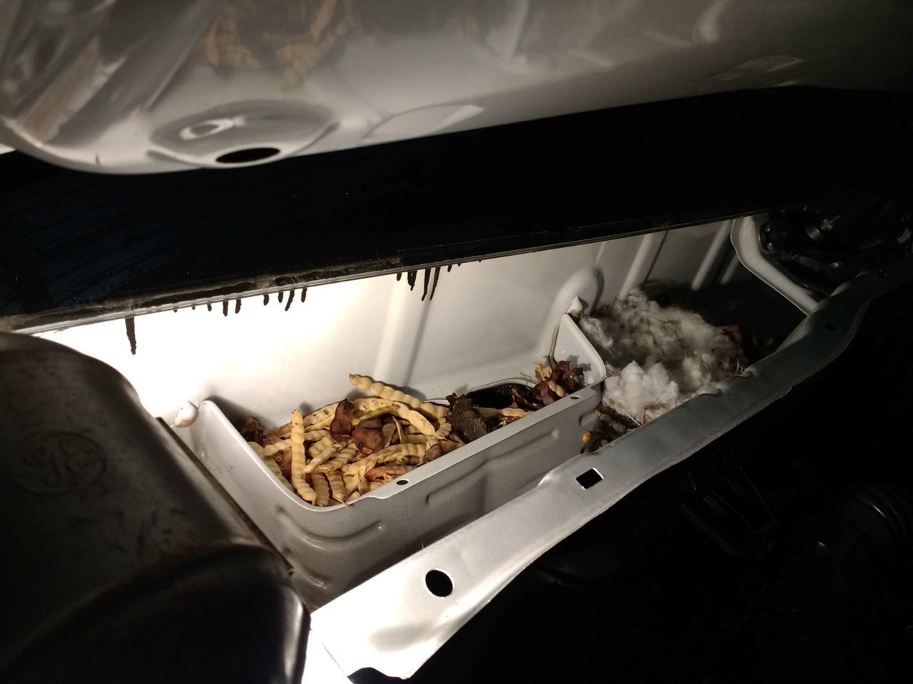

    thought that was french fries for a minute
