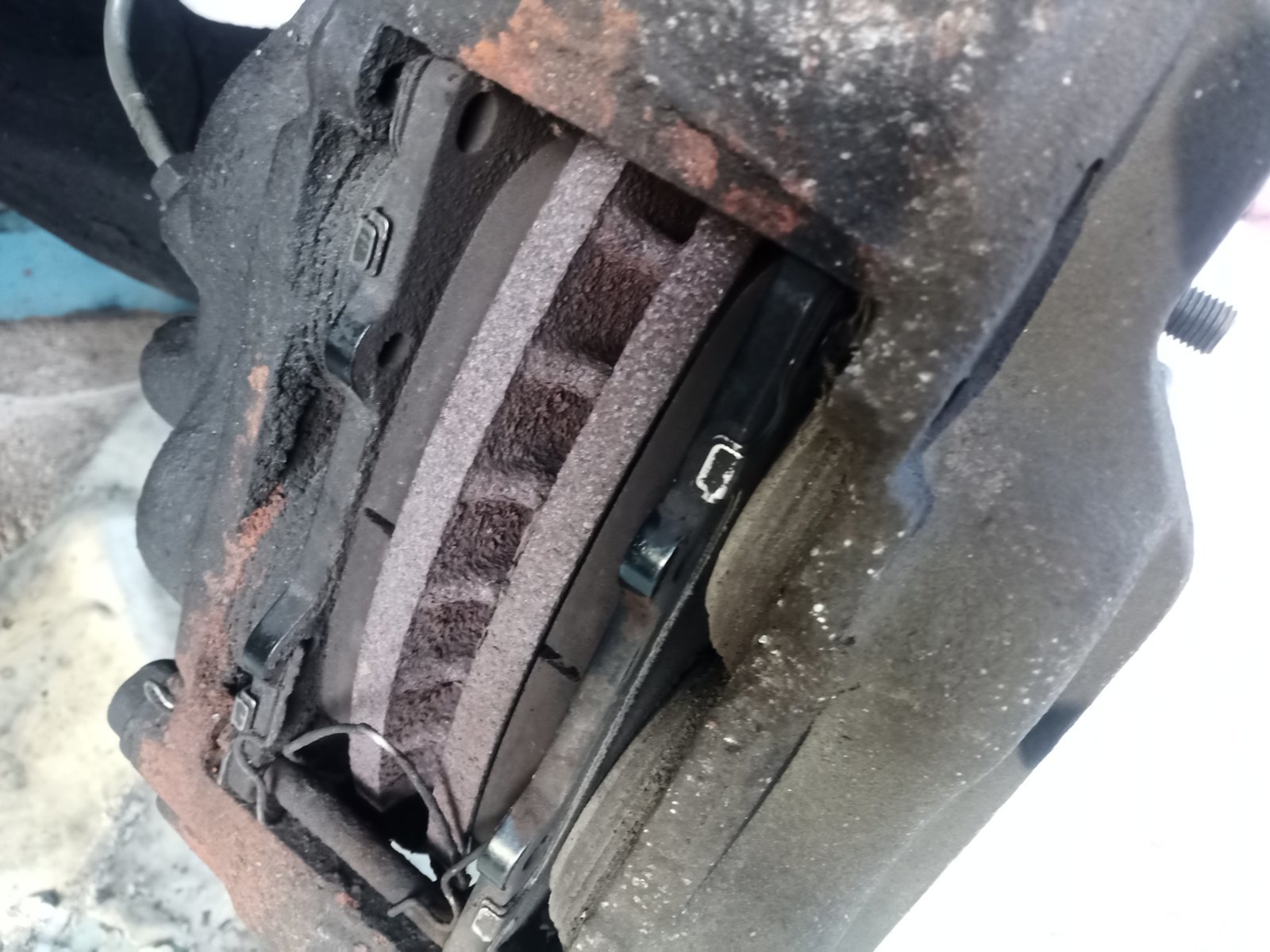

    the Quality of a Yota dealershop 199$ front brake pad special was unearthed 29 months & 32k miles later...
