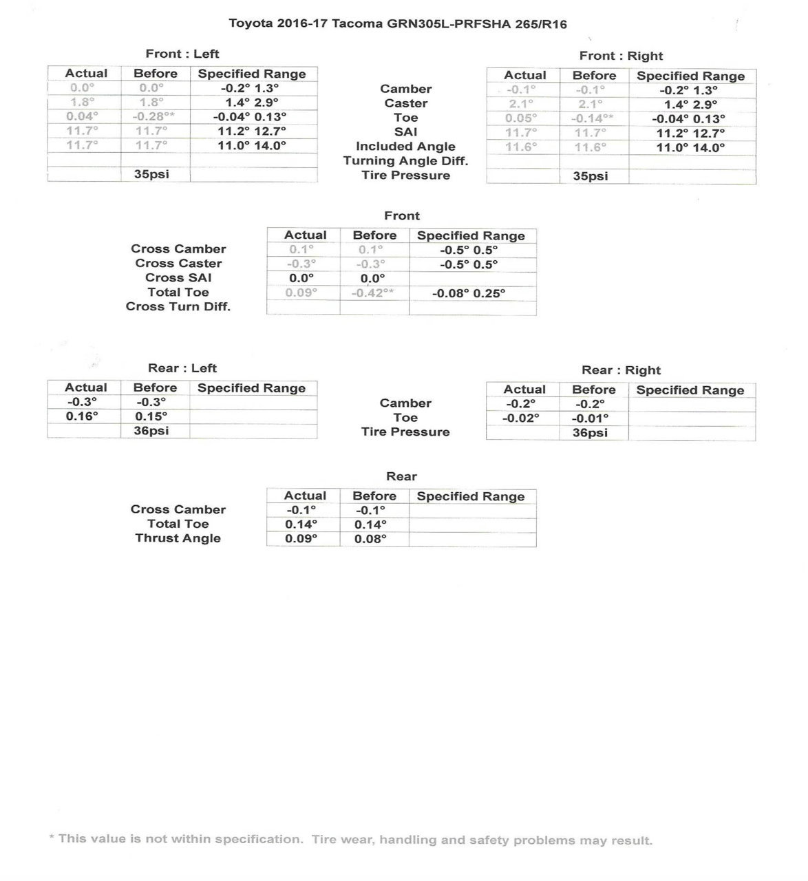

  15. Jul 7, 2019 at 1:00 PM
    #135
    Sungod
    Sungod Well-Known Member
    Feb 12, 2018
    #244194
    2,602
    St Augustine
    So is it fixed? I would love to see your alignment print out.
  16. Jul 8, 2019 at 11:11 PM
    #136
    17trdoffroadbel
    17trdoffroadbel [OP] Well-Known Member
    Mar 8, 2018
    #246666
    454
    Turd Gen
    Nothing has been fixed whatsoever. The shaking, which they deemed normal for similar vehicles, is enough in the steering wheel to see your hand moving. The alignment thing was just a BS excuse to get me for 120 smackers; I'm attaching a scan of the printout. I'll try rotating the tires front and back next. alignment.jpg
