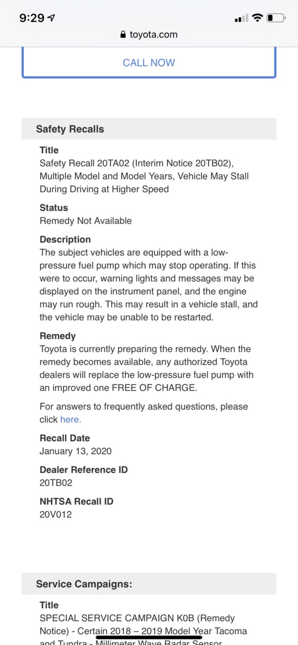

    CAAF5420-738F-4ABE-9F77-BD3A3D32588D.jpg Ok so I did some digging and it seems like I’m under the recall?

    for those of us under the recall, is it something we can fix now? I only ask because the picture I posted says “remedy not available”

    Nope, the letter says to sit tight and they will send another letter when the remedy is available. It might be different in your case since you could be possibly having a fuel pump malfunction
