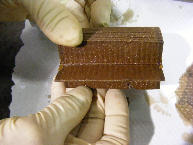

    Balien, you should have an oil sample analyzed asap- before a dealer gets hold of the truck. Blackstone Labs is a good source for this: http://www.google.com/url?q=http://...4QFjAA&usg=AFQjCNEH1z5K-ngqosfO9k8Tg18fM9cwvw
    I'd also remove the oil filter and inspect it. Cut it open and examine the pleats for glitter and metal shavings. (any copper is a bad sign). As stated by others, there is potential damage to bearings, piston rings, and cylinder walls.
    Are you sure the oil light didn't iluminate sooner, or flicker? In fact, the light should have come on when the tech drove it out of the service bay- which added time to the engine running btw. How long did it run? Have you checked the oil level since the debacle?

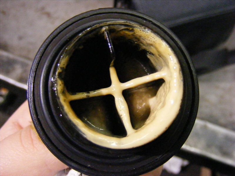

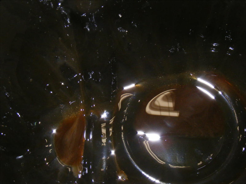

    Ok so now I've had my inspection done I wouldn't leave the truck they sent a rep from the other dealership. They drained the oil we got 4.5L out of the engine. They removed the oil pan we inspected for metal. A few microscopic grains can be seen in photo. then they pulled out a boroscope and checked the cylinder bore from the bottom. then they pulled a spark plug and boroscoped a cylinder from the top we could see the crosshatch pattern of the cylinder with no obvious scratches. He also looked at the timing chain guide which he claimed would be one of the first things to be damaged. It was normal. We took the filter apart and inspected for any metal. none was found. There was a white residue on the oil filler cap which they said was condensation there was a little bit of that in the oil pan too. They kept the truck overnight because the oil pan gasket needed to cure. See pictures what do you guys think now? Yes I kept some oil for analysis.

    The creamy stuff in the oil filler truely is normal for this engine: in the pan is a bit strange. Have you not driven it much since the incident?
    I can't say about the tiny particles of metal...it IS a new engine and they could be left behind from the break-in fill? Maybe someone who's been inside a recently broke-in engine could tell.
    I would actually think the chain guide among the least likely to show wear...it didn't have time to run completely dry, after all. Too, it uses boundary oil protection (as do the cam lobes and lifters) so a residual oil film will provide some protection for the short time you ran it.
    It's really the bearings where you'd see the most obvious damage: they rely on hydrodynamic oil protection and with no oil pressure they are scraping metal to metal.
