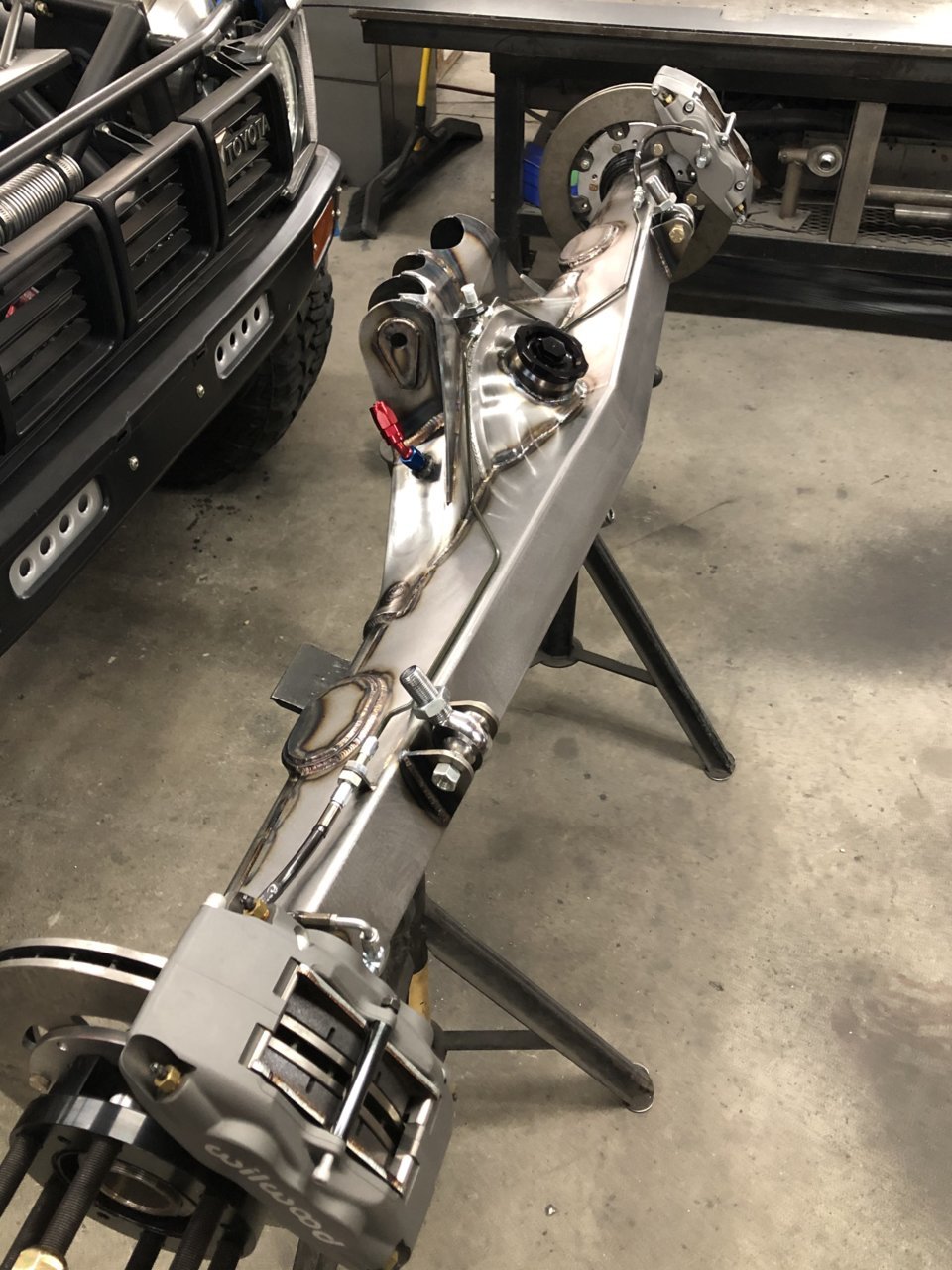

    https://www.tacomaworld.com/threads/airdogs-2012-prerunner-access-cab-slow-build.264263/
    In a few weeks I think I will be done worrying about blowing my 3rd.
    What my near future rear end will look like minus the the link mounts… lead time with parts is driving me crazy.

    Beef.

    Edit: re-read what you wrote
    Is that an example of the housing or are you linking at the same time.
    Im going a different route with a housing from trial-gear and a 3rd from a T100
    That’s exactly what I’m gettin minus the link brackets. Staying SUA for now.
    mk5, Hobbs and MonkeyProof[QUOTED] like this.

    I re-read what you wrote, couldn't stop drooling when first looking at the picture

    I finally figured out how to bypass losing my speedometer when losing the rear speed sensors on my 2WD so now I'm having Harry at JDfab build me a full float 35 spline ford 9. Losing the speedometer sets a P0600 code and is an automatic fail for smog. Just a couple of jumper wires in the engine bay and that problem is fixed for 2WD trucks.

    4wd will get a p0500 code, essentially the same thing. One missing signal will set a ABS DTC for whatever side its one and disables the ABS sytem, no signal from both sides will set the p0500
