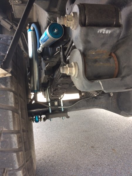

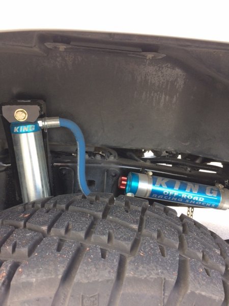

    Had this setup for one day and so far not bad! I got the Kings 2.5 12" Reservoir and compression adjusters to go with this soft pack J66. Valving 15F/10 "F" means flutter shim stack. So far the ride is a bit stiff on the street, probably need to throw a 35 spare tire/wheel in the back. took it offroad and it performed well! started softing up at 45-50mph. probably might change the valving to 12F. but so far i like the set-up. Next is limit straps and brake lines and hydro bumps.

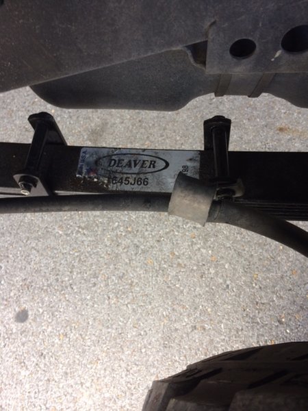

    Oh Also bought my stuff from Wheelers! J66 spring, bushings, carrier bearing spacers and Ubolt and hardware kit. Good stuff! Defiantly recommend them!
    Shocks from down south motorsports.
    shock relocations from BAMF

    Here you go.
