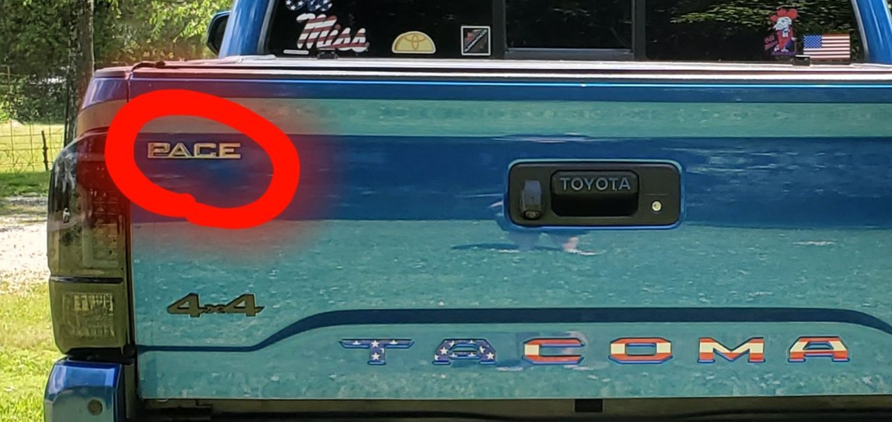

    Howdy everyone.
    Looking for some solid advice on how to remove this dealer badge on my tailgate. I've seen suggestions using WD-40, a heat gun or hair dryer, to dental floss or fishing line.
    Currently this is what I have on my tailgate from the dealership:
    It's the last bit of chrome on the truck.
    Simply put: Don't want to damage the paint or the clear coat, but want that off the tailgate.
    Thanks in advance!

    Pic isn’t showing up. But if the dealer decal is like the door badges, then a heat gun and fishing line are the best and easiest method. Heat up with heat gun, run fishing line behind it, peel off, get the glue warm and rub it off with your fingers. Shouldn’t need anything else

    Hair dryer to heat up the adhesive and some fishing line should do the trick!
    You could also pick up some Automotive Goo-Gone from a local auto parts store to get the remaining adhesive off.

    Hair dryer and dental floss. Then some goo-gone. Wash the area and apply some wax.

    Straight up isopropyl alcohol is my first choice, provided you can get the good stuff. Even 91% is half-assed compared to 99.998%. Beware, it will dry your hands like nothing you've ever seen though.
    I use it in an industrial setting on automotive paint daily.
