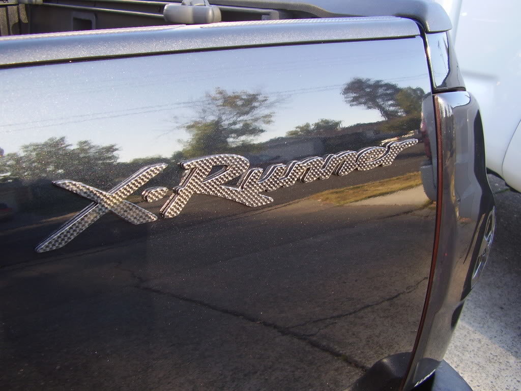

    When i de-badge my wifes truck i did it the day we got it so you couldnt see anything , but its also a white truck.. Now when i did my X-Runner i took off the toyota tacoma off a week after i got it and couldnt see it. 3 years later i took off the X-Runner and tried everything i could think of and it was still there so i got me a carbon fiber badge to cover it up

    Thats pretty sick man, great idea!
