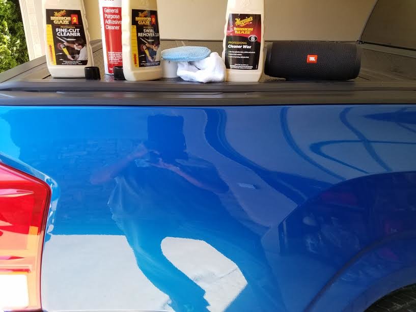

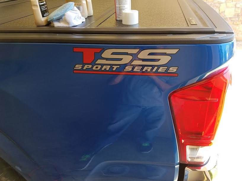

    Similar to other posts. Heat with hair dryer. Peel decal off. Then spray with this, let sit for 20-30 seconds, wipe off. Spray again, wipe again. Then put some touch-up wax in the area because you will have stripped it all off. It took me roughly 30 minutes to do both sides. I too like the clean look.

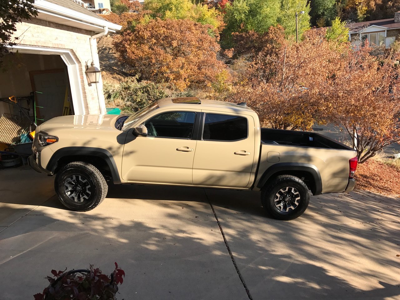

    Stripped her nekkid the day after I bought her. It's so easy even I can do it.IMG_0203.jpg
