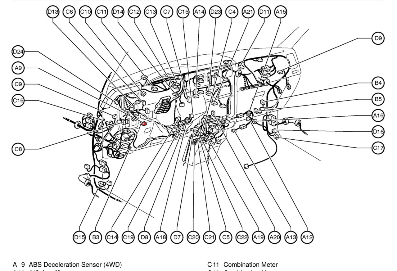

    I have a 2002 4x4 Tacoma with ABS, and I took it in to a shop for an intermittent ABS light and a strong pedal vibration when turning at low speeds. They said that it's the deceleration sensor, and quoted me nearly $1450 for the part, plus labor for a total of over $2k. What are the chances that it is the deceleration sensor, and should I have them replace it or get the part from a junked truck and do it myself?

    Did they say what ABS code it was throwing?

    It's less Tacoma and more mod
    I've never even heard of a deceleration sensor.

    That's certainly an accelerometer of some sort, but it's the brains of the airbags not the ABS. The yellow loom is a federal requirement denoting airbag function

    Oh. Yeah, you're right. I was confuddling the two. huh.

    I just heard back from him, he said it's code 44 and that he's tested the sensor and it's bad. I guess I'll just have to replace it and hope for the best.
