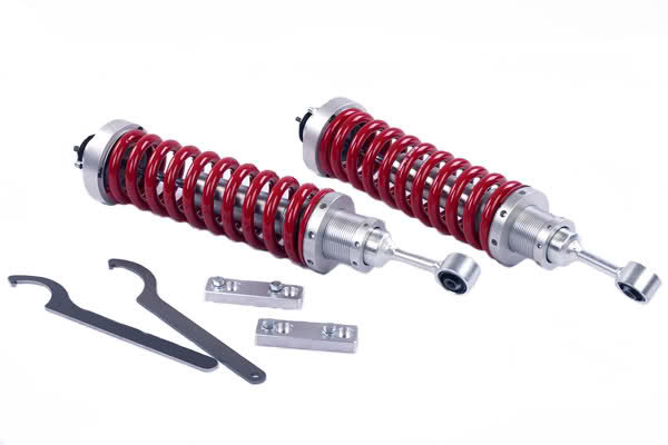

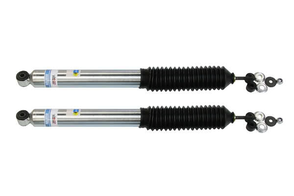

    ok i been reading all these threads the past few days and i have decided i'm gonna go with the toytec coilovers (gonna get the silver springs) and set them to 1.75" or close to that and put 5100 bilstein shocks in the back....not gonna lift the back..basically the toytec ultimate lift kit without the aal....i have a reg cab so no tsb for the reg cab...it is fine already...just trying to level out the truck a bit...but still want a little rake from front to rear so when i'm hauling something like an atv the nose isn't up in the air.... when you lift higher like 2.5 or 3 inches in the front you run into problems like having to buy uca's and cv boots wearing and alignment issues etc....i'm really anal about stuff like that...lol...anyways i can always aal later and change it if i decide to go that route

    well i talked to the toytec guys today and one was saying i should have a 1" rake from front to back from the factory but when i measure i have 2.5" or more...he says my front springs must have sagged some....i'm measureing about 5" from the front tire to the front fender and about 7.5" or more in the rear....also another guy from toytec suggested a 500lb eibach spring instead of the 600lb that normally comes on the coilover since i have a reg cab and don't plan on lifting too high....says it will ride much softer and smoother....so i'll keep this updated....trying to figure out how to get about a 3/4" rake instead of the 2.5" rake i have now front to back or close to that
    DA1210
    stock:
    measurements from top of tires to bottom of fenders: LF: 5" RF: 5 1/8" ........ measurements from the ground: LF: 34 1/2" RF: 34 5/8"
    .................................................. ....................... LR: 7 3/8" RR: 8" .................................................. . LR: 36 7/8" RR: 37 1/2"

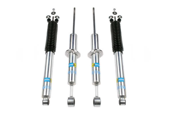

    well now i'm starting to second guess myself....i'm thinking it might be better for me to just go with the 5100s and set them at 1.75" instead of getting the coilovers...since that is what i would be setting the coilovers at anyways which could get confusing trying to get them exactly the same on both sides....so then i would have to decide whether or not to use the stock springs or the optional 500lb eibach spring that guy from toytec was talking about....does anyone know what the stock spring rate is???...i can't seem to find that info anywhere on here.....that one guy saying that the ride was kinda stiff with the 5100s is kinda what got me questioning going with the stock springs...but if the stock springs are 500lb as well i would just stick with the stockers...but if they are more than 500lbs i will go with the eibachs since it will make the ride less stiff
    the coilovers and 5100 rear shocks would cost around $1000
    the 5100s front and rear with the eibach springs would be around $500
    5100s front and rear would be about $300 (if using stock springs)
    right now everything is out of stock everywhere...5100s and coilovers.... so i'm trying to decide before they get them in stock again...lol

    keep your stock springs and set them at 1.75. Keep the cost down. In order to lift a truck there needs to be a certain amount of pressure on the coil. So if you use a softer spring you will need more preload to achieve the same amount of lift as a heaviers spring with less preload.

    Get the billy's and set at 1.75. From what I here the toytec coilovers are hard to adjust. U gotta take the tires off and probably need to people? Do u really need to be able to adjust alot? Save the $$ get the billy's with a taco leAn spacer and call it a day!

    well i been talking with the guy from toytec and he's saying it's better to use a lifting coil than to compress a stock coil as you will get a better ride and have more flex....so he is suggesting using a 500lb OME lifting coil to use with the 5100s...the 500lb eibach coil only fits the coilovers not on the 5100 shock itself..stay tuned

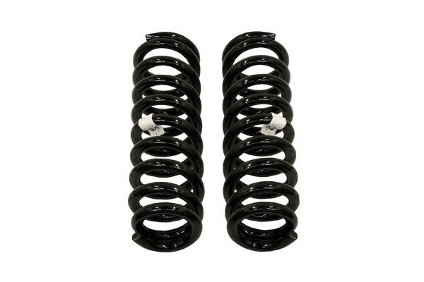

    yeah that's something i could do....i think the coils i'm getting are the 883 or something...or maybe 884...since i have a reg cab i don't need as stiff of a spring to get the lift or as long of a spring....i'll double check that...i know they recommend using the OME shocks with the 885 and 886
    edit: yeah they are saying go with the 883 springs on the billy's at stock height (0") and it will give me 1 1/2" of lift up front...i sent them an email asking if there would be much difference using the ome shocks and they said the ome shocks are made to go with the 885 and 886 stiffer springs....they said the 883 ome springs can be used with the stock shocks or the billy's at 0" setting

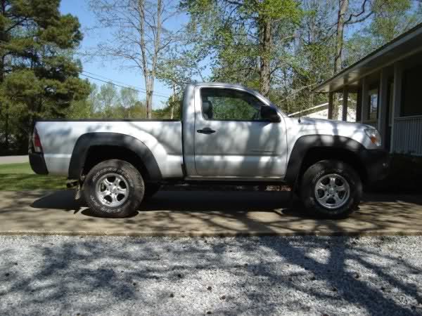

    ok i finally got some billys and got them installed today...they are set on the 0" setting on the billys and with the OME 883 springs they give around 1"-1 1/2" lift....they are perfect...the ride doesn't seem to be any stiffer than stock maybe a tad...still smooth over bumps and stuff which is what i wanted...and now i have about a 3/4"-1" rake which is what i wanted...about an inch higher in the rear than the front....looks awesome and works great...they should've come stock this way.....only bad thing about this is the installation cost...lol...all four shocks(5100 billys) and ome 883 springs costs about $475 to buy...the installation cost was the same...i guess it depends where you go but i went to the dealer...so total cost was about $950 to get it done...not too bad i guess considering my tires, wheels, and tire pressure valve stems i got put on cost around $2000 total...lol

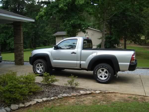

    a few pics
    before:
    after:

    Looks nice, thanks for sharing.
