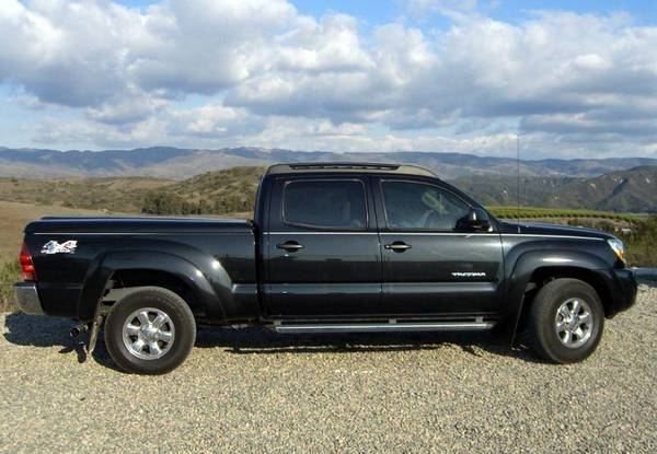

    By the way, I have 32" tires only. I think 33" will look much aggressive but there will be rubbing. Check out the build section, so you can compare and decide the look you want. Meanwhile, here are pics of my truck in different heights.
    Stock
    Bilstein 5100 at 1.75" with 32" tires
    ICON at 3" with 32" tires

    damn the third liooks sick thats whats going down....Thanks
