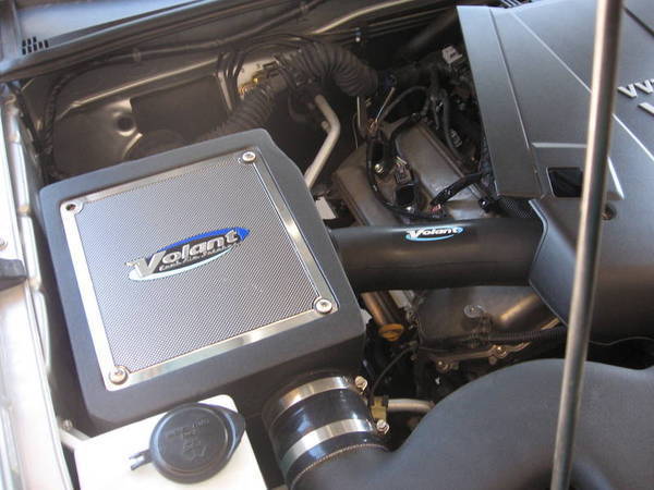

  18. Oct 2, 2008 at 2:18 PM
    #18
    it's in coma
    it's in coma Well-Known Member
    Apr 18, 2008
    #6047
    627
    in the desert
    06 trd off road
    intake and exhaust
    this is my intake, would this mod work for me:
  19. Oct 2, 2008 at 5:01 PM
    #19
    tacomaman06
    tacomaman06 Carolina Alliance: Enforcer
    May 1, 2007
    #1475
    26,212
    Will
    York,South Carolina
    '16 Tundra TRD Pro
    getting there....
    :D............nope....you dont need the deck plate mod!!
