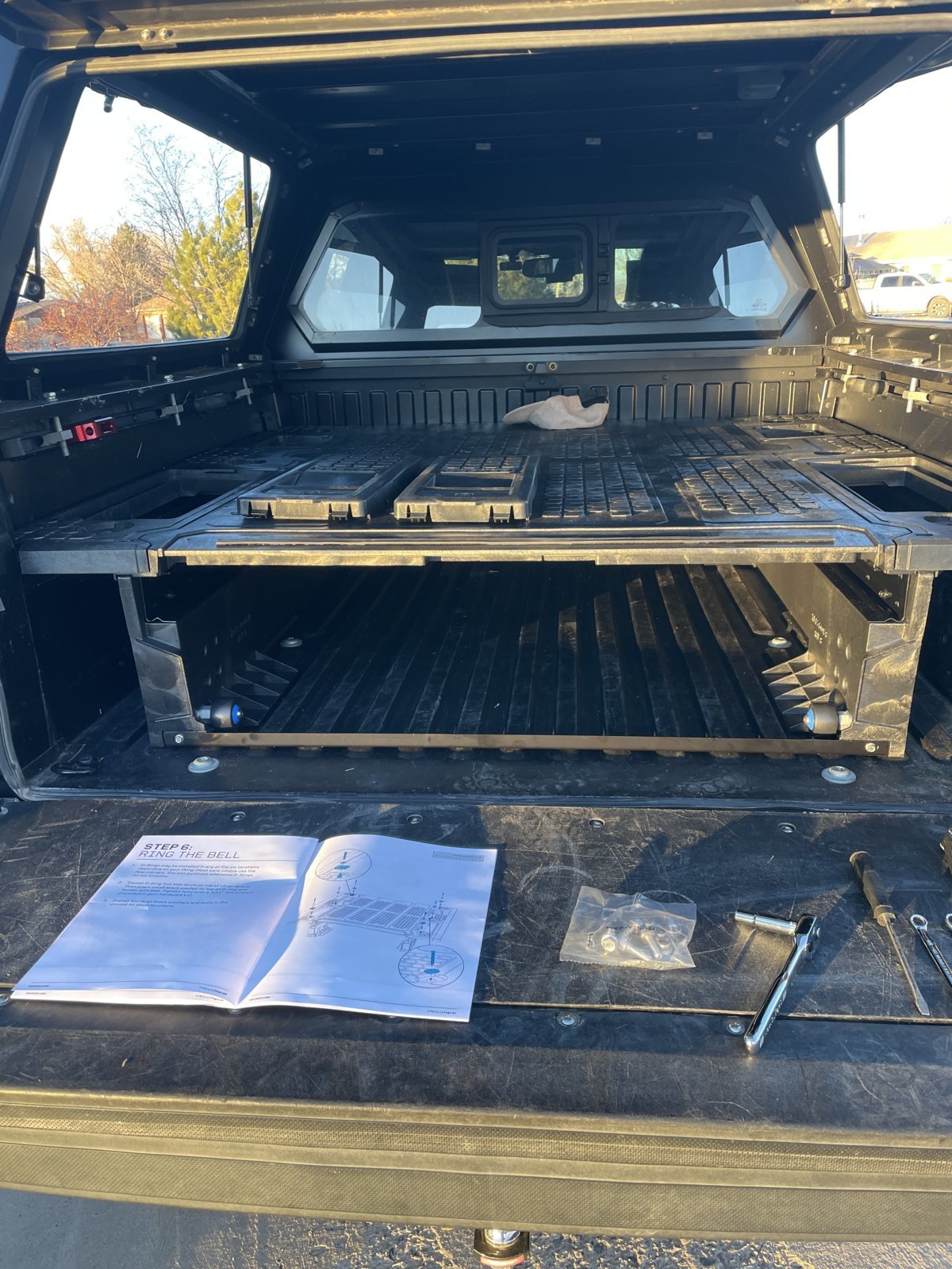

    I just finished installed the new decked 2.0 in my Tacoma, 2020 short bed.
    Delivery was great and easy.
    I read the instructions.
    Laid out all the parts and pieces. Made sure to re-read instructions and follow along each page as I proceed with the installation.
    Everything was pretty straightforward.

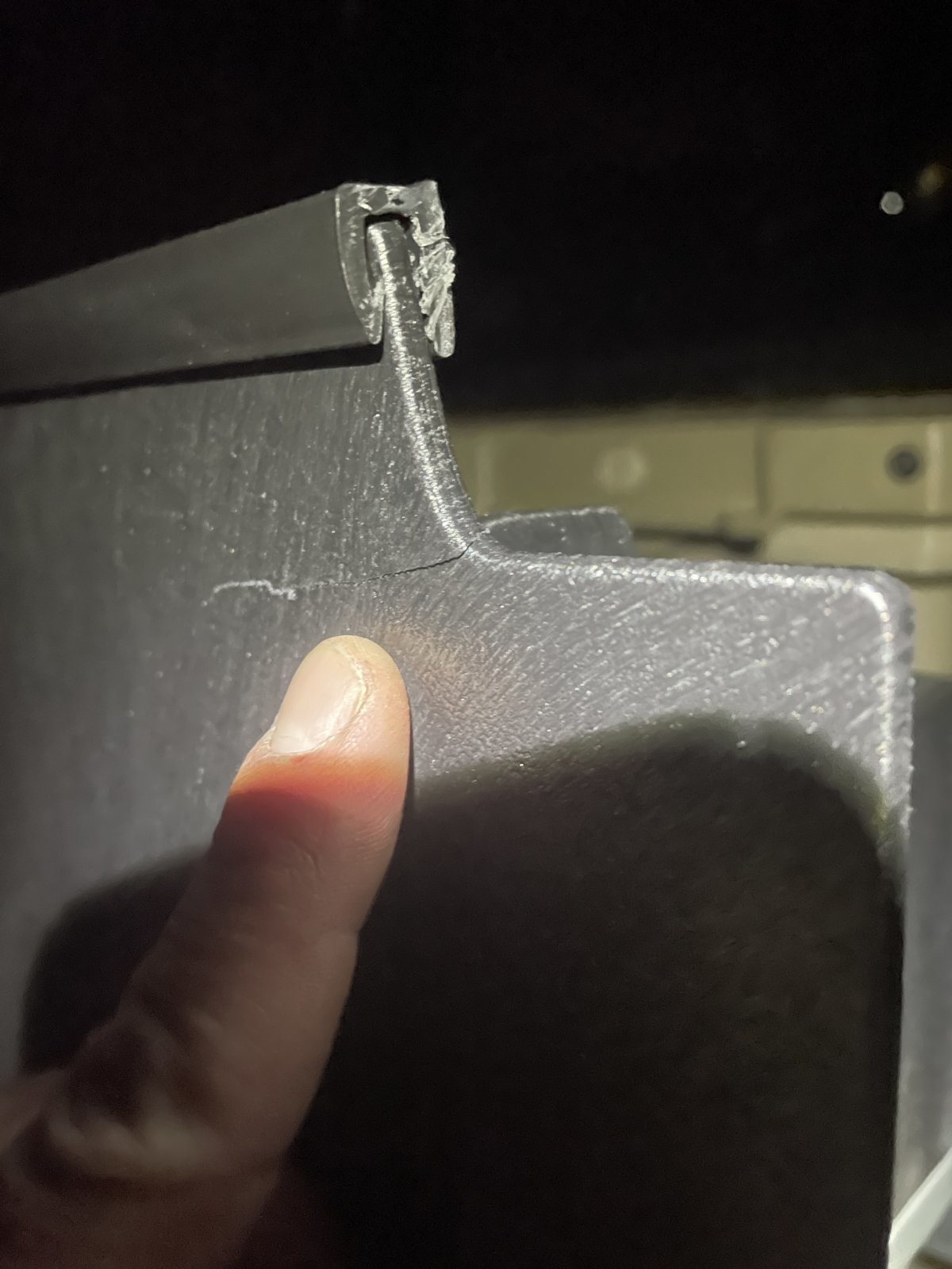

    At the very end, when inserting the drawer it just did not want to close. The weather strip wasn’t pushed down all the way. So I gave it a good seating and tried to close the drawer again. It went but needed force to close. It feels like it requires too much force to close shut.
    I wanted to include that the weather stripping tolerance is too tight and that the "ramp" side of the weather stripping ripped off when I closed the drawer. No image of this yet, but will update later. (update: you can see the weather stripping in the cracked photo - it is missing due to ripping off when closing)
    Also, the face of the drawer has already cracked…. I think from just opening and closing the drawer. I’m a little bummed about it already cracking and filed a warranty claim. Day ONE.
    @DECKEDUSA I’d love to hear any feedback or suggestions for a hard to close drawer
    Also waiting for warranty claim response. It’s a holiday week so might be next week sometime.
    Stay tuned.
    Install photo:
    Crack on the drawer face, top right corner. Not sure why this even happened.

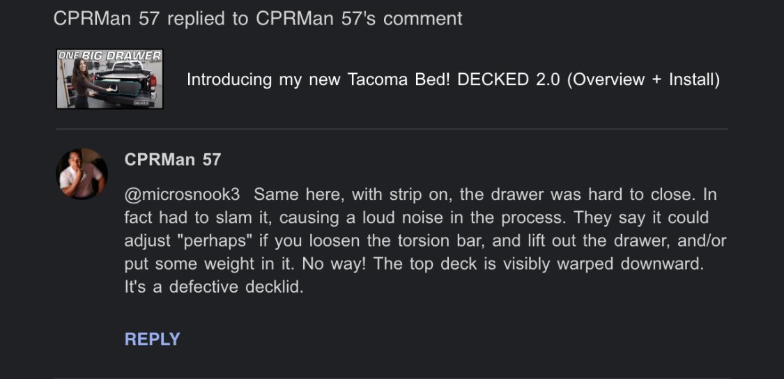

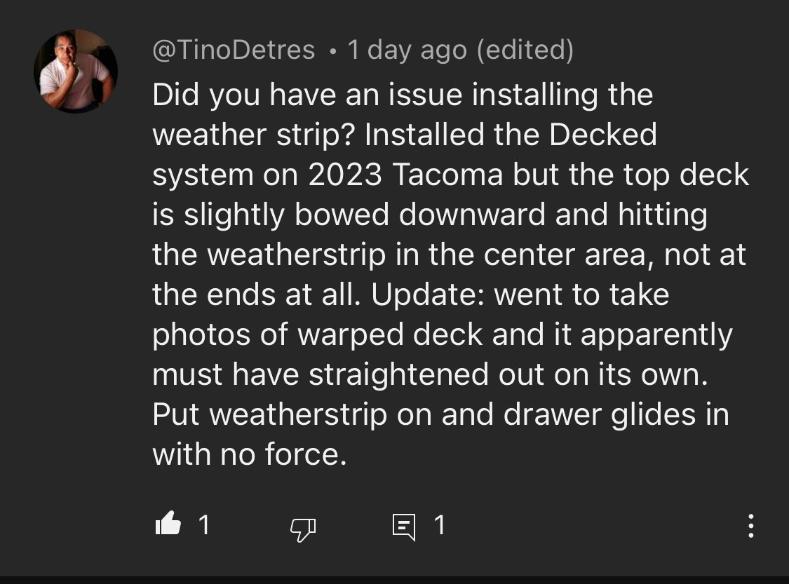

    I wanted to update, after posting to youtube and reading some of the replies to my comment. It seems that I am not the only person experiencing this exact issue. My deck seems to be warped downward in the middle and thats where its having trouble closing. The following day, this same person reported that the deck fixed itself somehow and the drawer closes without any more issue. I haven't checked on mine yet but will shortly and report back.
    Just glad I am not the only one experiencing this. But now I might be after his latest update.
    Here are the screenshots of the comments:
    @DECKEDUSA

    My warranty claim was responded to within 24 hours.
    They just needed to know what to send out and to verify address, etc.
    They should be sending out a new drawer along with a new strip of the weather stripping for on top of the drawer.
    I loosened my torsion bar and operated the drawer several times and re-tightened it. Now the operation of the drawer feels as it should. Smooth opening and closing. Just need to replace the cracked drawer face and weather stripping and it should be perfect.

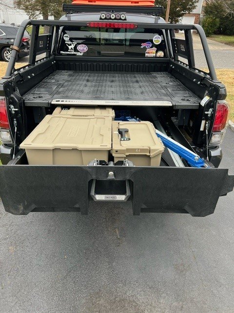

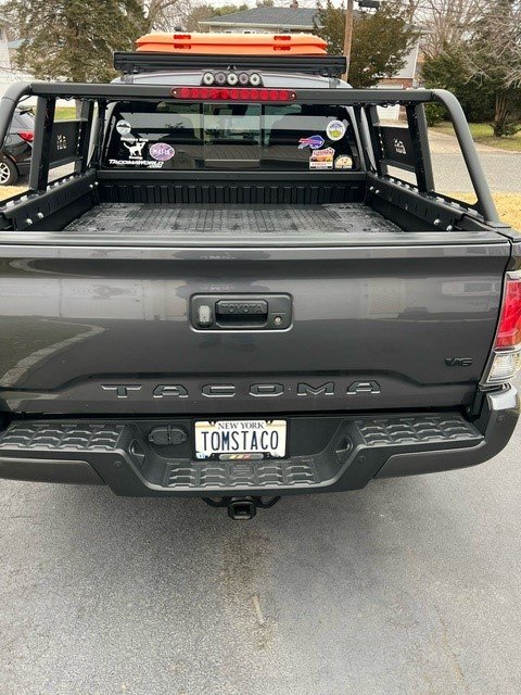

    A bunch..and no build thread!
    Just installed my Decked system Saturday. My weather strip is too tight and jams the drawer up. I am going to try and take the torsion bar off and try adjusting it, but other than that, it is phenomenally easy to assemble and the instructions (both written and the video) were top-notch (and funny). I did buy the optional locks for the drawer and cubbies.

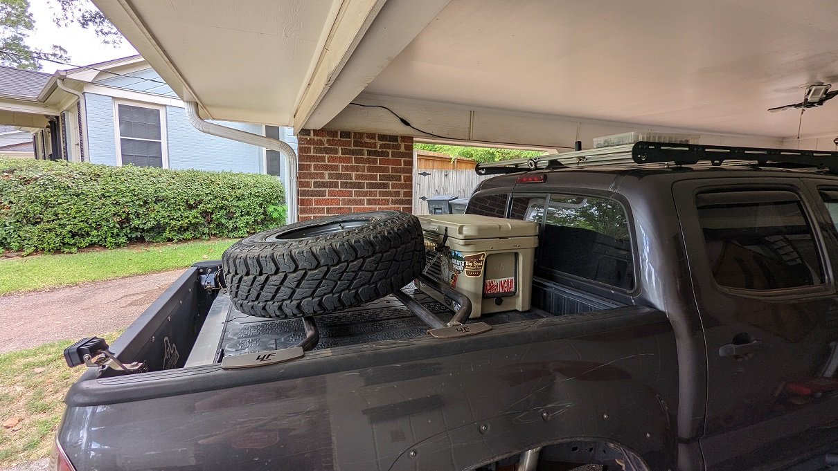

    What is this tire carrier? I need that.
