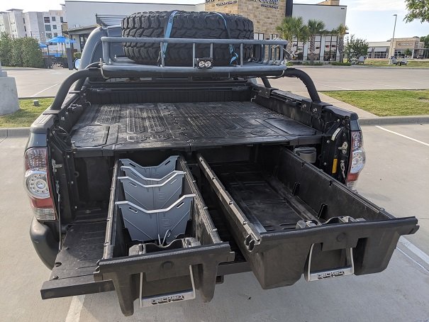

    Finally picked up a DECKED System for the truck... took it home on Sunday, uninstalled it that night, then started to get the outlets and so forth ready for the system to go back into the truck.
    One of the previous owners of the system had gone a little crazy with the Dremel I guess.

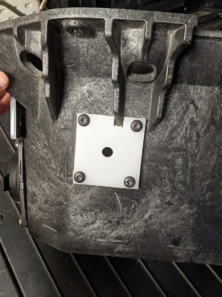

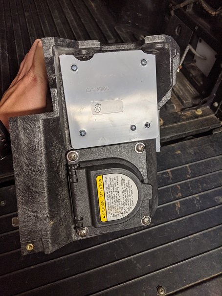

    I had to do better and make some covers for the giant holes they had put in the passenger side ammo can (forgot to take some before pictures of the butchering of it). One cheap IKEA cutting board later and a 2 gang waterproof electrical cover... way better and looks a lot cleaner.

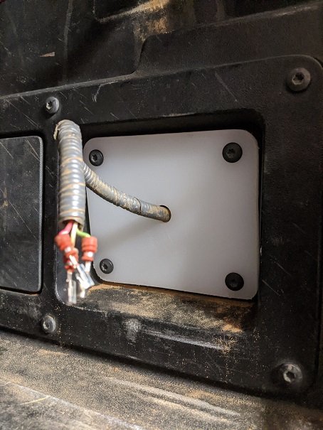

    Took me about a minute to take apart the wiring connector to be able to just run it through a 1/2" hole instead of what they had done...
    Also made a cover for the hole where the electrical outlet was.
