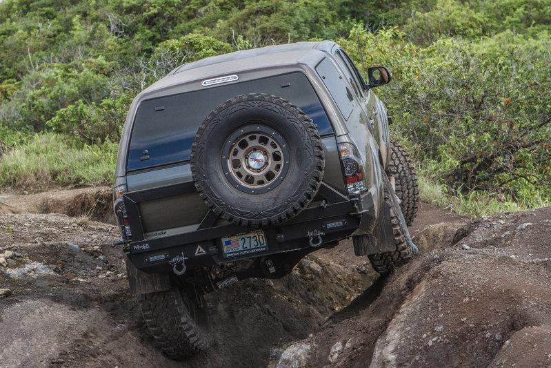

    How it looks today on 37's:

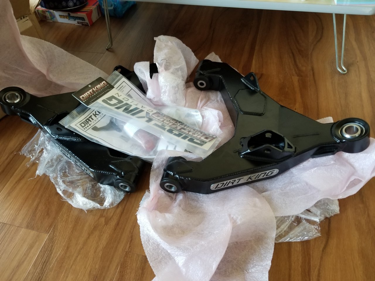

    Suspension: ADS 2.5 Coilovers, extended travel, w/resis/clickers, 650lb springs
    ADS 2.5 rear shocks, w/resis/clickers, 26.5" ext, 16.25" coll.
    Icon tubular UCA's
    Dirt king V1 LCA's with Kartek limit straps
    Icon 2.0 VS Alum extended rear shocks w/resi's. 26.8" ext, 15.9" coll. (sold)

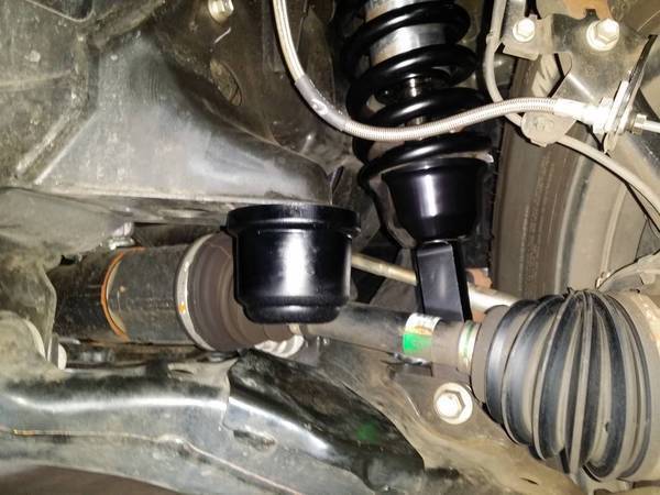

    Front super bumps w/one-off aluminum spacer made by Bullaculla
    Rear super bumps

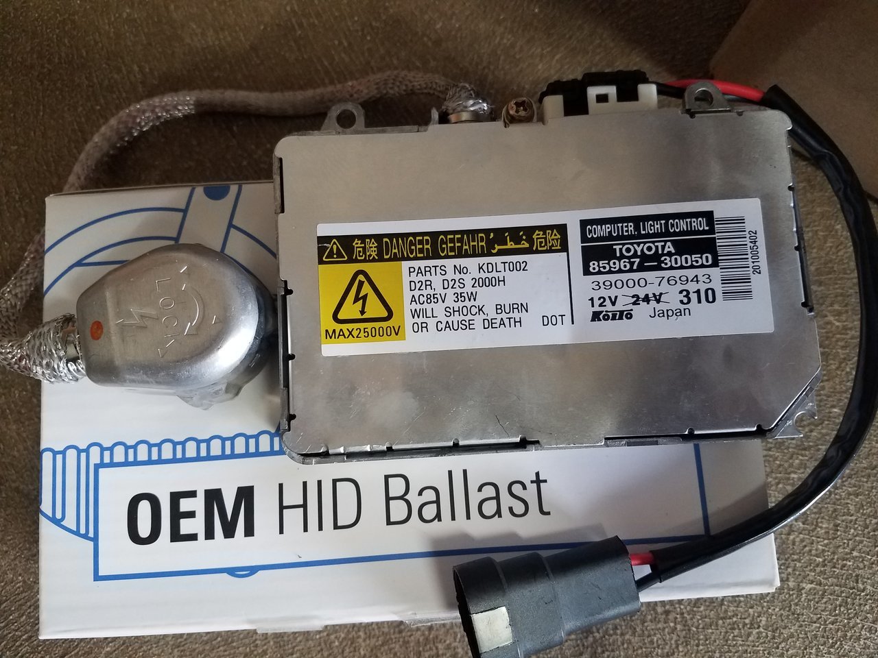

    HID retrofitted D2S headlights. 35W

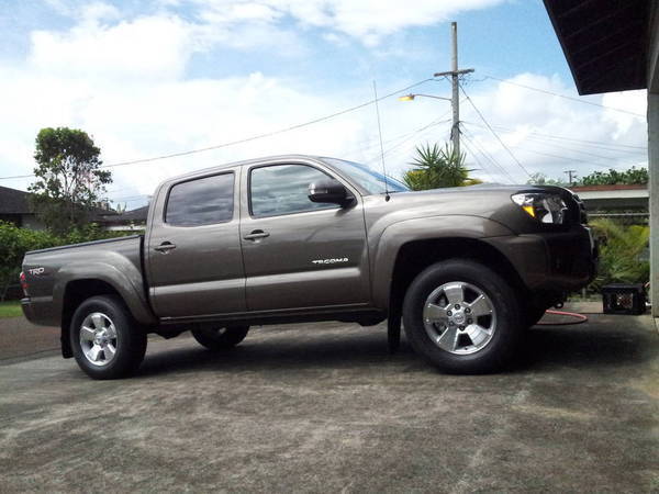

    Day I brought it home:

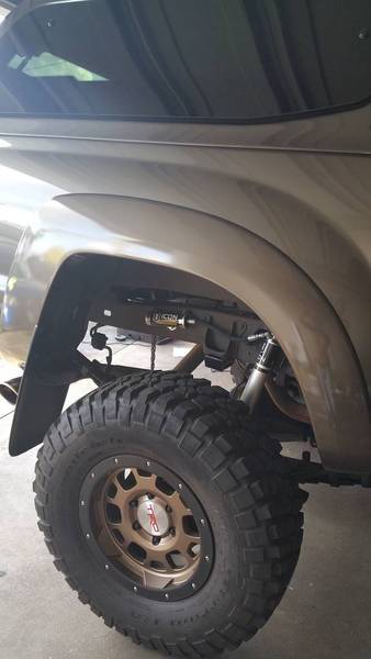

    Threw on some 5100's, TRD bronze wheels with 265/75/16 KM2's, and some N-fab steps.

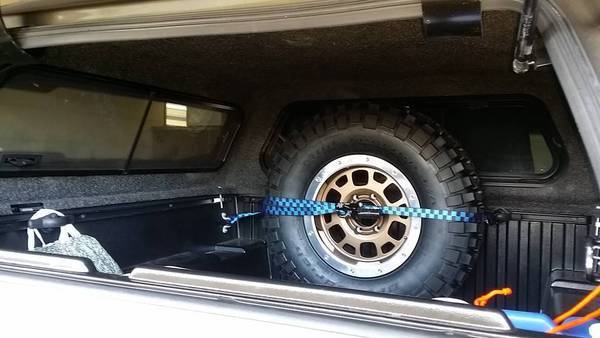

    Got a matching wheel for full size spare:

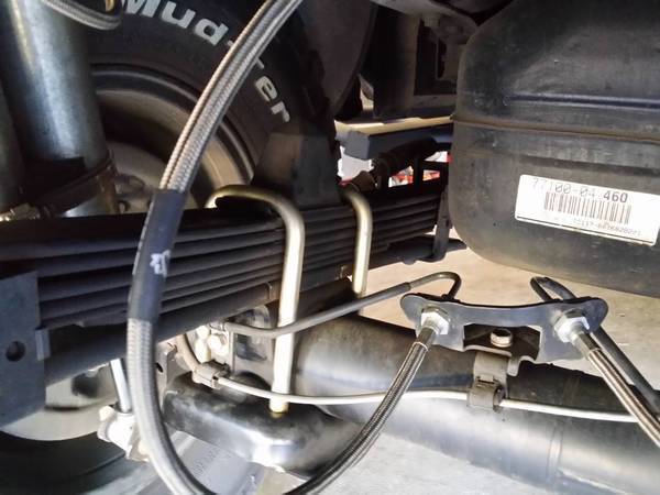

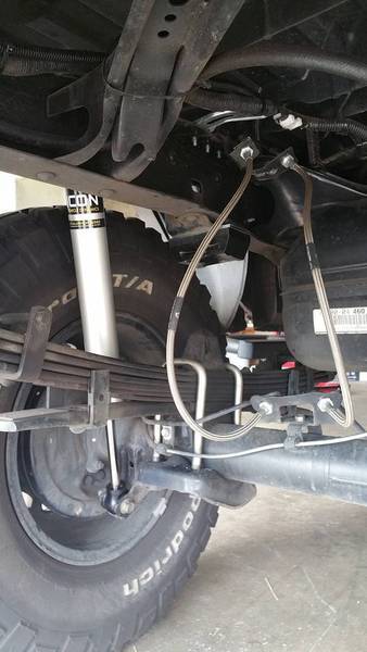

    Crown Extended brake lines:
    Wheeler Super Bumps:

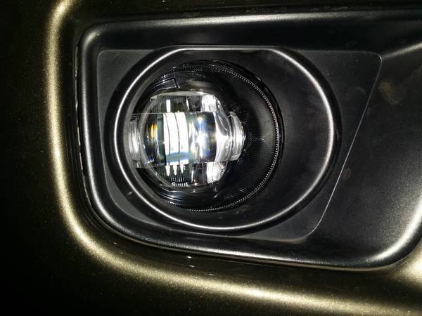

    LED fog assemblies from Retrofit Source:

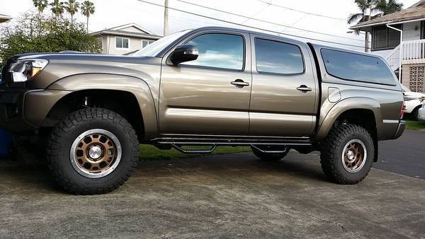

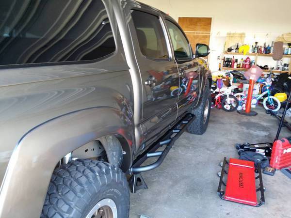

    Installed some BAMF sliders:

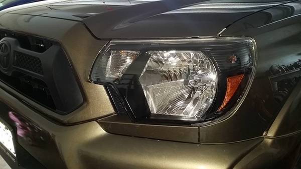

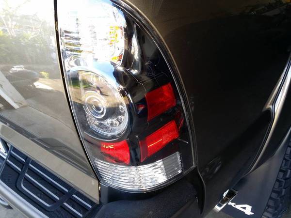

    Black tail lights from Amazon to match BHLM:

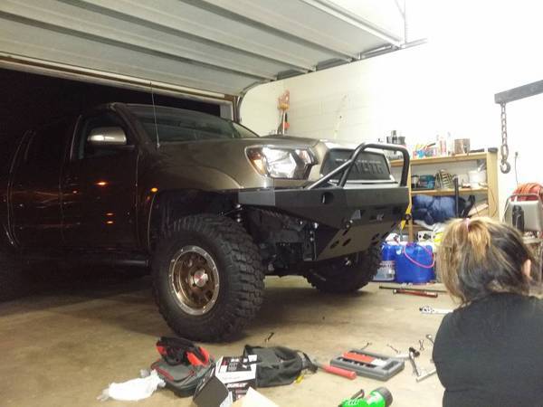

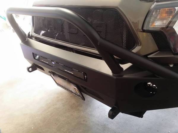

    Got my front bumper on:

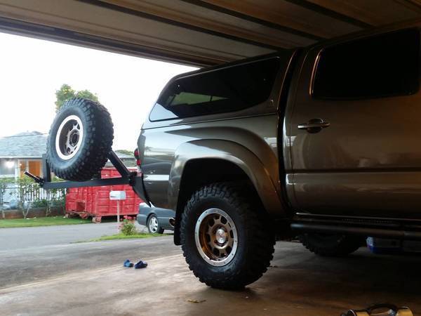

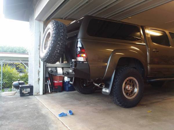

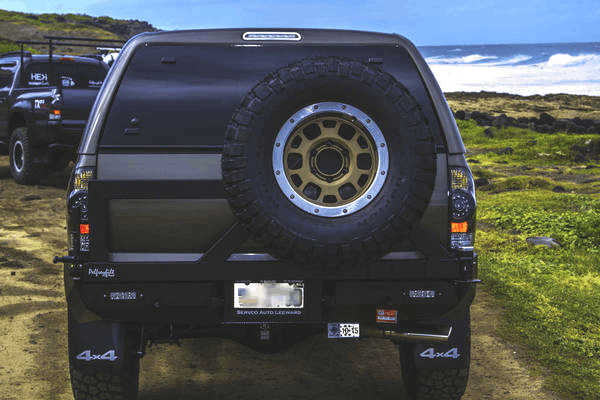

    Also got the rear w/swingout on:

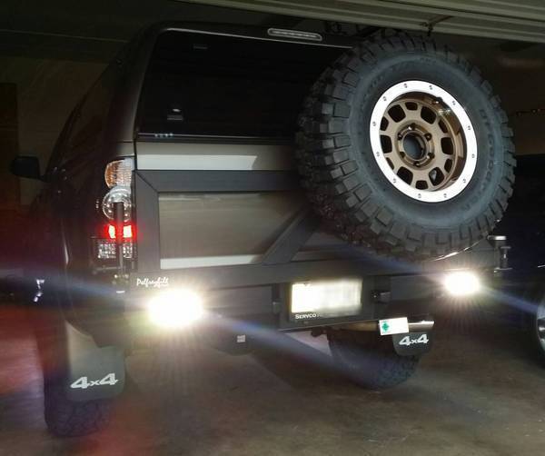

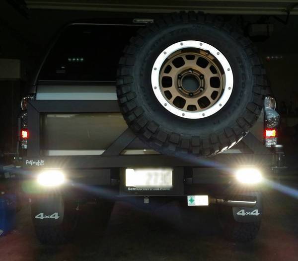

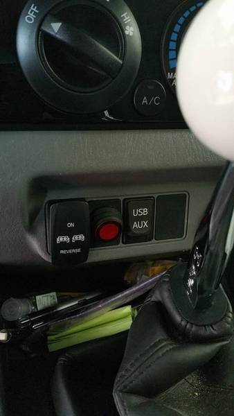

    Wired the Rigid SRQ reverse lights. Used the 3-position switch that came with the lights. The switch can be always on/ off/ on with back-up reverse/camera. The switch illuminates if the lights are on.
    I'm going to replace the switches with ones from OTRATTW soon.
    SRQ lights are brighter than I thought they were going to be:
    Relocated the reverse camera to the swing-out.

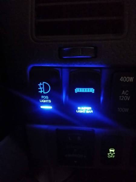

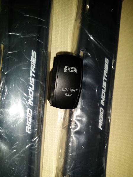

    Got my bumper light bar covers and rocker switch. Just need the light bar.

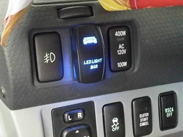

    Bumper led bar switch got installed next to the stock fog light switch. Tapped into the AC control dimming circuit so the lights on the switch can be dimmed with the rest of the dash lights.

    OTRATTW custom 3-position reverse switch installed. The Rigid srq wiring was used, just have to add a couple illumination wires so the bottom leds come on with AC control lights.

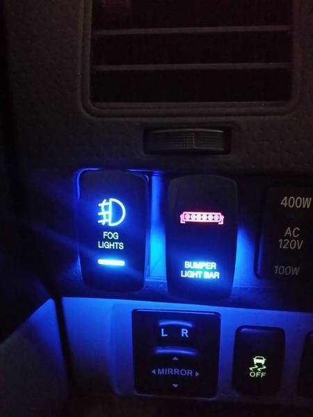

    Got my fog light and bumper led bar switches (matching brands) installed:

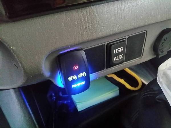

    Did the reverse camera on anytime mod. Used the dpdt switch that came with the rigid reverse lights.
    Installed a custom OTRATTW switch for the "camera anytime". Up is on, middle is off, and down goes on when in reverse

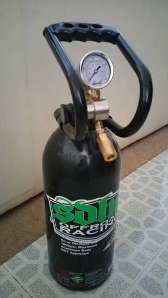

    Picked up a 10 lb Co2 tank. It fills tires fast!

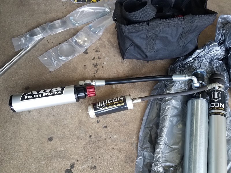

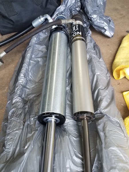

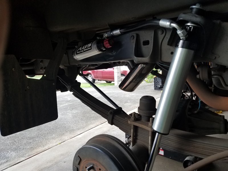

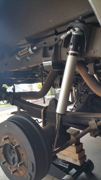

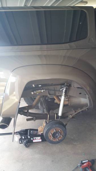

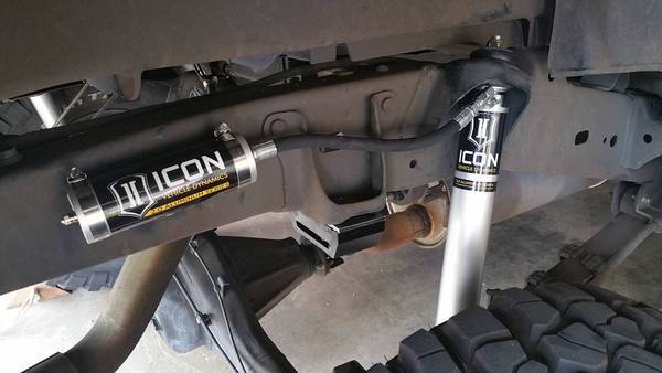

    Installed extended Icon 2.0 VS rear shocks w/ resis. 26.8" ext, 15.9" coll. Way more travel now but the leaf pack is limiting it. These shocks are actually for the Allpro leaf pack I have on order. Should be perfect for it.
    I cut down a polyurethane bump stop to the height needed to keep the shocks from bottoming out until the Allpro leaf pack gets here.
    Flexed it out and there's a lot more down travel than before:

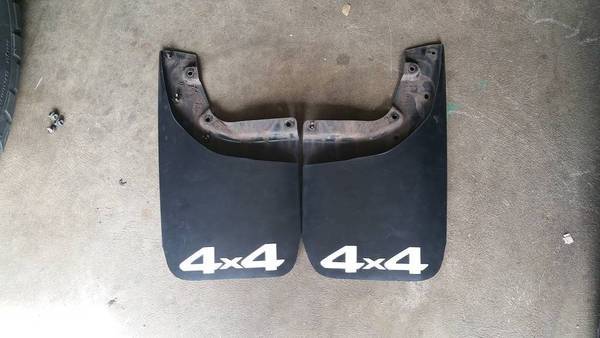

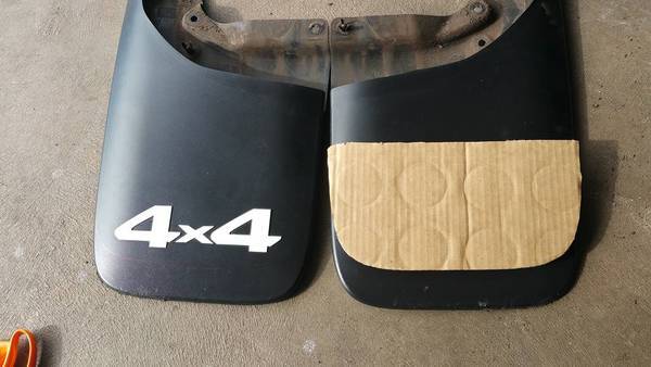

    2/22/15: Trimmed mud flaps today. The bottoms of them were getting shredded so this should do the trick.
    I think it looks better anyway.

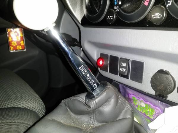

    6/20/15: Shifter relocation bracket installed. This moved the shifter about an inch to the rear and toward the driver. Seems like a more comfortable shift for me now.

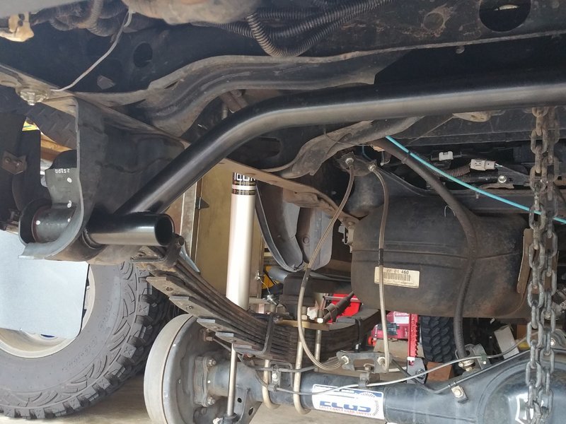

    Droop with the extended Icon 2.0 RR and Allpro Standard leaf springs:
    Rear Icons at bump:

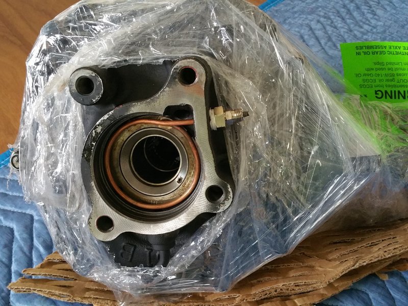

    7/14/15: Got my shipment from ECGS. 3rd member geared 4.56 w/ARB air locker and front clamshell w/ECGS bushing.
    The rear swap wasn't that bad:
    The front clamshell was very time consuming and I think requires two people. There's a lot of nuts and bolts and crap that has to come off before you can drop the clamshell:

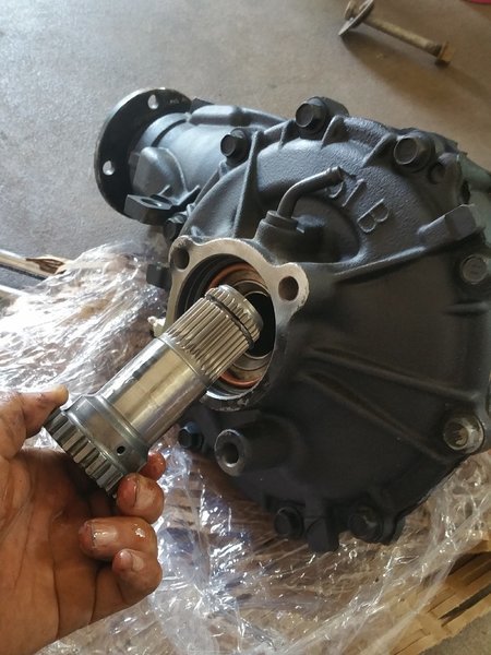

    There's a gear and shaft that has to get swapped over to the new assembly. This is the diff before the gear was swapped over:

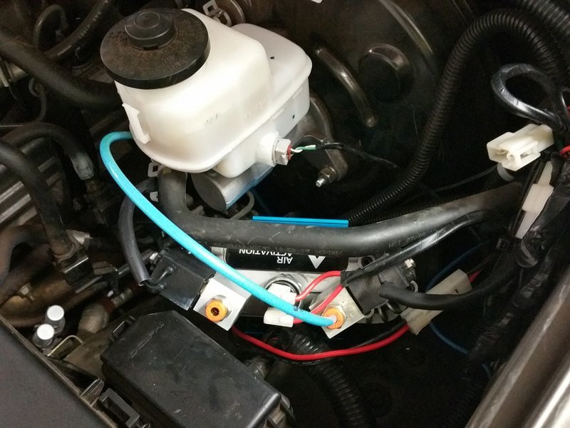

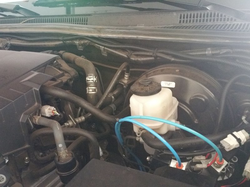

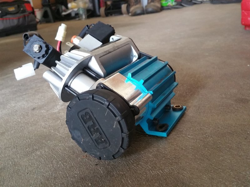

    Mounted the compressor:
    Ran the air lines along the brake likes all the way to the rear end:
    Installed the compressor and locker activation switch under the AC controls. I'll be getting OTRATTW switches to match the rest soon:

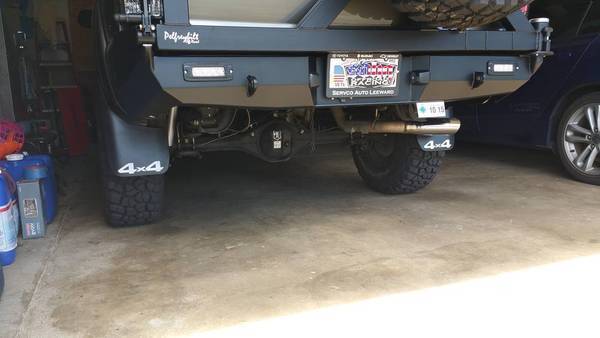

    9/24/15: Installed Rokblokz Universal XL mud flaps. Just the rears needed for inspection here. I used some scrap aluminum L-angle to make some brackets to bolt them to. It seems to be the only way since I cut my fenders.

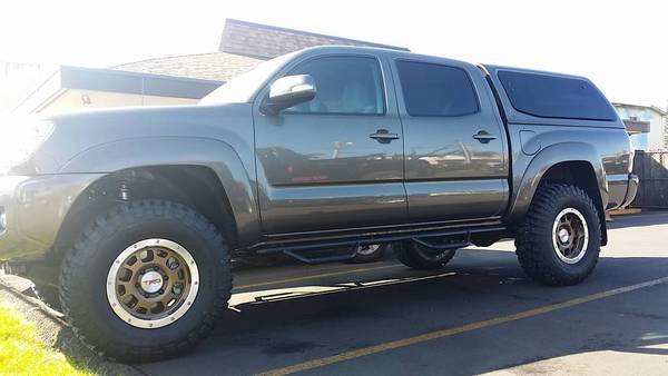

    9/30/15: Got my 35's in! Going to get them mounted and balanced with Dyna Beads:
    10/1/15: Mounted and on the truck
    The truck also passed recon and safety inspection like this. The tire rubs the UCA slightly so I installed .75" BORA hub centric wheel spacers.

    2/27/16: Finished up my retrofit. D2S projectors w/Apollo shrouds and backlit amber halos.

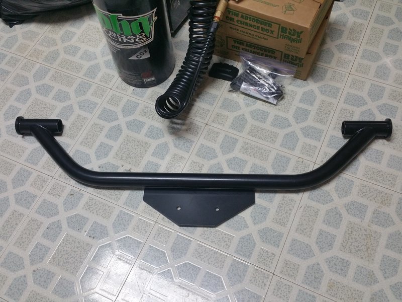

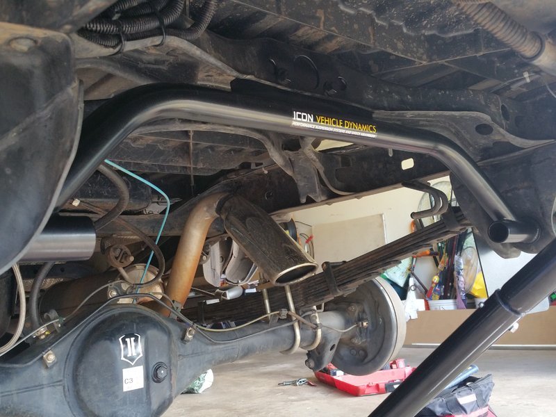

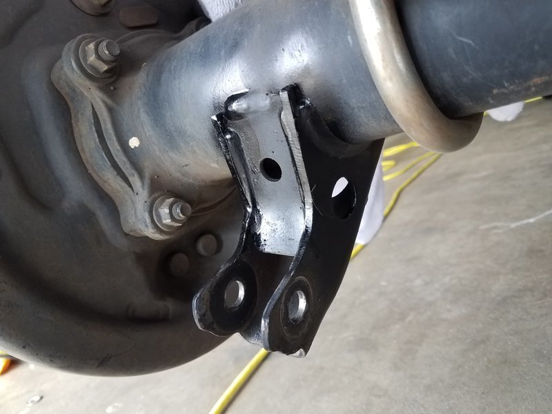

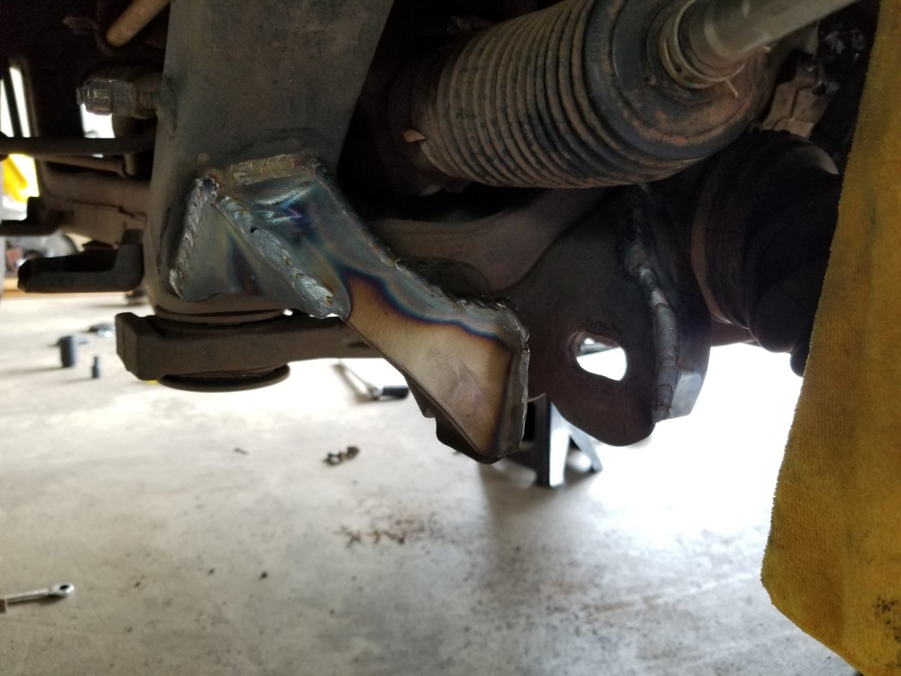

    7/30/16: Defined Engineering's shackle hangar support brace installed:

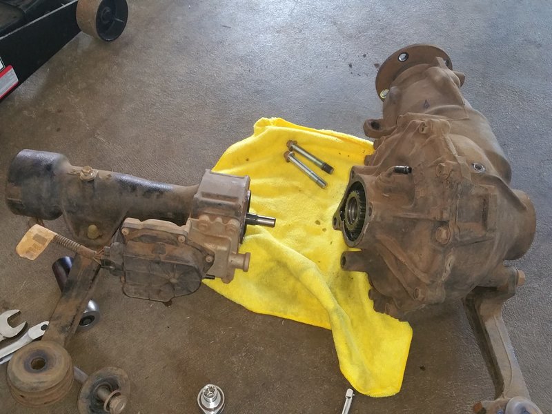

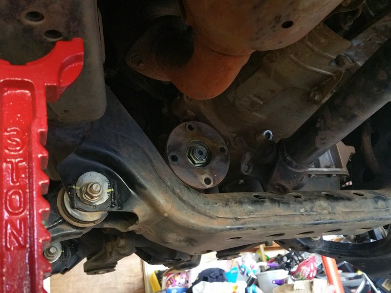

    8/13/16 Front diff swap w/ARB air locker. Fresh out of the box:
    I had to clock the air compressor to fit under the brake line hoses:
    Front locker switch wired up:
    Removed cv's:
    Unbolted front driveshaft:

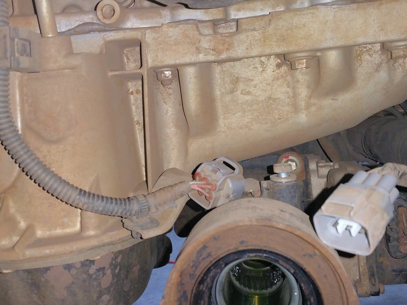

    This is the wire harness connector on the passenger side of the diff that needs to be unhooked and it's bracket unbolted. There is also a bracket on the driver's side that needs to be unbolted and have the vacuum lines unhooked. These are both on the top side so it helps to unbolt the front of the diff supports so you can swing the diff down to make a little room.
    Old diff w/ tube unbolted to be swapped over to the new diff:
    This stub shaft has to be removed from the old diff to be swapped over also:
    And finally, I plumbed the new air line and tested for leaks:

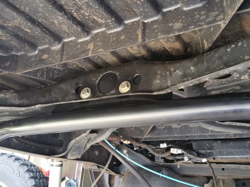

    9/2/16: Total Chaos bed stiffener/tie down brackets:
    It bolts in using one factory bed bolt on the bottom and a 10 mm bolt up top. Three 5/16" holes need to be drilled on the vertical sheetmetal side of the bedside and bolted down with bolts supplied with the kit.
    I figured this might help with the bed twisting when wheeling with the Leer cap on.

    After relocating the battery, I could take all of the extra preload off of the driver's side coilover that was needed for "tacolean". The truck is totally level with the same preload on both sides.

    Installed ADS coilovers and rear 2.5" shocks:

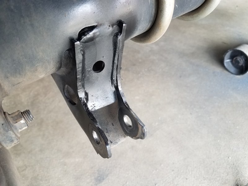

    I had to grind and clearance the lower rear shock mounts on the axle for the larger shocks to clear at full bump:
    Since I had my steering fade on the last wheeling trip, I installed a steering rack fluid cooler I got from bullaculla:

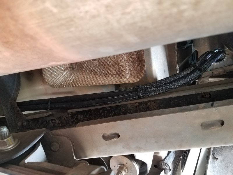

    Picked some flexible air duct and fittings to route to my intake box so it wasn't sucking hot air from under the hood. I routed it behind the passenger headlight so it gets blocked from rain and what not:
    The Donaldson filter I'm using did a good job of keeping crap out. The engine side of the filter was spottless:

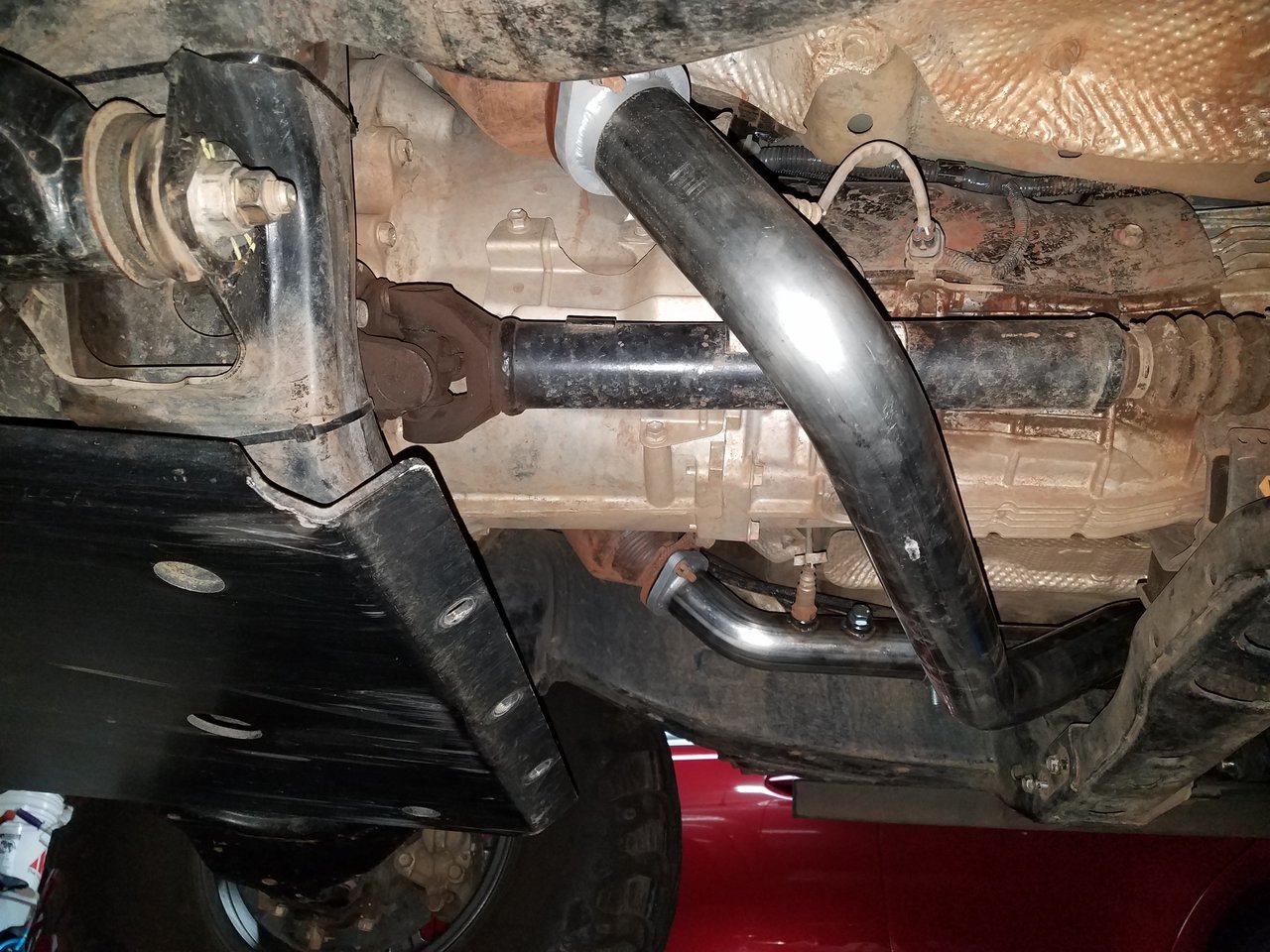

    9/9/17 Installed URD Y-pipe and intake manifold spacer:
    10/1/17 Got new Osram HID bulbs and OEM Toyota ballasts to replace my old setup. The new Nightbreaker bulbs are less blue than the old CBI bulbs and should provide more visibility in rain/hazy conditions. And the OEM ballasts are waterproofed from the dealer and should last a long time.

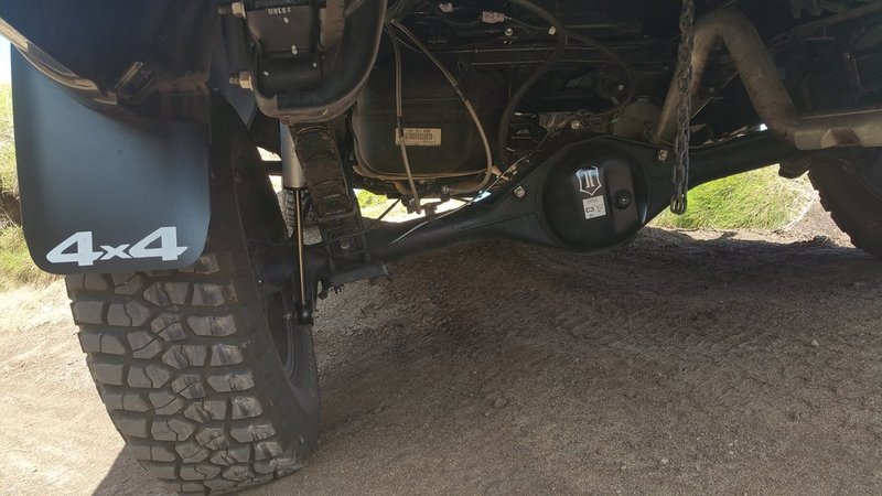

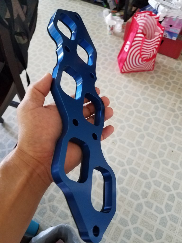

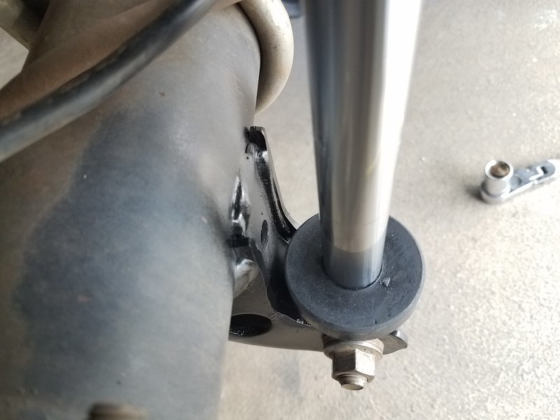

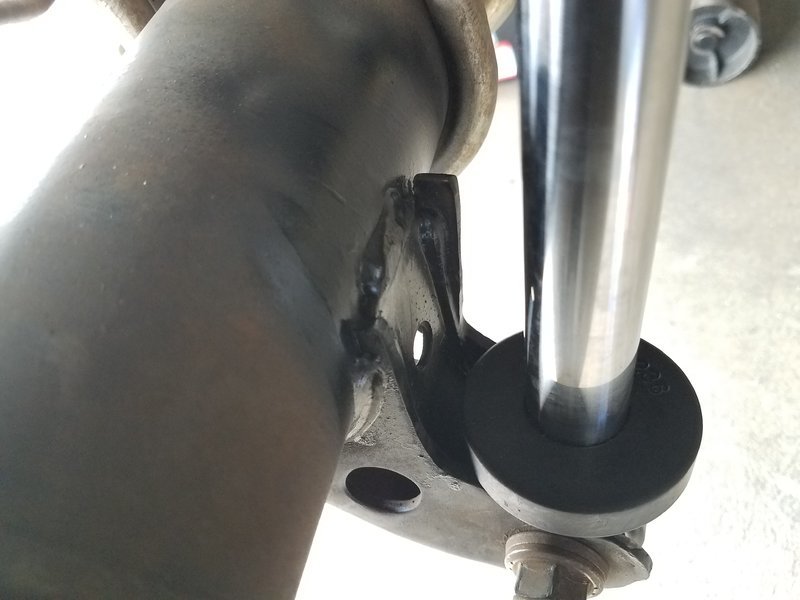

    Afterstaring at and comparing the amount of shock shaft on the rear of my truck, I noticed that the Allpro leaf springs locate the axle more rearward than stock. This wouldn't be a issue if I had relocated shock mounts, but I am using the stock mounts that have the pass angled to the front and the driver to the rear. I picked up these axlerelocation plates andmoved the axle forward 3/4".
    It was a bigger project than expected because I had to relocate the u-bolt flip plate forward also, which needed another 5/8" hole drilled/relocated. I also needed to cut off the excess threads on the center bolt that holds the leafs together so the Wheeler's bump stops could go back on.
    It worked out and now the axle is located equally between the top shock mounts and wheel wells, and the shocks now have close to the same shock shaftshowing. It also keeps both the rear shocks closer to the same angle instead of before which had the pass side angled more than the driver's.
    Before:
    After:
    The plates also added 3/8" of shock shaft because it added that thickness to the leaf pack. So, I will be cutting down the rear bumpstops to not waste any shock travel.

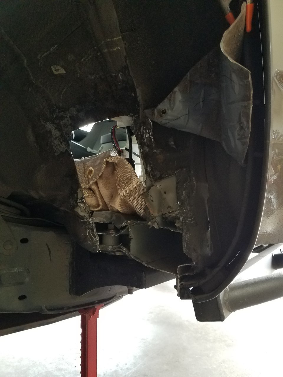

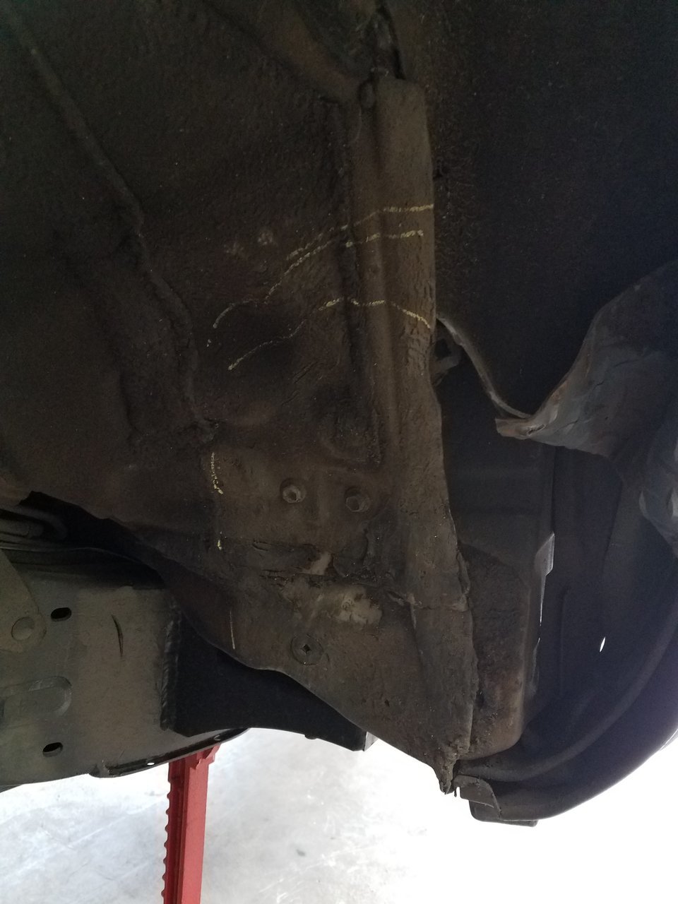

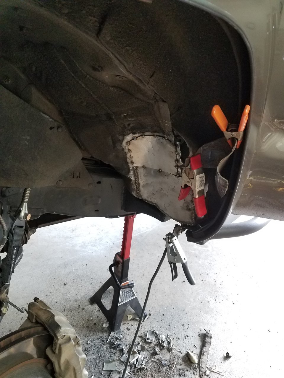

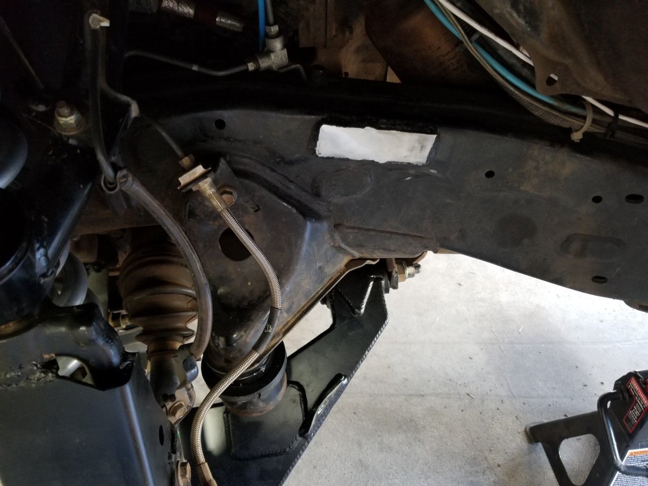

    3/5/18: I've been cutting and "tubbing" the inner fenders in preparation for the 37's.

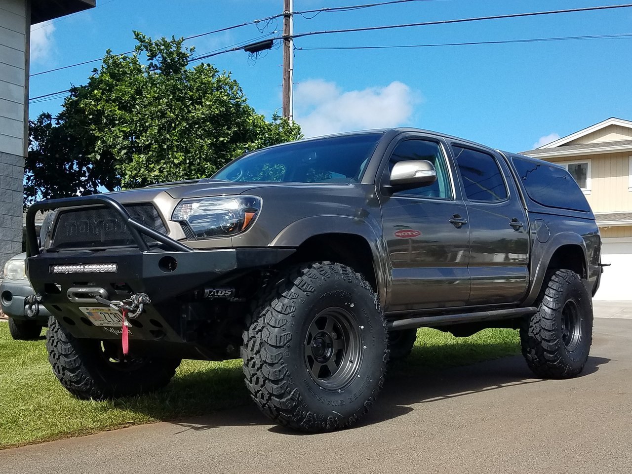

    37's!:

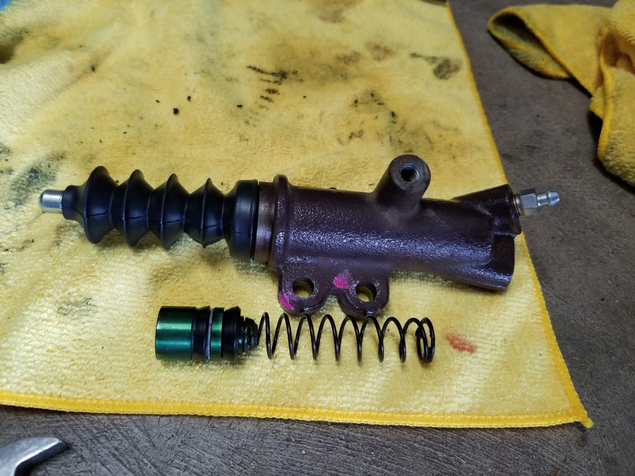

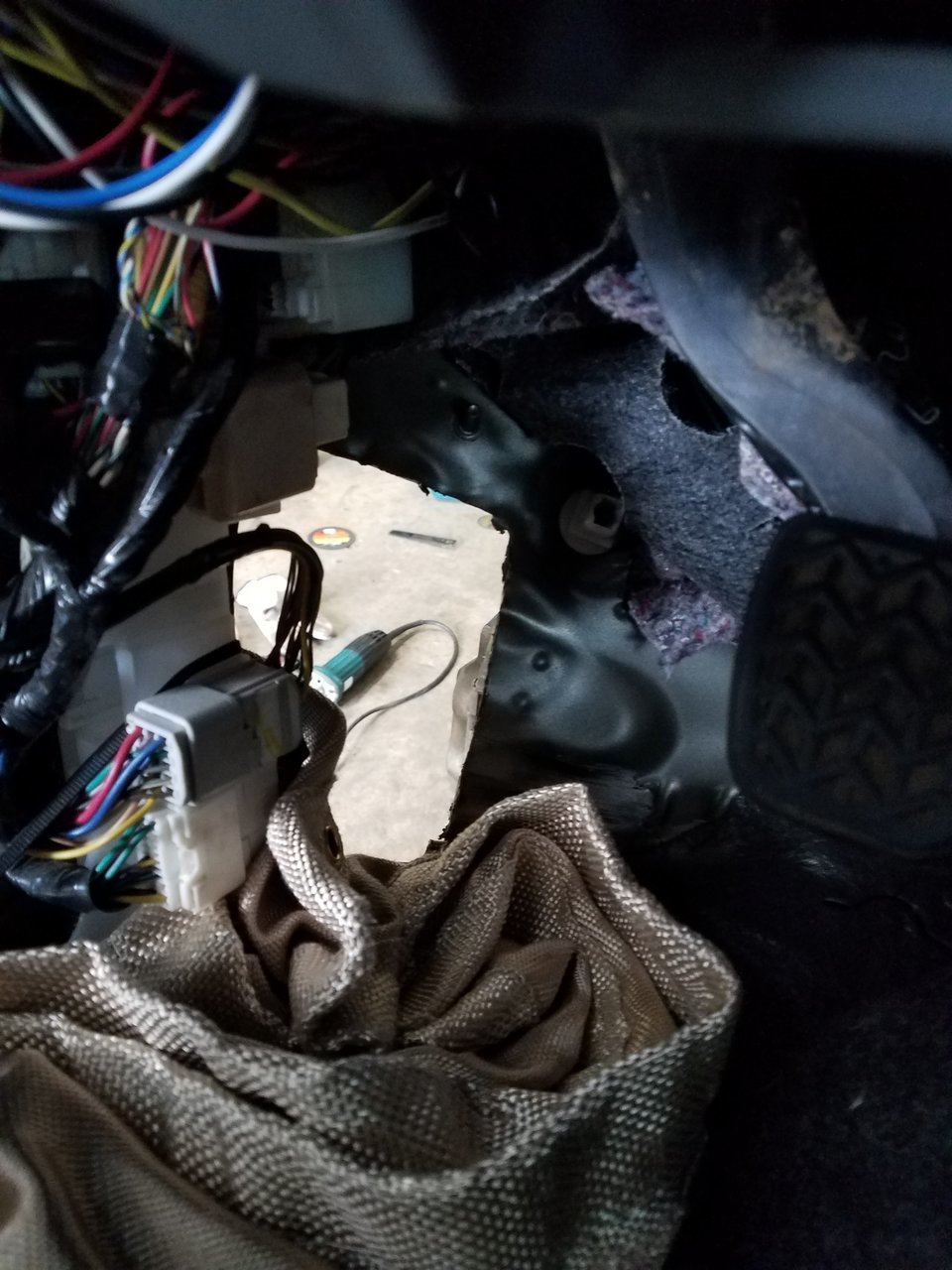

    5/28/18: Clutch master cylinder crapped out. Kind of shitty to change out since it is under the clutch pedal in the cab and hard lines travel through the firewall.
    Also changed the slave cylinder:

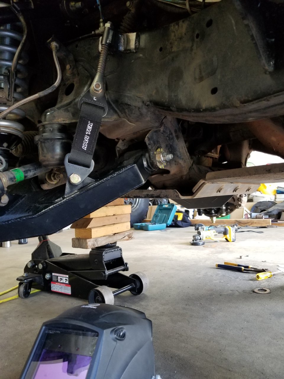

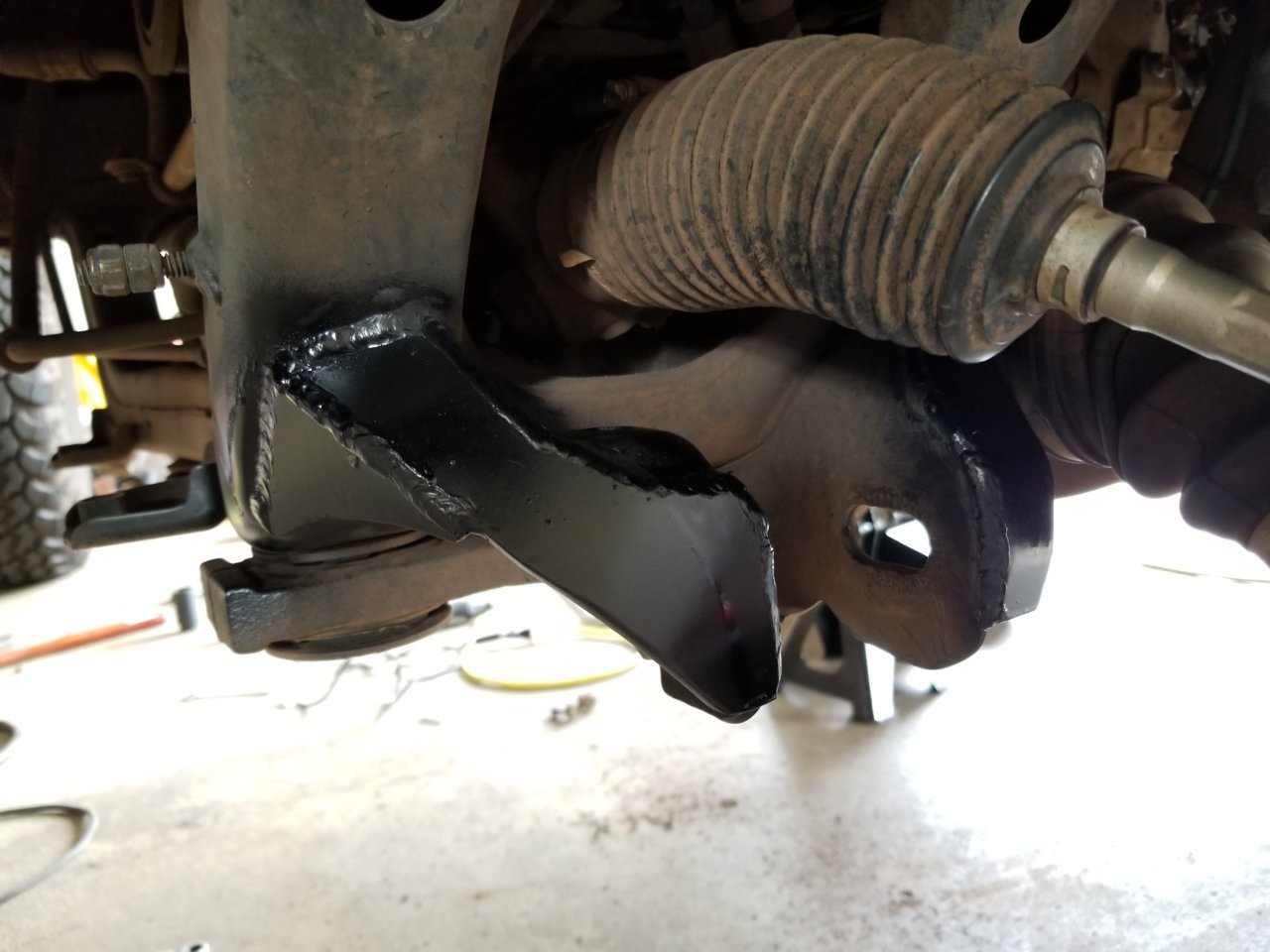

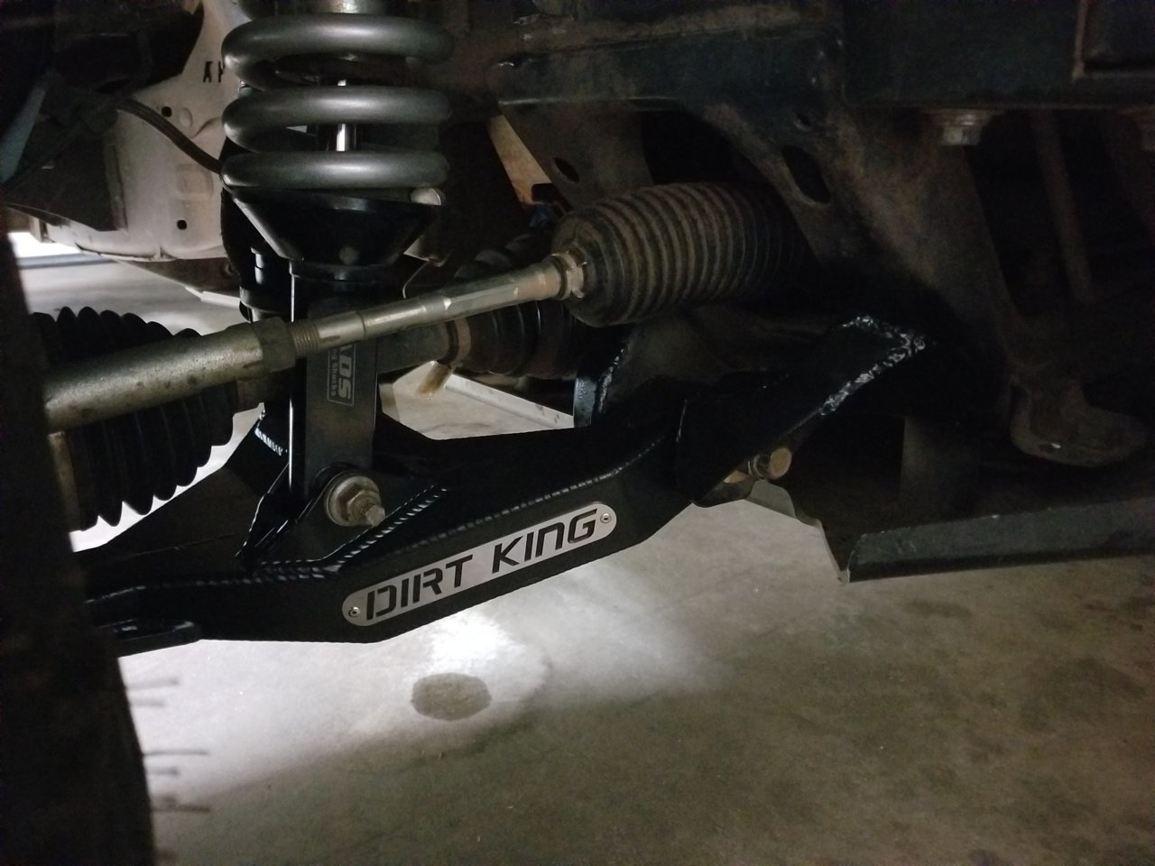

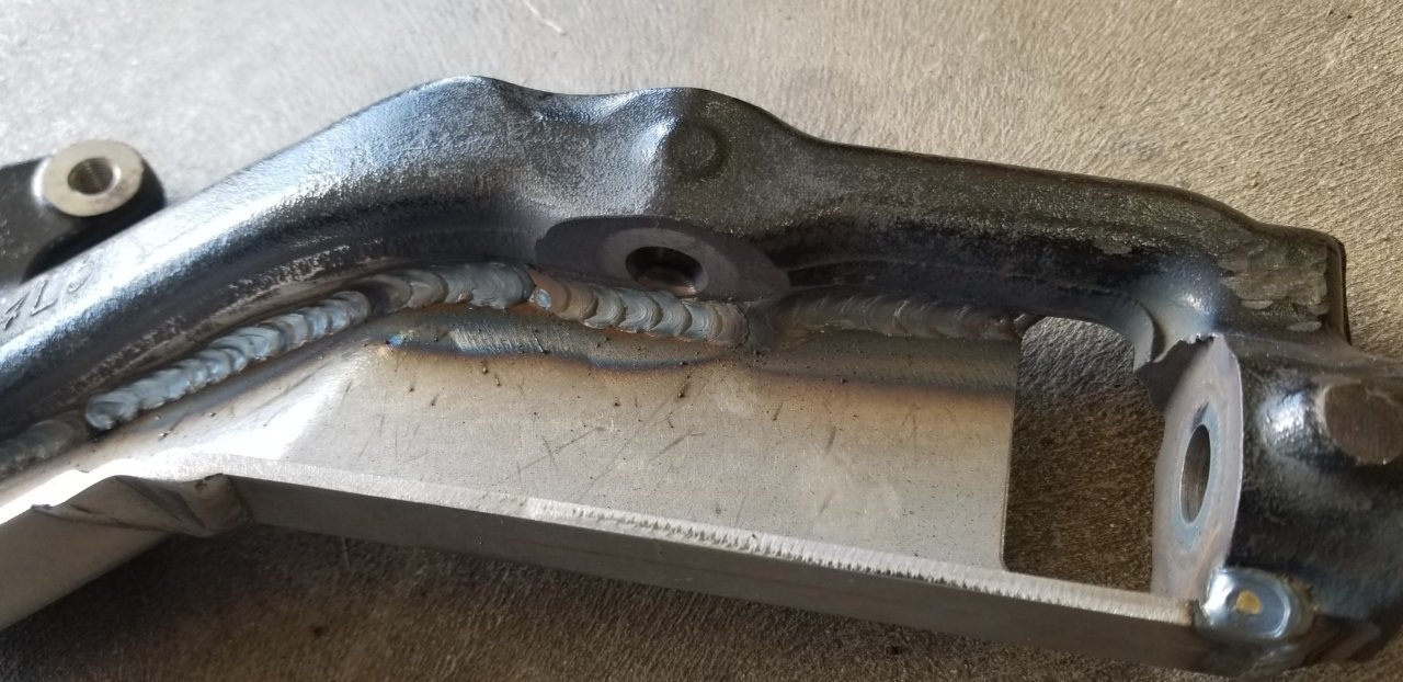

    6/23/18: Installed Dirt King LCA's and Dirt Designs LCA mount gussets.
    Installed shorter 7" limit straps since the new arms tabs are located in a different position:

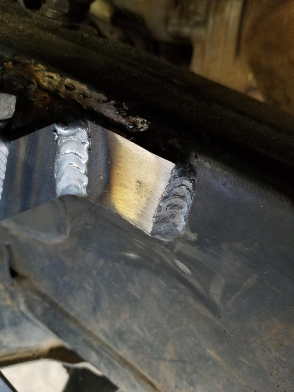

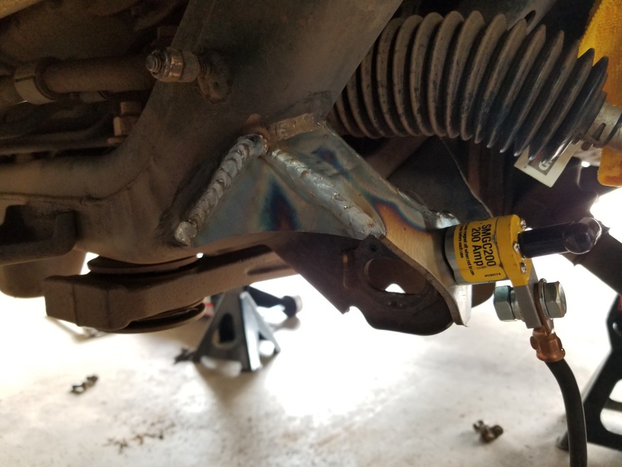

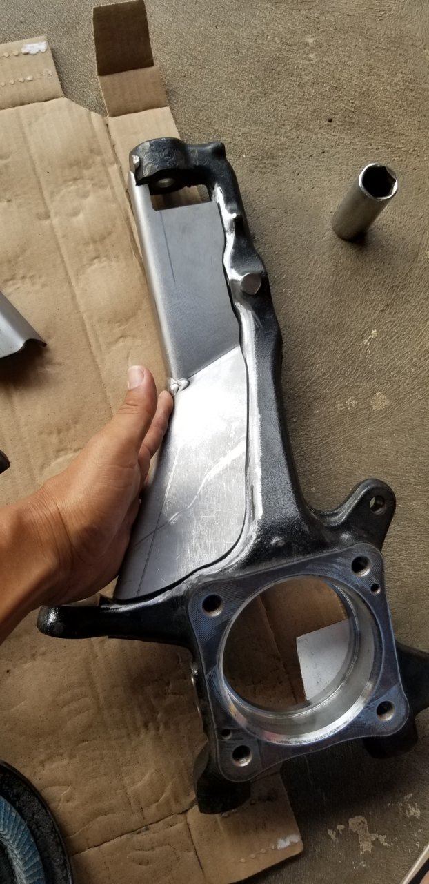

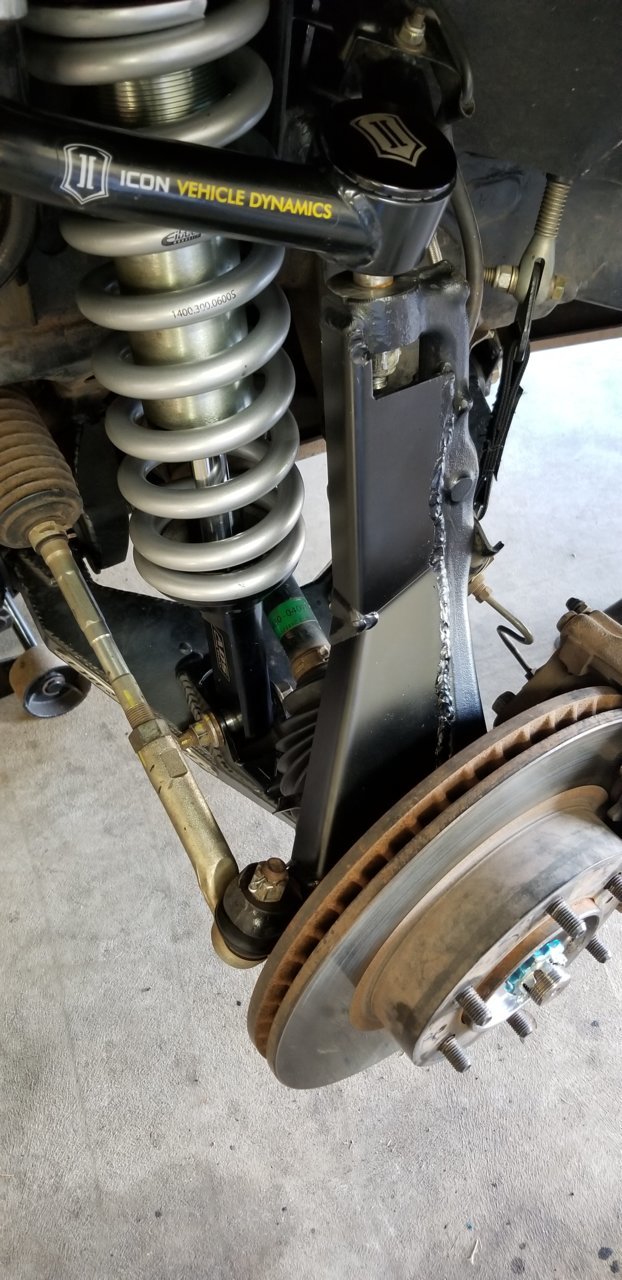

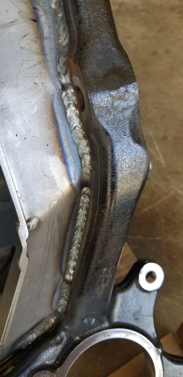

    8/27/18: Lowered the ride height front and rear. Welded up some Dirt King spindle gussets, installed them, and went to get an alignment. I was able to get better alignment #'s this time, which I think is because of the new lower ride height, LCA's, and spindles.

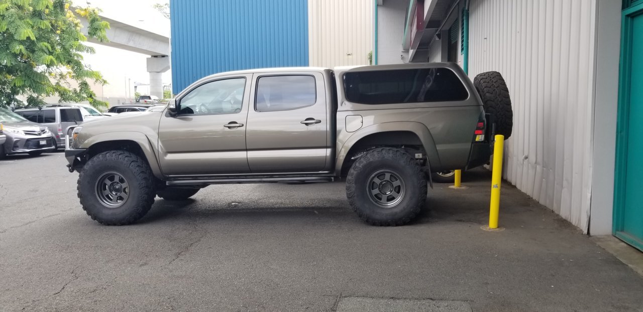

    My family really likes the cap. It keeps everything in the bed nice and dry. The only drawback is if you have to haul an oversized load that won't fit under it. That's not a problem for me because I have a smaller Tacoma work/company truck that I can use for that.;)
