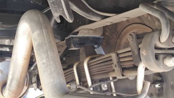

    I got some 10" Icon VS 2.0 resis installed today. Now all I need is the leaf pack from Allpro. I gained a lot of droop from the 10" shocks. I cycled the rear and had to add a small additional bump stop until I get the new leaf pack. There's much more down travel now and my leaf pack is now the limiting factor.

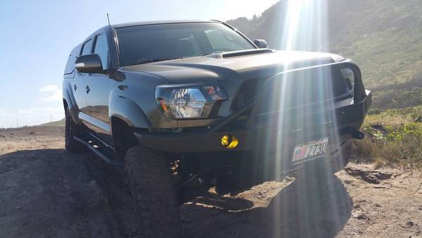

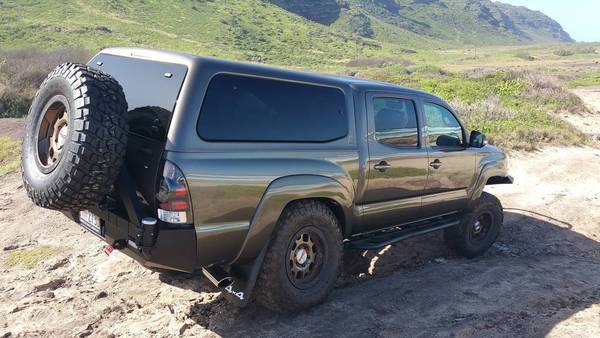

    Way more down travel with the 10" Icons than before:

    You wouldn't believe how much these polyurethane bump stops compress. I left a "buffer zone" of almost 3/4" of solid poly bump stop and the stock bump stop can push through it and my shock reaches bottom by a hair. I ordered new bump stops to put on to give more of a safety zone.

    If I had just a 1/4" more pad on the top bump stop I installed, that would have been perfect for this leaf pack. I'm thinking that with the Allpro leaf pack that I might not need a bump extension.
