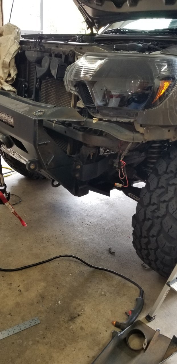

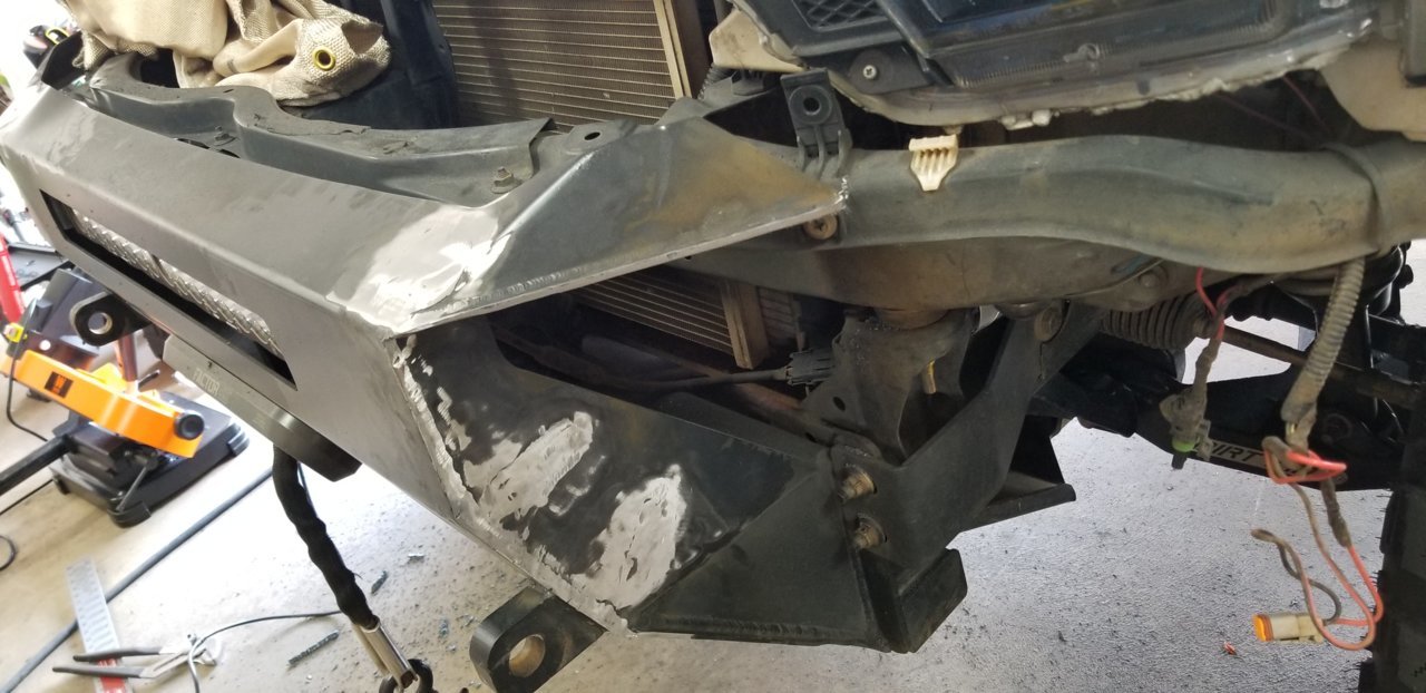

    I finished up the bumper and got these center hoop side braces installed. My notcher cannot cut at that angle so I had to do it by hand. The template for the notch was made from a free notch template program online. Just input the parent and cut tube diameter, wall thickness, and angle of notch. It even gives you a picture of what the two tubes look like intersecting at your angle. The print out is full size and you print it out, cut with scissors, trace the cut on tube, and cut with your favorite angle grinder or tool. All template stuff done with my phone.

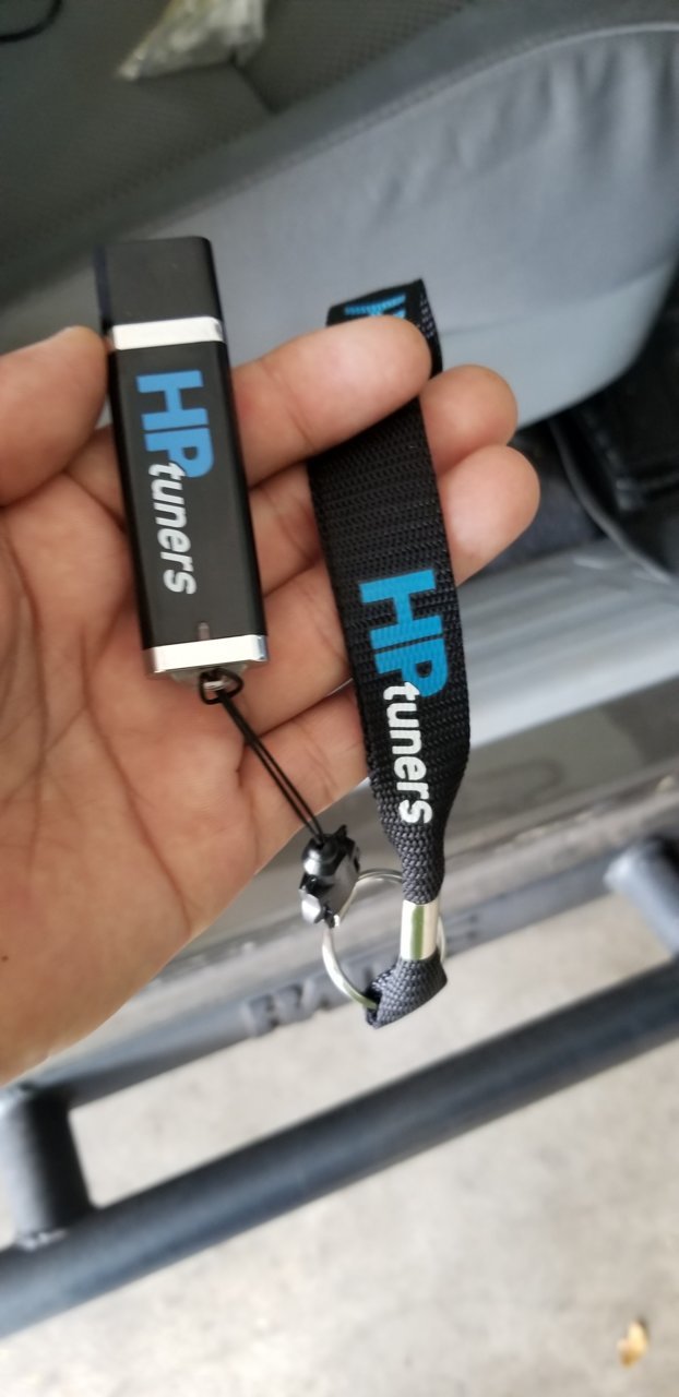

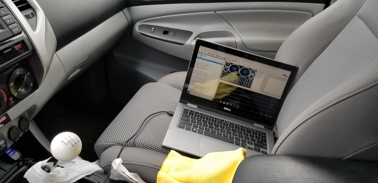

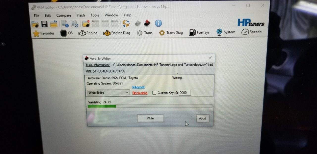

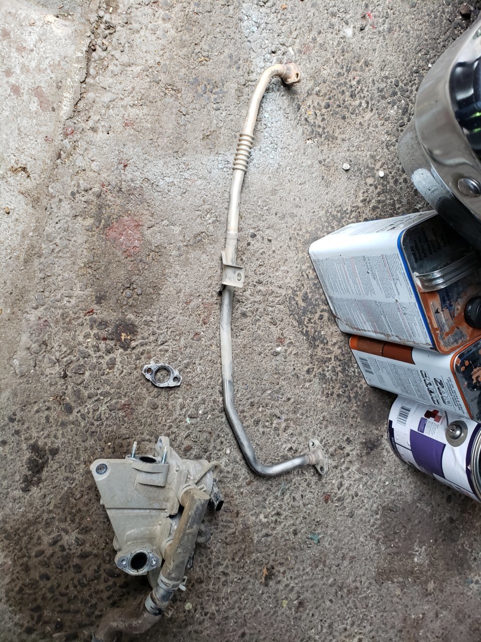

    I received the HP Tuner device and flashed a couple of tunes. @JustDSM did all of the tuning. I had sent him a few datalogs for him to review the base tune and he further refined it and sent me a final tune which is very nice. He went above and beyond to help me with a custom NA tune.
    The truck works amazing now. No throttle lag, able to pull smoothly from lower RPM's, and bit more get up and go at partial and wot. Smog pump and related parts will be deleted after I get the block off plates in the mail, (for offroad use only).

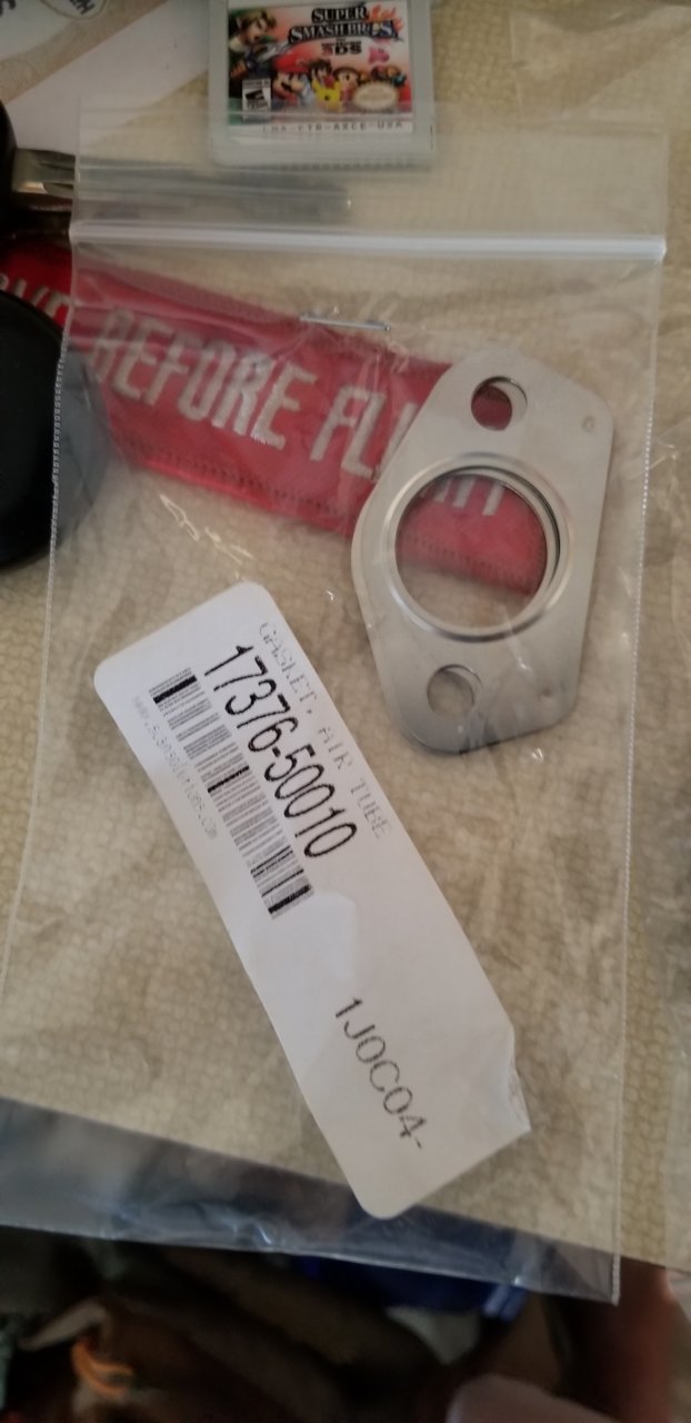

    New OEM gaskets for the SAI block off plates.

    Yours came with a usb?

    Yes

    Hmm not mine. I had the keychain, cord and the obd2 device. Oh well

    That sucks, but for what it's worth, it's just a regular flash drive.

    Makes more sense what the keychain was for at least.

    I am going to pull my SAI parts maybe tomorrow night, after I receive the block off plates. Was there anything hard about removing it all?

    15,985
    KS
    DCSB OR 4X4 LT
    Pelfreybilt Front Bumper,BAMF sliders, Airflow Snorkel,Mini D2S Retrofits, ADS Rear Shocks, Deaver U402 Leafsprings, 35s, AllPro +2LT
    I only pulled the unit on the wheel well with 3 10mm bolts. My blockoffs come tomorrow to pull the rest off

    @deeezy pulling the rest went pretty easy. Driver side is a lot more cramped but i got it from above with a 1/4in ratchet and extension. The wrap around tube has a bracket on the backside but its easy to reach down behind the motor. I unbolted both tubes at the valves then the headers and pulled them off. The valves have 2 nuts on top and 1 bolt i accessed through the wheel well.

    Awesome, I will be be doing this hopefully this afternoon.
    Thanks!
