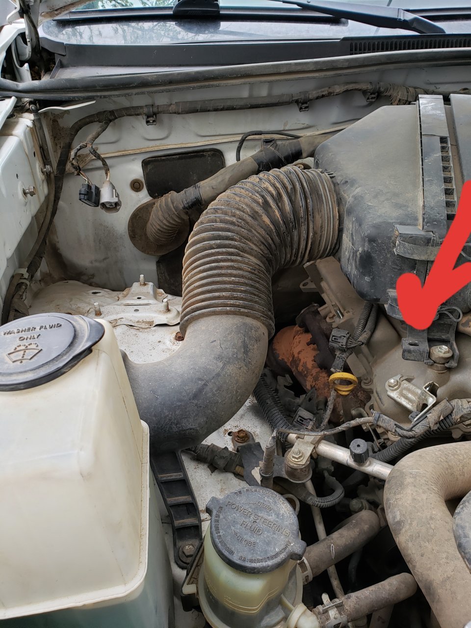

    If you undo the plastic keeper plugs nicely theres another spot you can pop it in on the intake too so it holds them off the motor

    Ah damn. I have a different intake.

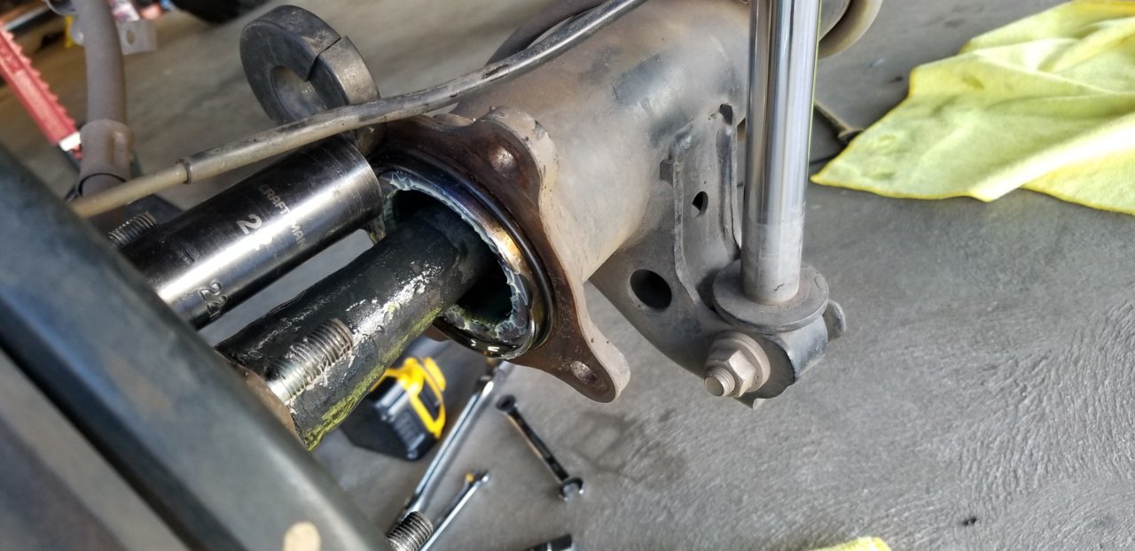

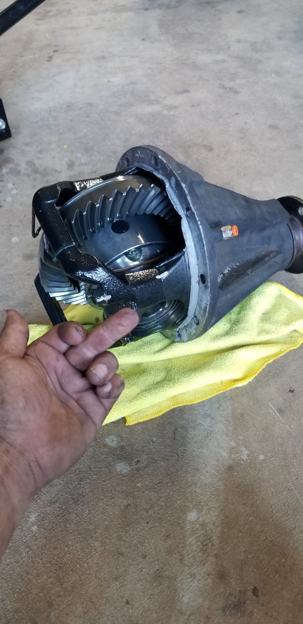

    I had a free afternoon so I got working on the new rear 3rd member and locker. Man I'm getting old. Being this is the 3rd time I've done this, I'm getting faster at it, but the diff feels like it's getting heavier every time. :rofl:

    The air locker was warrantied for a faulty seal. I figure regear to 4.88's so I'm not swapping diffs for no good reason.

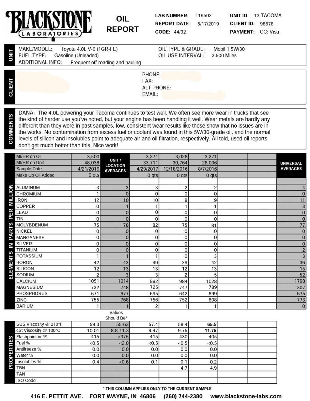

    Got my latest oil test back and glad to see everything is in top shape with all the bouncing off the rev limiter. The engine oil temp actually got a little hotter than normal on the last trip with all the WOT hill climbs. Not dangerously hot, but hotter than normal. (not sure why they put "hauling" down on the oil test)

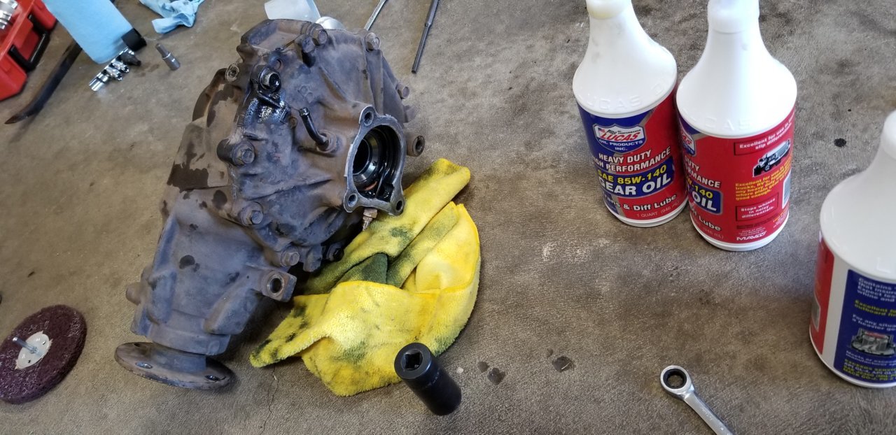

    I got the front diff installed and holy crap I'm getting old. Or the diffs are getting heavier lol.
    Truck drives awesome with the 4.88's and the lockers hold air. (Fingers crossed)

    Front diffs on these 2nd gens are a PITA to get out! My old first gens had more room over the top of the diff to get to those top bolts for the vac lines and such.

    Totally. I was trying my hardest to stay calm, but a few cuss words came out in the process. Lol

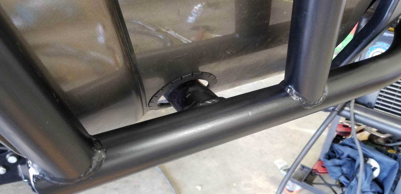

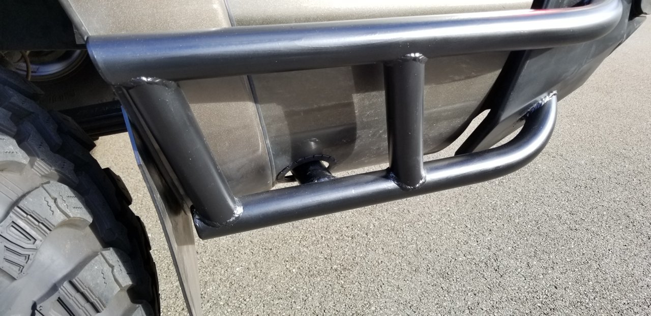

    Here's a few pictures of the front fender tubes I finished up. I plan on working on the rear bumper and fenders also and the end goal is to be able to get my reconstruction inspection with these as if they were fender flares.
