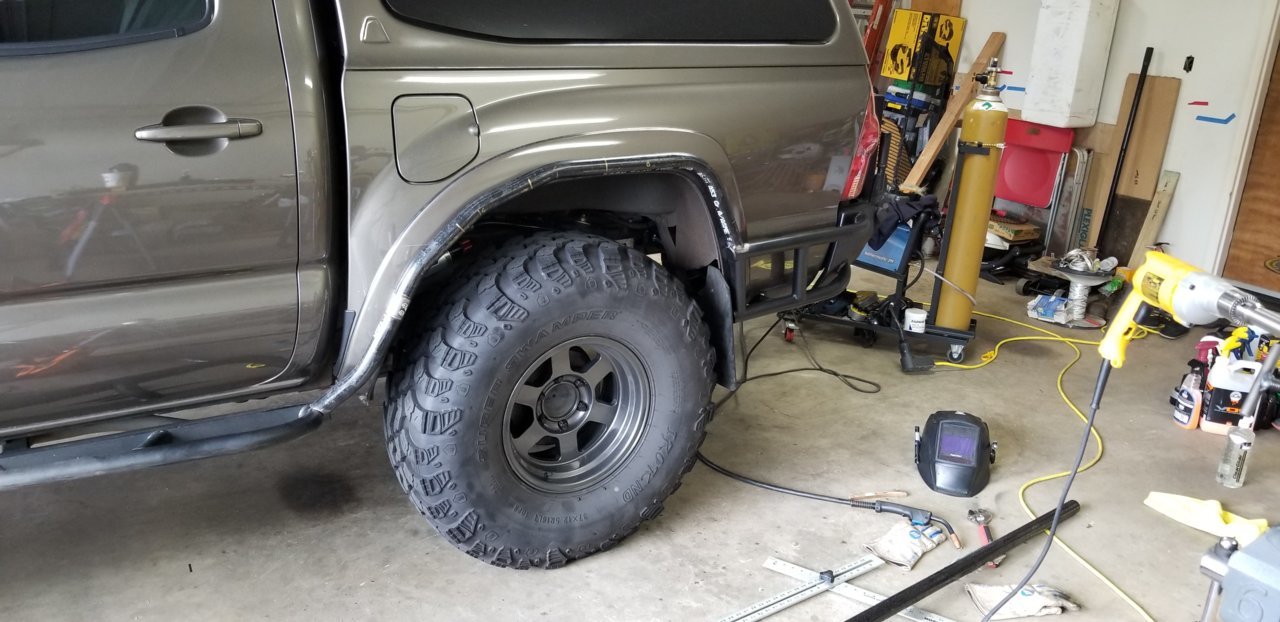

    Thank you. That means a lot to me. My wife likes arts and crafts. I told her, "I'll show you arts and crafts!" (In Tony Montana voice)

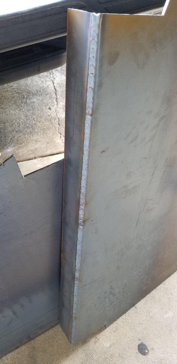

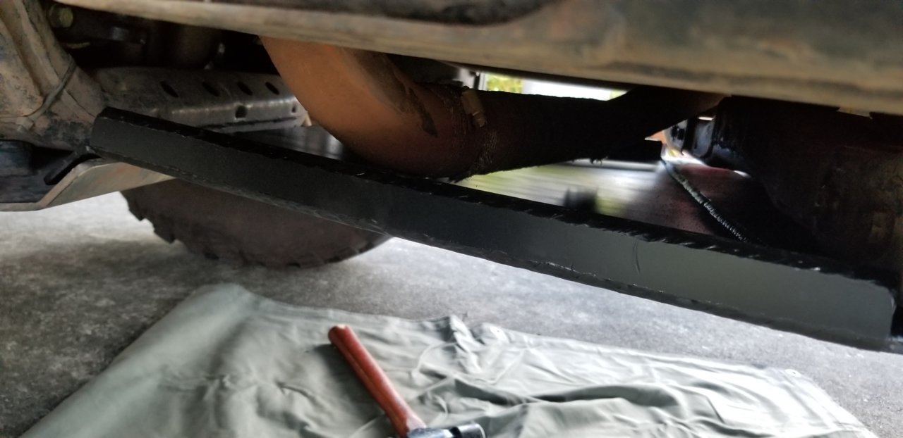

    I've been working on this today:

    Nice work. So that panel isn’t coming off anytime soon:rofl:

    Yup, not any time soon. lol. Your talking about the "slider leg" that goes to the frame? If I ever have to take it off, I have tube clamps to weld in after I cut the leg and I will just notch out the bottom of the bedside since it's so close to the bottom anyway, so the leg can just drop out through the notch. I should have actually done it that way, but I was so dead and tired and just wanted to finish it.

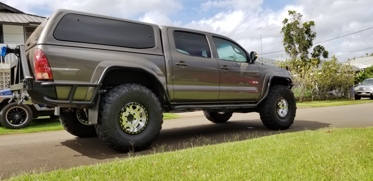

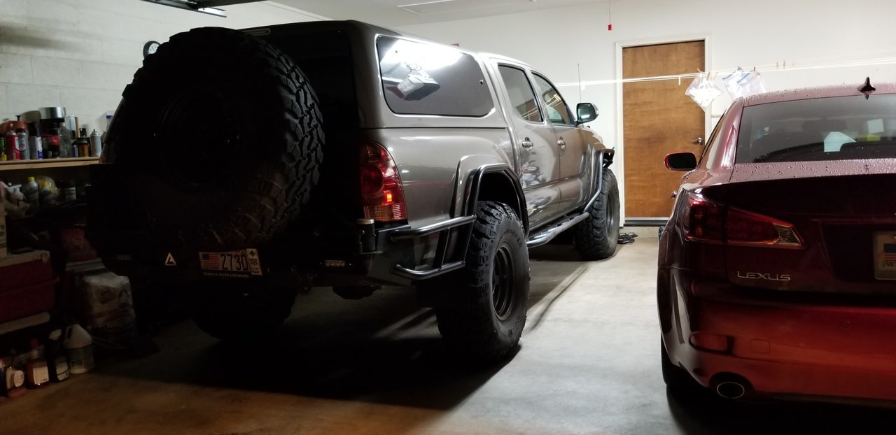

    Finished! (notice it's nighttime! I take so damn long!)
  6. Jun 7, 2019 at 10:04 AM
    #2066
    Sacrifice
    Sacrifice Motorcycle Goon
    Oct 8, 2013
    #114093
    15,986
    KS
    DCSB OR 4X4 LT
    Pelfreybilt Front Bumper,BAMF sliders, Airflow Snorkel,Mini D2S Retrofits, ADS Rear Shocks, Deaver U402 Leafsprings, 35s, AllPro +2LT
    So i have to ask. Wont these just flex into the body panel? :confused:
  7. Jun 7, 2019 at 10:06 AM
    #2067
    deeezy
    deeezy [OP] Well-Known Member
    Sep 1, 2013
    #111645
    5,253
    Dana
    Hawaii
    2013 4x4 DC, 6 spd, TRD Sport
    King ext travel coilovers, Icon tubular UCA's Rear-King "Tundra" 2.5's, Allpro Expos, TRD cat-back, Hurst/Core short shift kit, etc...
    They might. They are about 1/2" away from the panels. I tried running it with a bigger gap and it looked retarded, so I'll deal with a little rubbing. My body panels are already bent, dinged, and scratched, so figured what the heck, just run it.

    I let my wife know that too. She held every piece where she thought it looked the best as I tacked everything in place. She had the final say, if she says F-it, I say F-it. haha :rofl:

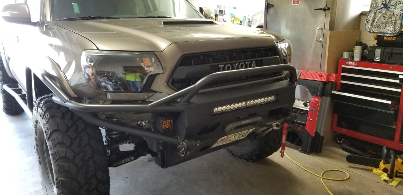

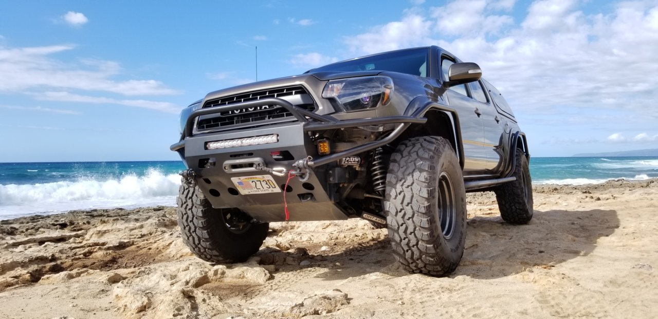

    Wanted to change the look of the front end so I picked up a generic TRD pro grill from Amazon. (And poser pic at the beach while testing the new lockers out)

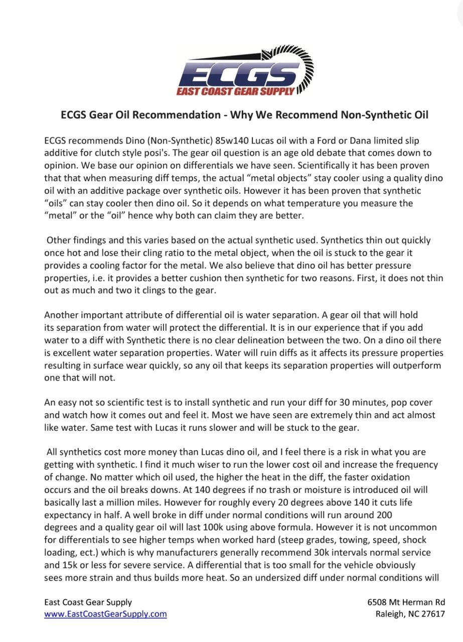

    An informative document about gear oil from ECGS:

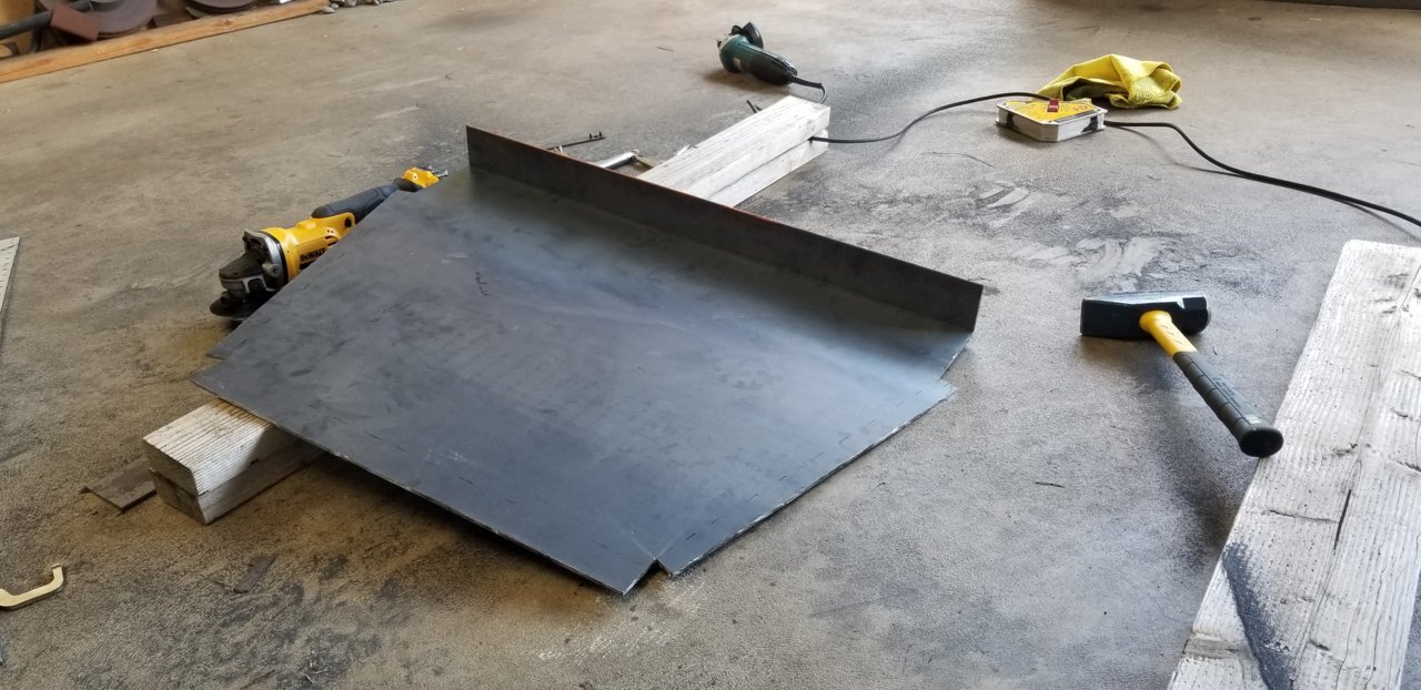

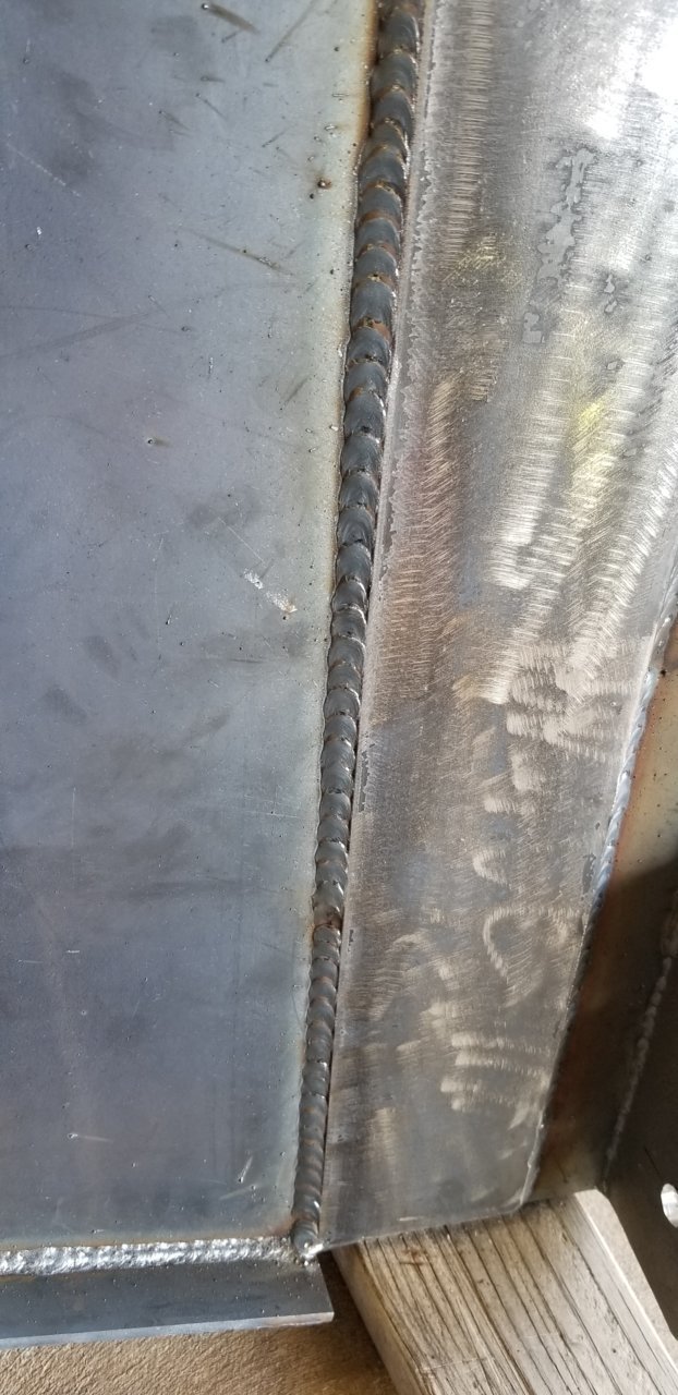

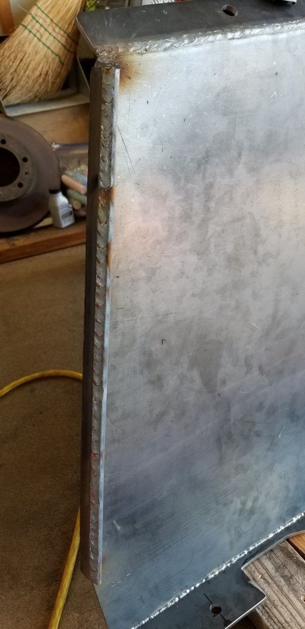

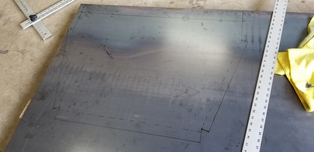

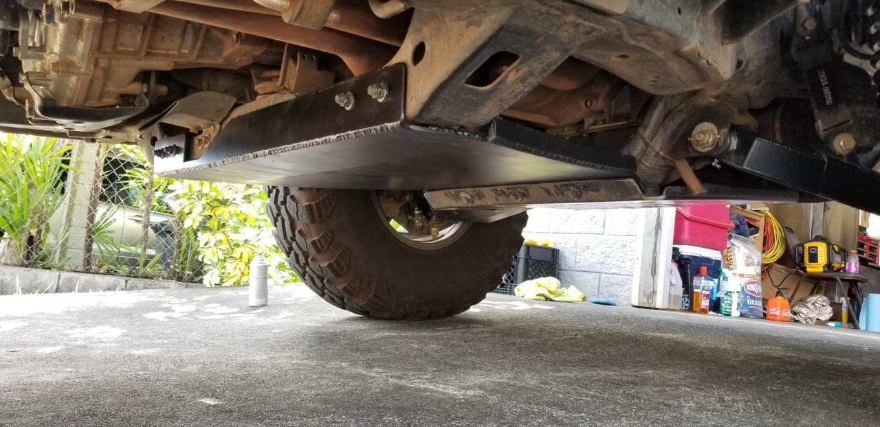

    Haven't been on in a while, probably because it took me so long to cut all of this with an angle grinder. I forgot to borrow the plasma cutter from work and figured what the heck. Anyway, my aluminum mid skid got bent enough to flatten the bottom of my y-pipe a little so I replaced it with this. 3/16" plate doubled up to 3/8" in the areas that bent on the aluminum skid, the vertical end rails and in front of the crossmember. The main reason for building this is because I need a steel mid skid that bolts up to the Pelfrey IFS skid.

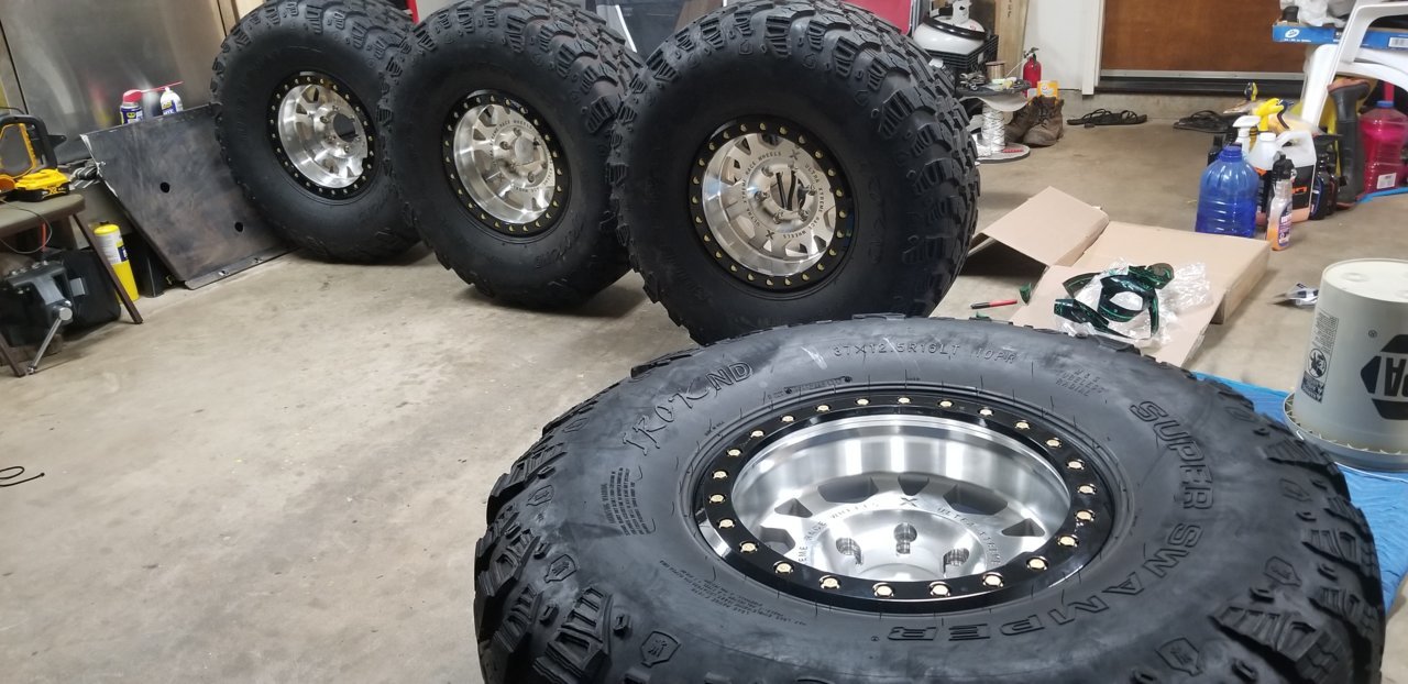

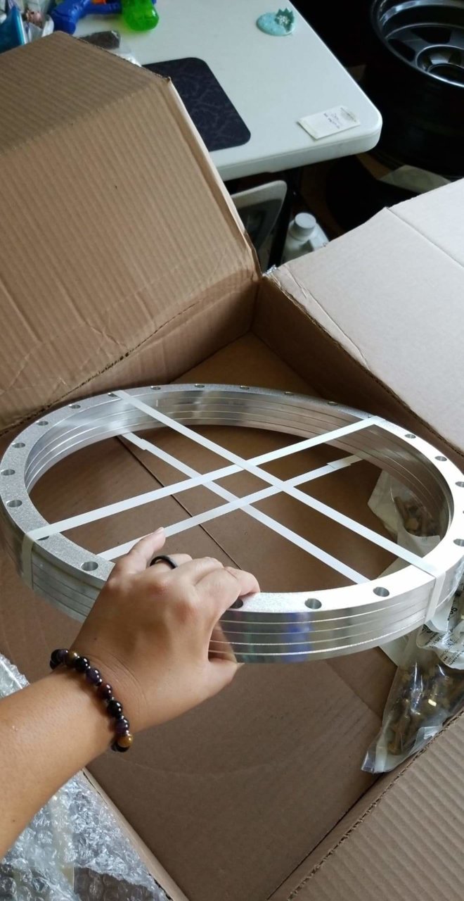

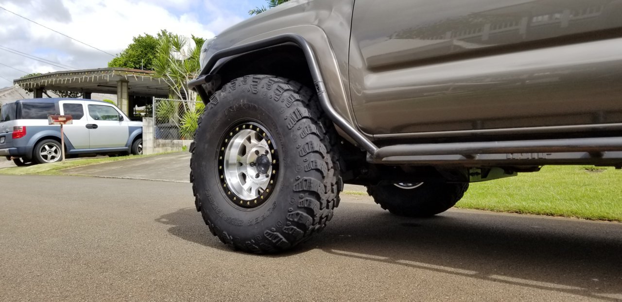

    Finally got these beadlocks mounted. Ultra Wheels had custom spacers made for the wheels to accommodate the extra thick bead the Irok tires have. It's been a long night and I'll get these on my truck in the morning.

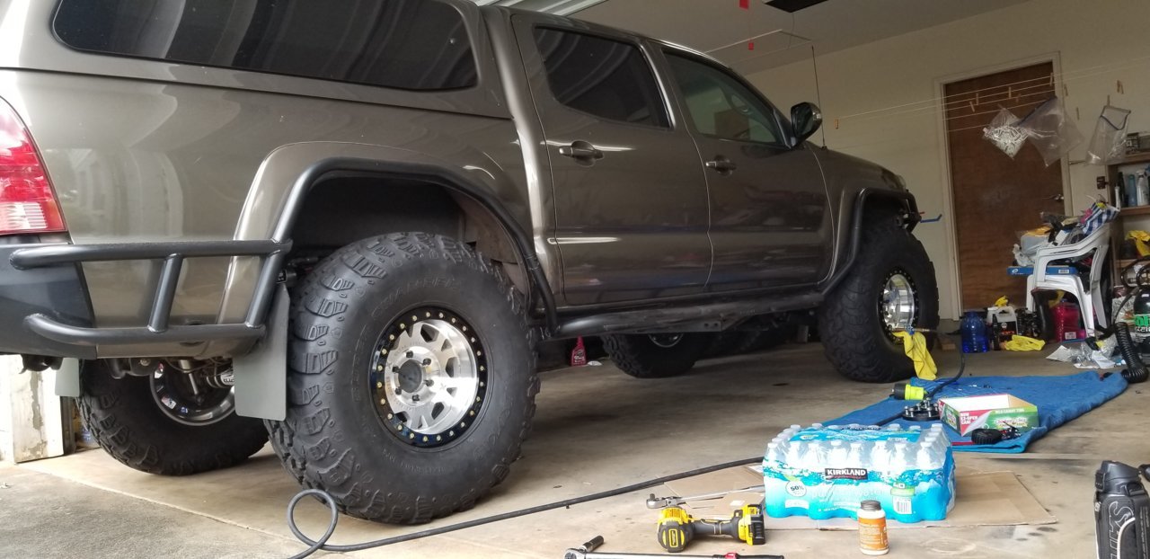

    And mounted on the truck.....

    Truck looking cherry my bradda

    Damn man those look beefy. Truck is looking great

    Thanks man! Yeah, these wheels are something else, machining was perfect, flawless. They actually look better in real life lol.

    One more poser pic. I forgot to mention, the beadlocks and tires required no balancing. Smooth as glass, as fast as my slow truck can go.
