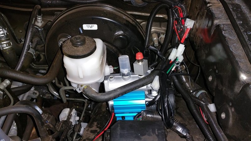

    This looked like the only place to mount the compressor without moving anything. It has about a 1/2" clearance around it.

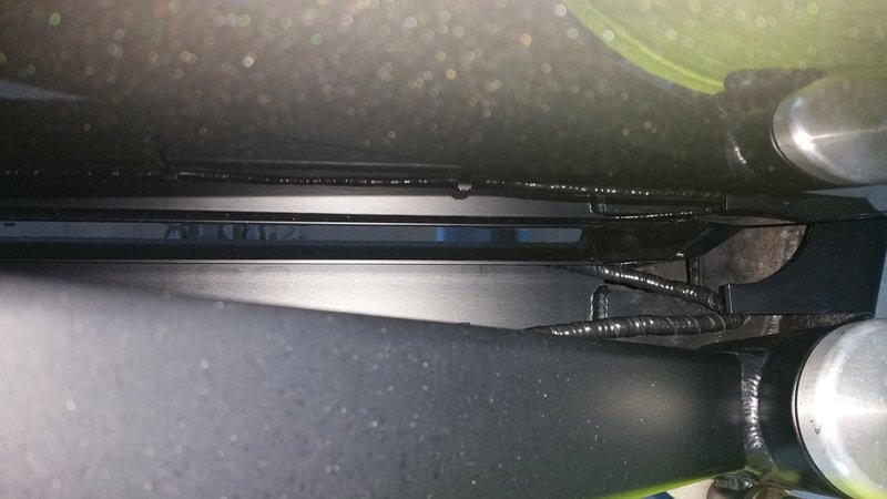

    Finally got the air line in for the locker. I routed it pretty much along side the brake lines all the way to the rear end:
    I put the two compressor and locker activation switch under the AC controls. My wife said the ARB switches don't match the OTRATTW ones so we're ordering some matching ones soon.
    The instructions for the compressor said to hand tighten the pressure and solenoid fittings but I had a small leak. I had to use a wrench and slowly tighten until the leak went away. The system holds air good now and the locker works good and activates no problem.
