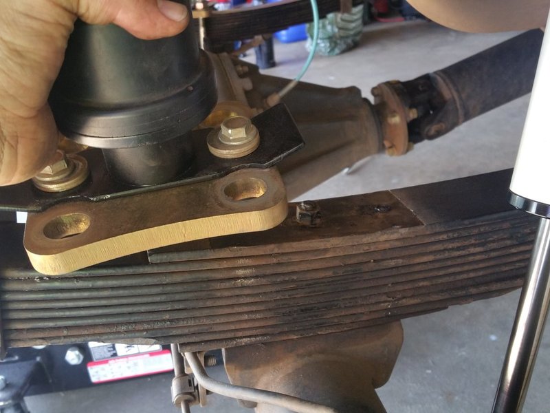

    Well, the shackle install turned into a chore. I forgot that in order to swap shackles, I had to remove the leaf spring from the truck to get enough clearance to get the bolt, holding the shackle to spring, out. Anyway, I like how it turned out. No squeaking and the new shackles and bushings can move better than the old stock ones (my old bushings might have been shot).
    I had to remove the U-bolts and all the bolts holding the leaf springs to the frame.
    Old shackle before I swapped it:
    New HD shackle drooped:
    HD next to stock:
    New shackle at ride height:

    Thanks guys. I figured that I might as well upgrade shackles if I was going to replace my bushings anyway.

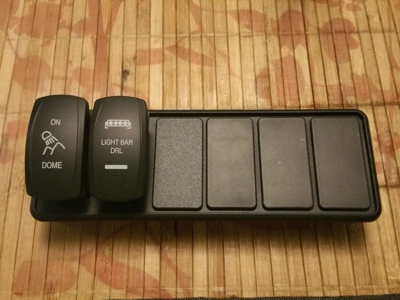

    I got my Iggy switch panel in today along with some blanks. These are the switches going in. I'll finish painting the panel tomorrow.

    Did some wiring last night. I got my 3-pos rock light switch and the DRL switch for the S8 light bar installed in the Iggy panel. I have 4 blanks left and wiring additional switches should be easy because I have a switched 12v feed, ground, and illumination wires down to the new Iggy panel.
    I used to have the drl wired to come on with the rigid fogs. Now they are separated so I can have just running lights on.
