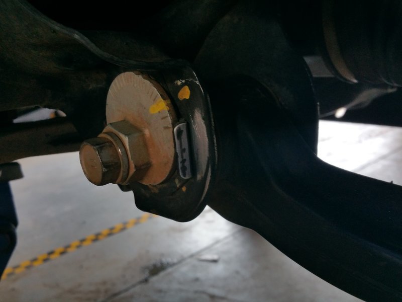

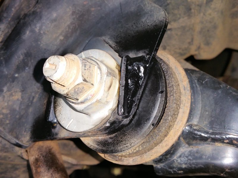

    After seeing a couple member's alignment cam tabs get flatttened I decided to check mine and a couple of the tabs were starting to bend out. Not flattened but it now had about. 1/8" of play between the tabs and the cam bolt. I tapped the couple of tabs back into place and had a friend weld a bead behind every one. The stock tabs are very flimsy and were easy to tap back into position. They look pretty un-bendable now.

    I need this done

    Yeah man. Not as good as the Total Chaos cam tab gussets but way better than nothing. I don't think the tabs can bend if you weld a fat bead behind it.
