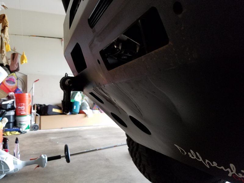

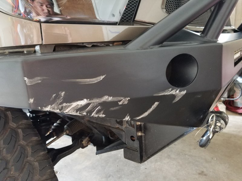

    And my bumper dry humped that wall I tried to climb.

    Keep it. Adds character

    Yeah, I'm glad I opted for steel. I just cleaned it up and painted over it. Doesn't look too bad. :rolleyes:
