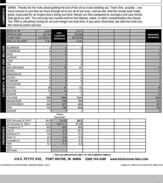

    I got the results of the latest oil sample from my truck back today. I was curious if there would be any changes from the last analysis since I pounded the crap out of the truck and had it bouncing off the rev limiter for quite a while on the last wheeling trip. Well, it's just as good or better than the last oil change. This means, it's okay to bounce off the rev limiter once in a while.

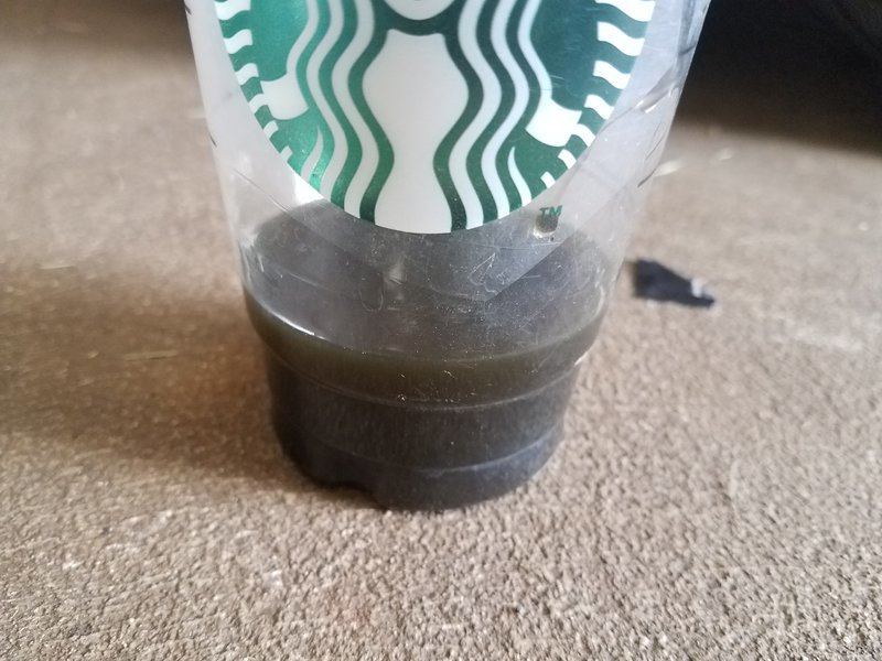

    I flushed the old steering fluid out and replaced with some full syn Valvoline Max Life Dex2/3 (was the cheapest option because sale).
    The old factory fluid didn't look too bad until I put it in a cup.

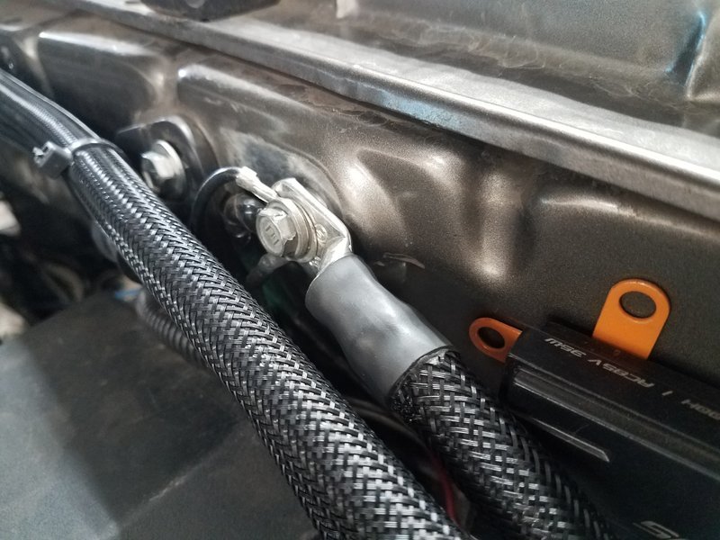

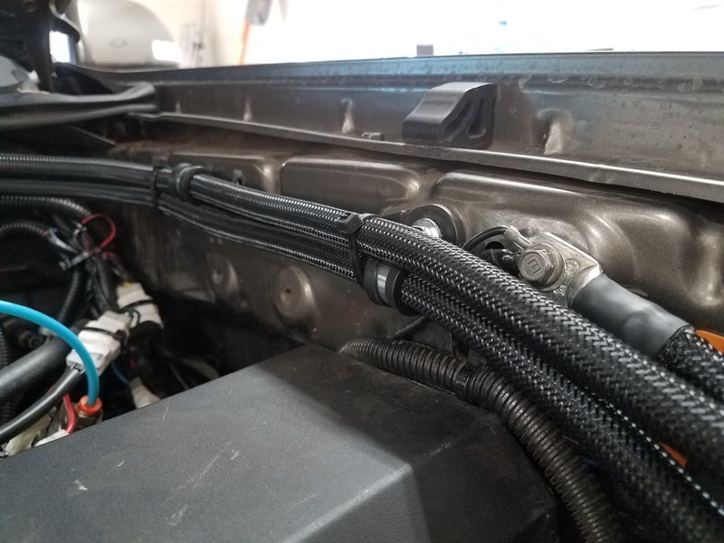

    I re-did the factory ground wire that grounds to the driver's side fender/frame with some 1/0. And also finished strapping/securing all of the main battery wires going to the bed.

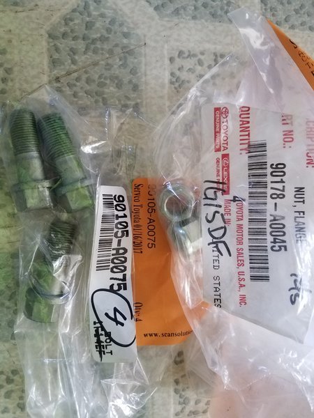

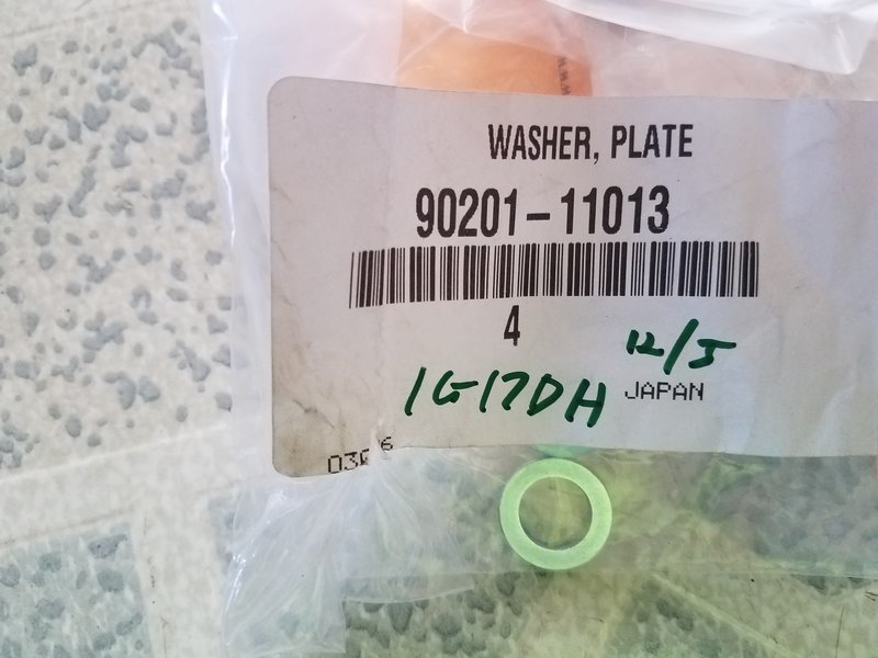

    If anyone ever needs to buy some driveshaft bolts, here are the PN #'s for Toyota hardware:
    Bolt: 90105-A0075
    Nut: 90178-A0045
    Washers: 90201-11013
