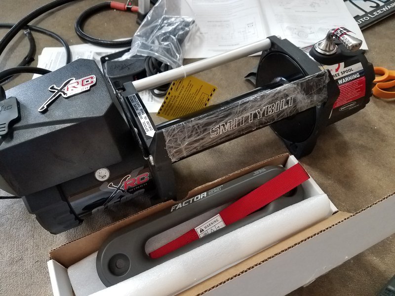

    Today's project:

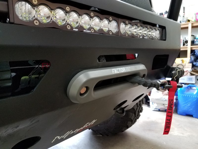

    And.....it's finished. I still need to spool the winch under load tomorrow.

    Idk if you forgot already, there's a ring on the inside of the bumper so you don't have to clip the winch to a d ring in front.

    I did forget. Thanks for the reminder. :cheers:

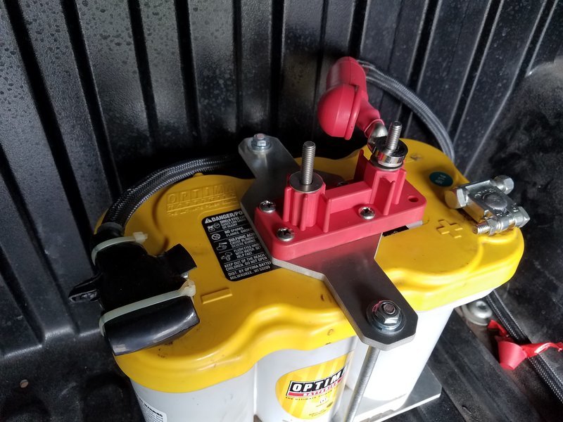

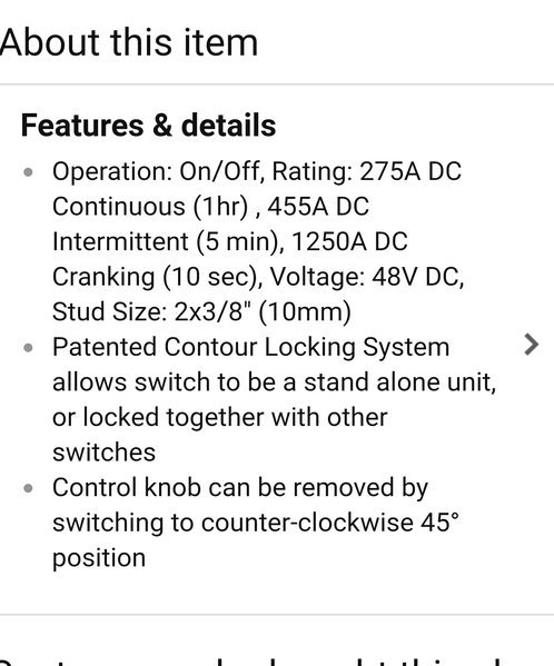

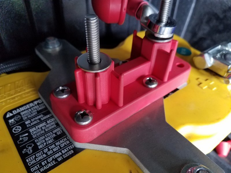

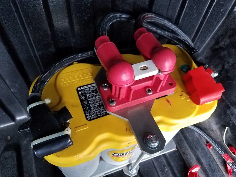

    I picked up this disconnect for cutting the 12v power to my winch when it's not in use. It should do the trick.

    What have you done to your truck lately
    Where that going in the cab?

    That thing is going in the engine bay most likely next to the main bus bars.

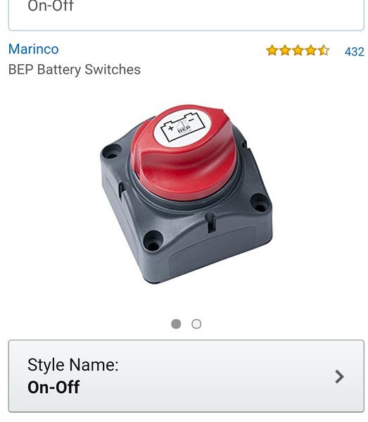

    I was trying to pick up the Blue Sea disconnect you posted earlier but Amazon wouldn't ship to my address for some odd reason. So I figure I'd give this one a try.

    Pretty much the same thing anyways. Think that's the same one I was gonna use.

    Did you check west marine? They carry A LOT of blue sea products.
