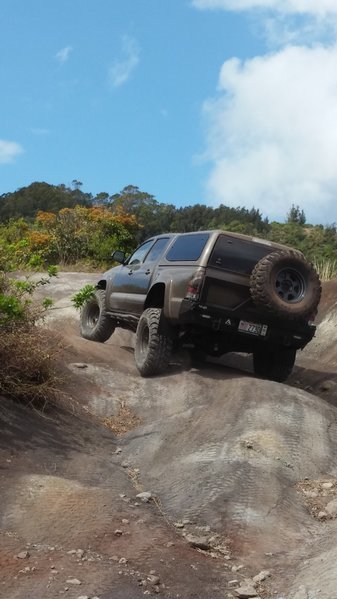

    To your adjustable coil overs :rofl:

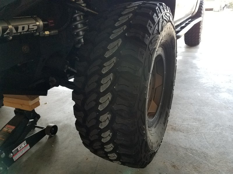

    After replacing my inner and outer tie rods I needed to set the toe alignment again. Since it was just toe, I didn't want to pay for a full alignment at a shop so I did it like this. It may not be as accurate as the lasers at the alignment shop, but good enough for me. It's set at about 1/8" toe in now. I got the procedure from jberry's "alignment at home" thread, except I marked the tire with chalk.
